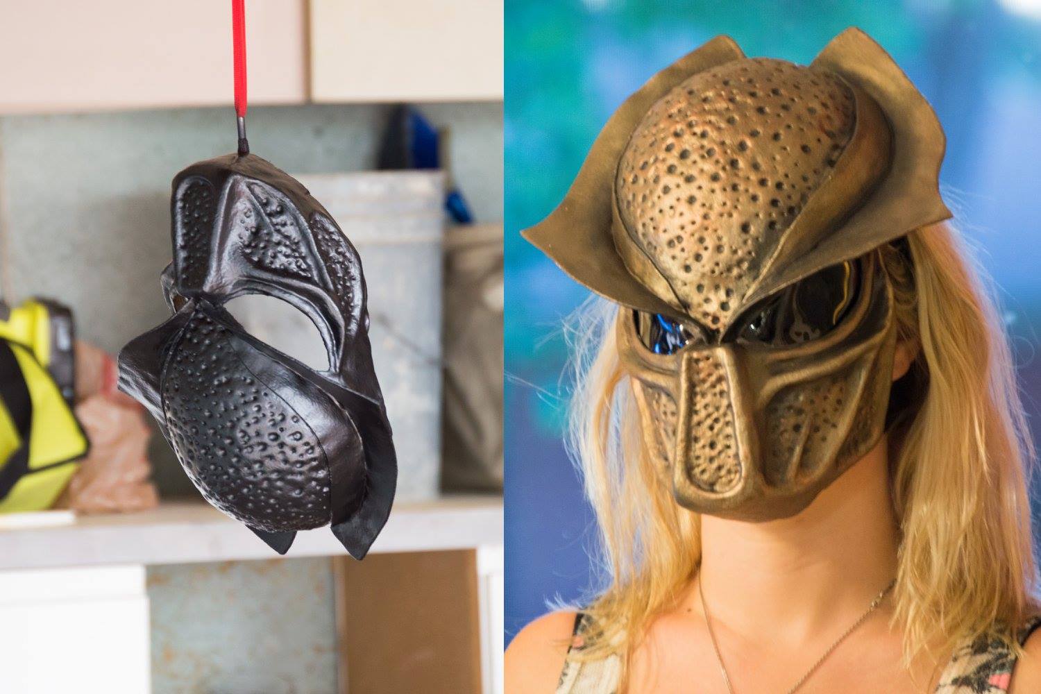

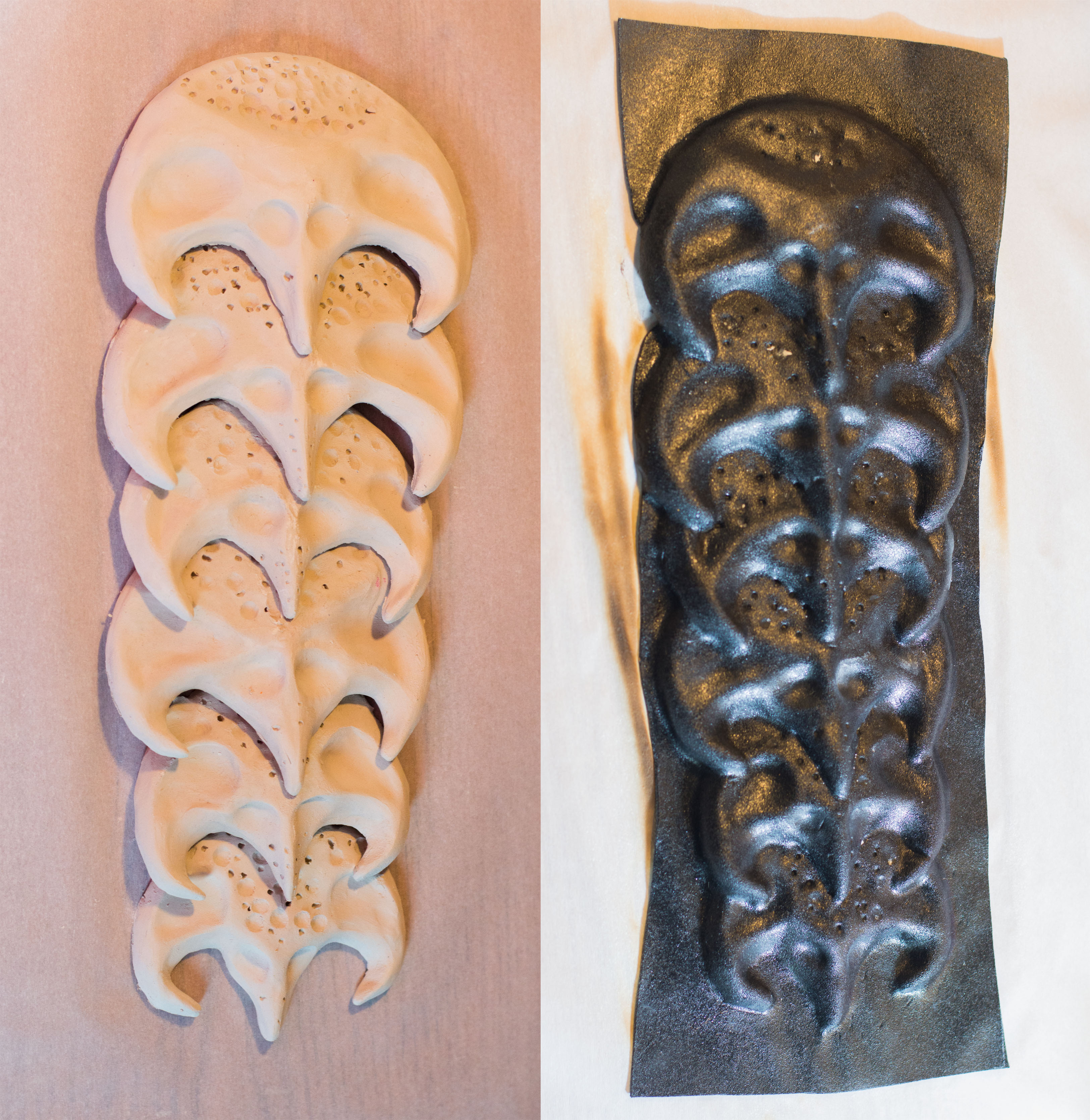

I was really excited about the helmet so that is where I started. First I sculpted it out of cheap air drying clay then heated some worbla over it when it was dry. The clay did crumble when I took the worbla off but the end result still came out really nice. This was good for a one time copy of the clay but I would not have been able to use it more than once.
After construction I primed it with 3 layers of wood glue and 2 layers of plasti-dip. I painted it with bronze spraypaint and acrylics. The eyes were made out of PETG plastic which I dyed to give it the tint.

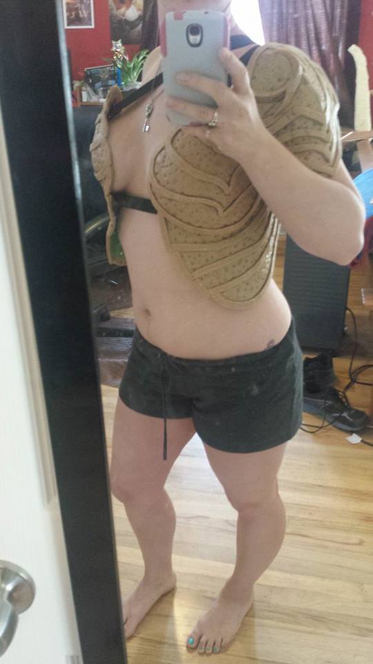

I also have the chest piece and shoulders/cannon completed. They are also made from one layer of worbla with craft foam. To get the texture I used a solder to make the holes in the foam then heated the worbla on top pushing into the holes. For the cannon I carved the main structure out of pink insulation foam and heated worbla on top which melted the foam. I don't recommend the insulation foam as much as EVA since it melts so easily. I was able to cover up most of the mistakes with the detail work so it isn't really noticeable.

Nice work on the helmet, I hadn't thought of using clay and worbla like that before, the result looks great.

Great work so far! Just a question on the helmet though, How do you breathe with the helmet so close to your face and no holes in it for breathing?
The helmet is loose enough and has plenty of space where enough air gets in. Also I plan on securing it with magnets onto the wig so I can easily take it on and off. I am mostly worried about how hot it gets inside the helmet, hopefully being able to take it off easily will be good enough!

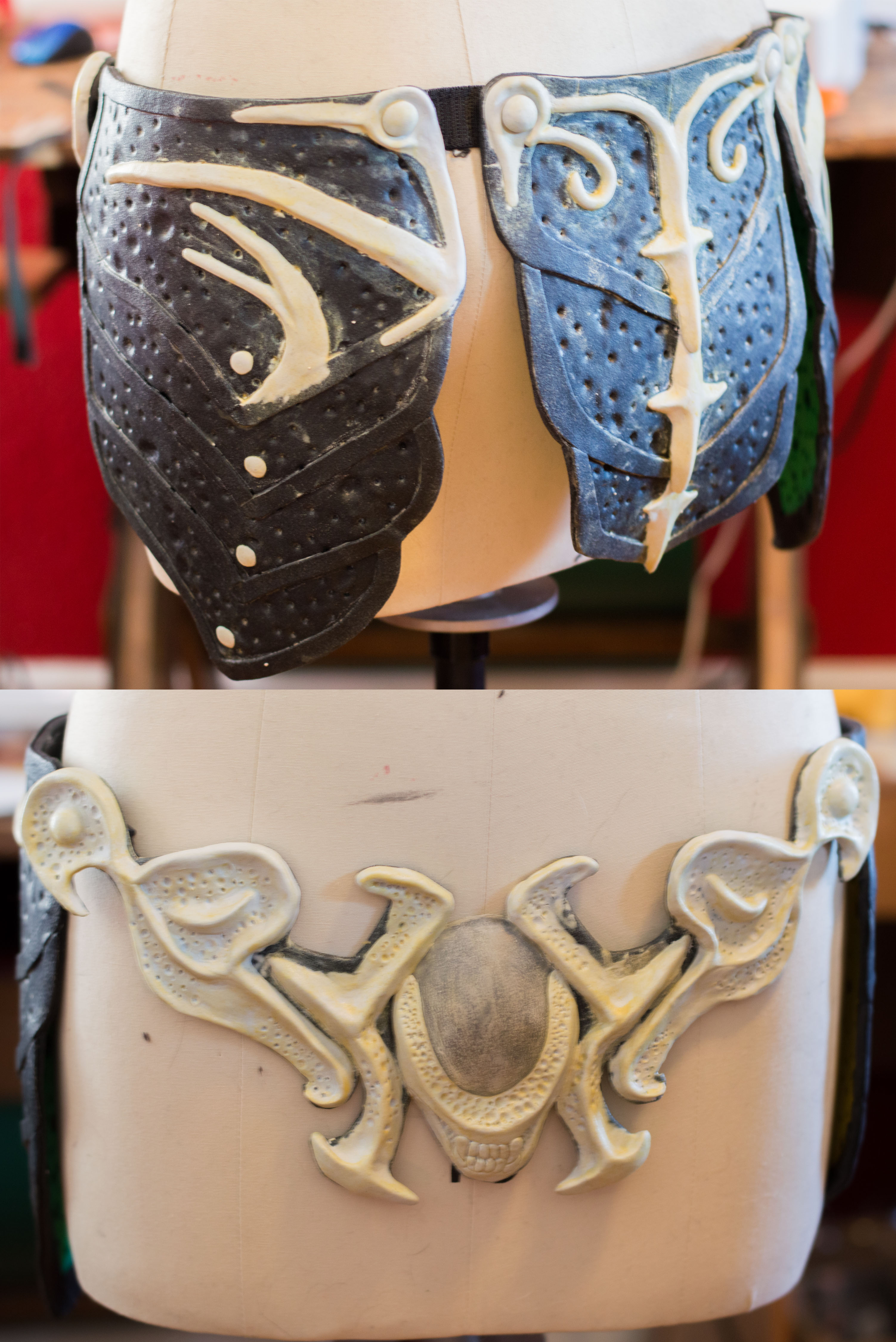

Here is the belt and hip armor progress!!!
For the main pieces of the front and back I used apoxie to sculpt the details over black worbla. For the center front portion I used transparent worbla for a smooth surface and to cut down on the weight.
For the hanging down piece I sculpted it with cheap clay and heated some worbla over it to make one solid copy. This made it really light and durable! I love using this method however I use the cheapest clay I can find which does not allow for multiple copies to be made since after the first copy the clay breaks.
Here is everything finished and painted! I attached the hanging piece with clips and the cloth with velcro! The belt itself is one piece held together with elastic and one clip on the right front side. I wanted the hanging part to come off for easier sitting at cons and such :) One of the biggest challenges for me was patterning this to my body since the figure has much much longer legs than I do. I ended up having to squish everything shorter in order to fit.

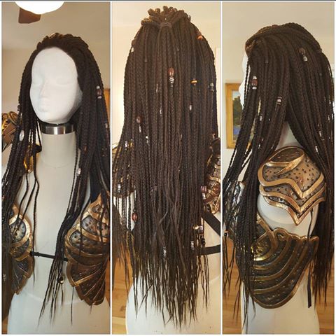

I couldn't resist posting a full shot of the armor so far with the wig I received today! I am debating with cutting the wig shorter since the figure has her hair about shoulder length. I love the long hair though so I may leave it longer. Beads will be added at some point as well.
More progress! I have finished the costume, and in a rush I did not take as many progress photos as I would have liked (especially of the sewing parts). I ended up putting some LEDs in the shoulder cannon and finished the leg and feet armor using the same techniques I used before with making holes in the patterned craft foam and constructing the pieces with worbla.
I ordered an amazing lace front braided wig off amazon which I beaded and pulled the front portion back. Although the wig is longer than the original design I really liked the length and left it as it was.
