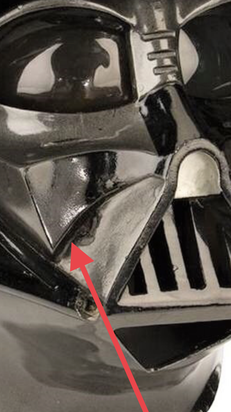

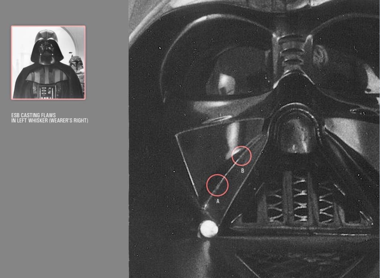

OOO the helmet lying on the ground from dagoba very nice Is that worms I see below the cheek
Yes...the ESB hero had also worms.This worms are an intersting detail because you cannot see them on the ANH screenused helmet.But on the VP and the ESB helmets its there.Was it a detail in the first mold of ANH and they removed it for the helmet?
Here you can see the worms on the ESB hero mask:

The "worms" are not there in ANH because they are a casting flaw only found on the UK mold. they weren't part of the ANH helmet and are not there in the US mold.

I think if it was not found on the ANH screen used that it must have originated after the mold was made of the ANH screen used Mask
I can not say if it was an actual artifact perhaps in the Mold for the ESB production
But that is actually very interesting if a cast pulled directly from the UK mold does not have the worms like the original screen used ANH
then the worms must be present in another Mold and then it would say that all face masks with direct lineage and has the worms came perhaps from a mold of a UK cast face mask when the worms became present
Or it could simply just be a paint artifact or a mold artifact that originated somehow or another
Acams razor say's it's the simplest answer
You are complicating things. The UK mold created this defect when it molded the original ANH. It was not on the ANH, still isn't, and is not in the US mold. All UK mold castings that hasn't been cleaned up or had the detail deliberately removed has this detail.

Apologies Carsten I did not mean to complicate things
I was merely making an educated guess on my part as I was not aware of the simplified factual answer you and Juan have provided
I deleted my post to avoid confusion .
Thank you very much for providing the correct answer ! :D

I’ve been reading along and following. But still confused with the term “worms”
“Worm” is the groove where the flat edge meets the step below the eye?
