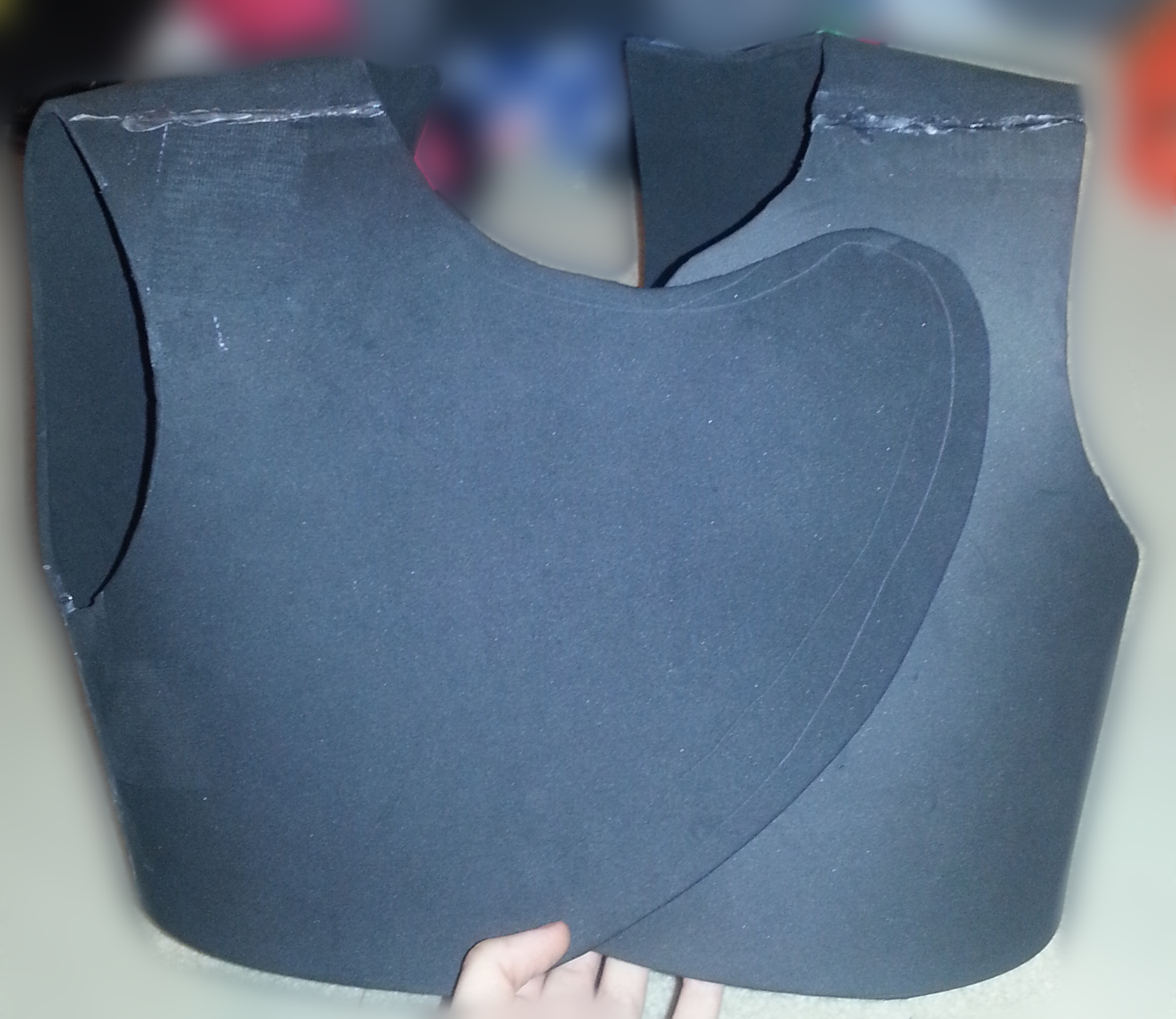

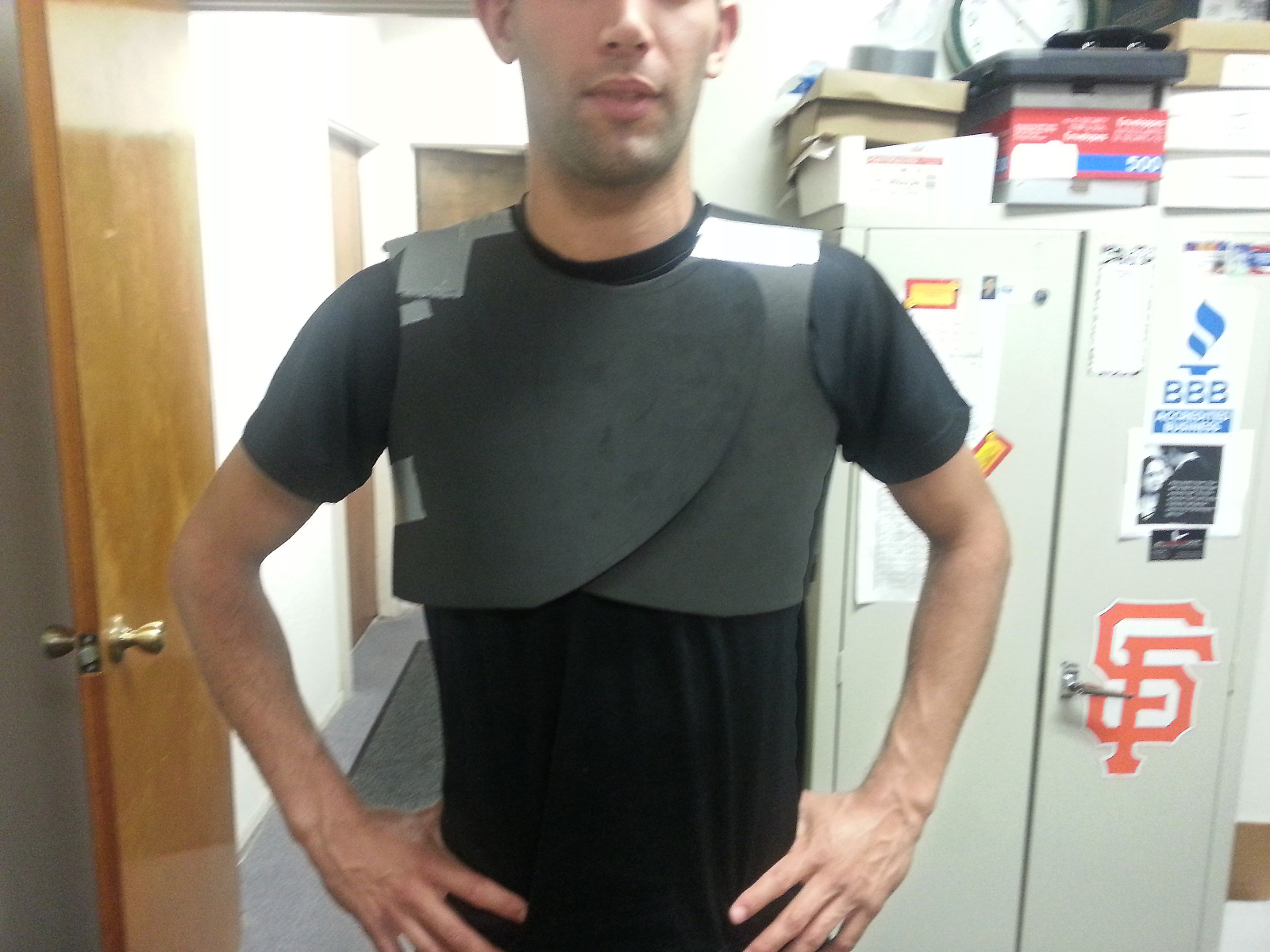

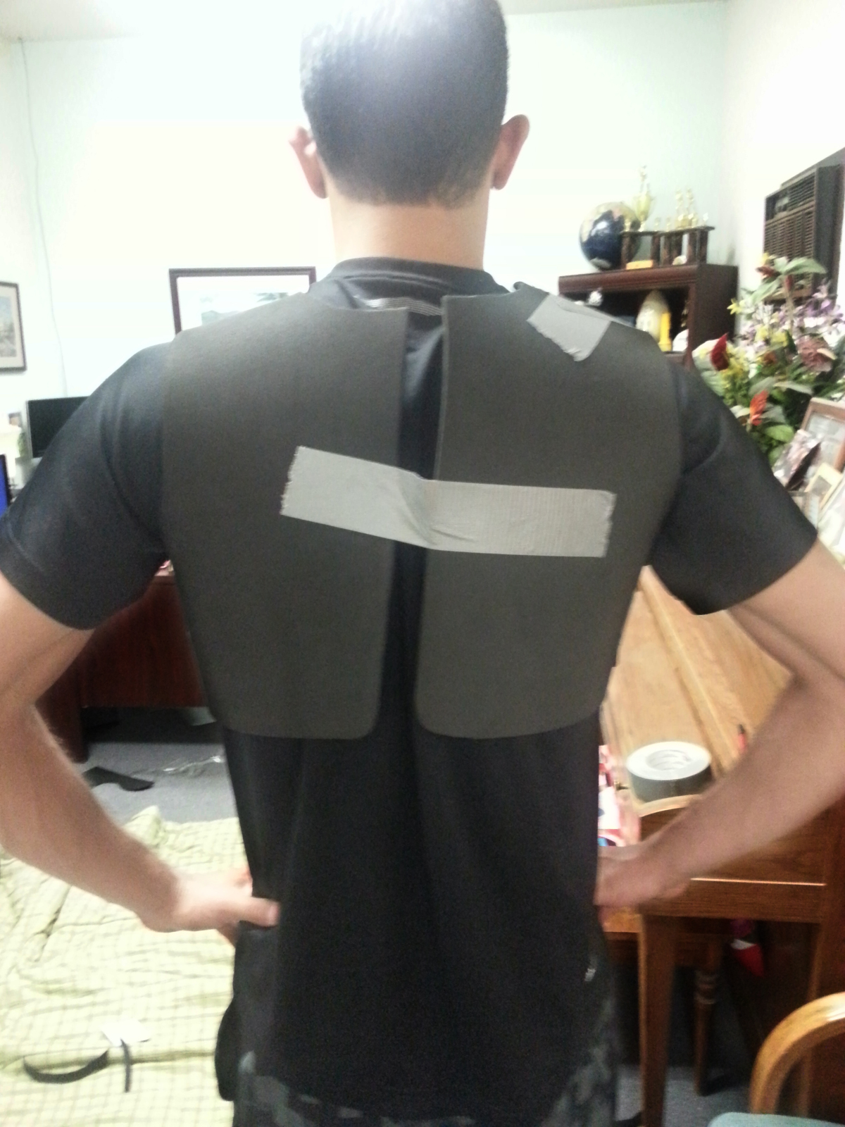

Sorry for double posting but I wanted to share. I worked on the chest last night with my 5mm foam. I had been wondering how I was going to harden it (styrospray, resin, smooth-cast 65D) but this foam is actually already great! It's flexible enough so he could move, but solid enough to hold it's form.
Keep in mind this is not going to be "screen accurate" but it will hopefully still be recognizable.
The duct tape is to hold the pieces temporarily until I have time to sand/smooth the edges and then attach them with hot glue and reinforcement pieces. I thought for 1 hour of work it's a great base for the chest. Probably wont work on this too much tonight as it is his Dad's bday, but tomorrow I will be back with more updates, most likely smoothed edges and at least 1 shoulder piece.

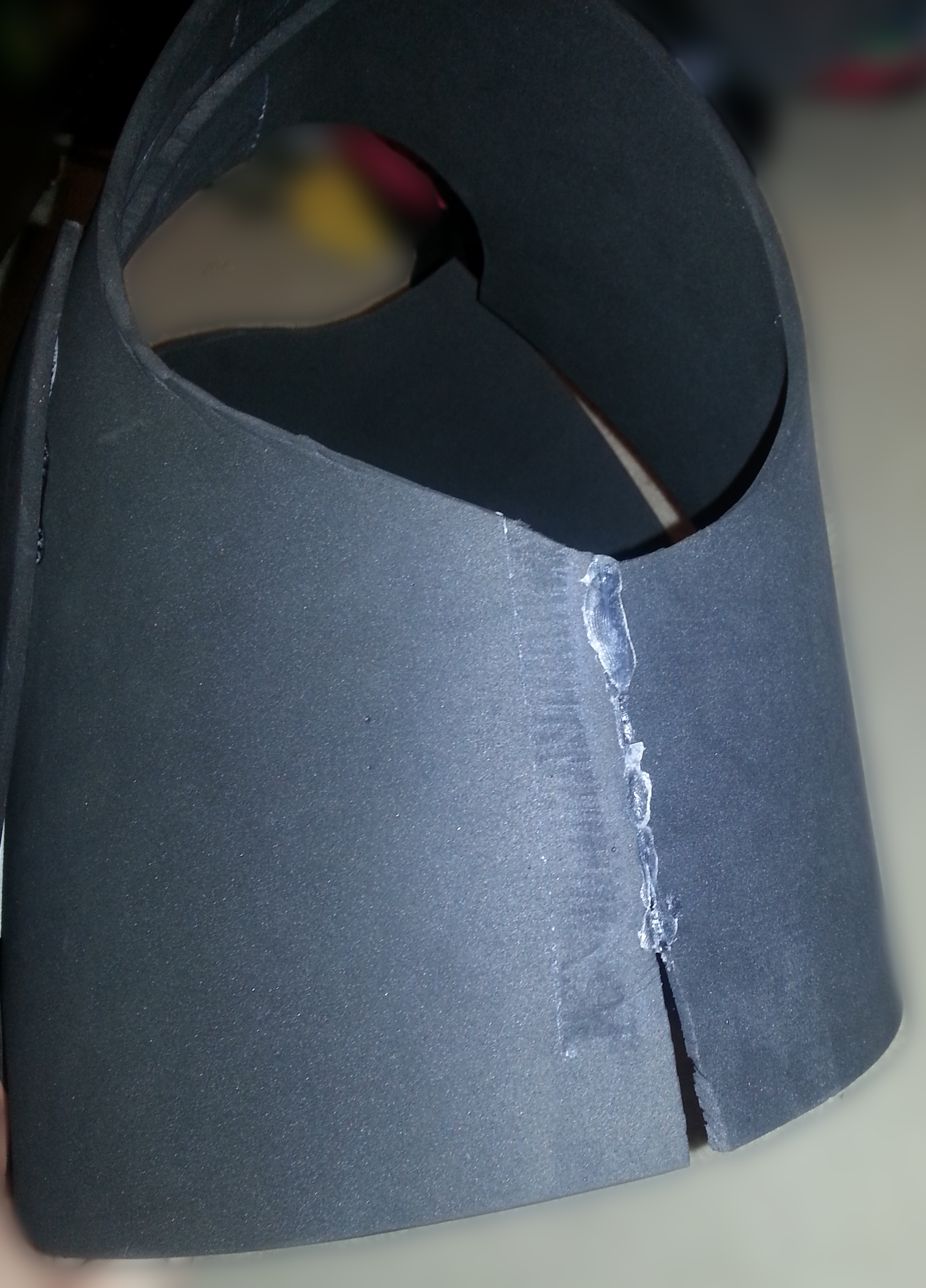

Ok so I found a couple spare moments to work on the chest piece. Keep in mind I'm not worried about seams or how it looks because I will be covering it in faux leather which will cover the imperfections. I trimmed the excess foam pieces and glued them together with hot temp hot glue and used the spare pieces of foam to reinforce the seams.
I left the bottom unglued because of how Hiccup's armor doesn't fully close on the sides as you can see below:
