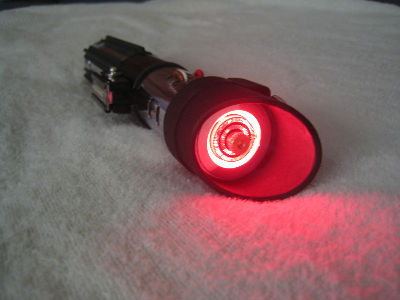

I had forgotten how good those '05 MR ESB FX Vaders were. Easy to convert to in-hilt LED and super accurate for what they were. A real gateway drug that one. Here's mine:
Here's a good thread on that model:
https://www.therpf.com/showthread.php?t=238269
