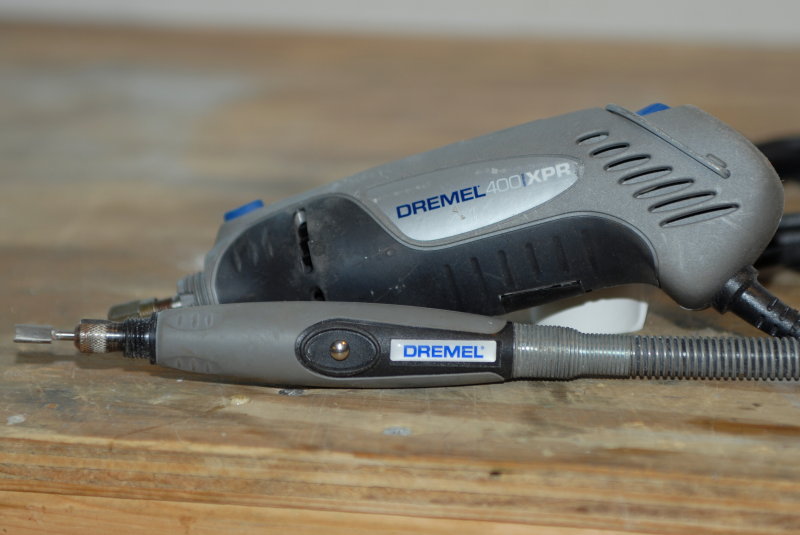

What about a dremel wand attachment with a round ball grinder?
