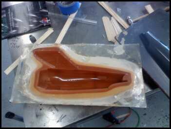

The first shop I worked in used burlap soaked in plaster to make mold shells. They could be upwards of an inch thick or more. Personally, I use polyester reenforced fiberglass.
like this
