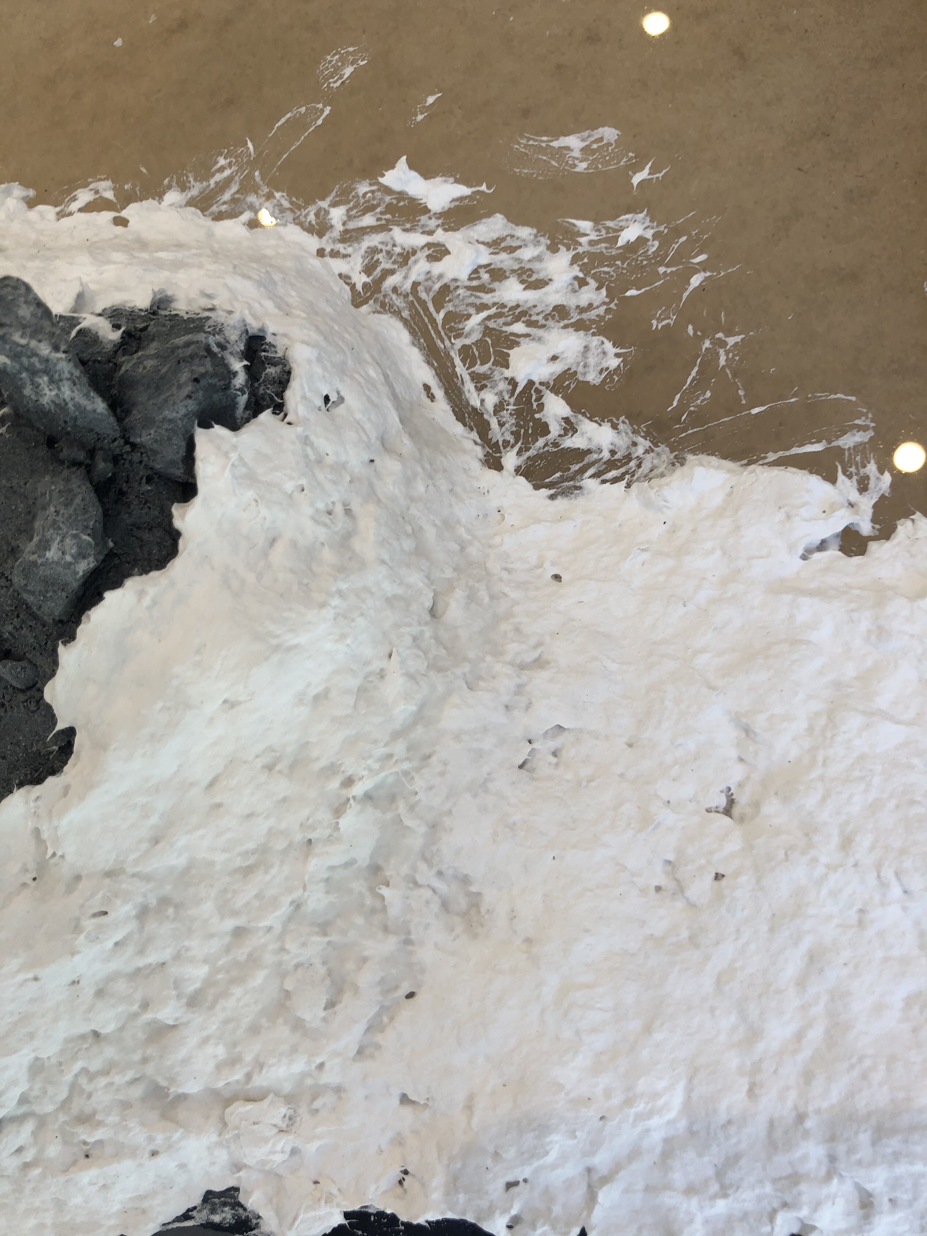

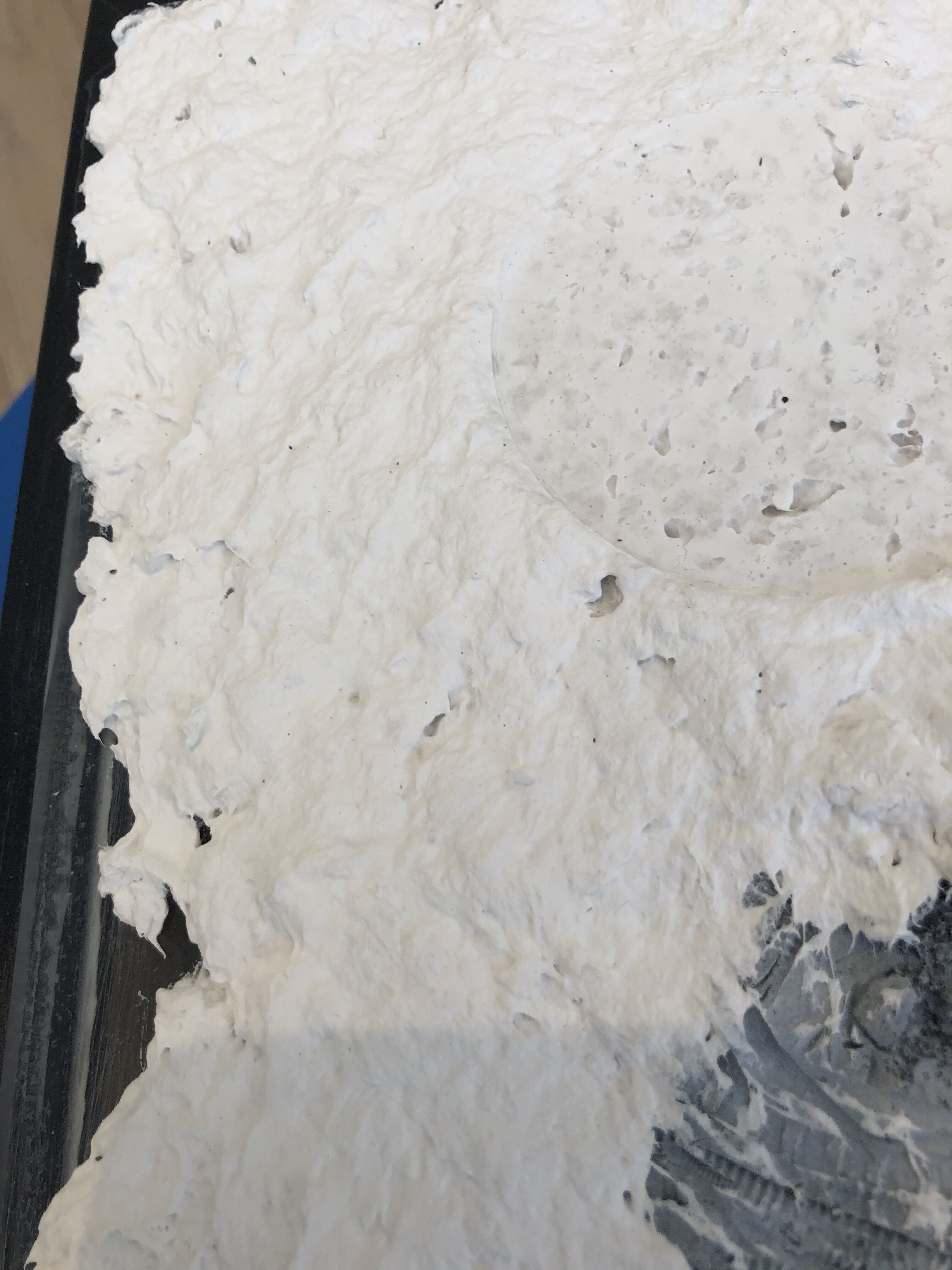

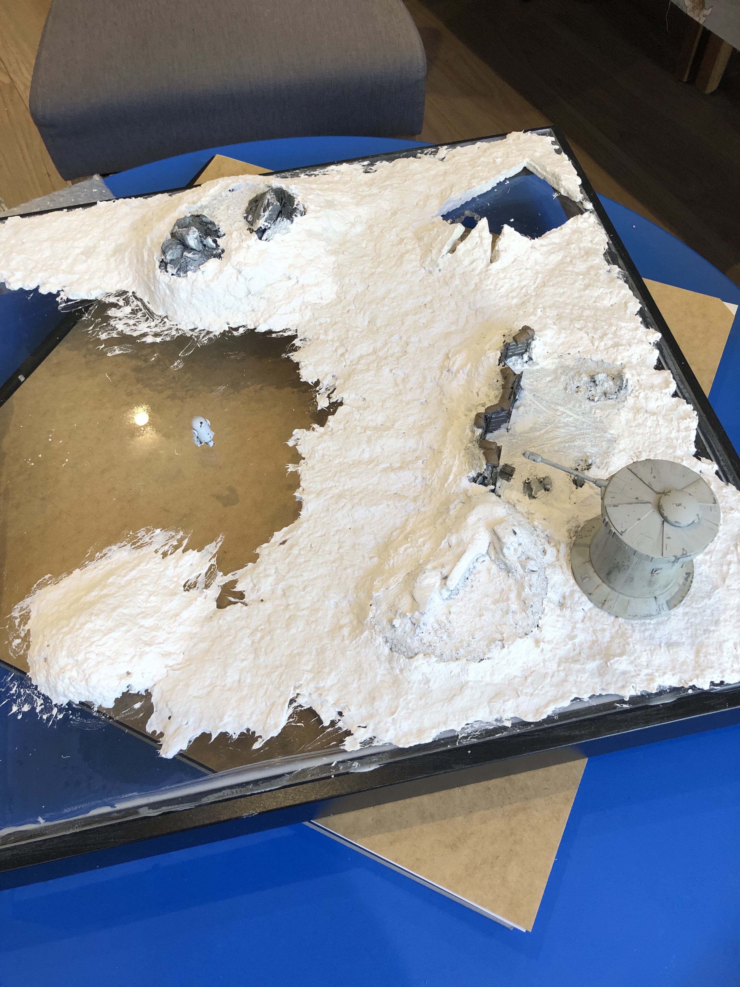

So I’m part way through making a 1/48 diorama of a battle on Hoth (not the one shown in ESB as I didn’t have room for that at this scale).
The diorama is going to be on a 50x50cm base and will likely include the following:
-crashed snowspeeder (Bandai with greenstrawberry photoetch, with led cockpit lighting)
-Flying snowspeeder (Bandai with greenstrawberry photoetch, with led cockpit and laser cannon lighting)
-ATST (Bandai with greenstrawberry photoetch, with led cockpit lighting)
-rebel bunker with 1.4 FD cannon (the one that looks like a radar)
-DF9 turret
-various rebels incl wounded pilot from the snowspeeder, medic, 2 unit, Luke skywalker (not sure how that fits into the storyline, but meh)
-various stormtroopers, probe droid, possibly a K2SO type droid too

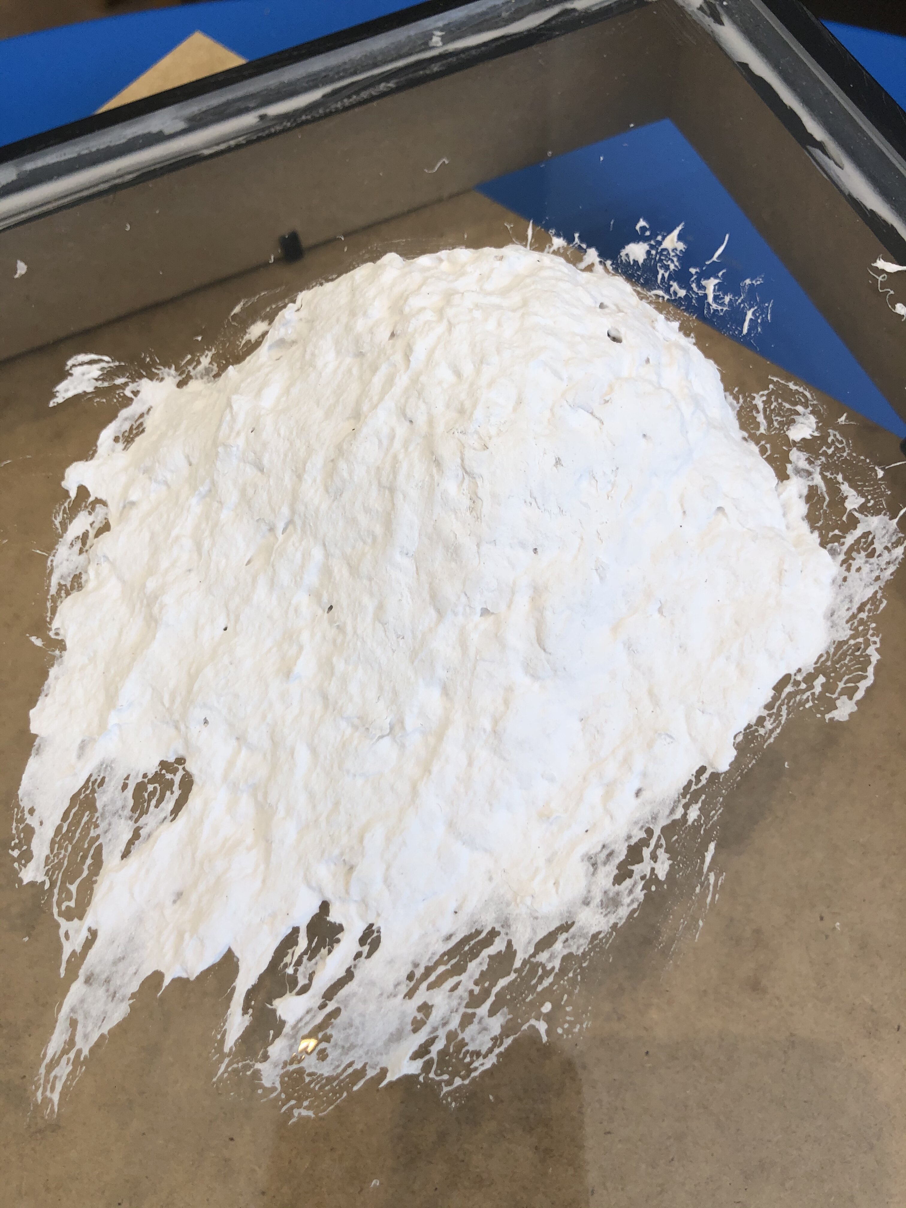

I’ve started putting the base together and I’ve never done snow effects, at least to this extent, before. I’ve used sculptamold to create the terrain so far and I’m planning to use precision ice & snow over the top of it. But before I start sprinkling the (quite expensive) snow on I’d appreciate some input and advice on the snow. I think maybe the base needs to be smoother in order to look realistic at this scale,but I’ve been staring at it so long I can’t really tell any more! What do you guys think? And if you think it needs to be smoothed out, does anyone have any tips or techniques for what to use to do that? For scale there is a DF9 turret in the third photo, and an R2 in the centre of the same photo.

I think the texture there is good for the traveled parts or the parts where snow was shoveled or blown onto the clear paths. Where there is less activity in places where people aren't likely to walk or move snow to I think it should be smoother. The contrast of the two I think will help with the realism
like here, surrounding the trench the snow is pretty well roughed up, but as you get away from the trench and a 5 to 6 feet in front you get more smooth and pristine snow with an occasional trail

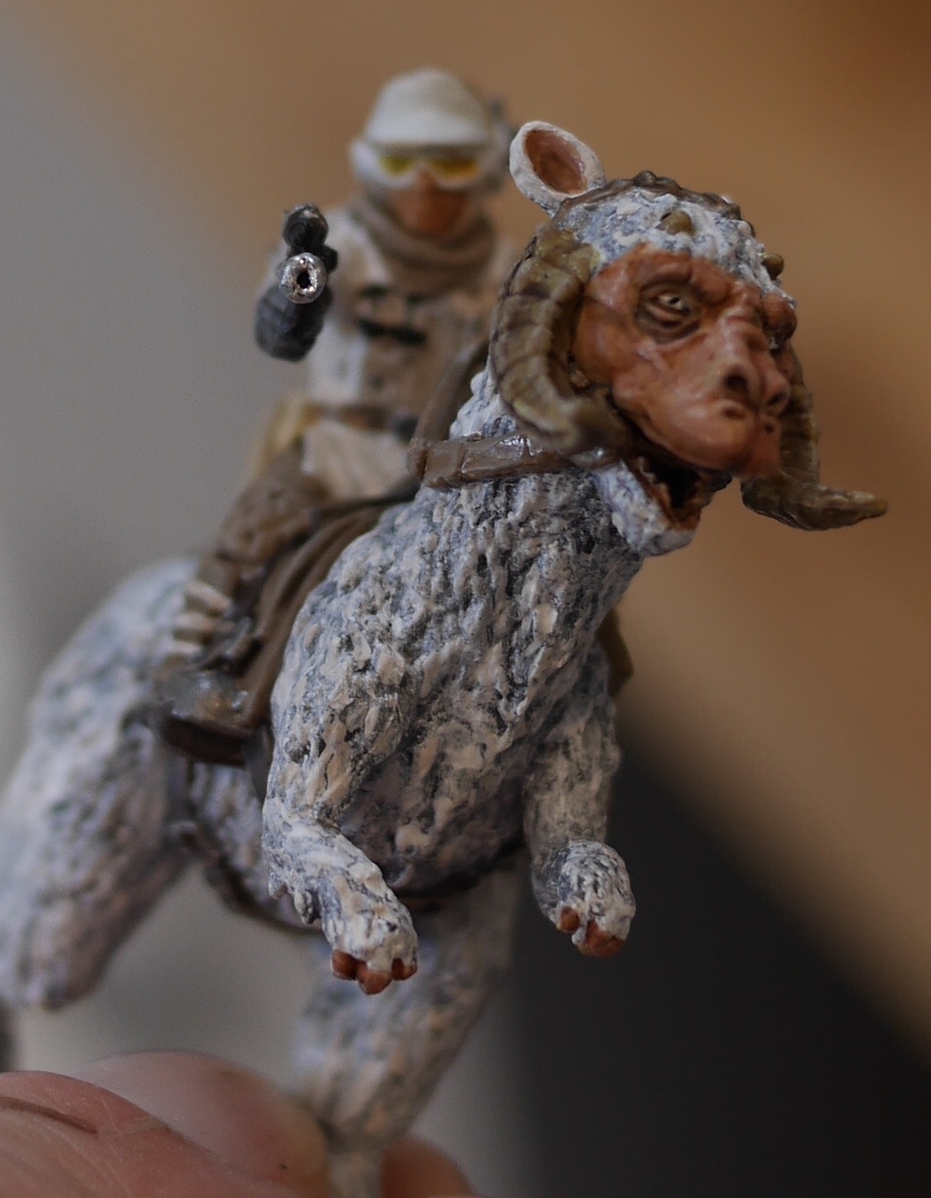

I actually already have the Legion tauntauns (sneak preview attached) but I just don't know yet whether I will include one as I think this diorama could get pretty crowded.
NKG - those look great - I have so far got a mix of Legion, Skull Forge Studios and Mel's Miniatures (the latter two from Shapeways) but I was struggling for snow troopers, as the legion ones don't look that realistic. I was going to use normal stormtroopers instead, but those Shapeways ones look perfect. The only problem is I can see there being a bit of a mismatch in sizes between figures. The Bandai 1/48 figures are noticably smaller than the legion ones. So far I have planned to keep them far enough away from each other so its not too obvious, but if these snow troopers are much smaller than the rebels it might look weird.

The Tauntaun rider looks great
As far as the Holden Shapeways figures, they are going to be closer in size to the Bandai 1/48 than the Star Wars legion figures. The Legion stuff is more like 1/46 scale on average, although a few things bigger or smaller. The other thing with the Star Wars Legion stuff is that since they are gaming miniatures, they tend to be a little "beefier" or "thicker" than more realistic proportions of the scale model figures. They typically look good enough paired with 1/48 vehicles (and oddly enough, the Bandai 1/48 speeder is actually bigger than the Star Wars Legion one, but it is the opposite with the AT-ST

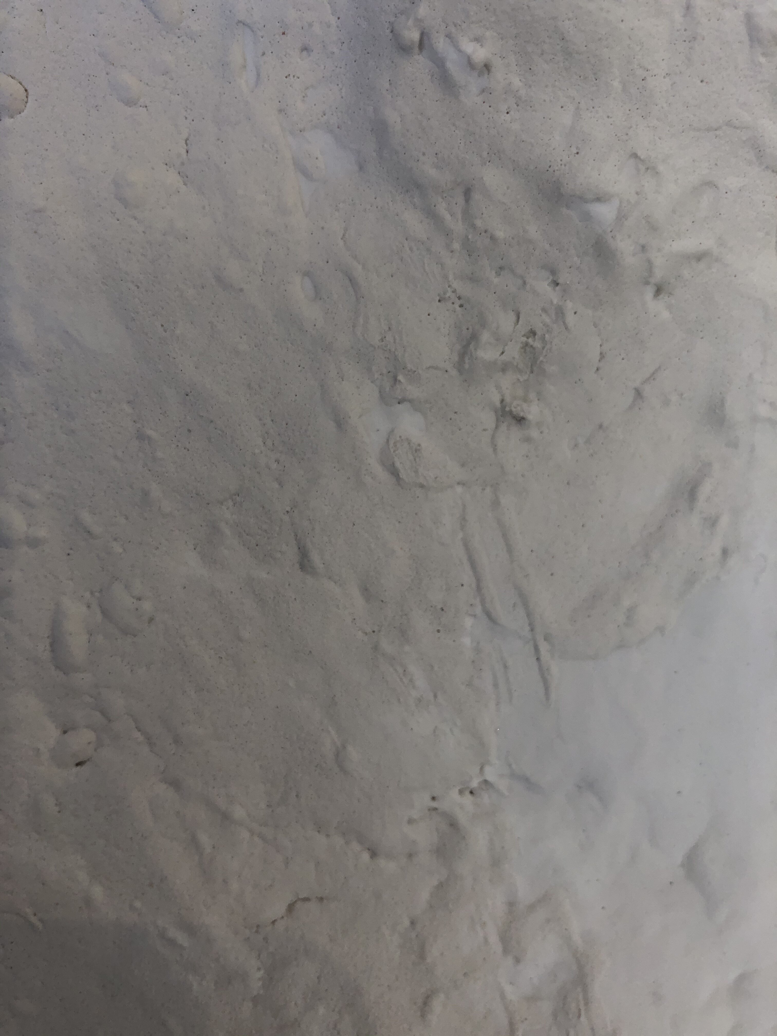

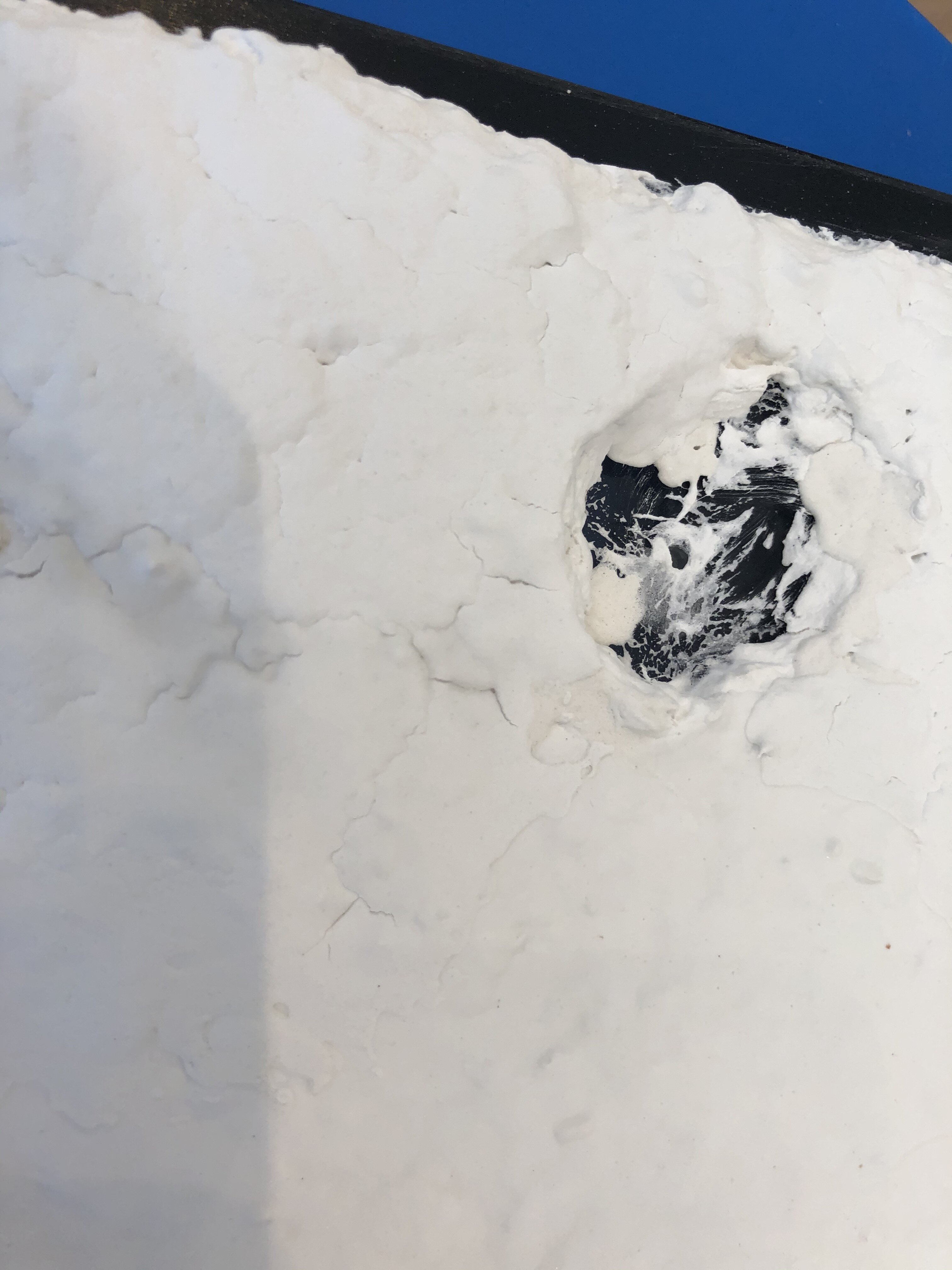

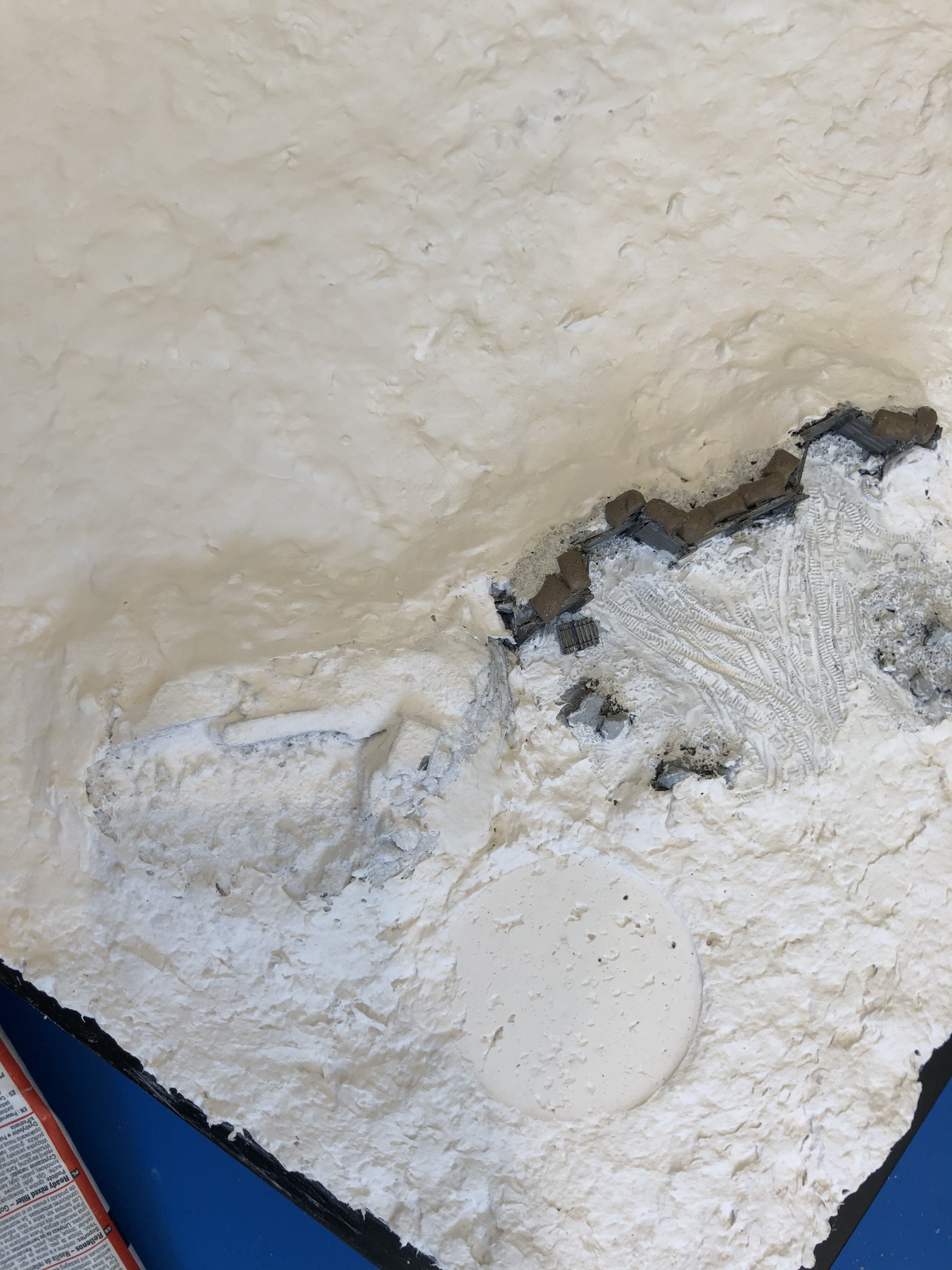

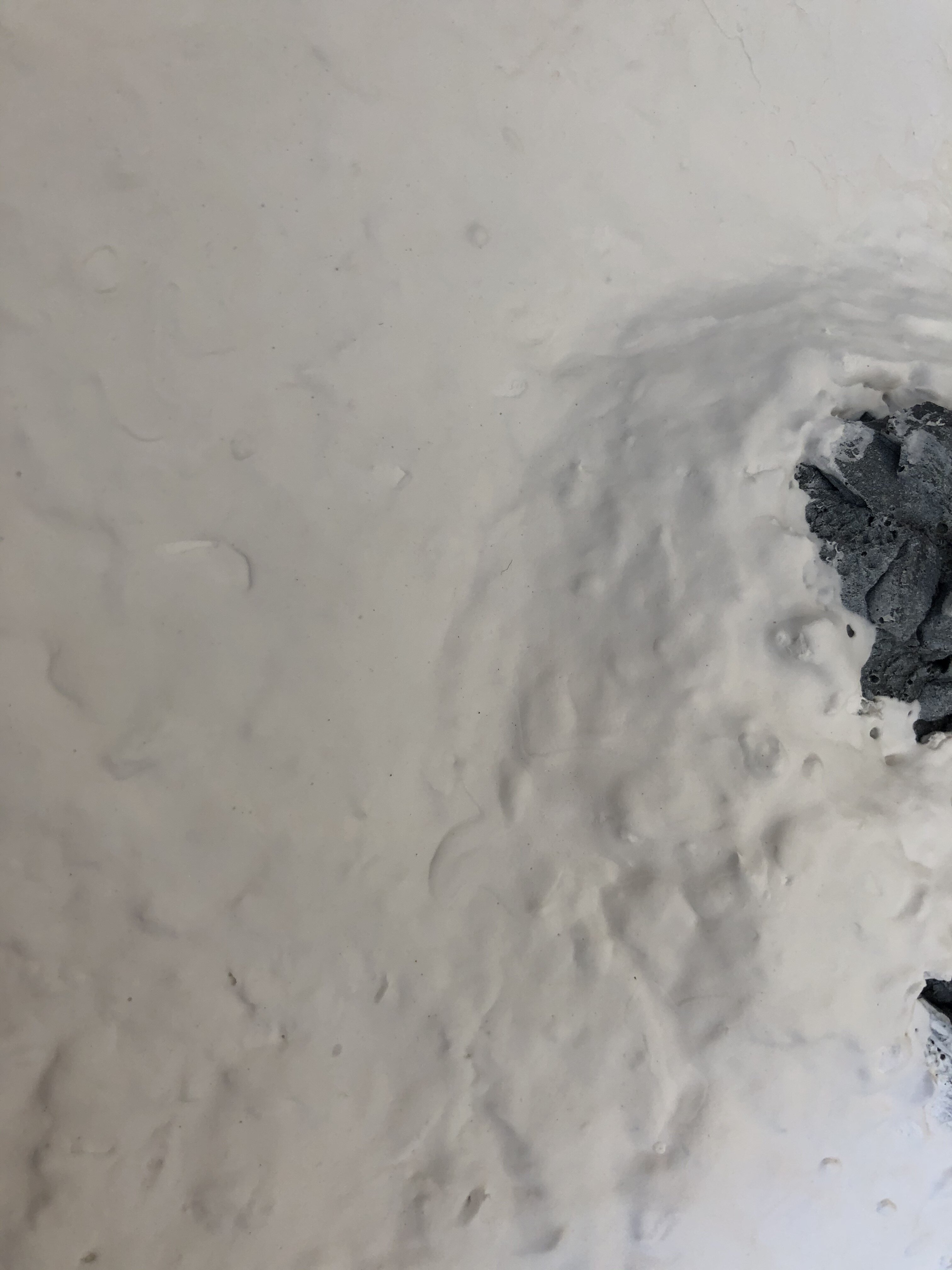

Fun in the snow - the sculptamold is finally dry, so I had a go at smoothing out most of the snow areas. I tried plaster of Paris but that wasn't working at all, so I got some exterior wall filler and watered it down, and kind of poured it on.
I think it worked really well, until I ran out of that tube and decided to use some other filler which I had lying around. It was a much rougher texture when dried.
So I tried a 'super fine' filler on top of that, and it dried a bit weird and cracked.
This last photo shows the difference between the smoothed out snow in front of the bunker and the roughed up snow behind it.
All in all I think it's looking OK. I can't decide whether to go back over the slightly cracked bits and the bits with the slightly sandy texture, or whether that will be hidden when I finally pour on the precision snow.
Jimw100
Ha, yeah my fallback plan was "pretend it's supposed to be like that".
