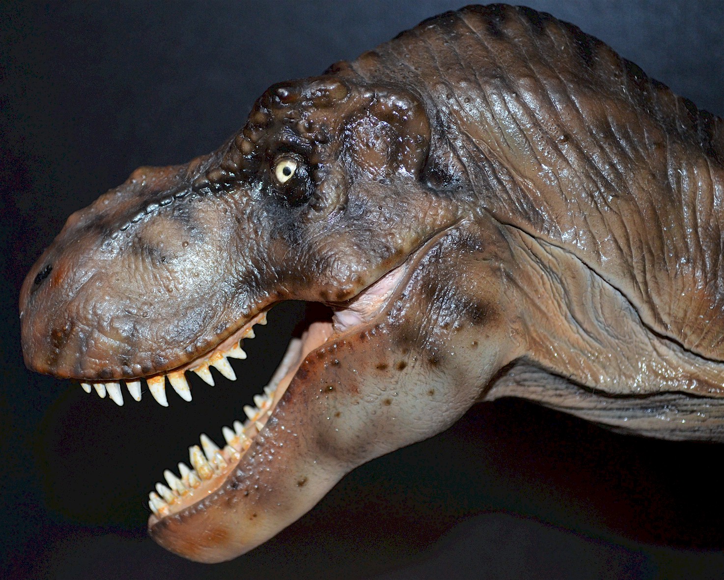

The eye size I used in my Horizon T-Rex model, was an inexpensive pair of 5ᵐᵐ or 6ᵐᵐ pale yellow glass eyes. I believe I got them from Van Dyke's at the time, but you can order them directly from Tohickon Glass Eyes. https://www.tohickonglasseyes.com/home.asp
The eyes were installed from the rear side of the head. The socket was drilled out and shaped using a Dremel Motor Tool, and when the eyes set well, Ave's sculpting epoxy was used to hold them in place. This one was built in 1993, right after I saw the movie!
These eyes are flat backed, without wires ...
https://www.tohickonglasseyes.com/shopproductdetail.asp?prodID=53&catID=1
These are the eyes on wires. These handle a bit easier because of the wires.
https://www.tohickonglasseyes.com/shopproductdetail.asp?prodID=49&catID=1
For Velociraptors with slit pupils - as seen in the movie - they sell Reptile and Amphibian eyes that are second to none! https://www.tohickonglasseyes.com/shopproductdetail.asp?prodID=32&catID=16
This is a Leopard Frog eye ...
Hope this helps!
