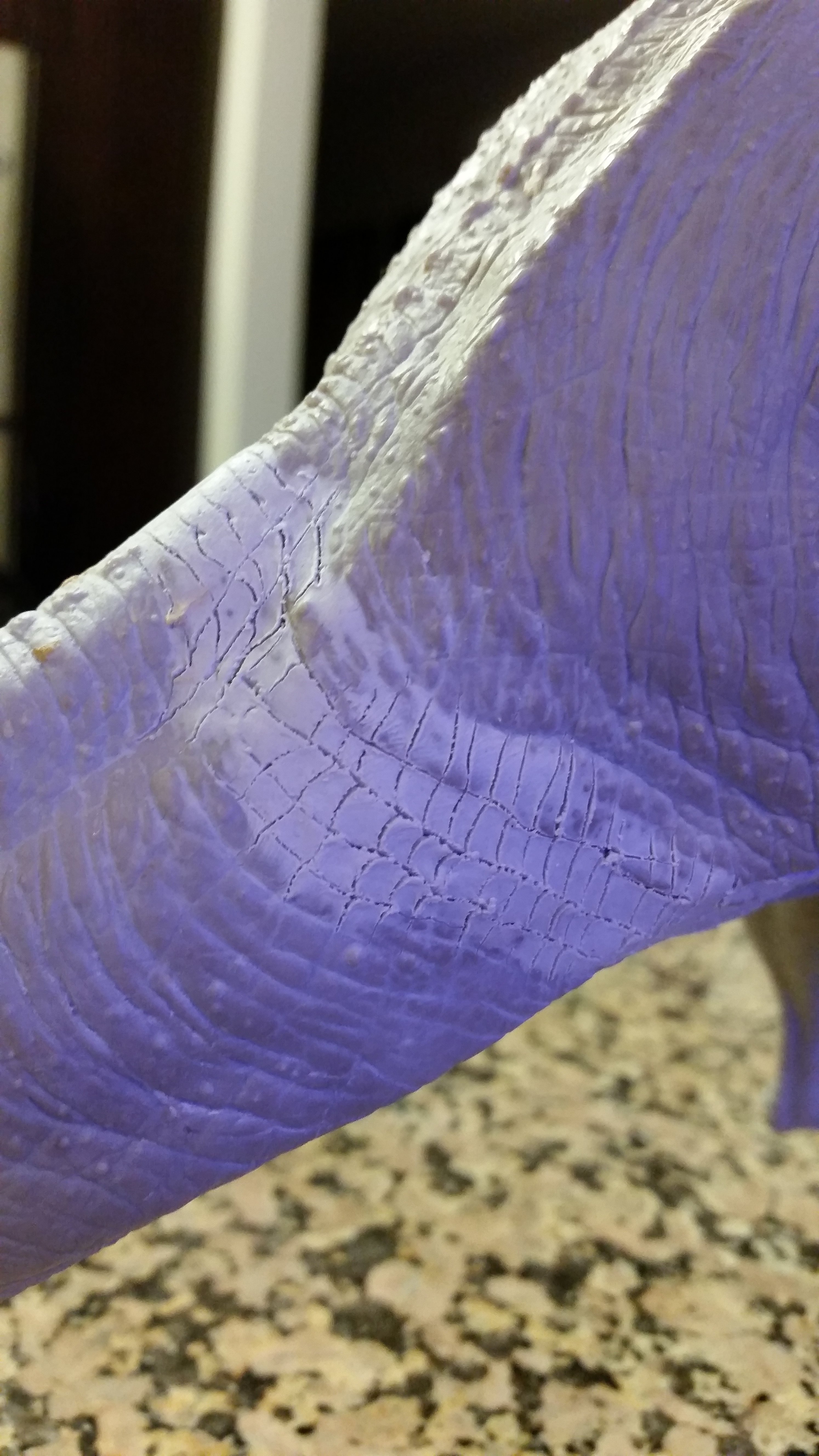

    Finally, a question to everyone out there. The body is hollow. I was thinking it might be a good idea to fill the body with something to give it some more weight, which will also help it be sturdy. Does anyone have any suggestions as what I should consider filling the body with?!
    [​IMG]
    I need to order that Aves sculpt still, but looking at the lines, I am very nervous to use it! Not that it won't do the job, I just don't know how to use it....and if those gaps are filled well, then it will show through the paint. So hopefully, it goes easier than I expect.

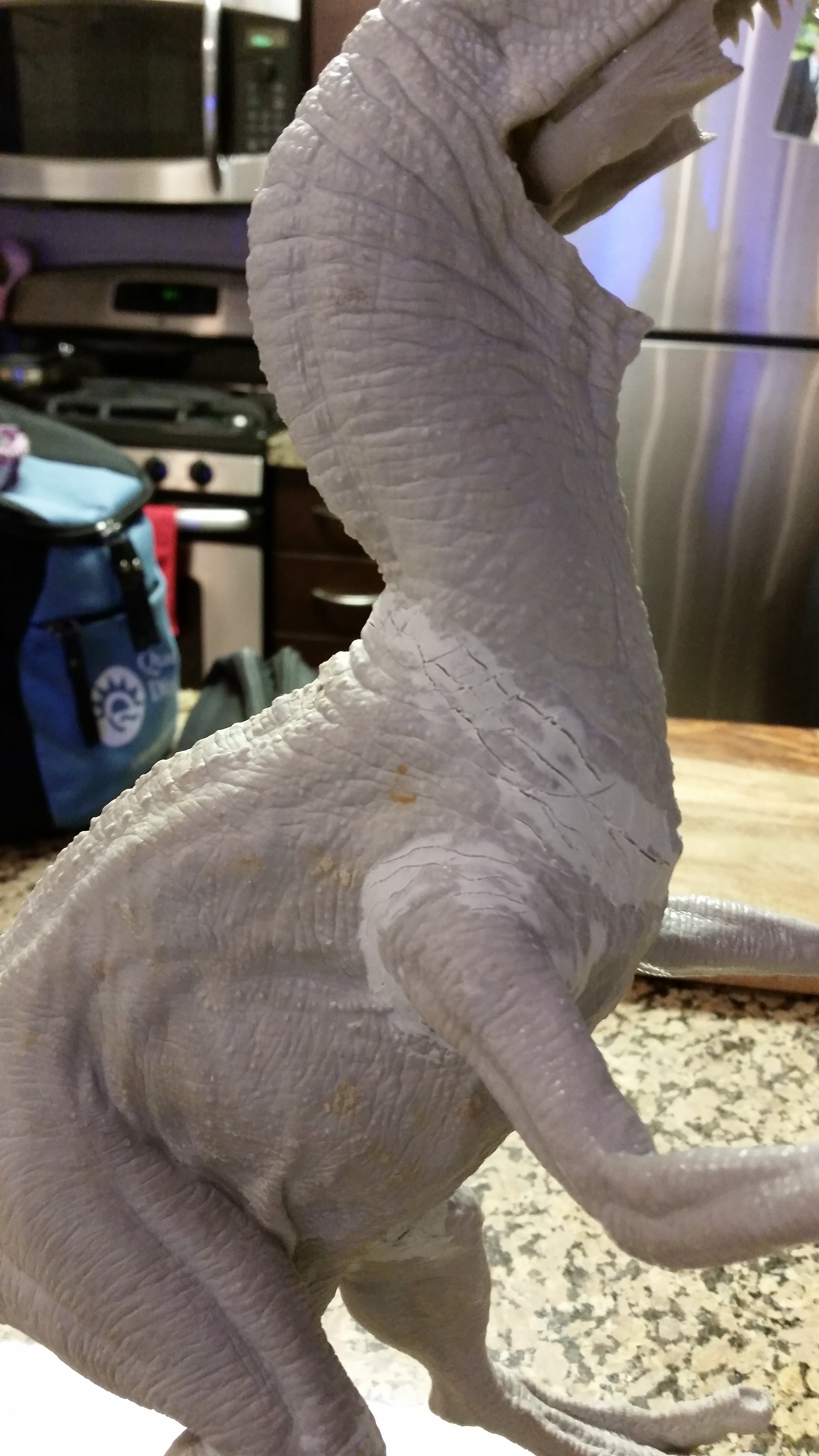

    So today I got my apoxie sculpt. Never used anything like it before and I have never worked with clay. I was very concerned how it would come out, but started with the bigger gaps and worked towards the smaller gaps. Overall, I am very very pleased with how it came out. It may not be perfect, but I think with some light sanding it'll be very hard to tell it from the original vinyl. I did my best with the details, and again, not perfect....but I am happy with it. I will attach some photos! uploadfromtaptalk1433565870559.jpg uploadfromtaptalk1433565904212.jpg uploadfromtaptalk1433565919905.jpg uploadfromtaptalk1433565933230.jpg uploadfromtaptalk1433565948857.jpg uploadfromtaptalk1433565963410.jpg
