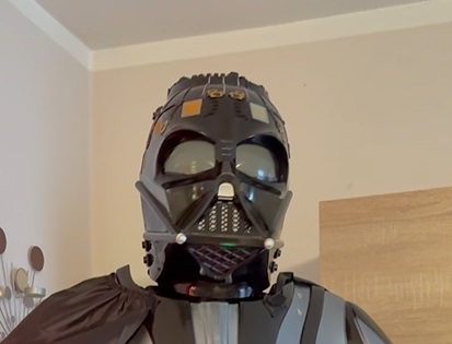

I’ll see if I can explain clearly in just text, as I didn’t take any pictures of the assembly (I woke up eager to get it done, ha),
Luckily, the head of the animatronic doesn’t have any moving parts itself. So all that is needed is to remove the four screws that attached the head to the metal bracket.
I then took and old plastic paper towel holder I had lying around, and affixed that to the metal bracket.
Then stuck a styrofoam head on the stick of the paper towel holder (both of which I had to cut a bit shorter), and hot glued it into place.
The original head had a neck “skirt” that I then glued around the base of the paper towel holder. Reattached the whole assembly to the body. I didn’t want to plastic Jazwares helmet to have direct contact with the styrofoam head, as I was worried they would bond or melt to each other over time. So I stretched a black beanie over the whole head before placing the helmet on.
Now I have it working just like the original, but with nothing destructive done to the helmet or animatronic. If I so wished, I could take it all apart and go back to how I started.

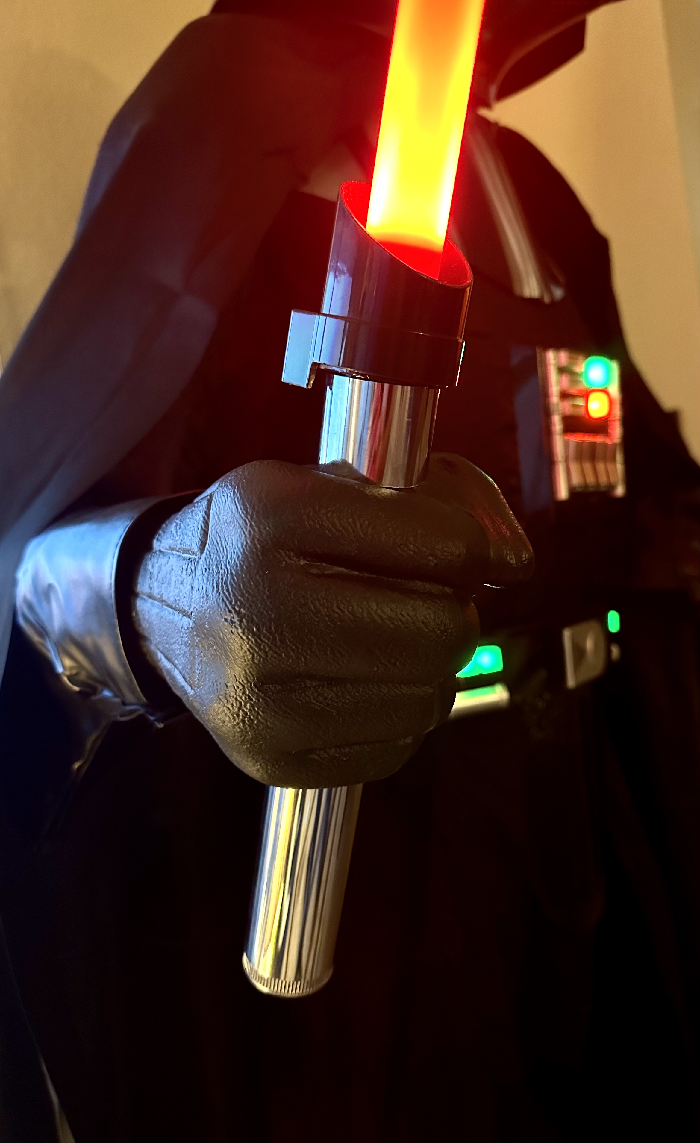

Working on upgrading the lightsaber. It’s a little tricky because I don’t want to add too much weight. But so far so good. The helmet and the lightsaber were the two worst things about this, so I’m pretty pleased.

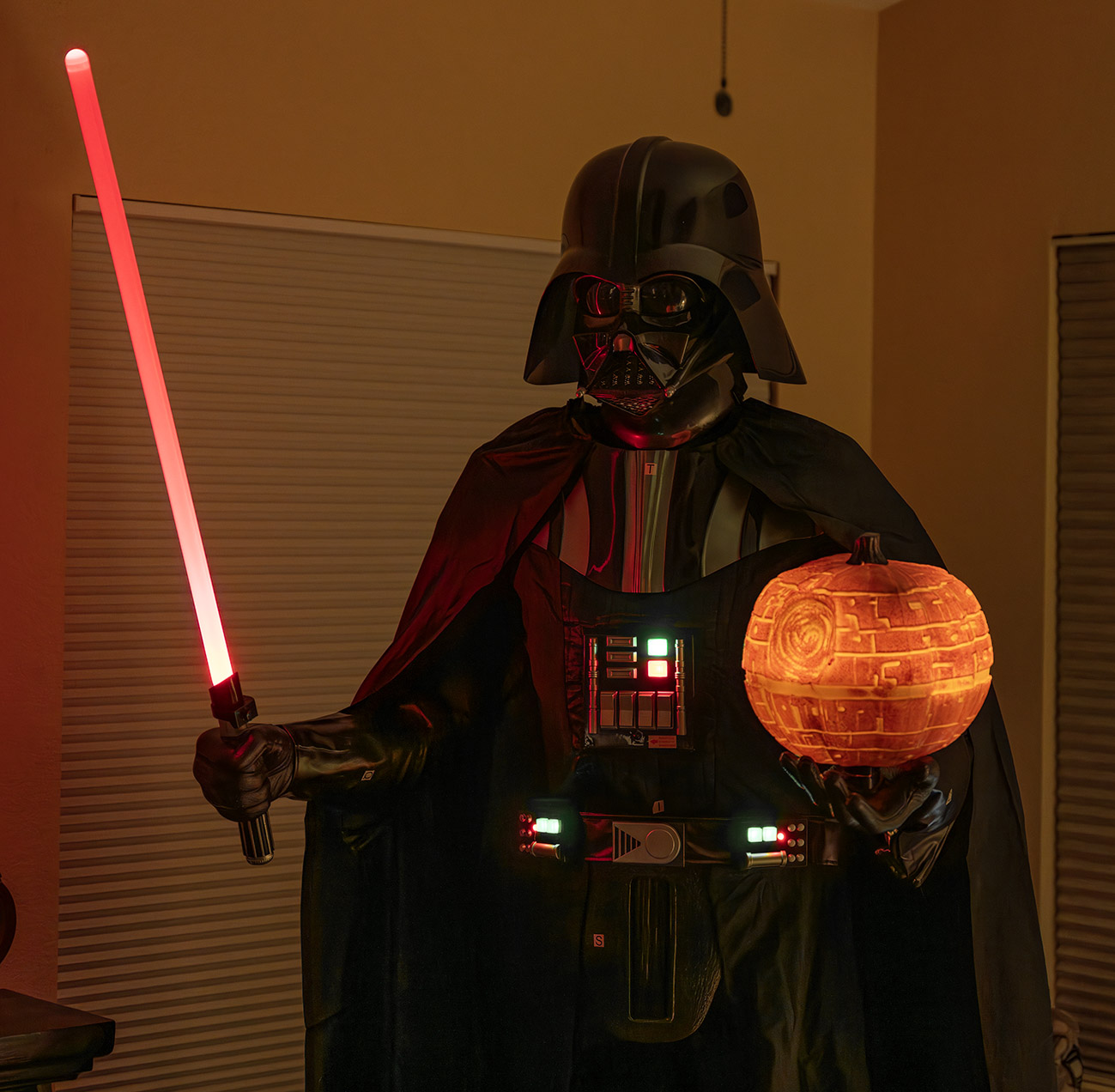

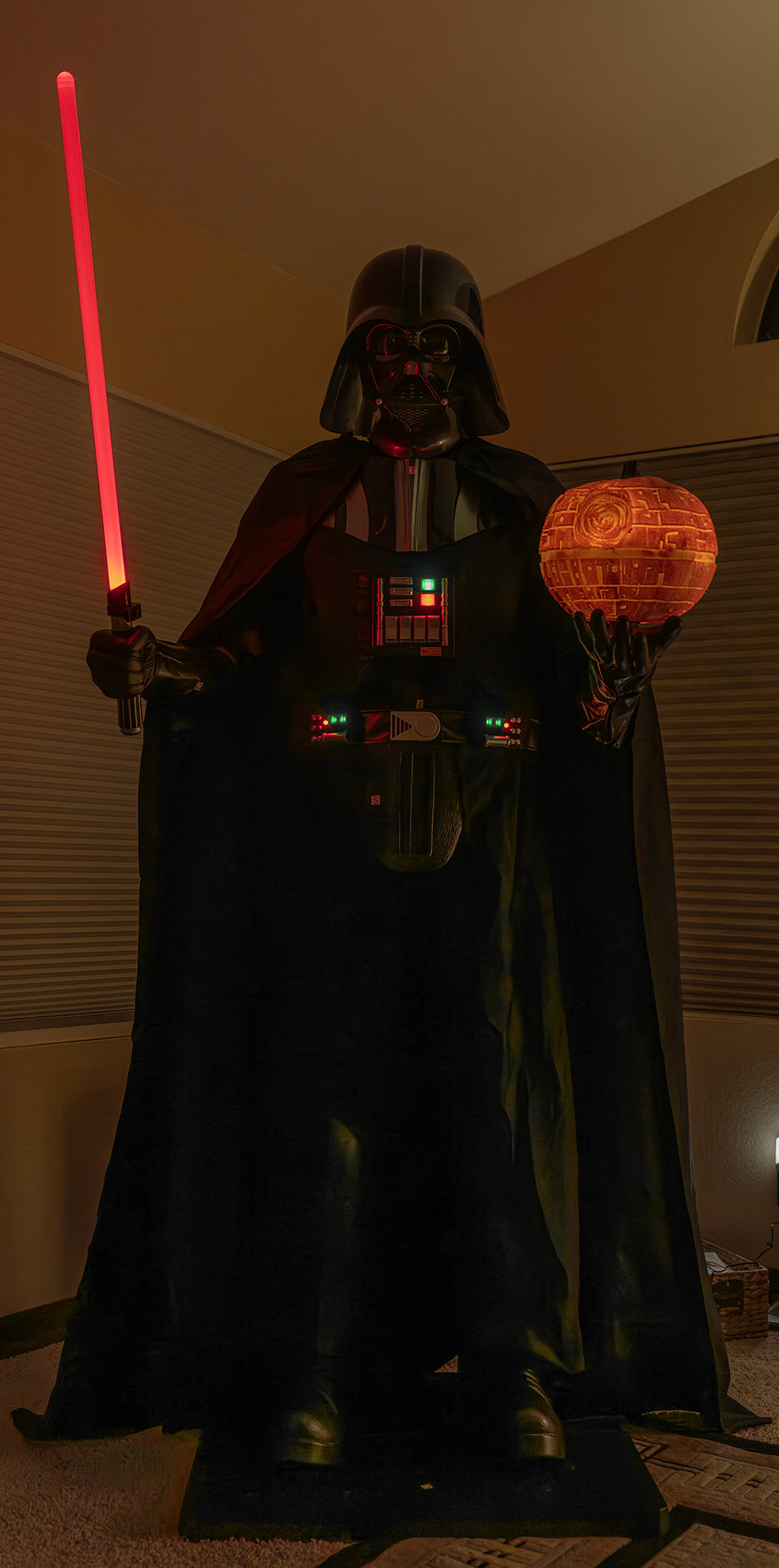

I’ve done more work on this guy. Today I steamed the bodysuit to get rid of the wrinkles that were driving me crazy, and stuffed the arms and legs with extra foam to fill them out more. The lightsaber has gotten some major upgrades as well. I made vinyl decals the serve at the ports on the MPP. Will be swapping out the chest and belt boxes soon.
Looks amazing!!! How did you get the left arm pointing down? Also how did you update the lighstaber? I havent done anything yet, im petrified to ruin it
Thanks! The left arm is just a metal bar, so I very carefully bent and twisted it. For the lightsaber, I used a chrome sink tube cut to a shape that fits over the (ground down) existing saber. I used as many lightweight parts from toy and 3D printed sabers as I could. It’s far from accurate, but also far better than what it came with. And in general, this will always have inaccuracies overall. I’m trying to find a balance between upgrading parts, but also keeping the cost relatively low. After all, if I was willing to drop major money, I would have just started from scratch on a 100% screen accurate Vader.
