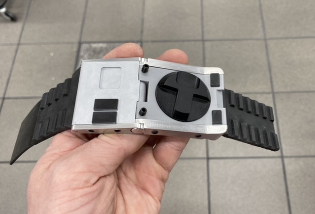

A shot at the underside of the watch, as I want to do this as a working watch with a red light from the projector, I had to build a battery in to the body and needed a battery lid. And inside had to be made the complicated way because I want to be able to turn the projector 360 deg so that had to work with the LED and the battery inside.
Note: Above picture don’t have a polished surface on the sidebars yet.
Final test fit, and only missing the Velcro on the strap, a small aluminum panel to cover the “hinge” and the electronics inside. But that will be done when I have the time.
