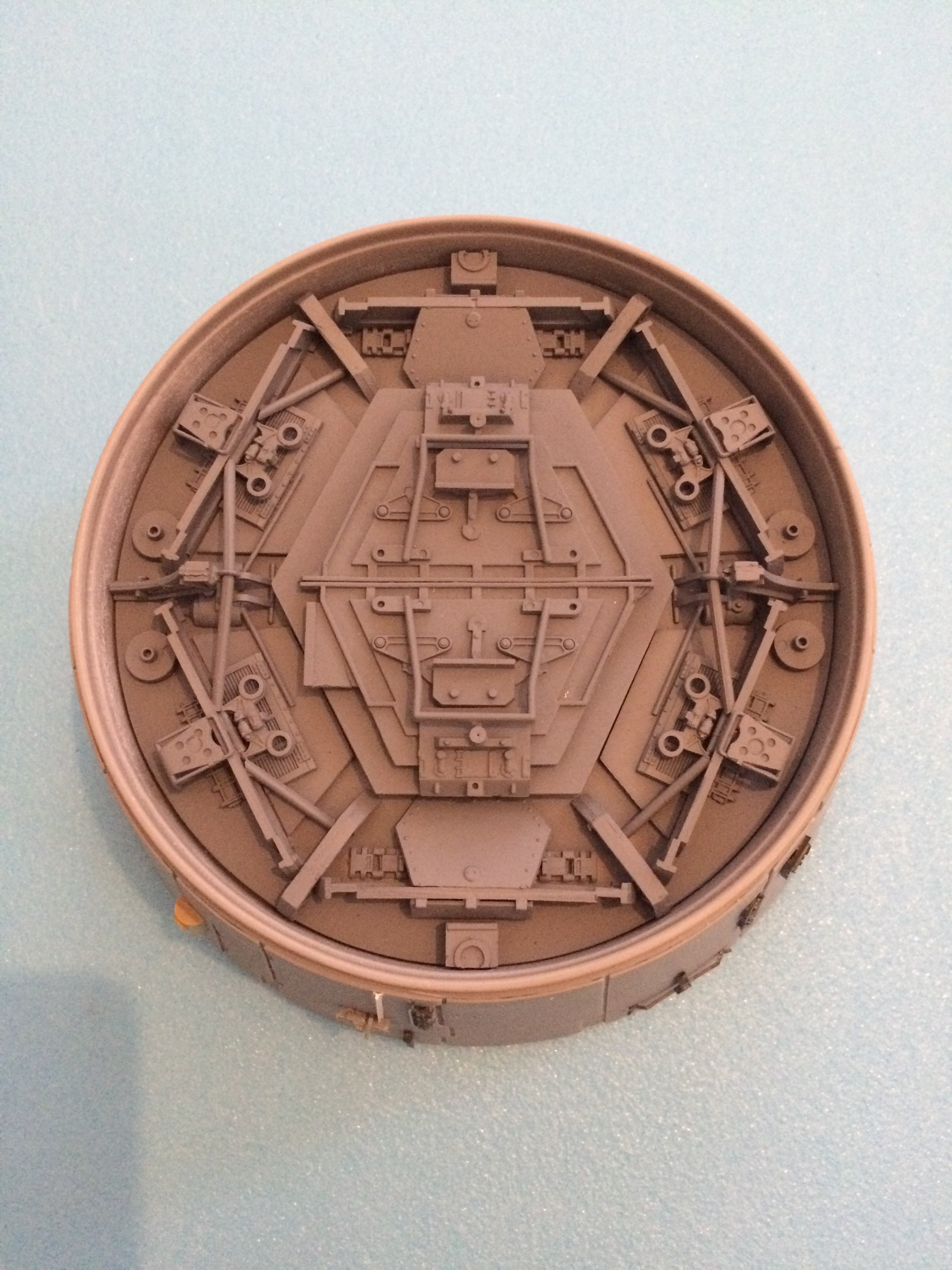

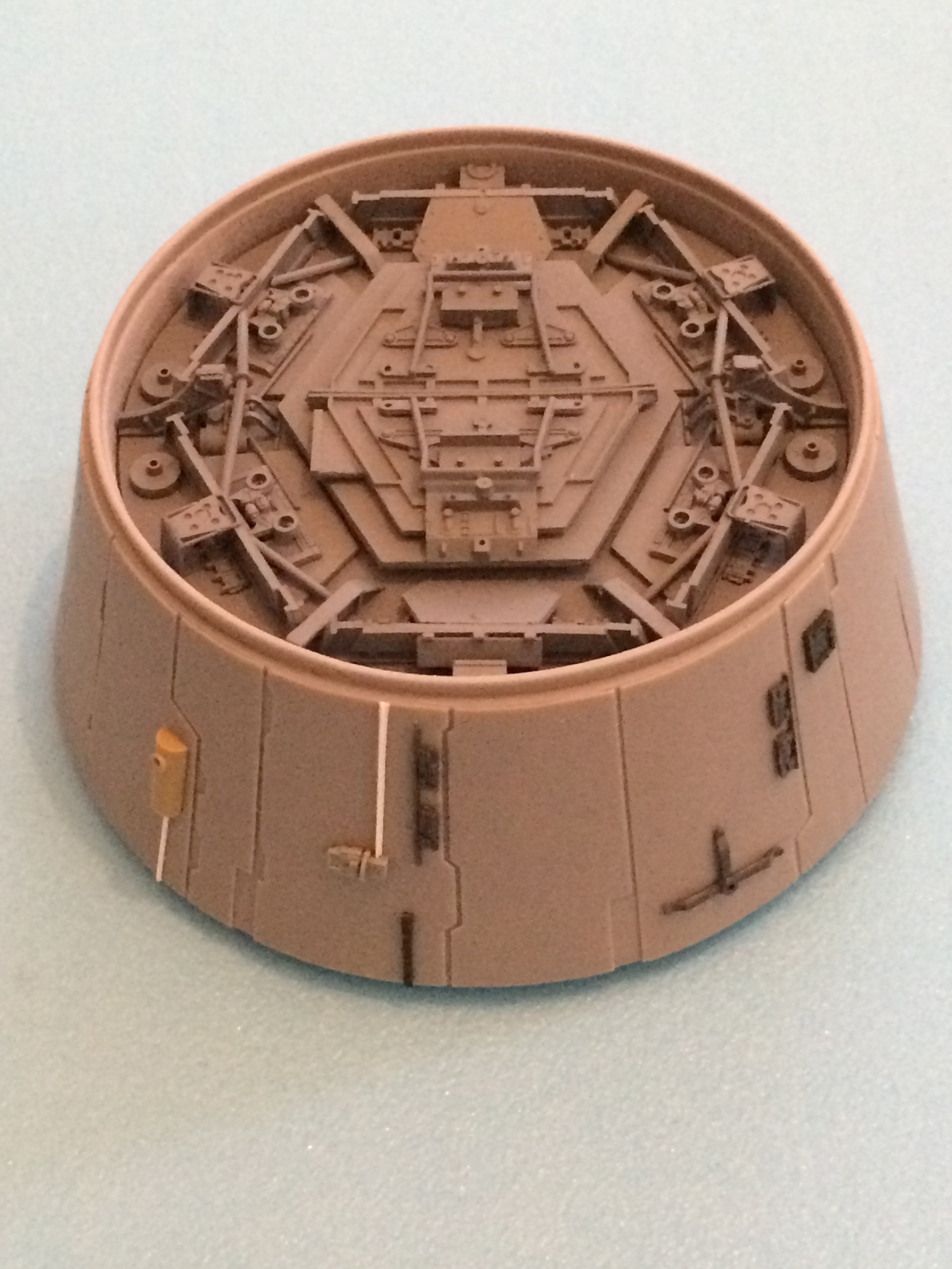

If there is any left, I’d be very interested. Trying to finish up my 5ft Falcon Docking rings. Need 2 small pieces. If anyone has any to spare, please let me know. Willing to pay whatever!

Those docking rings look great, nice to see more being built!.

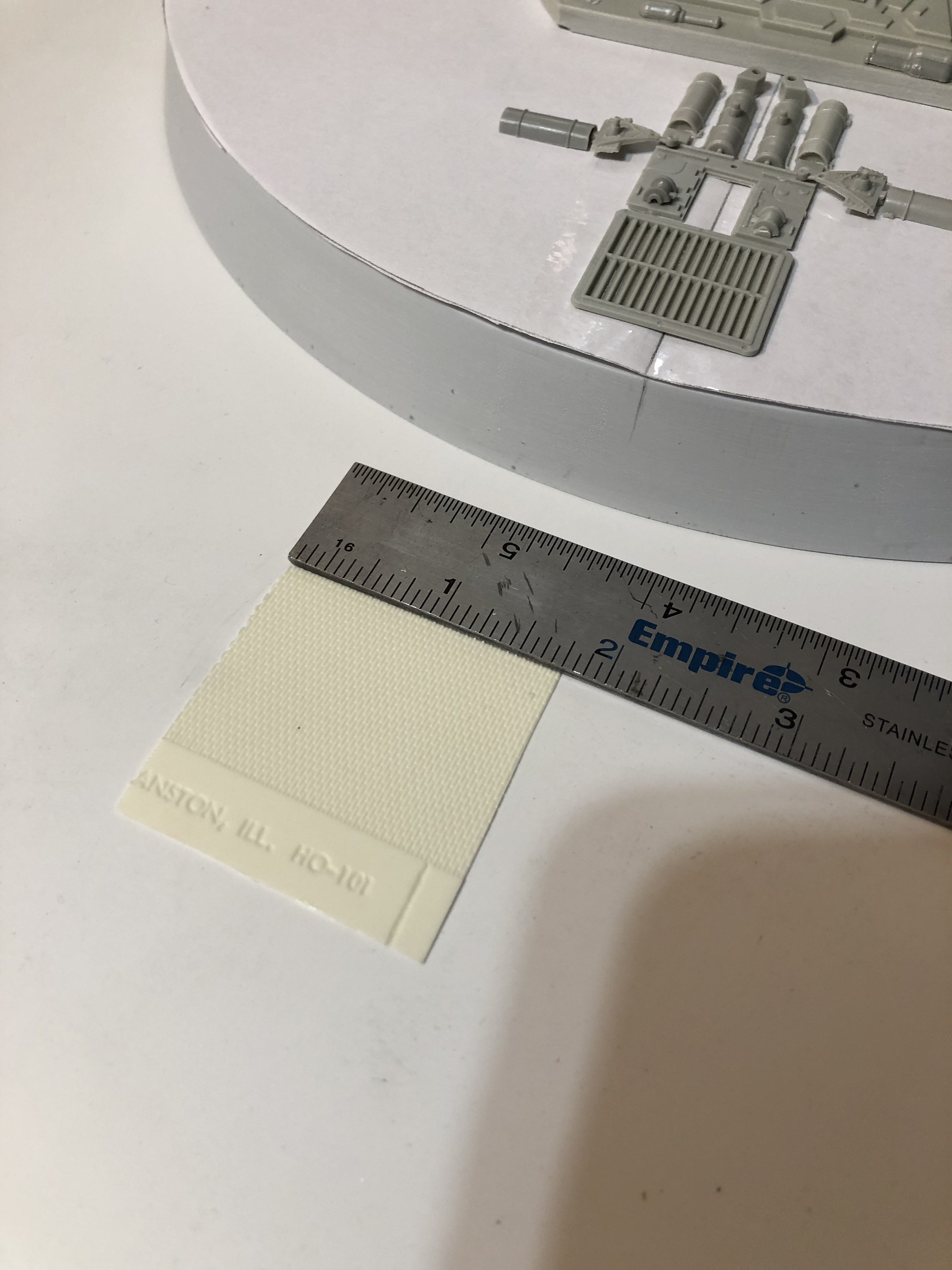

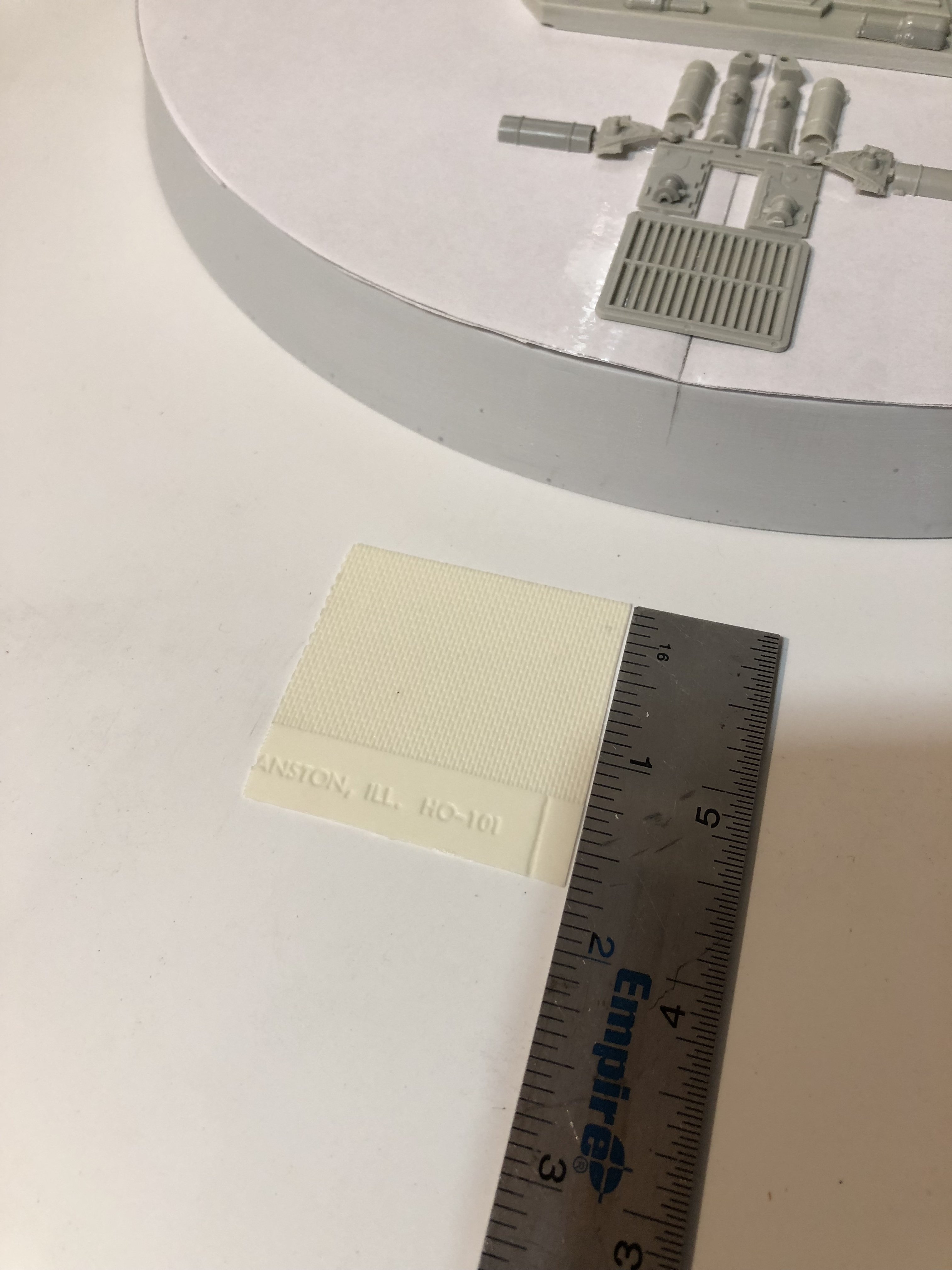

When I was hunting for this brick last year I came across a “Mom and Pop” Hobby Store not too far from me. I ask if they had any and sure enough...they did! ...BUT...they would not part with it, of course. He did offer me an interesting resin copy of it that looked absolutely amazing. I was lucky to get some real stuff for my Build and now comparing the 2....it’s dead on accurate. It is PAPER THIN, both sides indented, etc. The Piece even has the “HO-101” on it. He charged me $10 for it, which, I had to think a little about it, but considering the ending auction price I just saw on junk-bay for this stuff, it is a good alternative. I would have surely used it if I didn’t score a piece for my docking rings. Attaching some pics.....
