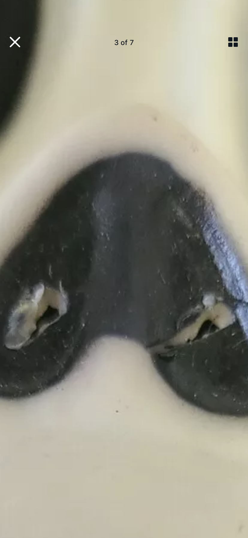

It’s too small “air holes” that were cut in the mask. It’s an old soft pvc / rubber mask. Like the old scream/ghostface masks.
Darth Lars
That looks like it needs to be filled. I would use epoxy or epoxy putty. I would avoid auto-body filler putty made with polyester as those doesn't adhere as well as epoxy does. (I think Loctite makes both types)
First clean with alcohol. I would use packing tape behind the hole to prevent the putty from spilling out the other side.
Try to fill the holes perfectly the first time. Epoxy-putties can often be smoothened with a litte bit of water if necessary.
Then repaint the black nose after the putty has cured.
