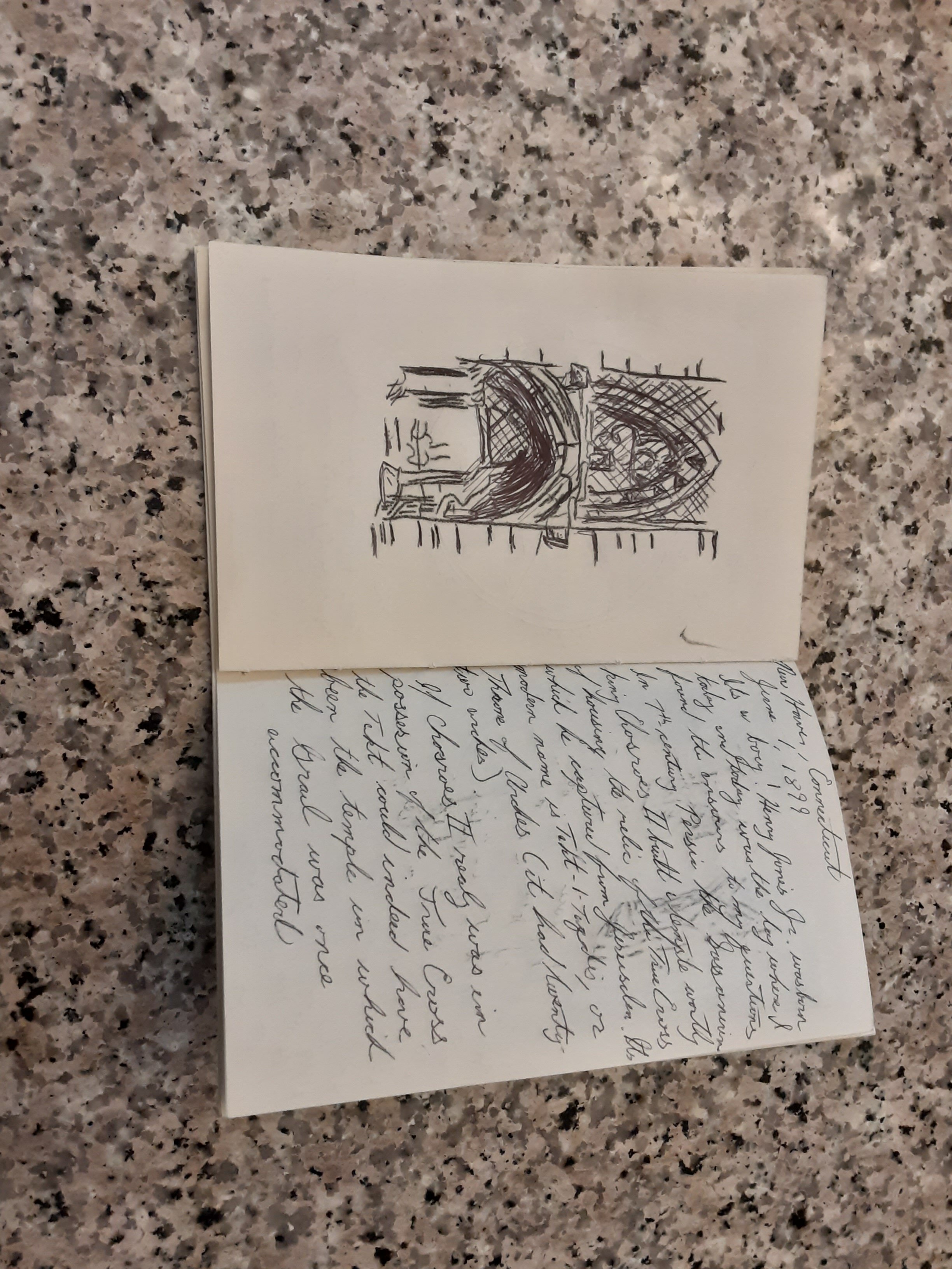

So I did my research, found the inserts, printed my pages and began trying to put order to the book. I bought the kit from a seller on Etsy but there are no instructions. I got the typical it's so easy, just do this response from the seller. Oh well, back to the drawing board.
The good side of it is, I decided not to use the print outs, but to hand write the book. Going off my experience with the Abner Diary, I decided to follow parts of the build a little different. It's much easier to write in pages out of the book rather than in them. I'm a lefty so I always struggle on the right hand side of any book while writing. I had a ball with the Abner diary hand written, and completed, so I want the same feel doing this.
So, I researched a little on making books by hand and checked out the Grail Diary on instructables.com .
I decided to cut out my pages and then I decided to make them oversized, so when I fold them over, they can be trimmed to fit.
I used a paper cutter to do this cutting 6 sheets at a time. If you are serious about paper props, you may want to invest in some paper tools. Hobby lobby has the 40 percent of coupon all the time.. I use it every time.
I made 10 mini books and pressed them together. This way, I can now begin to start hand writing my Diary one page at a time.
I need to find out what the first page is.
The kit was labeled as signature 1 through 10. First pic is the first page of signature 1 , second is the last page of signature 1. Is this the first page of the book. ???

So if the first page you posted is signature 1 page 1, you would copy that exactly as it is onto your sheet. When you fold it, the left (blank) side will become the front of the signature, or page 1, and the right (guy on the horse) will be the back of the signature, or page 24. Signature 1 page 2 from your files would then be copied on the back of the sheet above with the left side on the back of the blank side, so it becomes page 2, and the right side on the back of the guy on the horse, so that would become page 23. You would fold the page so that signature 1 page 1 is on the outside.
This would be the bottom of your stack before you fold with the sheet that has pages 1 and 24 face down.
Just work through them like that. The second picture you posted, which is the last page of the signature, would be on the top of your stack before you fold, so it would end up somewhere in the middle once folded (also, fold the signature together, don't fold each page separately and then assemble it into a signature).

I couldn't read the writing so I had to find a legible source. When I found it, I realized the pages from the kit are out of order. At least signature 1 is. Zen shows 15 signatures but they are 20 pages , not 24. My set has 10 signatures at 24 pages.
I'm really not sure now.. this is going to take some time to put together. Im hand writing it all so as long as I can get the correct order, I dont really care about the out of order pages from the kit because I can correct that part
Ok, this thing is really out of whack and pages are out of order.
Who is correct.
The printed kits or the 4 or 5 websites that all have the same text order for us to hand write ourselves.
My main issue is matching up the hand drawn pictures because they're not labeled.
Some places say the book starts with the grail is flooded.
Others start with , (and this makes the most sense) new haven April 3 1898
I can't find answers and no one seems to know so I'm just going to follow the text that makes the most sense and try to find picture order.
If anyone knows where to find the names or labels of the hand drawn pictures, I would appreciate it.
