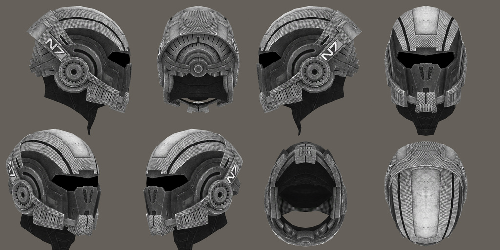

Granted the pep I'll be casting is more complex than most, The N7 Helmet from Mass Effect, but even still, slush casting is slush casting. Now I'm no pro, as this is the first prop project I'm starting even after following this forum for a few years now, but that's why I'm here asking the pros.

A few thoughts. The model (pep) will be very angular. When the helmet has been slushcast, it will require a lot of sanding. Body filler (rondo) can be sanded to a glass like finish if you spend enough time on it, but plastic? I would imagine it would ruin it. If you are prepared to spend a long time correcting this, then go for it. If time is a constraint, or the finish needs to be superior, I would advise against it.
