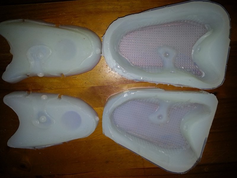

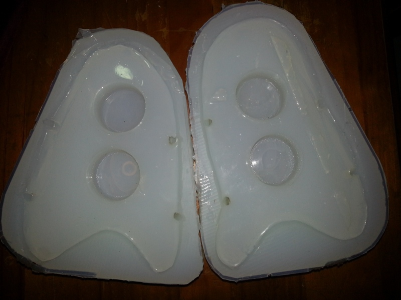

Absolutely you can and in fact I had to do that (part fill the mold box) to make these molds.
attachment.php
attachment.php
The part fill was to allow finger pull holes to be created in order to separate the parts. It also saved silicone :)
