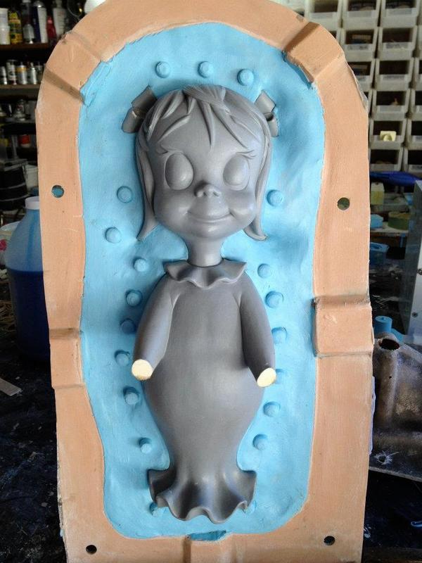

You need more space around your part. Your Part is WAY too close to the edge.
Hopefully, you are not planning on casting very many. You could try making a quick plaster jacket around your existing mold, if you can get the master back in it, or try it with a casting.
There is a reason we use fiberglass or plaster as a mother jacket for large molds. Also saves on Silicone.
