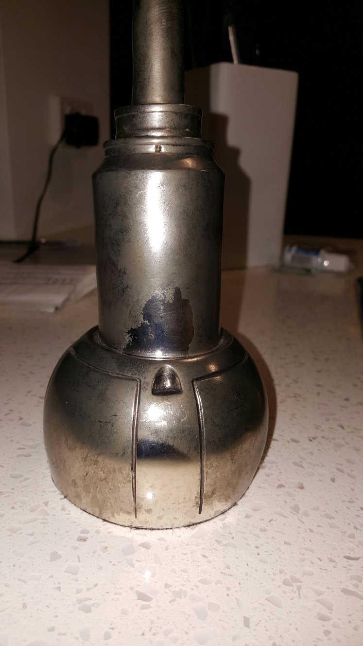

  11. safire25
    safire25 New Member
    Trophy Points:
    3
    ok postmanpat as promised I tried the enamel thinner on the hip piston in a spot you cant see on the statue. I had to rub quite a bit but as you can see the enamel thinner did slowly start to take off the paint and left the shiny chrome underneath - Hooray!!
    Problem is just below this spot I also tried on the actual piston and no matter how hard I scrubbed it would not take the paint of here. I have attached a pic of the only other V2 statue which shows it cant be done and the lower piston is shiny as the top so I still don't think this is the stuff he used to remove the paint effects
    20150806_205234.jpg 20150801_141851.jpg .

  14. safire25
    safire25 New Member
    Trophy Points:
    3
    20150808_114620.jpg ok I think I have found what I need. I tried lacquer thinner and some came off but not on the below piston at all. So last step I tried paint stripper. After 20 seconds I rubbed off and the paint came off easily showing the chrome underneath. I only did two very small spots which you should be able to see in the photo. I might just test this by keeping the paint stripper on the chrome for a lot longer to be 100% sure it wont harm the chrome. If anyone can chime in I would appreciate It before is start the life size statue. Its the only thing that has worked but don't want it to bubble or remove the chrome plating either. From this test it hasn't but does have me a little concerned
