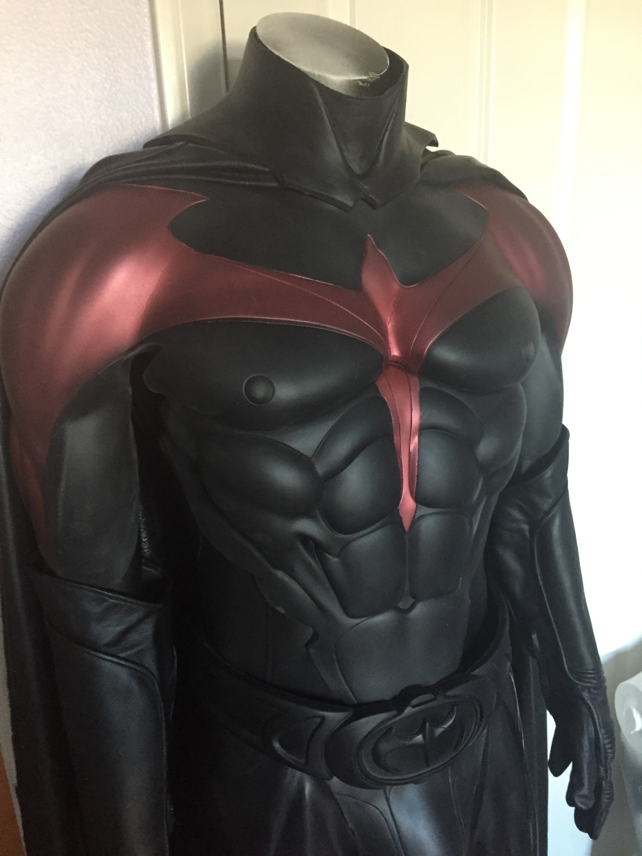

They don't have red either lol... This was painted with their paints and red powders. You need silver powders.

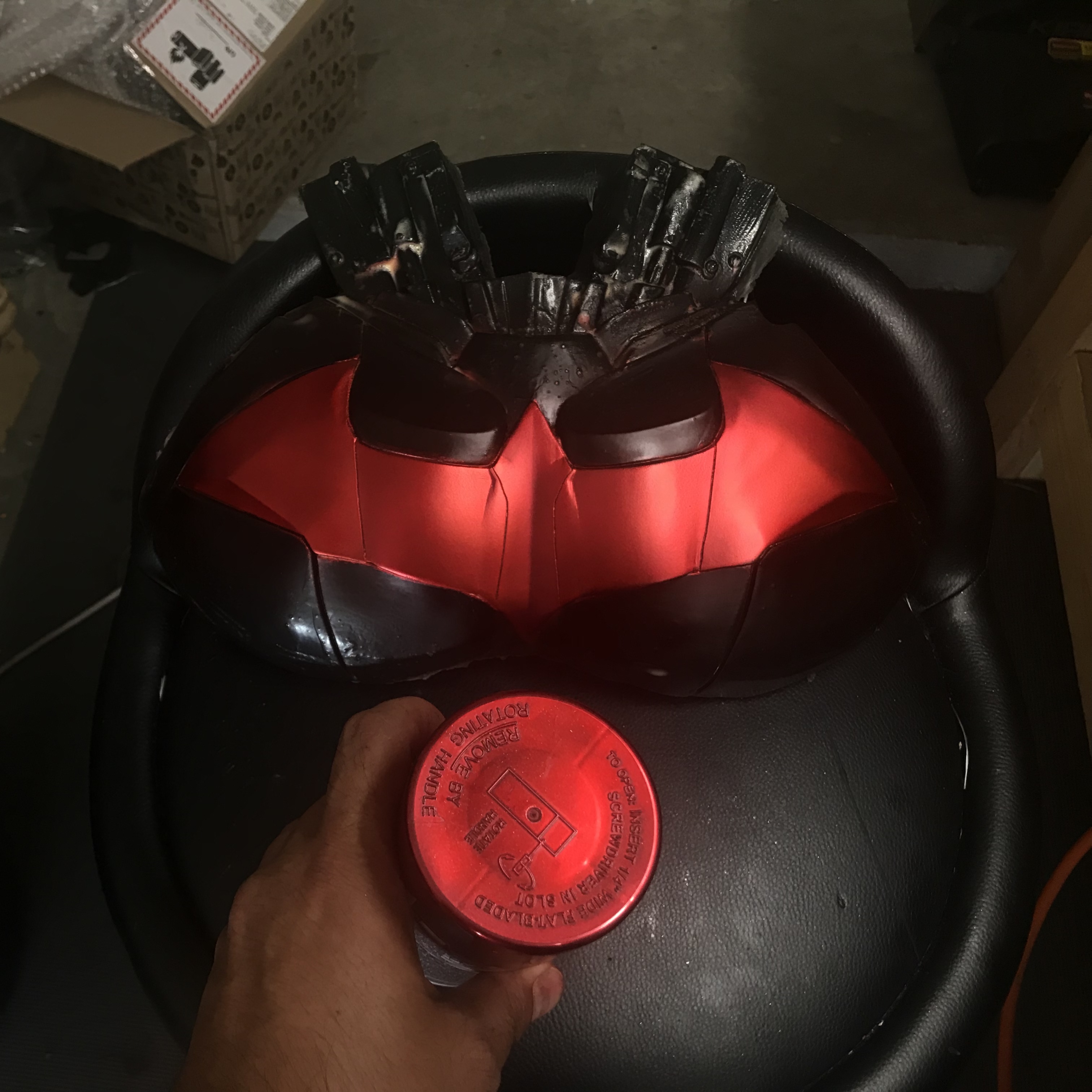

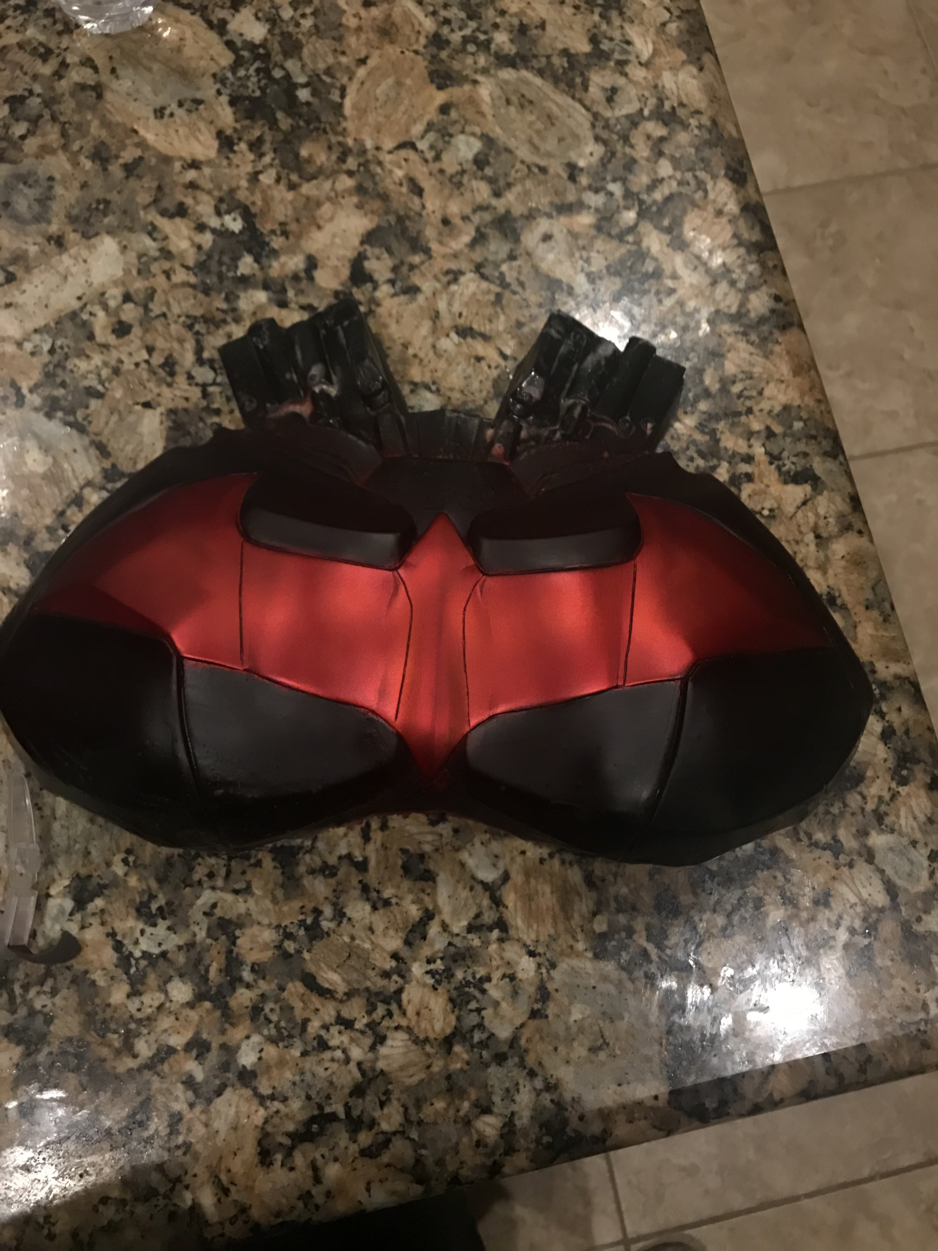

What red did you use and what’s your method of application? I’m having issues sometimes with the color sticking to the piece. Sometimes I find it can be rubbed off and peeled away. Maybe my coats are too thick or I’m not allowing enough time between coats. I’ll try thinner more spaced out coats on my next attempt
Ben experimenting with several different reds and methods on my urethane pieces. Think I came up with one I like but I need to see if it bonded correctly with the urethane. Also using BJB SC89 clear coatings.
note: the paint can in the pics was just for color comparison, as I’m trying to match it.
