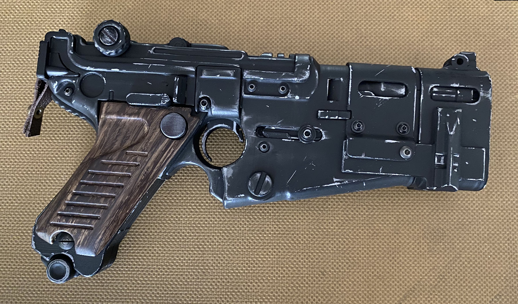

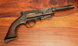

I'm almost done with my resin Mal Pistol and I was wondering if I could get some help or tip to create a "good" wood finish on the grips. The picture below is what I'm working with and the second one is what I hope to come close to.

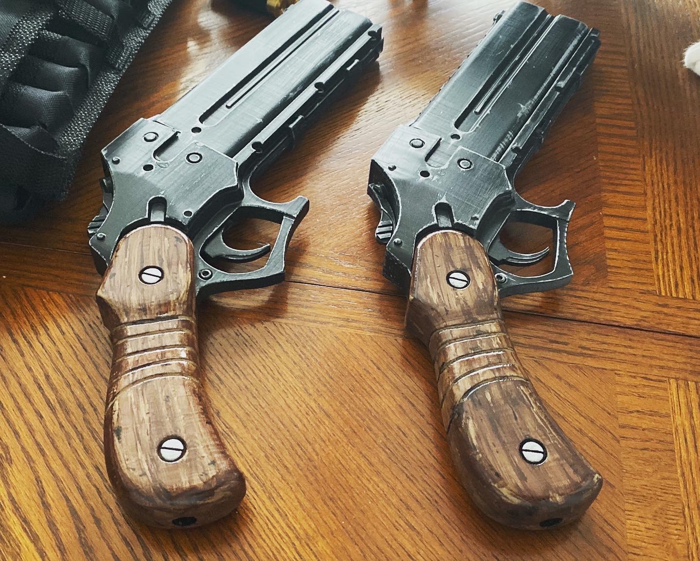

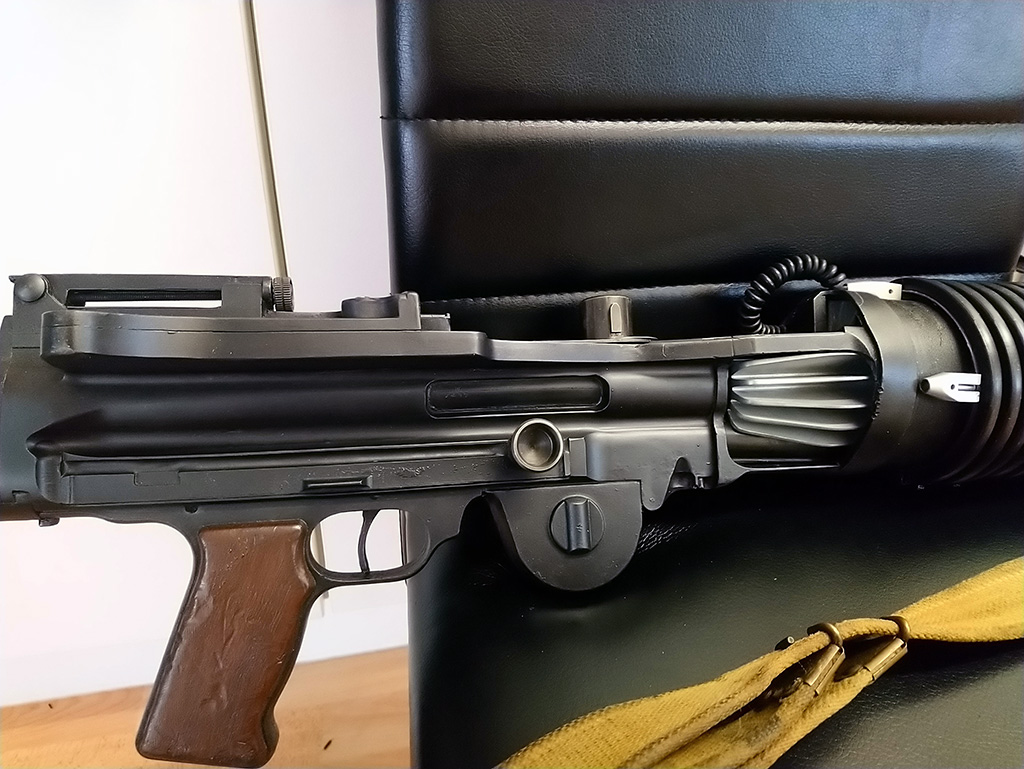

Sidewinder has an aswesome method he uses on his Fett Webleys. I used it on my Lewis Gun and it is aswsomeness.
I'll type it up tomorrow if I'm not too lazy.
You need a basic dark brown paint and some increasingly darker brown ink washes and black. And a satin clear.

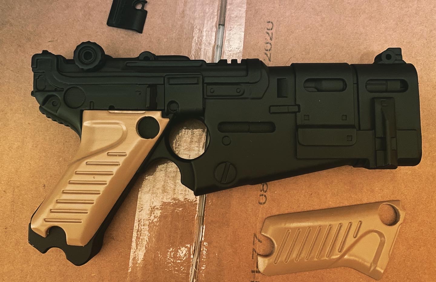

I like to use a satin tan spray paint base. I then use various brown shades of acrylic paints, streaking it over the base color in various ways depending on the effect I want to use. I use these paints because it's very easy to remove them if I don't like what I'm doing. Once you do like the effect you have achieved, let it all dry. Be careful, acrylics can be scratched easily and if water gets on it, you have to start over.
Then I use Krylon clear coat. Either matte or glossy, again depending on the look you want. No more then 2 coats usually.
Base coat of tan:
These were done with matte clear coat.
These were done with glossy clearcoat.
Hope it helps.
kurtyboy
Much more subtle. Brown base then horizontal streaks drybrushed almost using three progressively darker brown inks and black with a wide brush. Satin clear coat.
Almost vertical streaks on the hand grip following the shape lengthwise.
