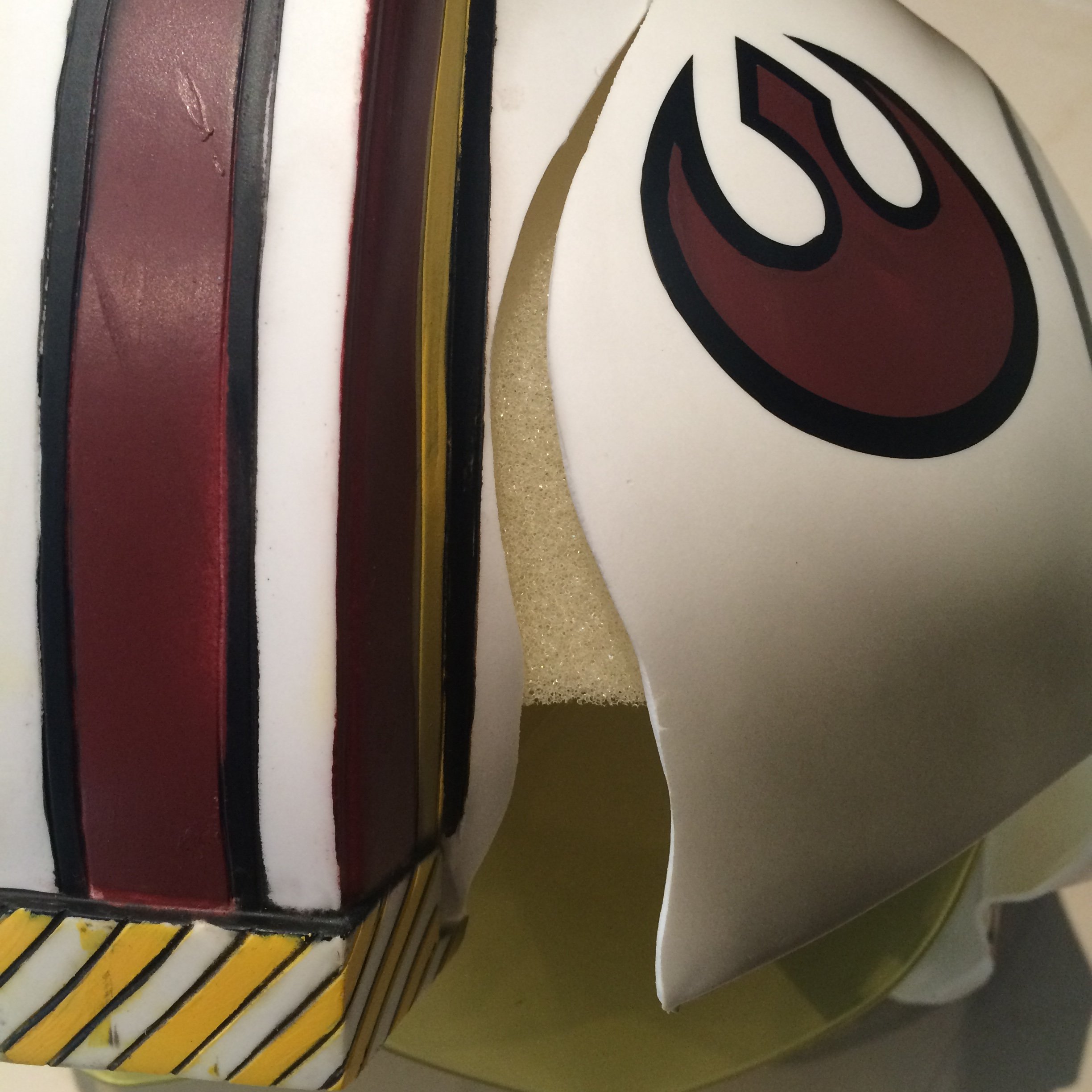

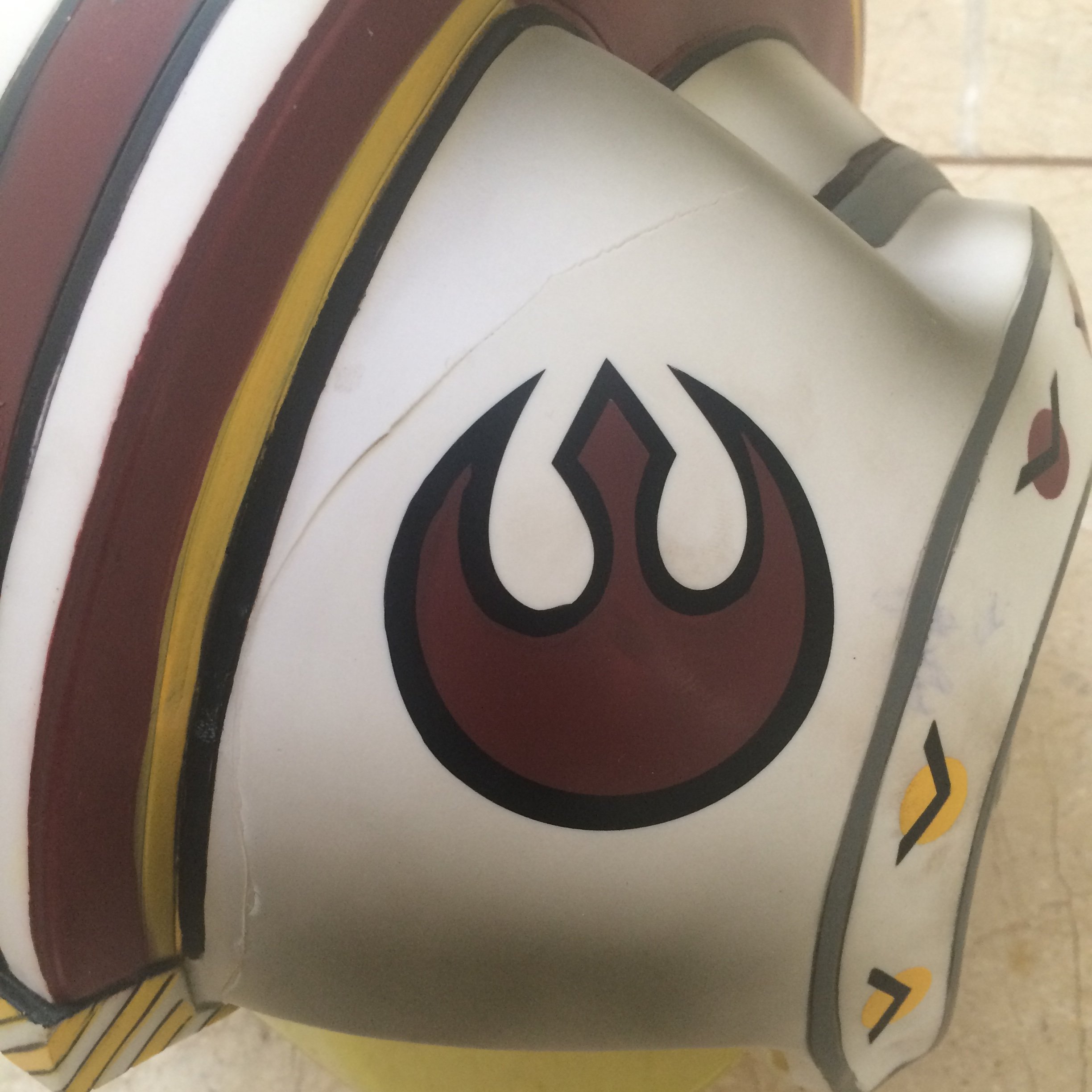

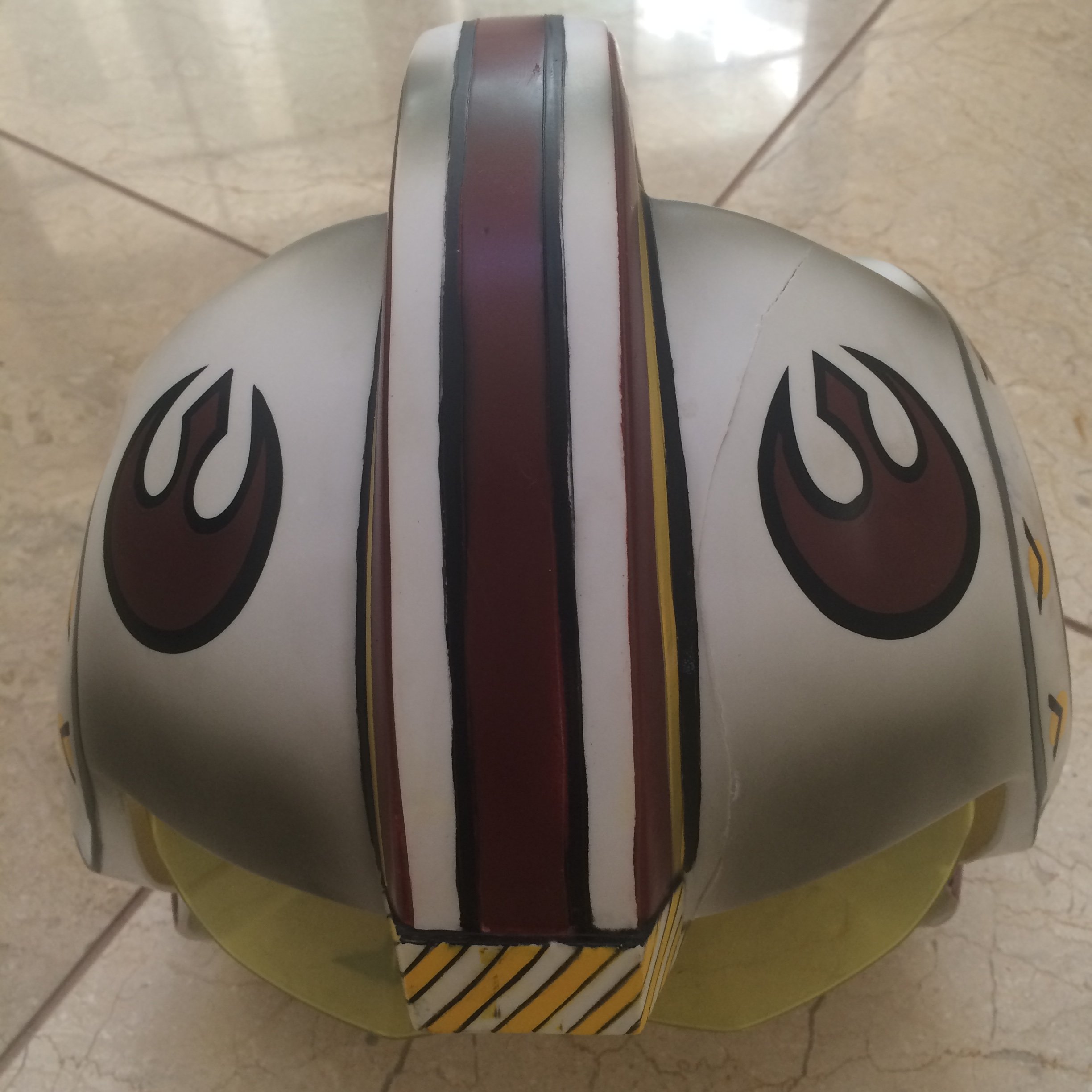

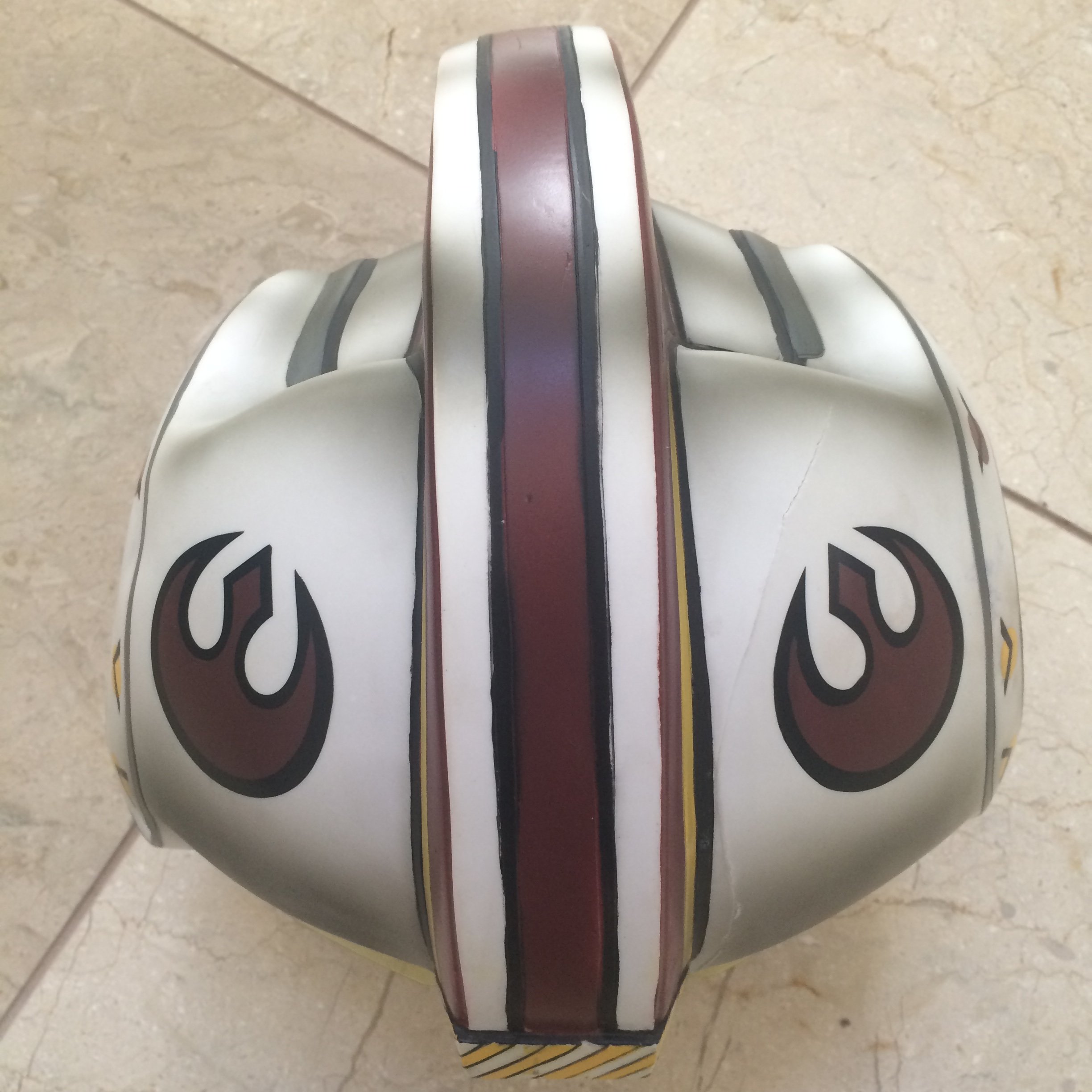

I have a somewhat large crack in my X-Wing pilot helmet :(
The branding on the Helmet says
Don Post Mask
Lucasfilm 1997
Although the box says 2002
What would the best way to repair the helmet be? Are there any glues that are suitable? I've had one suggestion that the edges might have to be melted to bond them together (like a weld for plastic).
Any suggestions would be much appreciated. Hope you can help - thank you :)

Thanks kindly for your reply! Can't see a recycling symbol on the helmet, just on the box (& I guess that could mean the the cardboard box is recyclable.
UPDATE: I was advised by a maintainance man that superglue would be suitable.
It's actually bonded it together so far
Surprisingly, superglue is holding it, but I want to glue something to the under surface across the crack to hold it together firmly and permanently.
Does anyone have any tips as to what will bond the helmet plastic to another plastic permanently to secure the crack.
Thanks kindly :)

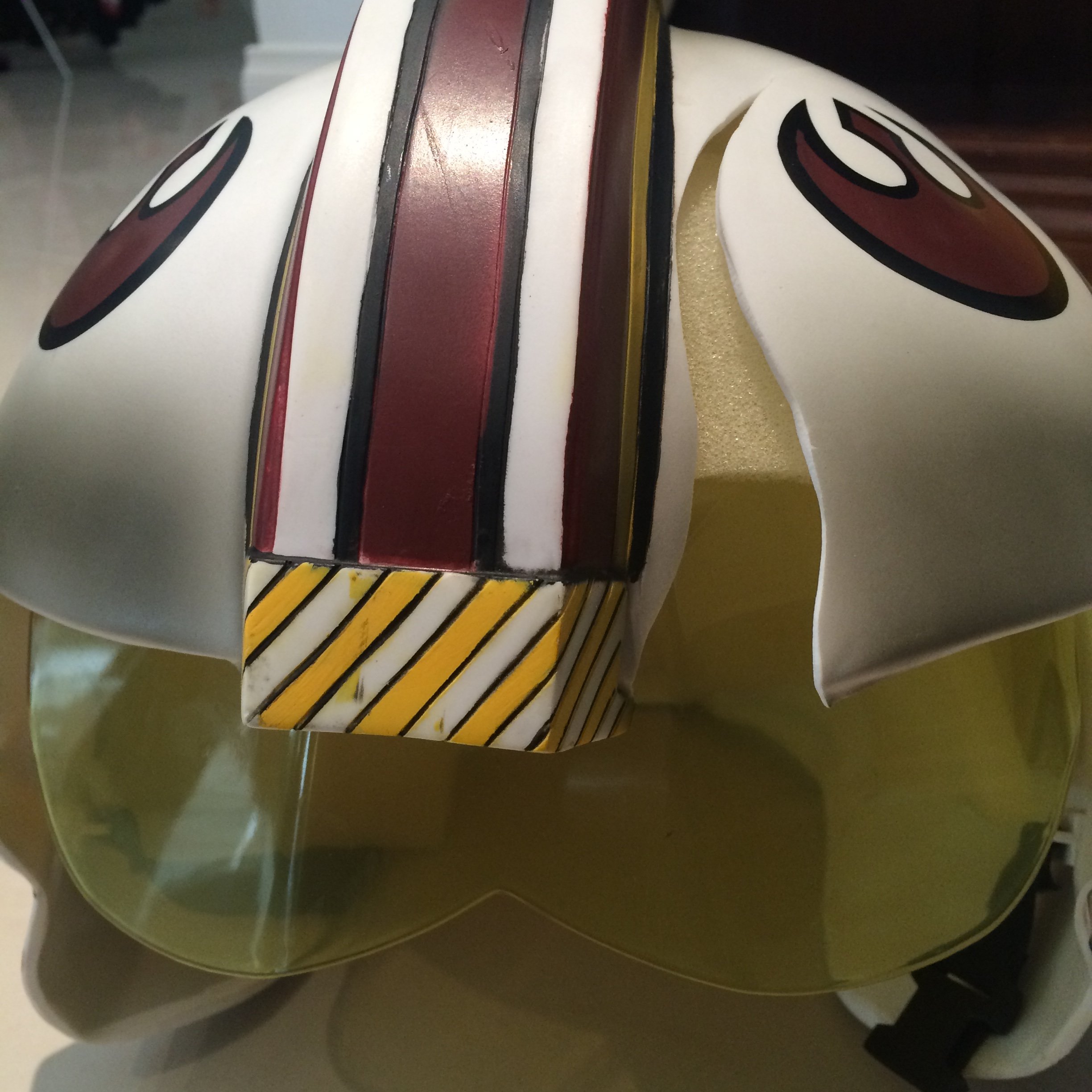

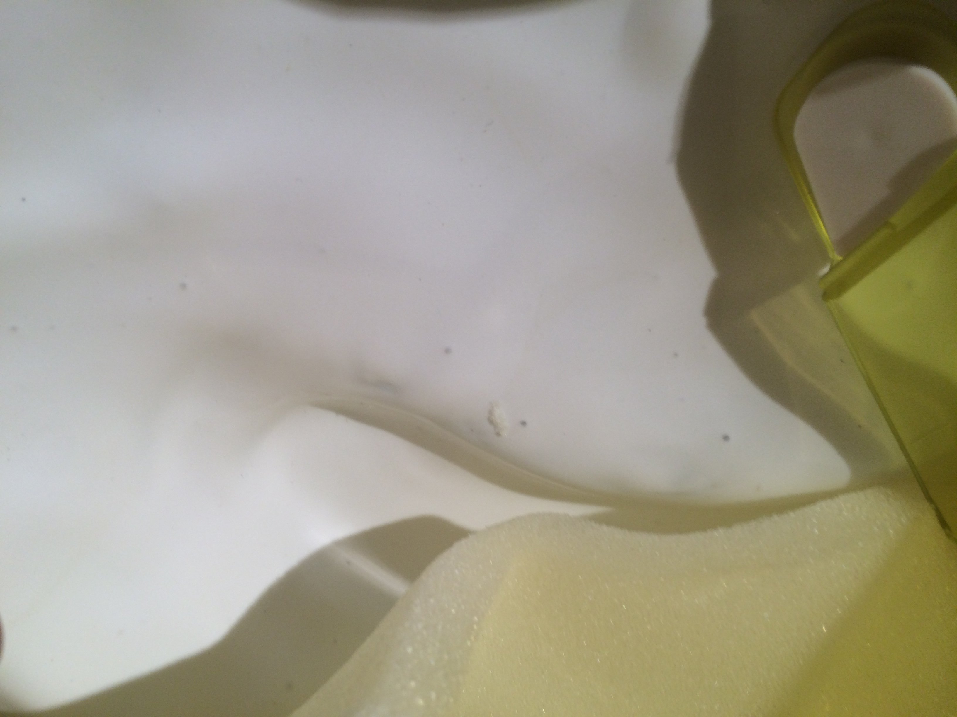

The inside of the helmet looks like this
There is a soft foam lining that I think I can easily remove and under that is just the plastic
So you think the fibreglass will adhere to the plastic? I've never done fiberglassing before. Is it difficult/expensive? What does the process involve? I presume that the sanding gives the fibreglass a better surface to adhere to?
As an alternative, can an apoxy resin/glue be applied over the crack on the inside (perhaps a few layers)? If this was an option, would I still sand the surface?
I'm pretty sure that would work as well. Typically light sanding gives a better surface for things to adhere to.
Yes remove the foam so you just have the plastic, you can buy a fiberglass repair kit that has everything you need at any home improvement or automotive store. It's only like $15. So here are the steps.
