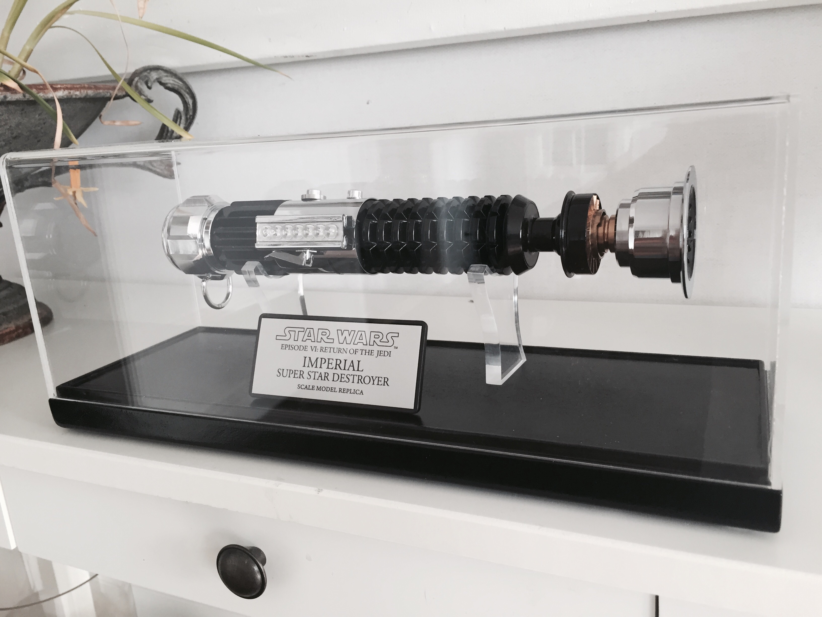

  6. Nils
    Nils Sr Member RPF PREMIUM MEMBER
    Trophy Points:
    1,195
    When I was working with my saber cases I used clear epoxy an it worked fine. But do not use CA. Done that, never do it again!!
