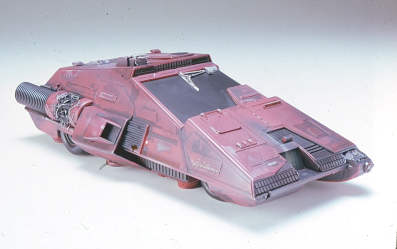

I need help in identifying some kit parts on the Alfa Romeo spinner in Blade Runner. I'm not an experienced modeler and I can't ID parts but I want to see if I could possibly replicate this. The original model was around a foot. I think some parts are from some formula one kits like the air intakes on the sides and the underside wheels and tubes. In some of the photos you can see model sprues or whatever on the sides so that may help.

here is a side view of the filming miniature

I think those curved pieces are tank tread covers

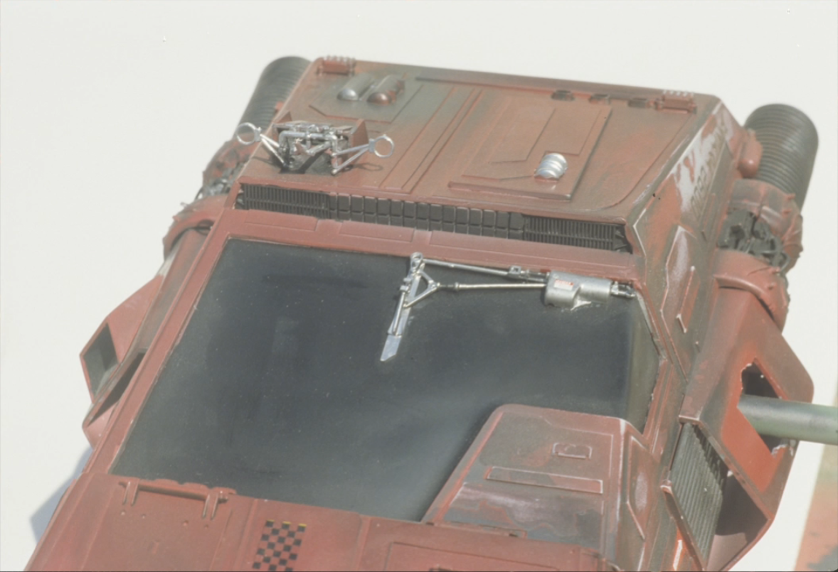

Well in the first picture, the fenders in front of the black wire management tube, look to be from the Tamiya German 88mm 36/37 gun kit.
Hello, nice model !
I can see some Tamiya 88mm parts, some Tamiya 1/12 DFV parts (Ford engine you find in several 1/12 Tamiya formula one), and some parts from the 1/35 Tamiya Marder 1A2.
Thank you for the ID. It looks like they definitely used the Marder treads on the bumper. I think the crome mud flap from the Kenwoth K123 is used as those curved things on the back.
Thanks!
RAM
The Marder is also used to make the intake or whatever it is above the windscreen, the parts on each side of the tank thread are chopped off the rear chassis plate (the kind of grills).I think I can also spot some vintage Koolshade.
1/12 Tamiya Wolf WR1 for the 4 large radiator grills with the cross bar on the underside, and probably for the other DFV engine parts around there too.
Some of the pipings on the underside are from this kit too.
Suspensions parts (triangles), on the underside again, from this kit, seems to be a huge donor !

There are other Marder parts on the roof.

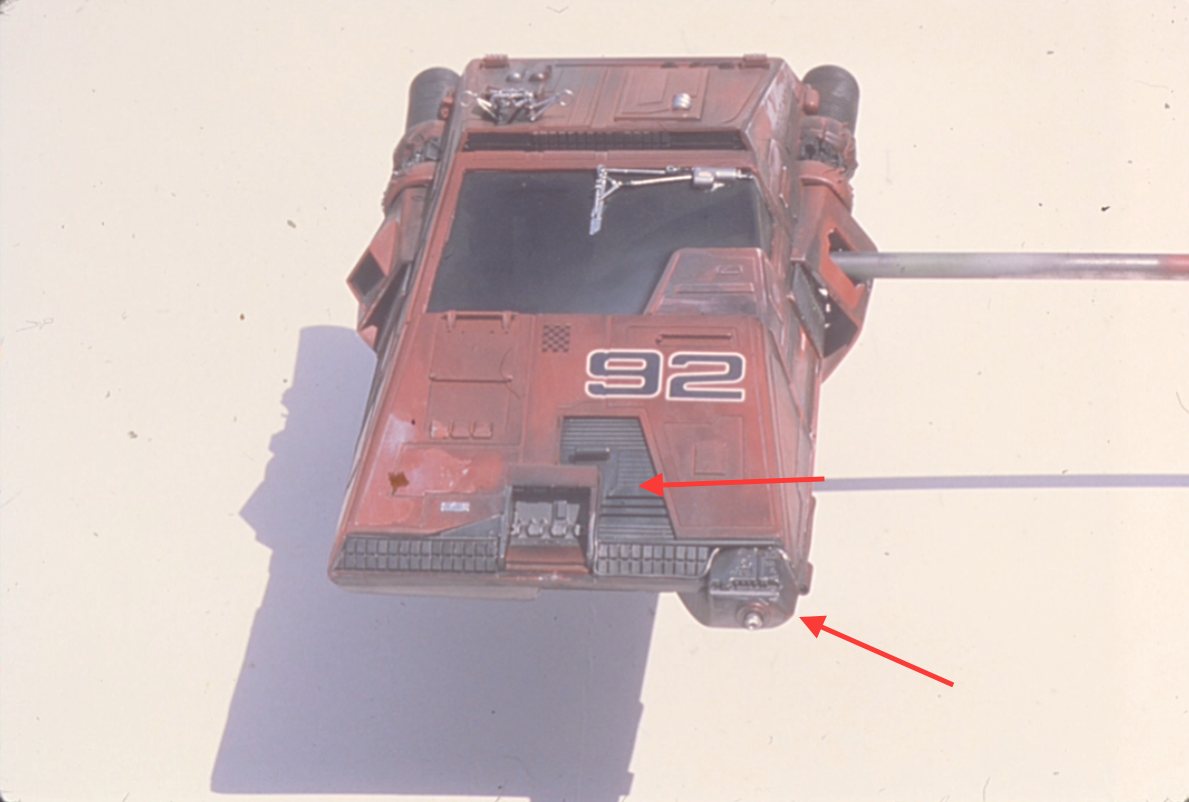

Thanks Lee. I don't see any other parts used besisdes those decals. I need to know what that checkerboard decal on the hood is from.

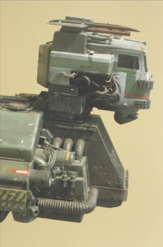

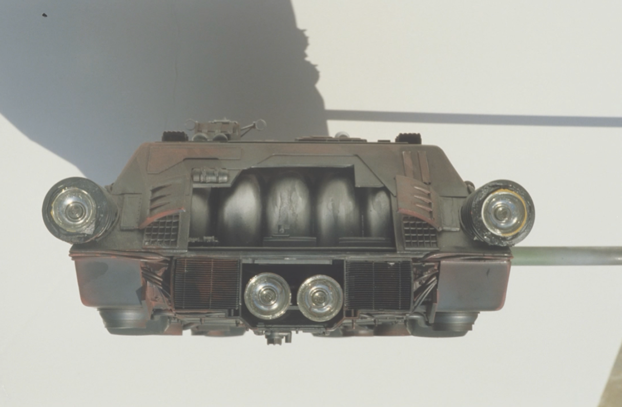

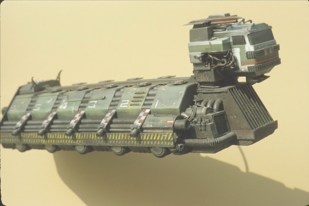

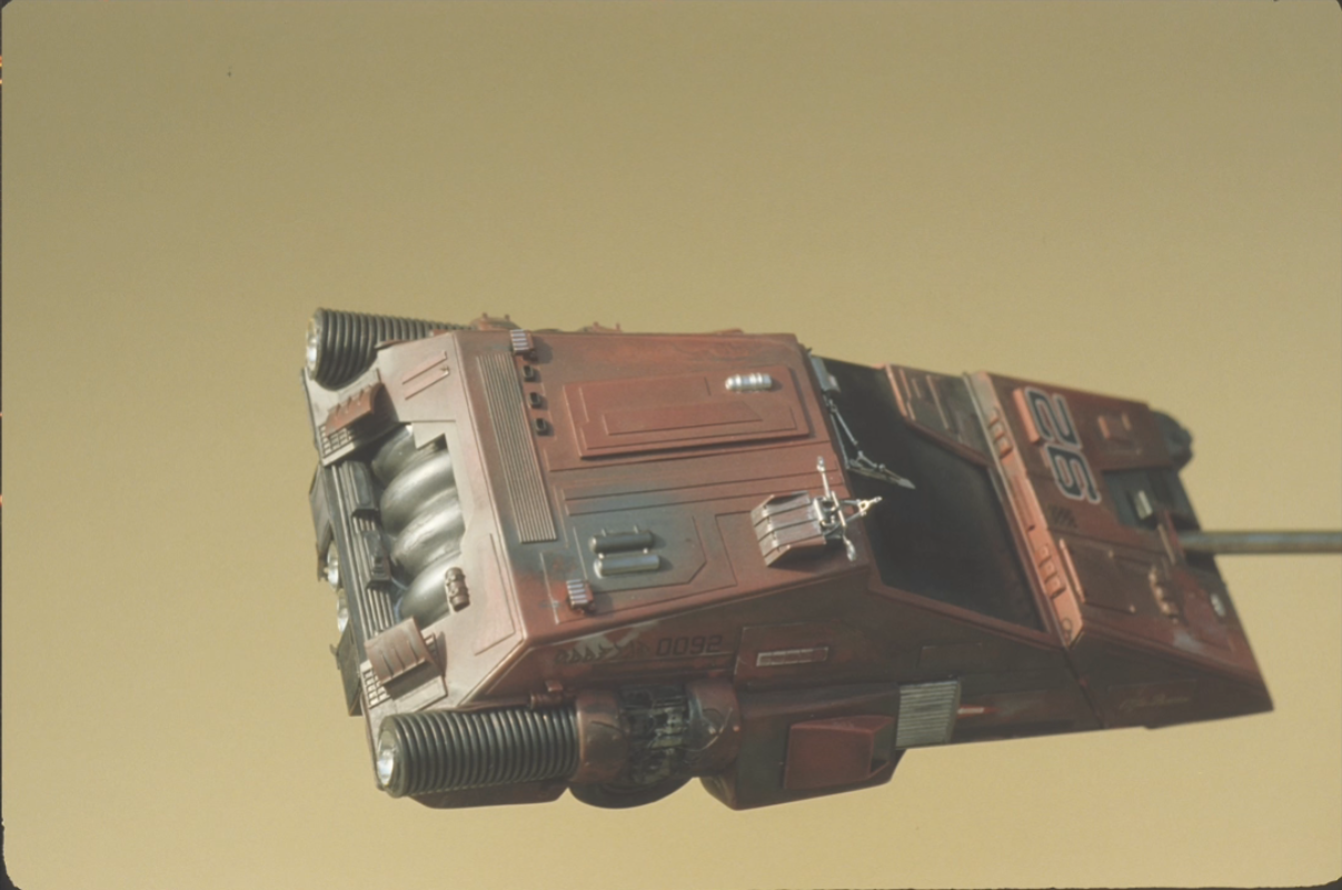

I got some more screen grabs and hopefully other parts can be identified but I have photos of the "Flying Truck" and the rarely seen lobster spinner. Yeah this will be my first big project if I actually can get everything right. I would love to see others make the Alfa or Lobster but it really feels like these models are "lost" so to speak. They need more attention :) It would also be cool to see it in other colors or how it would look if it was new.
you can definitely see the marter treads on the front.

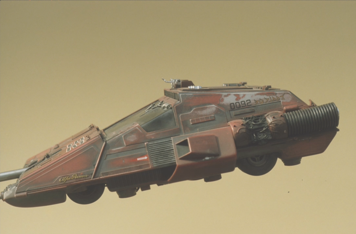

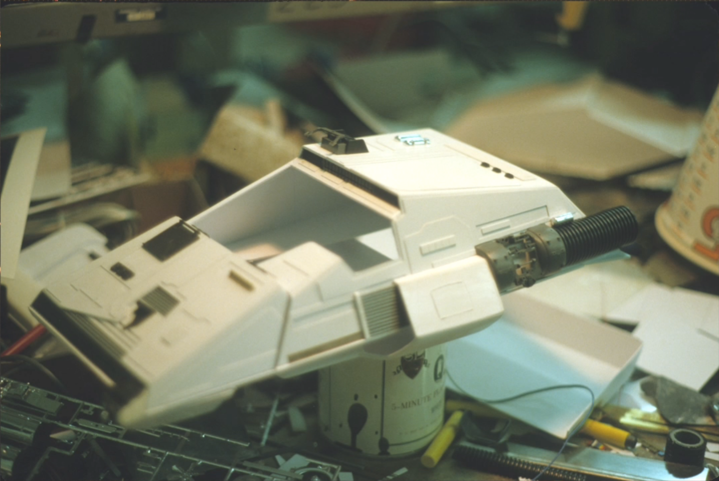

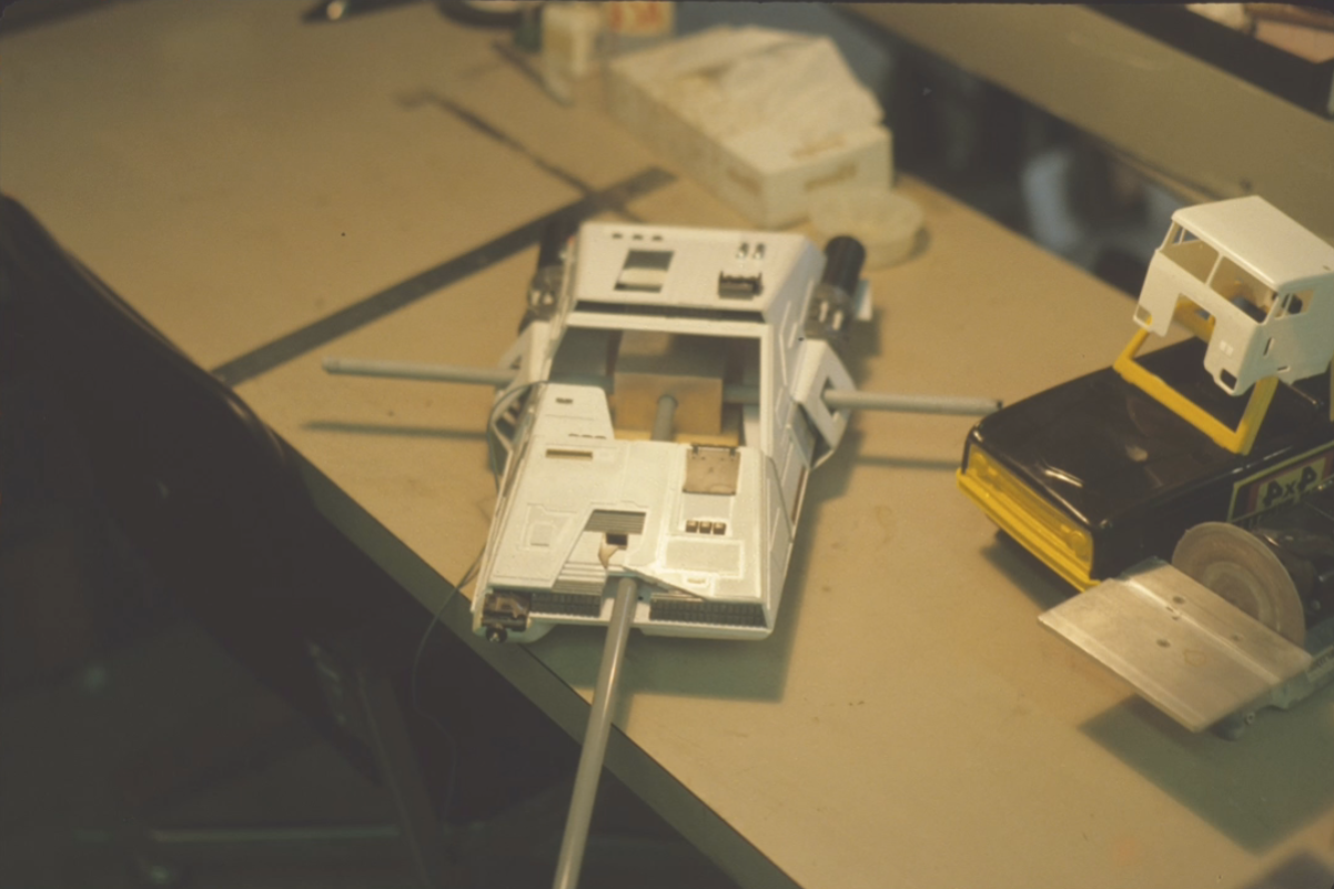

Can anyone identify the kind of air intake things on the sides? it looks like a cut down piece of the Tamiya Lotus 72d
need these parts identified.
