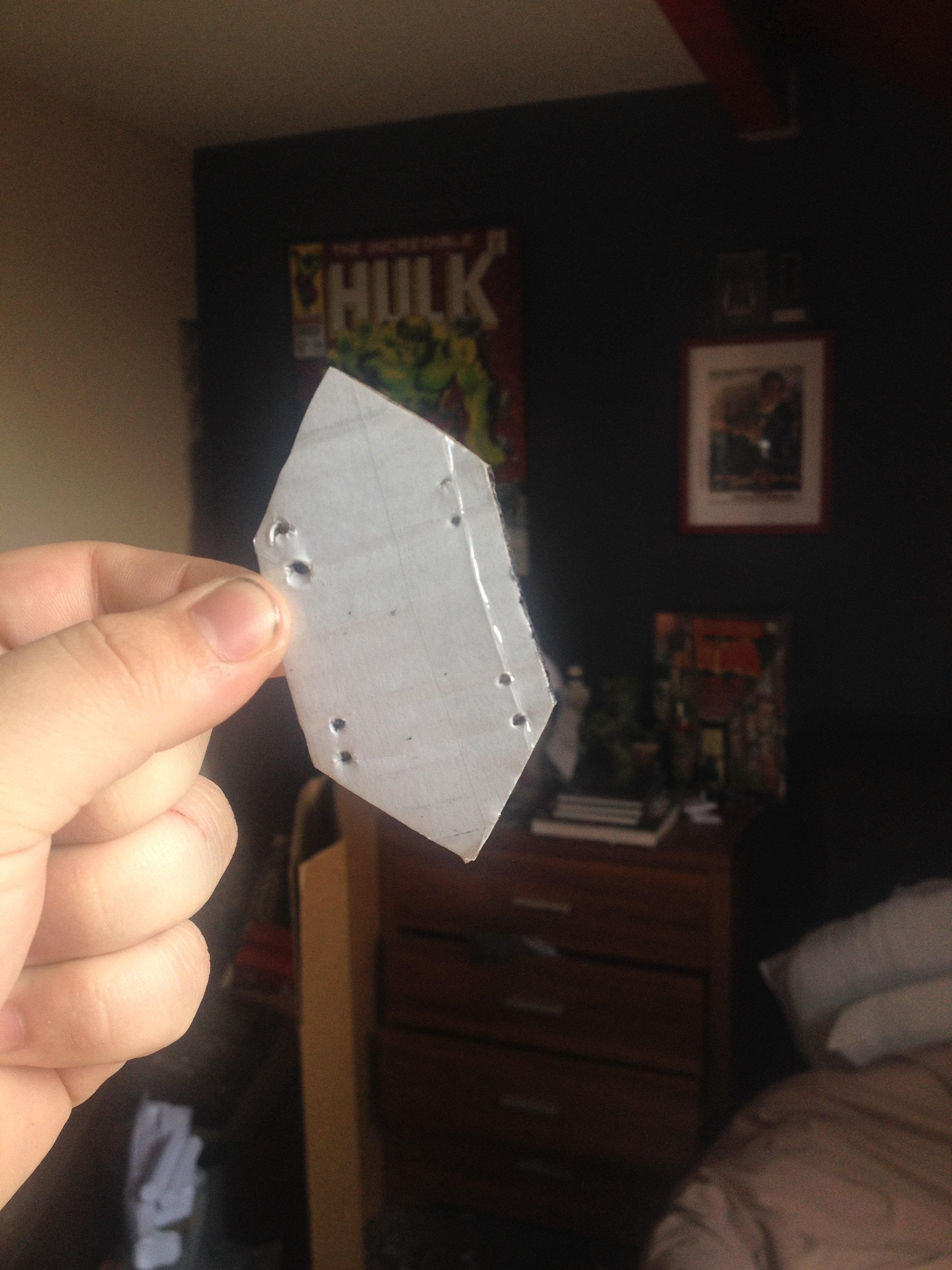

This is the individual piece:
This is a shoulder guard mocked up.

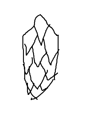

And this is the detail i want on each piece. (excuse MS paint lol)
My original thought was to use pvc foamboard and carve the pieces individually, but then i wondered would casting be a better option.
So my questions are, how would i cast these? what type of mould?how durable would the pieces be (don't want them to crack) and how will the holes turn out with casting etc. i have never casted anything before and would like a cheapish way to so. And i need about 100+ of these.

I think casting might be over engineering that part slightly.
Have you thought about using styrene sheet? Its fairly cheap and you can cut it with scissors, if you need it to be slightly bevelled you can heat it gently with a heat gun or powerful hairdryer over a curved object. It's also very light for costuming in.
If you mold and cast them it's very tedious work at 100 of because that's 100 pours, you'd probably have to drill all the holes later.You can build a set of 5 and then it's 20 pours, but if it's easy to build a set of 5, you might as well keep going Silicone isn't that cheap, (not where I live anyway) but resin in bulk can be. Styrene (HIPS) is a good suggestion or even better is a foam core type board which is easier to cut and work with.
I wouldn't cast the piece, but find a suitable substrate to cut out of

If if it gets too hard to pull the mold because of its hardness, you could also make a mold using silicone caulk, which is cheap and easy.
Use clear 100% Silicone I caulk, mix in a drop or 2 of acrylic paint to make it set faster, and then you'll have flexible mold that'll be able to pull away each piece much easier.
i find it hard to find 100% silicone here in the UK or maybe im being stupid because it doesnt actually say 100% silicone on it.
And would 5mm thick fibreglass resin be durable?
I would say carve at least 5 of them to reduce the amount of pours needed.
Buy some silicone made for casting. It will cost more up front, but you will have better casts and it will be easier to work with.
Make an open face mold and place an indent in the master for the hole that will be drilled (if you drill all the way through on the master, the small piece of silicone left will probably tear after a few pours).
The indent will make locating the hole for drilling easier.
