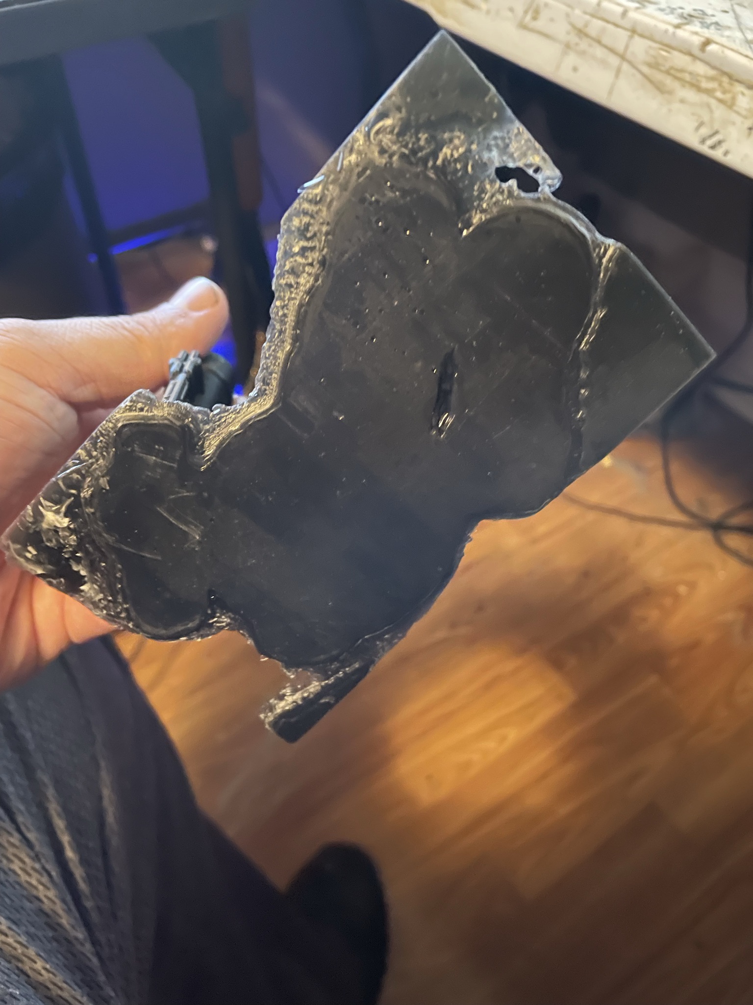

I've been running my first 3D printing project. A DE-10 blaster pistol (technically 1 of 2) for a Mando armor kit I'm assembling.
For some reason every print comes out with this big, 3mm thick, plate of resin at the base. It covers the entire print area. Anyone know why this might be happening?
I'm using beds and supports.
Black Anycubic 405nm resin.
And a Creality LD-002H (light source is 405nm).
Thanks for any help and advice. ^_^

your printer will only do that if the file is telling it to.
Check settings, see if you have a base being laid down, what kind of attachment to the build plate is programmed in? Check the raw file and see if it contains the base.
Your printer shouldn't just be printing a thick base. Besides, it waste a bunch of printing material

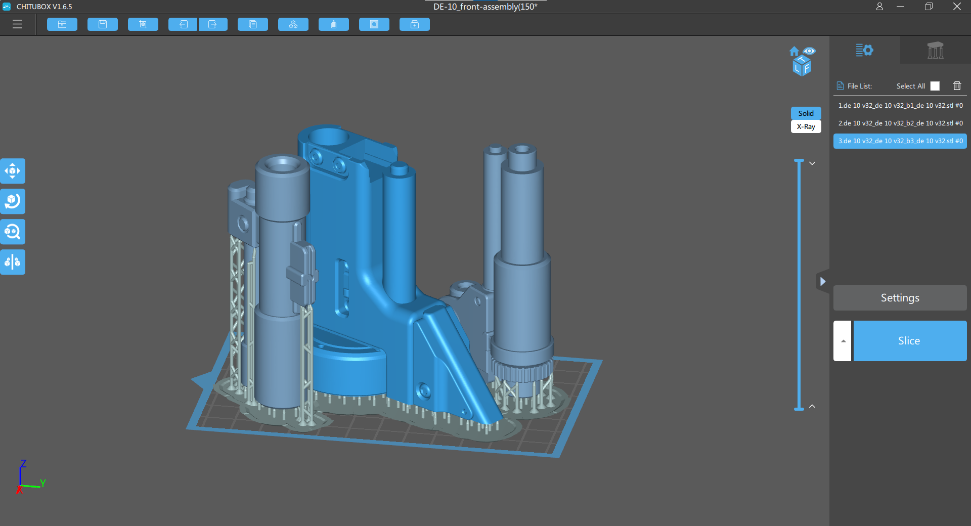

What slicer are you using? It must show up on your preview. A screen capture would be useful. This must be your "Raft". Go into your support settings and see if you can find anything that can adjust the height of your raft. 3mm is way too thick.

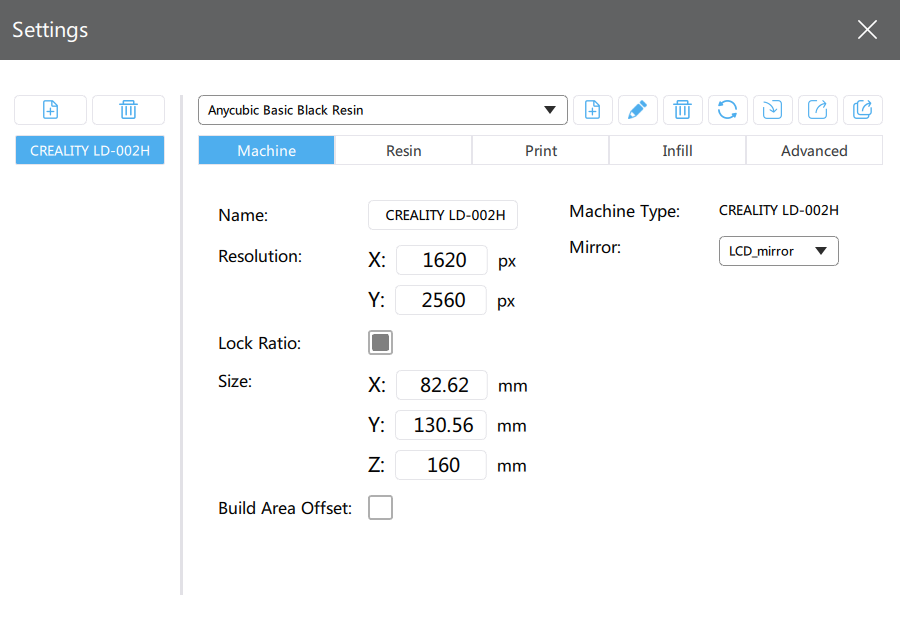

I'm using Chitubox, it came with my printer. And the files only show the normal rafts...
Here are my settings:

Here's what the file looks like:

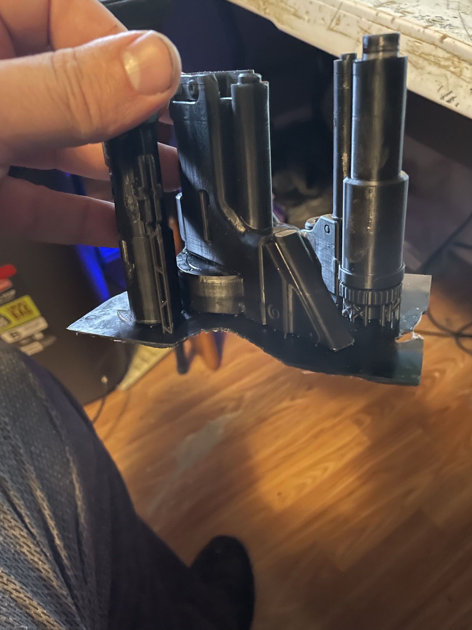

And here's what the print looks like:
The base of the rafts are there, but for whatever reason, it's like there's a spill over on the LCD screen. but the rest of the print after that is fine.

Your Bottom Layer Count is way too high.
It should be around 5, not 55.
Try changing it and see what happens. This is one strange problem. The rest of your print seems fine. I'm wondering if it could be bleed through of the light through the mask due to the long exposure times on 55 layers.

Presumably the thinner squared off area is what you refer to?
If so,reduce your printers uv exposure. If you're running at 100% percent,try 80. It looks like lightbleed through the lcd,caused by over-exposure.
