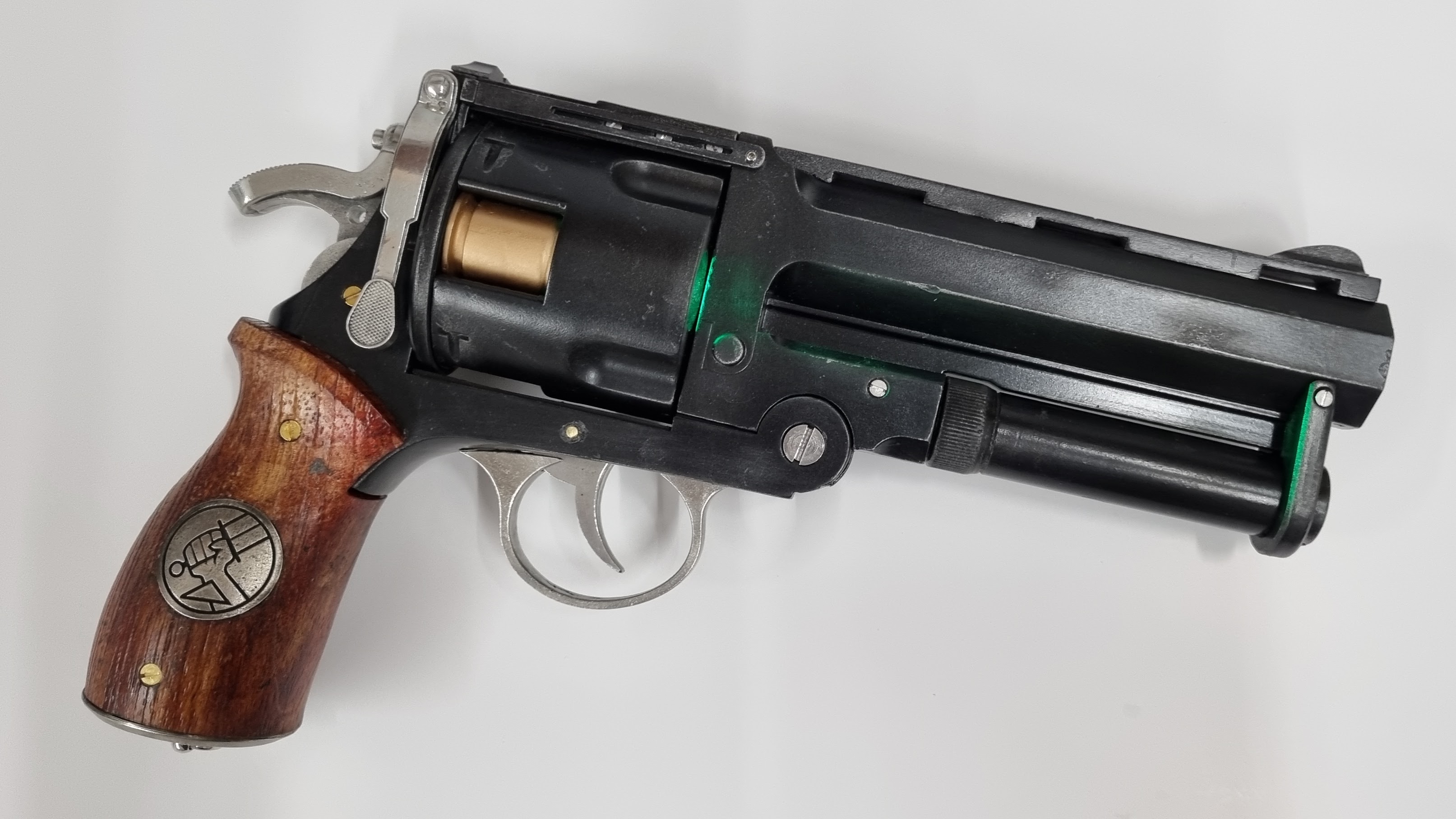

Hellboy Good Samaritan. Cast Resin, Metal Pewter and 3D Resin Printed greebles.
I have a build log nearing its end in the Replica Props section HERE if you would like to check out how it's made.
Details
We, Tip Top Workshop will be making some raw DIY kits available. They will need post-processing to get to the finish you require.
The main body of the gun will be a solid resin cast under pressure to eliminate the majority of bubbles.
Some of the smaller details such as the sights will be resin 3D printed, as will the body of the rounds (rounds tips will be clear cast resin)
The shiny parts (Silver) will be cast Pewter! Again a raw cast for you to sand and polish. It is possible to electroplate Pewter with Copper then Brass, to get a more accurate finish.

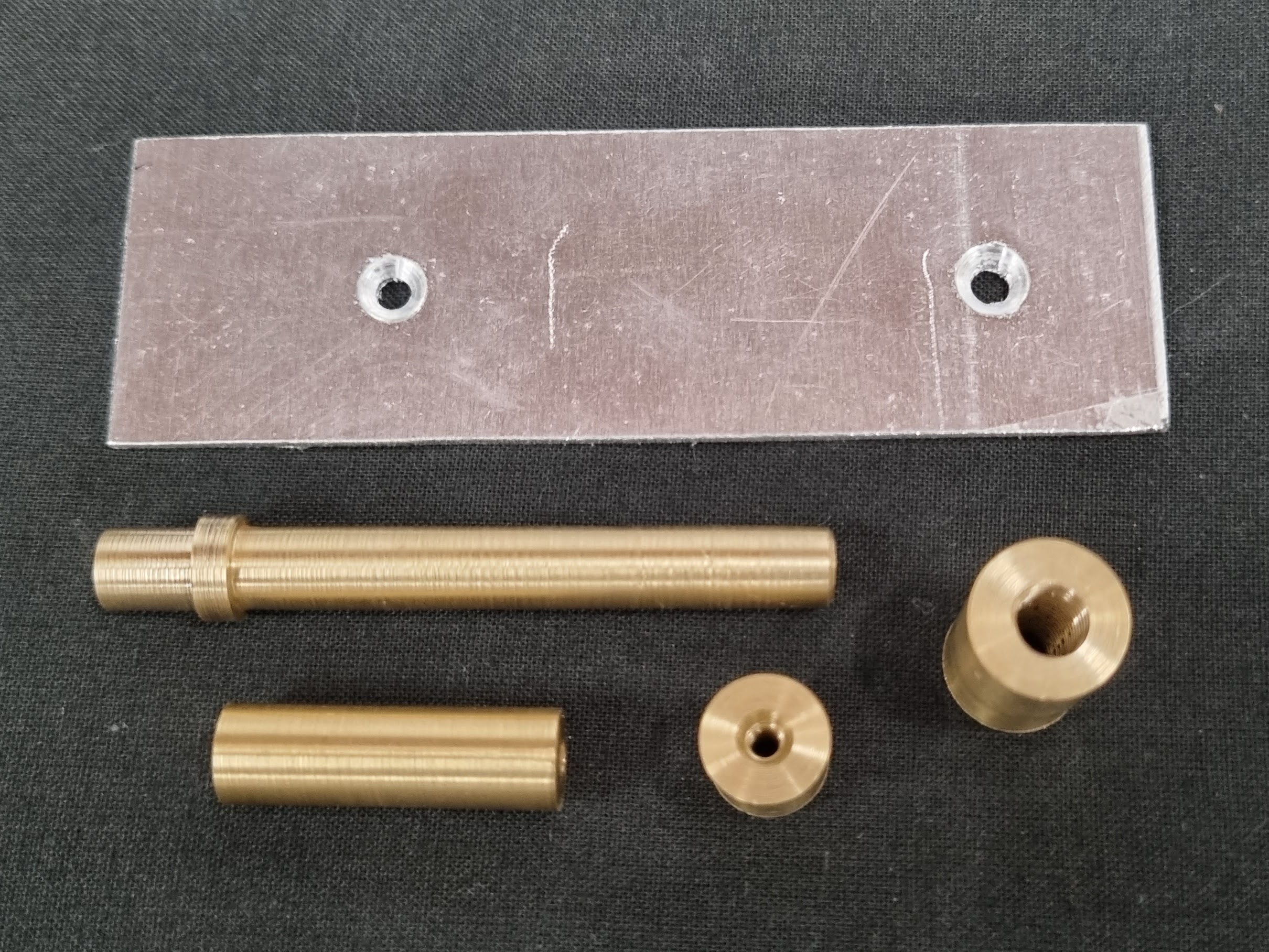

The Brass bushings seen in the diagram will be turned on a Lathe and pre drilled and tapped for you!
All screws, Laser, LED's, Springs, and Magnets needed will be supplied.

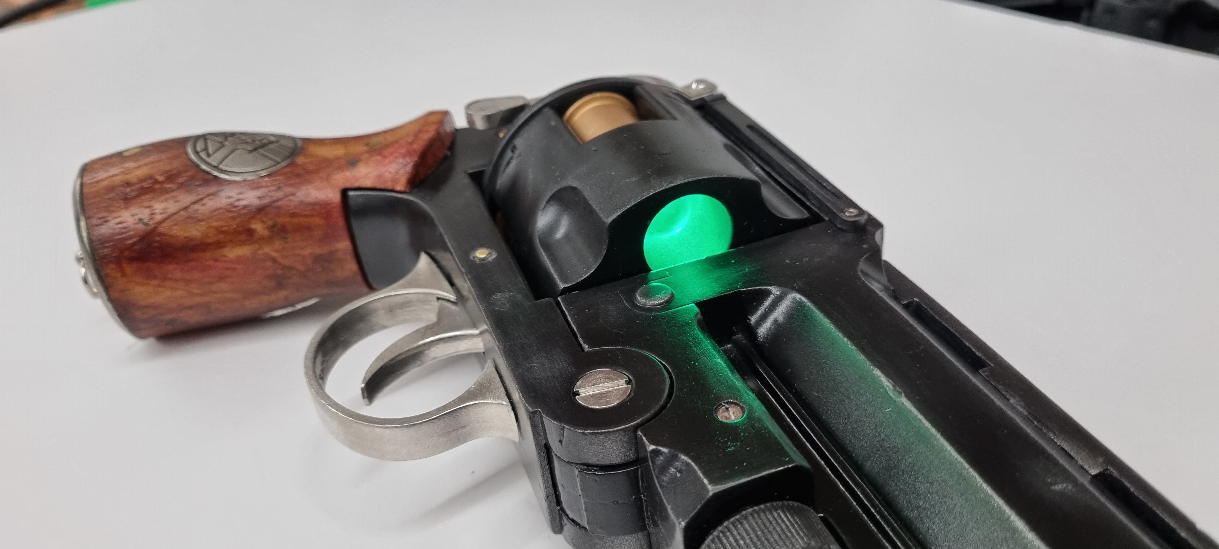

There are Electronics for the Laser, activated by the trigger. and electronics for the Bullets to give off a Green glow!

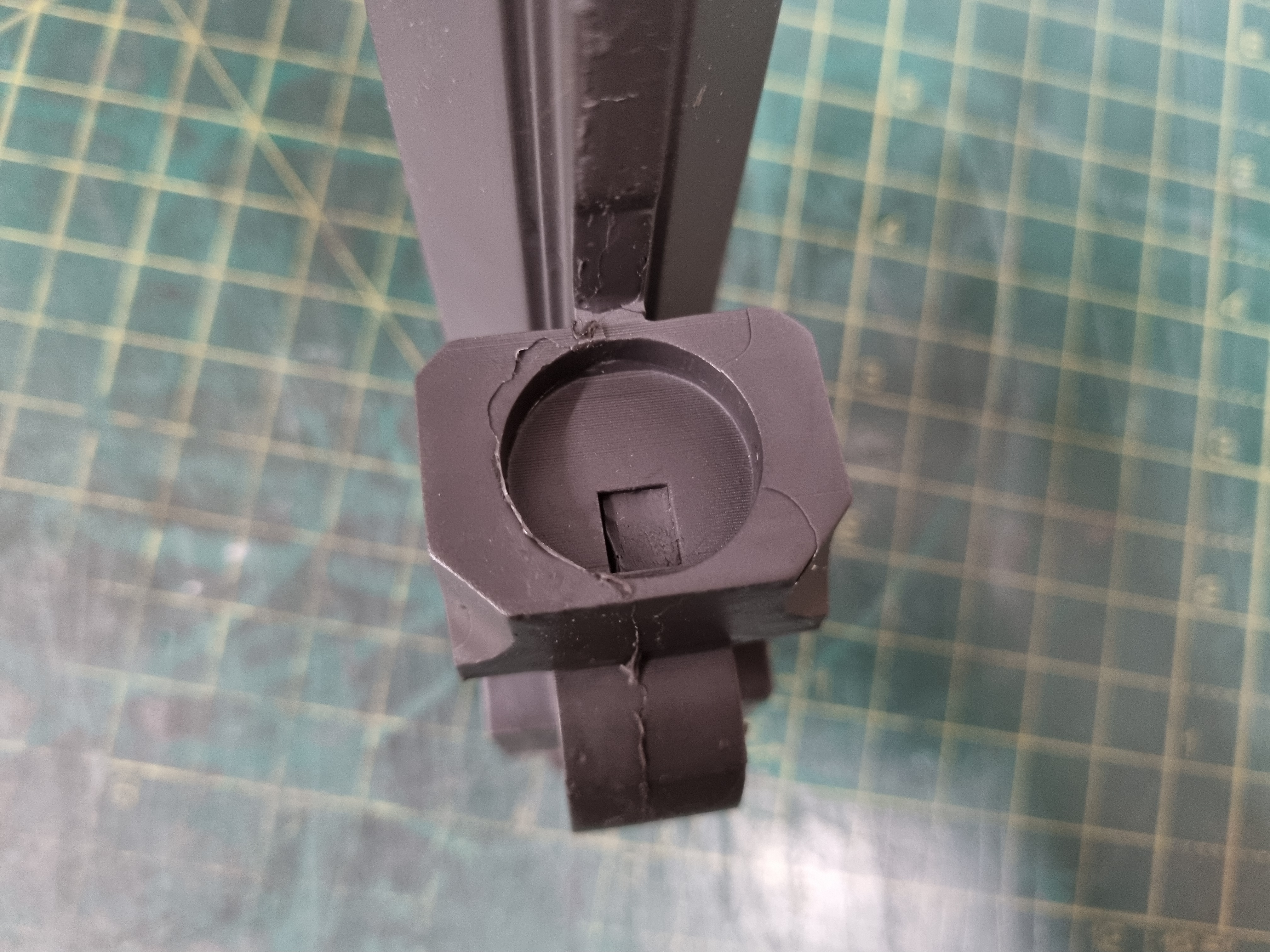

A problem with the laser tube has come up that a couple of you are experiencing, it seems the laser holder doesn't want to fit all the way into the tube. A quick fix for this for you is to either cut the holder short or drill out the back of the space where the tube attached to the barrel frame.
Another snag that I hadn't mentioned is that the rout for the wires to switch is blocked off, this is due to the casting process. You will need to drill a hole that leads the the hinge. You can see the original square where It should be at the back of the laser tube hole.

Regarding the laser tube - the reason the holder doesn't slide all the way in is because there is a lump on the inside of the tube about 2/3 of the way in. I used a rotary tool with a flex shaft and sanding drum bit and was able to sand down the lump. I initially tried using a large diameter drill bit as well, and didn't have much luck, as the lump isn't that big and the bit doesn't really have anything to bite into.
Also, remember to sand down the bottom of the laser holder to get a bit more clearance
I found the same today, I inspected the mould and its there. Not sure how that happened but I'm working on a fix.
I will manually fix them myself before shipping for now. Hopefully I will have a better solution soon!
