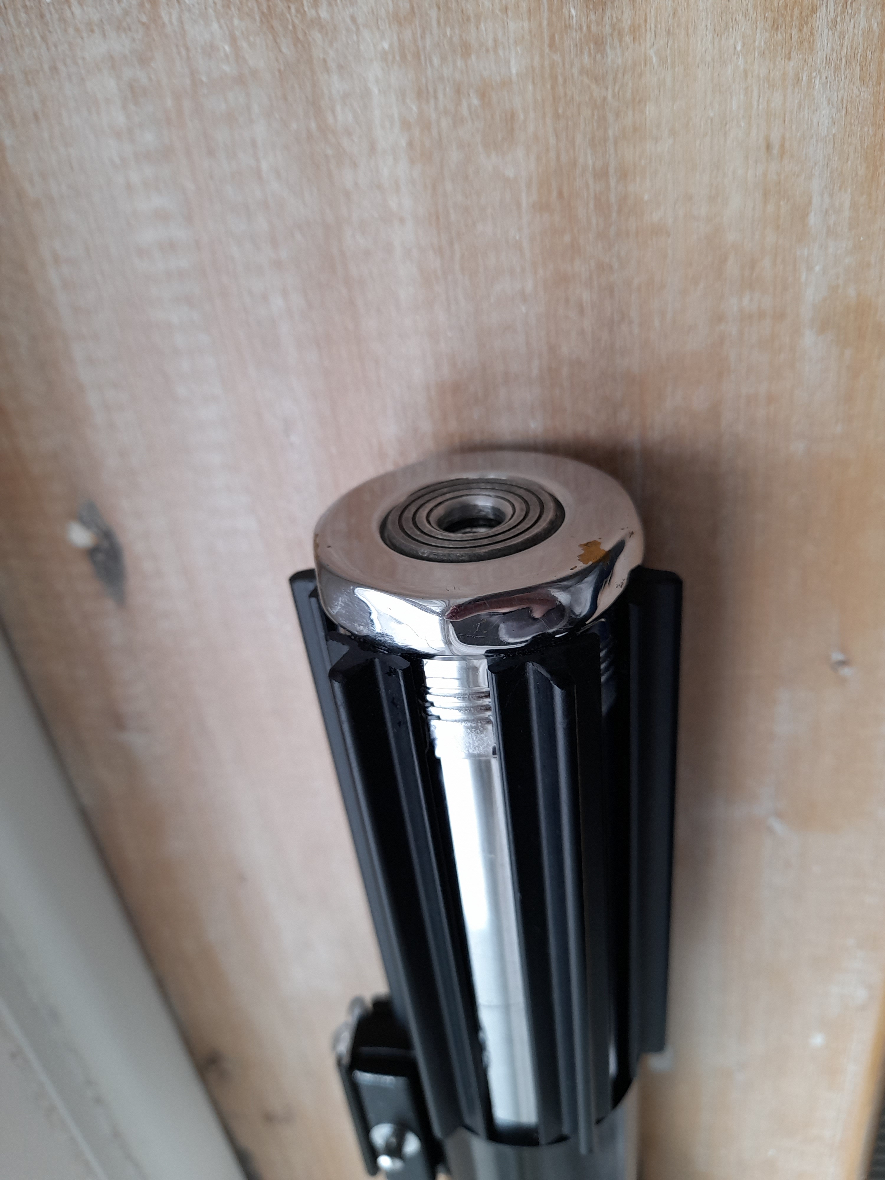

I've built three Vader sabers from Synchronars and it was only on my third that I realised that the large band on the end cap was actually removeable (with a little effort!) which exposed the chromed thread underneath. This makes the end cap much more realistic. OK, so you have the wrong shape but it still has the threaded base very similar to the MPP and nice and flat for the grips. On this one I decided to enlarge the pommel thread from a 1/4" original to the correct 3/8" thread as a test. You have such a lovely condition Heiland - it'll make a superb saber. Overall this saber cost me about £100.
You, sir, are a genius. How did none of us figure this out back in 2002 when we were all building Vader sabers out of Heilands?
Saberguy2, how did you remove the large band on the end cap ?
Aah, it was a very technical process of wiggling it, giving up on that when it only moved a tiny bit (but still worth trying) and then using a dremel and cutting disc to slice through it very carefully. If you can work out where the t-track is going to end up, it doesn't matter if you mark the thread with the dremel a bit. Hope this helps!
