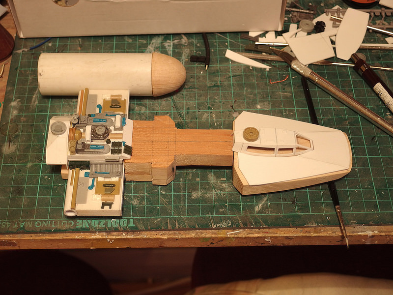

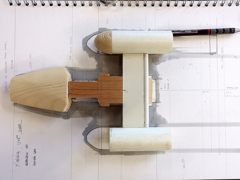

Seems to be something in demand by fellow sci-fi modelers, yet only one other kit is on the market and it ain't cheap either, so we'll be bringing this to you hopefully by the end of this year. We're working on a lot of different kit masters, not all SW ones either, so as you can imagine it's quite a hub of activity in my workspace.

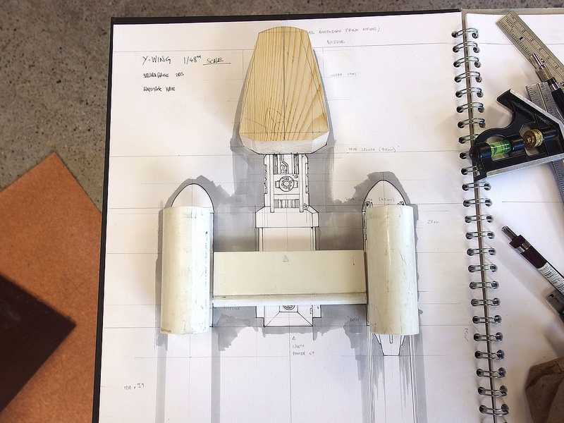

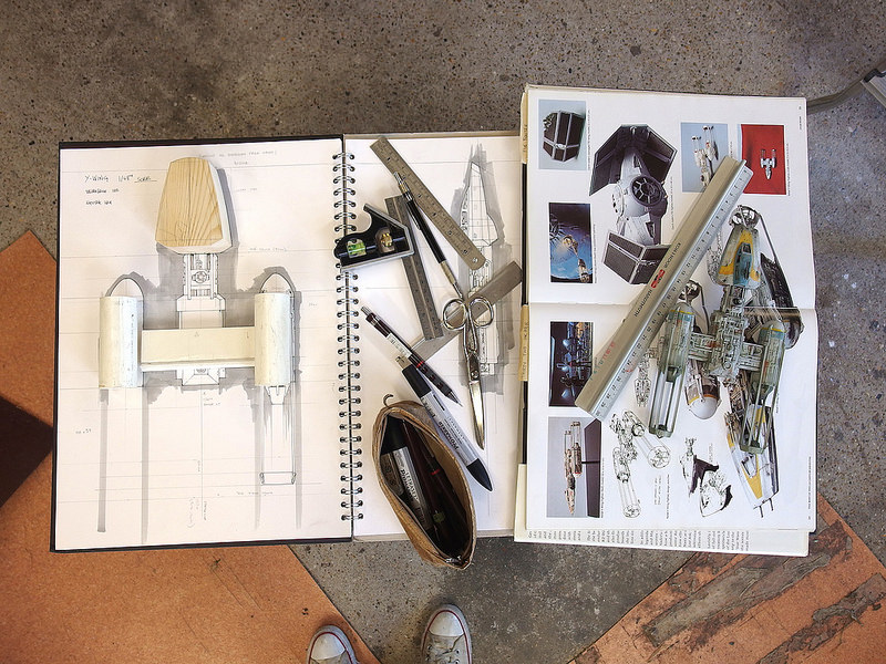

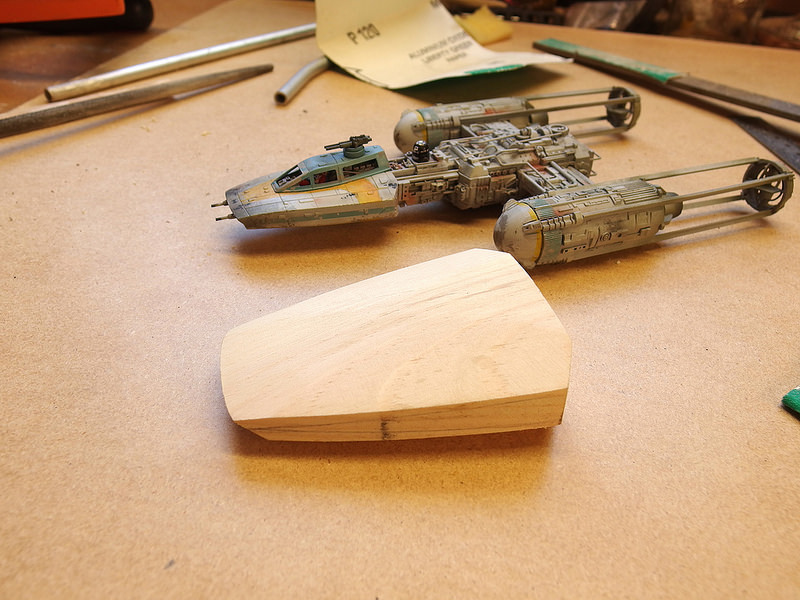

I started out with a blueprint I drew by basing it off my corrected Revell Y-Wing in 1/72nd and also from information gathered through the RPF and various SW art books.
The wooden components are all mock-ups and/or vacuum forming bucks, the final masters are built in styrene and resin
The fact that the studio models were in 1/24th scale and mine is exactly half that size has been very fortunate when it comes to donor kits- I was lucky to already have a 1/48th Hurricane V12

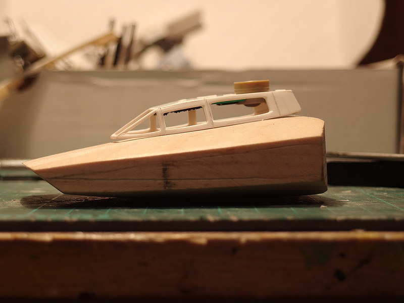

Anyway, nice work on your scratchbuild! You may want to rebuild the canopy master though; wider, lower and the top (everything behind the front window) should be completely flat. Looking forward to your next update!
Solid information, this is why I love the RPF. The canopy is definitely not correct, I just whipped it up on the belt sander to get an idea of size and shape, I'll be building the proper master out of styrene

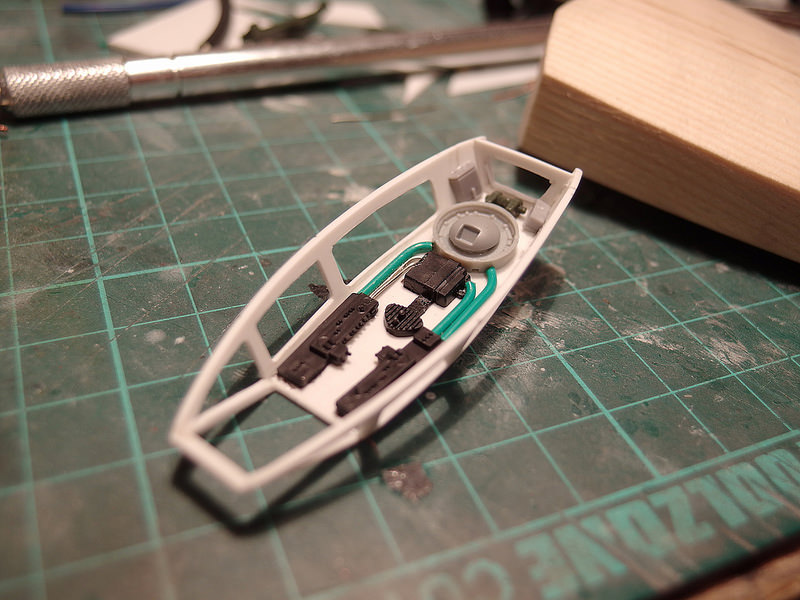

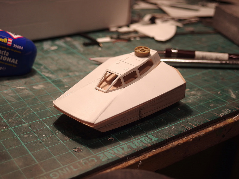

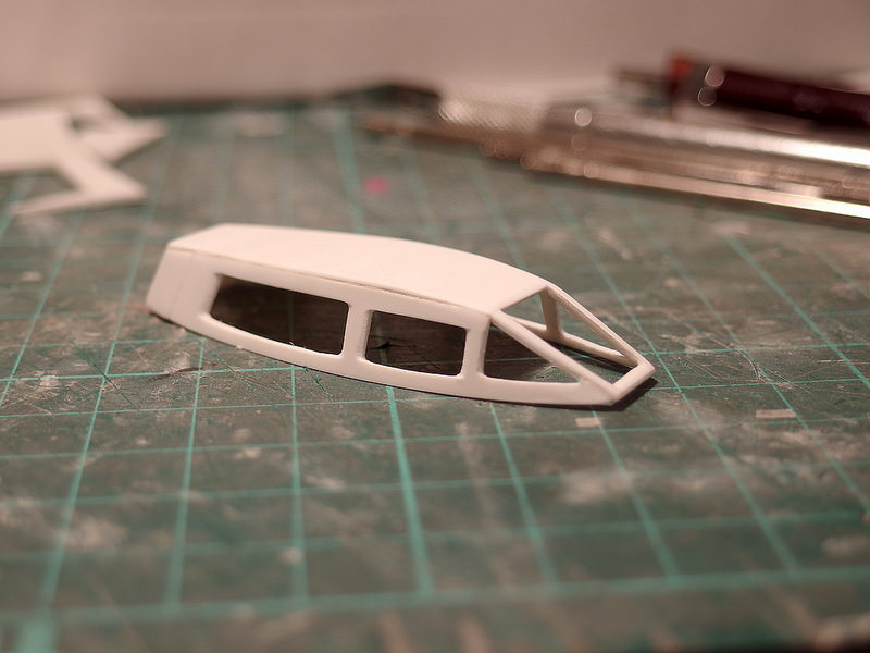

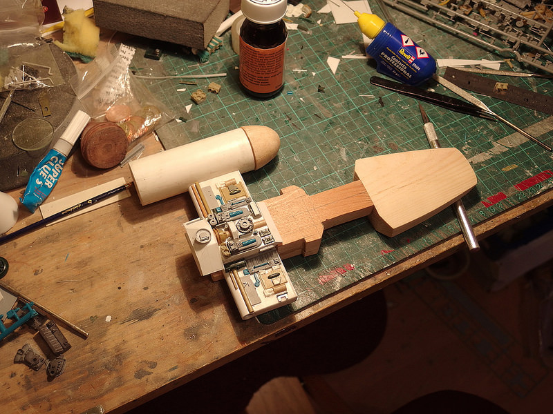

Today I was mainly focusing on building the cockpit, and starting the head.
I must've spent at least 6 or 7 hours making the cockpit canopy, trying to get it right, but it's a tremendously strange shape to get perfect (or at least that's what I found)
I detailed the interior ceiling as much as I dare to mould, and then began creating the new styrene head, using the wooden piece as both a forming buck and a prototype. I'm not very keen on 'skinning' the wood pieces with styrene as it's just as time consuming as building entirely from sheet plastic.
