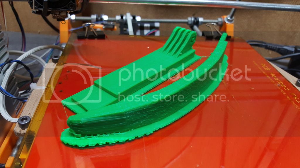

    After seeing The Avengers, and Hawkeye flips his bow and it unfolded, I knew I wanted one. I'm not going for screen accurate here, I want functional. In the movie, he's left handed and I'm a righty.
    Here is my first 3D print of the Hoyt Buffalo riser (right handed). Measuring 18 - 3/4 inches long. Printed with 50% infill, 3 perimeters, over 7 hours.
    [​IMG]
    I'm not happy with how thin the handle came out. I wanted to build the grip and controls separately. (I might still use this. I'll just need to weld the grip into place to reinforce the strength.)
    I'll redo this with the grip, minus the buttons. This will create a sturdier grip and minimize chances of breaking.
    I've already worked out how to "lock" the limbs open. I just need to prototype it to make sure it will be strong enough.
    After 3D printing the limbs to check functionality, I'll be making the final out of fiberglass. Using black ink, I'll be able to give it a carbon fiber look. (I have fiberglass already. If I like it I'll order some carbon fiber later.)

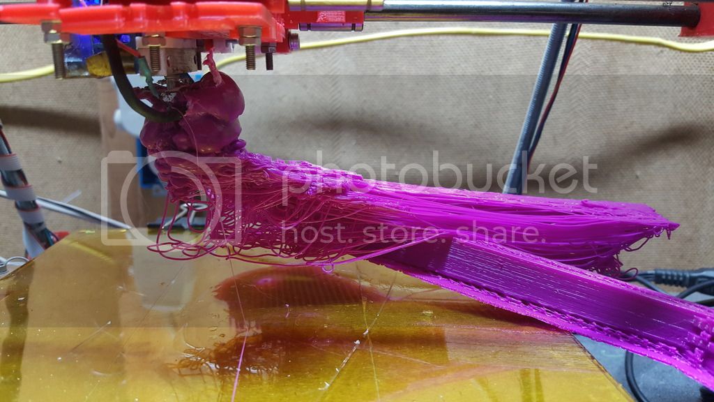

    I started printing the middle piece of the riser. Everything was going well so I left it to print overnight. I awoke to this...
    [​IMG]
    My 3D printer is currently down until I can fix it or calibrate one of my others that I never got around to using.

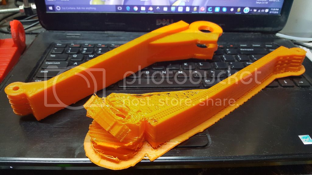

    I went ahead and started to try on my custom "King" size Prusa Mendel. I redesigned the original files so I can print up to 200mm tall.
    [​IMG]
    As I'm typing this, I can see the print lifting off the bed. I'll clean the surface and try again.
    Edit: The second try started peeling as well. Thinking it's my filament, I switched to orange. While changing the rolls, I noticed that the purple is PLA. I'm not set up to print PLA. When did I order PLA? Did I not read the product description? Or, did they send me the wrong roll? Oh well. I'll find a use for it later.

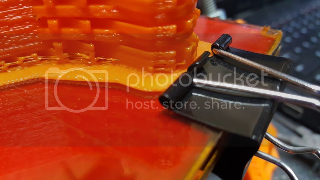

    I've been doing a lot of 3D Printing on my backup printer.
    I was finally able to print the second part of the limb. This piece has a hinge at either end and the shaft, is curved, and tapers down at one end. That makes this piece the hardest to 3D Print. I couldn't prevent lifting at the ends. I was, however, able to control it with a couple clips.
    [​IMG]
    Compared to previous attempts, I ended up with a good print to use.
