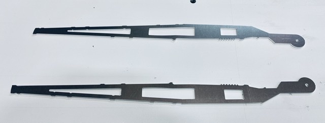

I am also going to modify my Hasbro U-Wing and definitely want to make some new, more accurate wings. I just CNC cut an internal structure for the wings out of .125” aluminum. I will test fit it in the next few days and report back.
