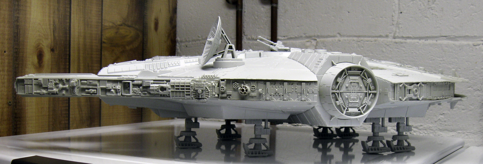

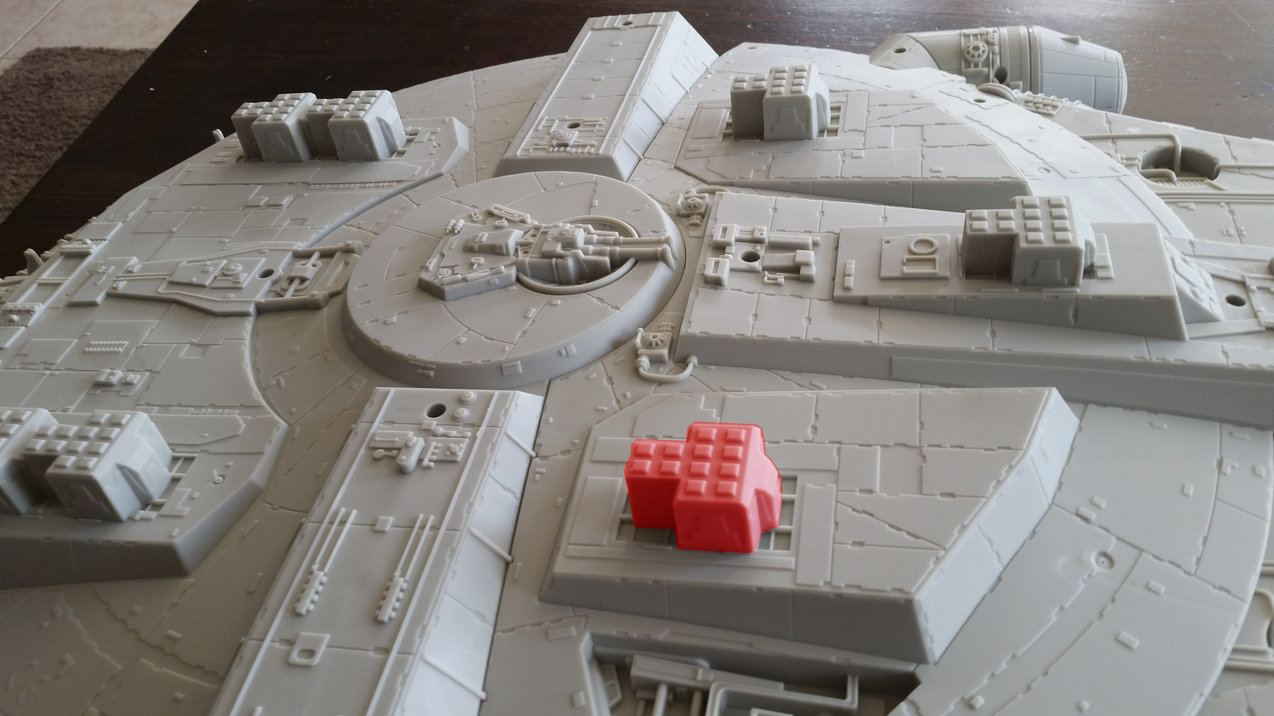

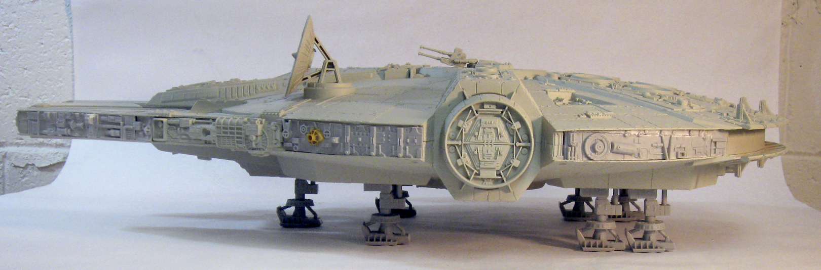

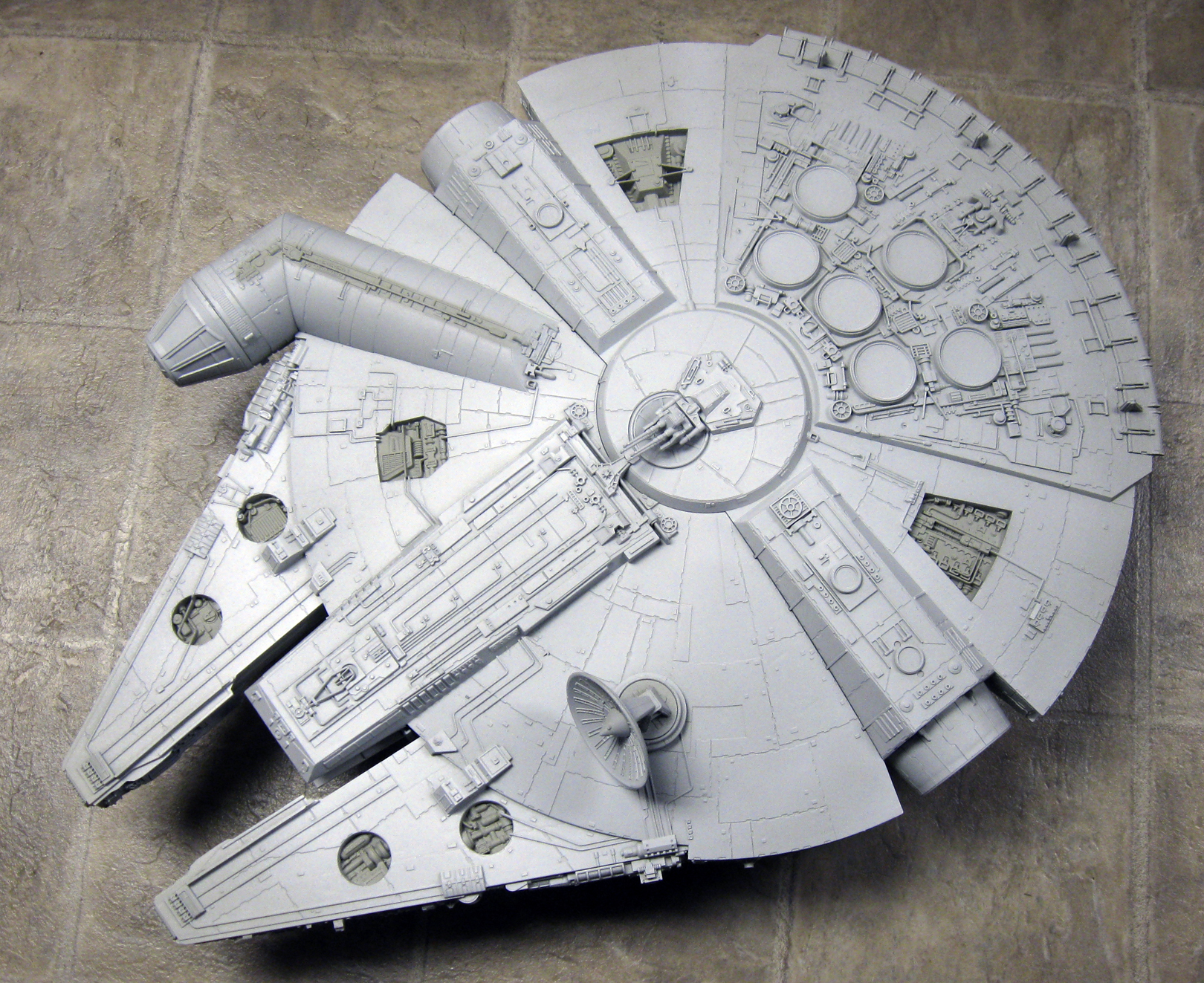

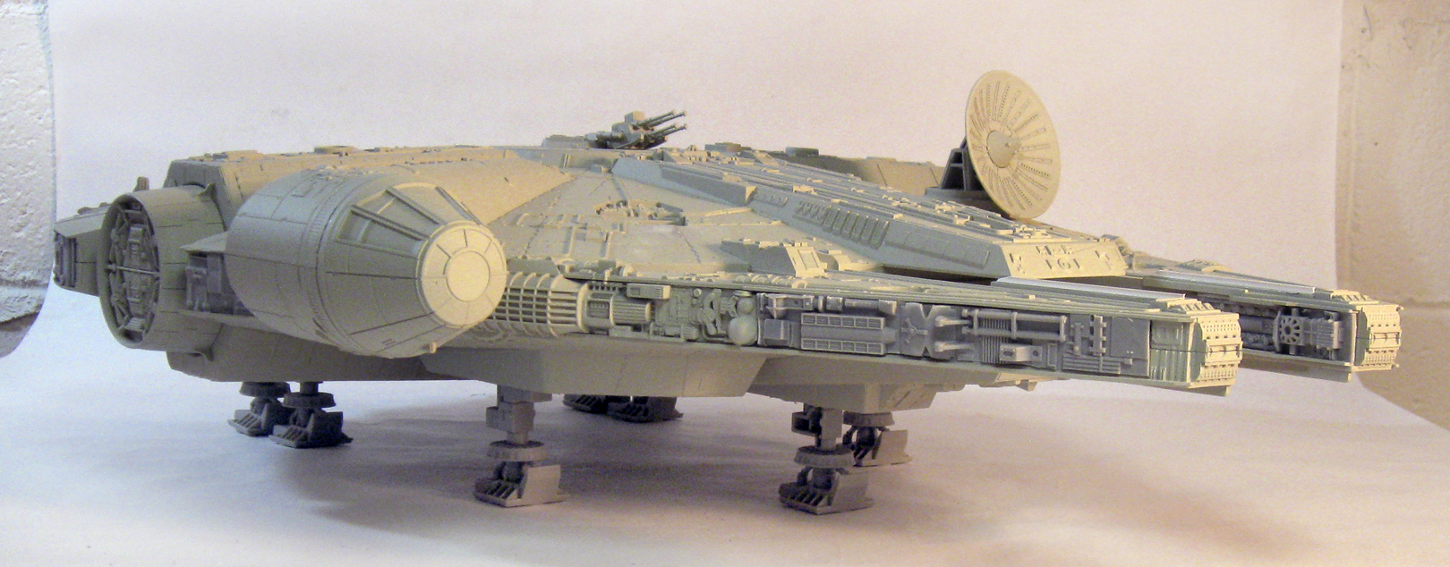

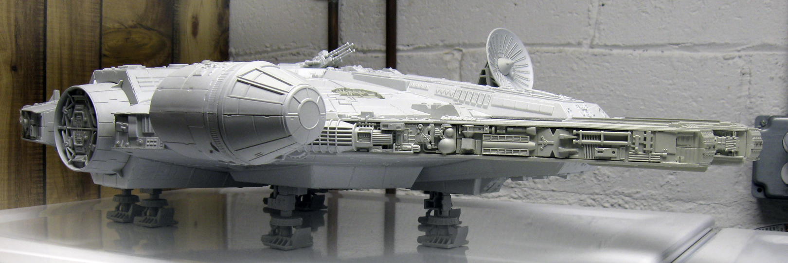

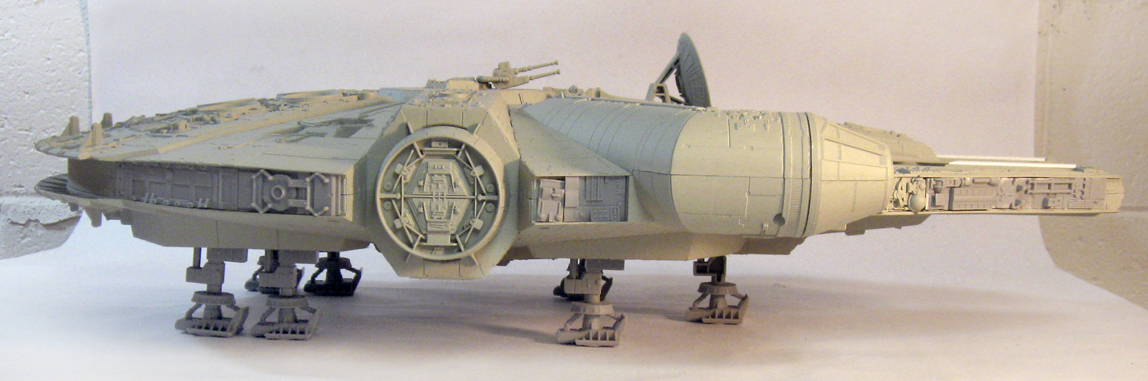

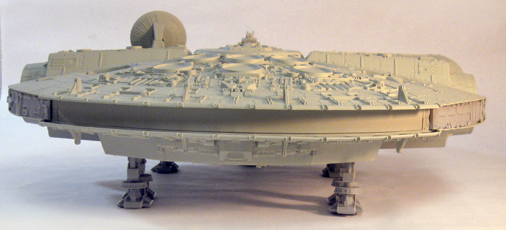

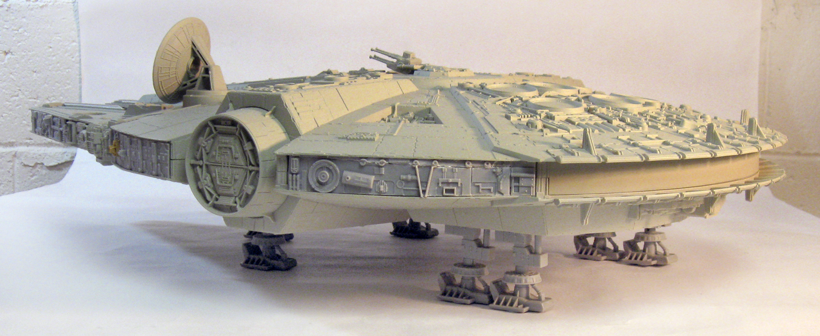

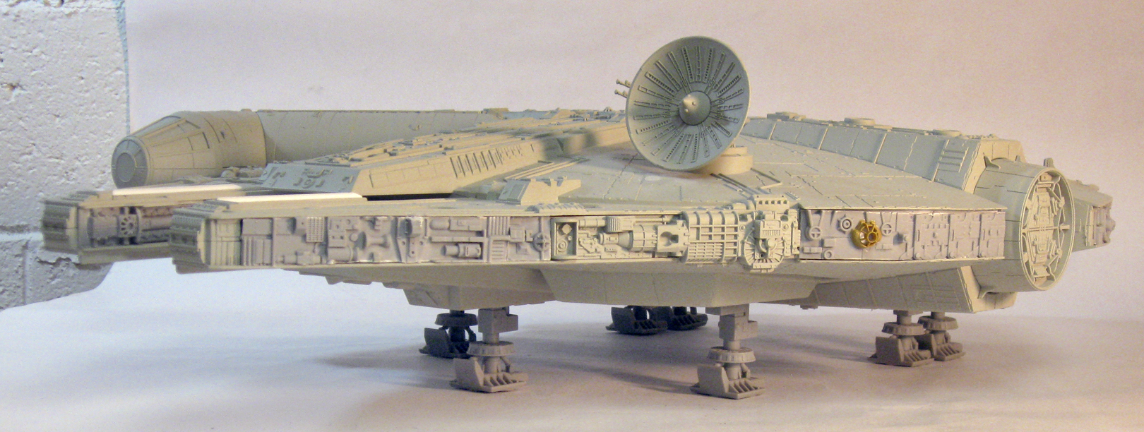

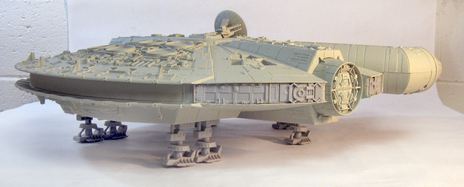

One; wash the model.
Disassemble it. There are 27 screws and three tab lock (cock pit / docking bays) pieces holding it together.
Remove all the side walls that require decals, along with the landing gear. SAVE these parts as you will use them as templates AND landing gear attachment points.
Disassemble your Hasbro Legacy Millennium Falcon side walls and decide were you need to cut them down to fit. The height need to be shortened and the length on most of the sides.

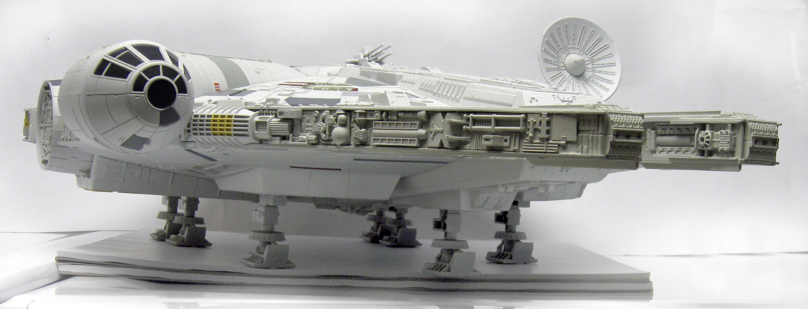

The landing gear will be installed the same way it is on the legacy falcon. You will use the cut off gear as the inside snap point for the legacy gear. LH_MLF_l.jpg
This is a minimal glue / pressure screw build.

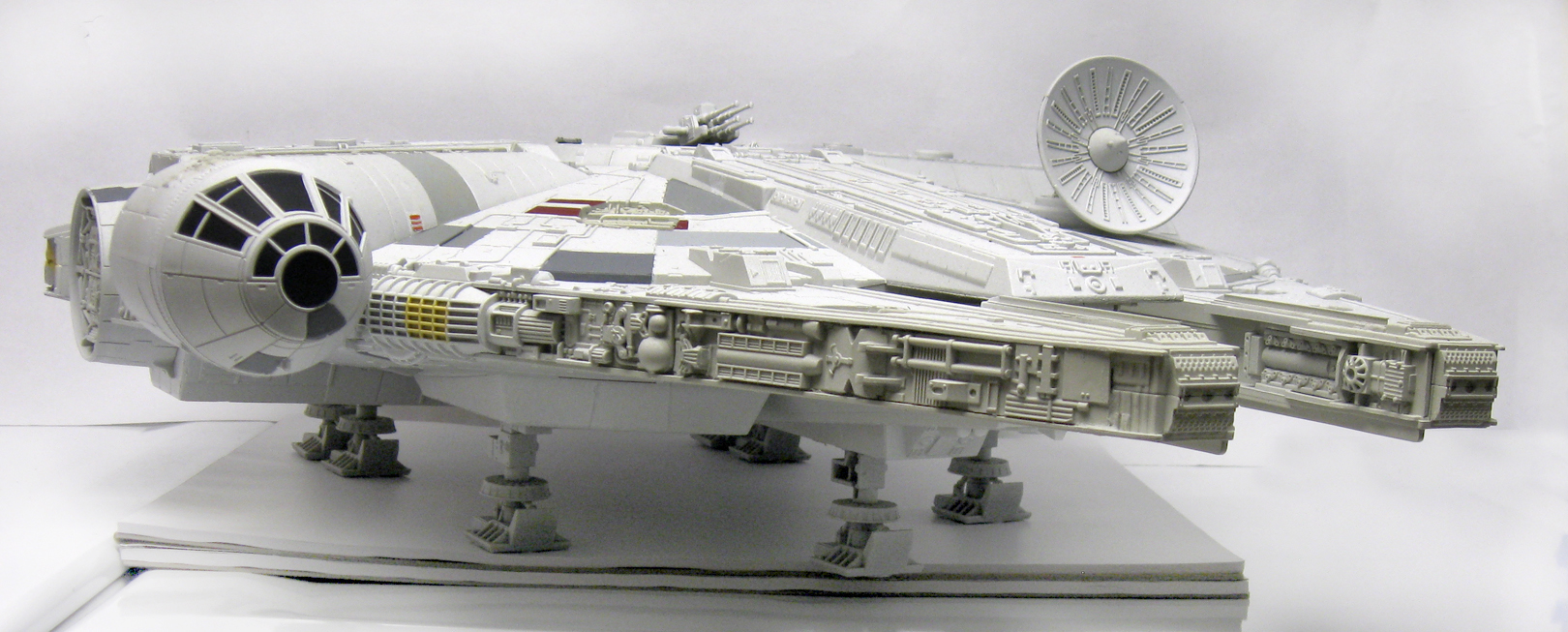

LH_MLF_a.jpg LH_MLF_b.jpg LH_MLF_c.jpg LH_MLF_d.jpg LH_MLF_e.jpg LH_MLF_f.jpg LH_MLF_g.jpg LH_MLF_h.jpg LH_MLF_j.jpg LH_MLF_k.jpg

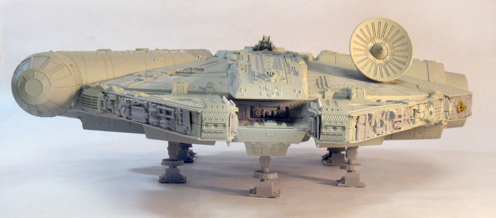

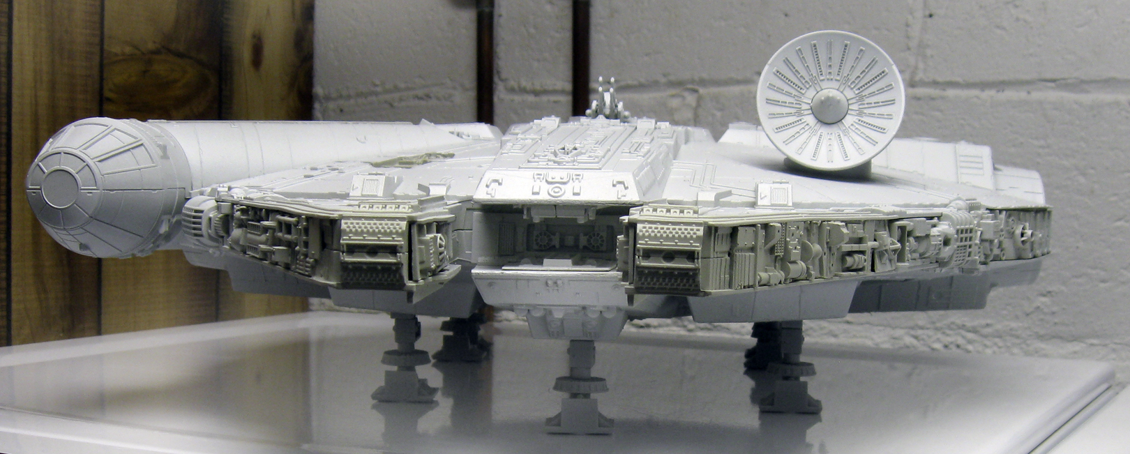

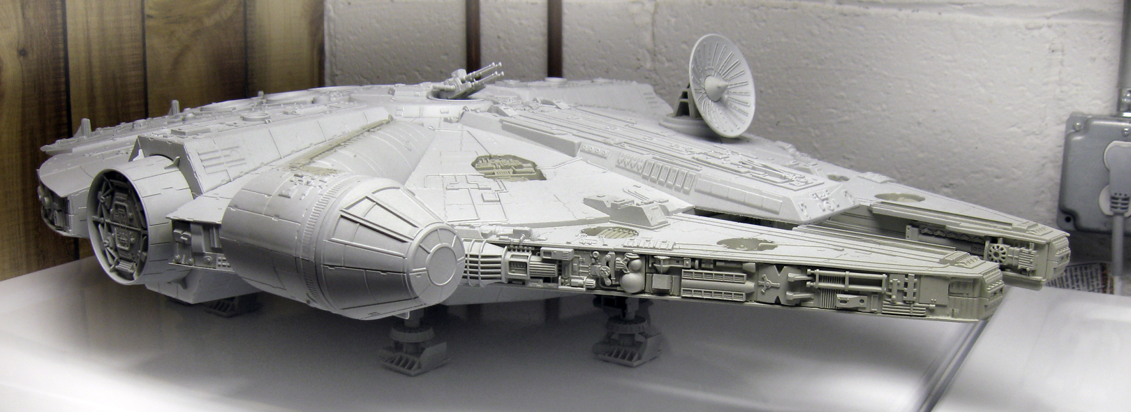

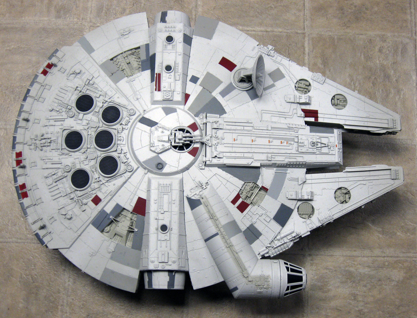

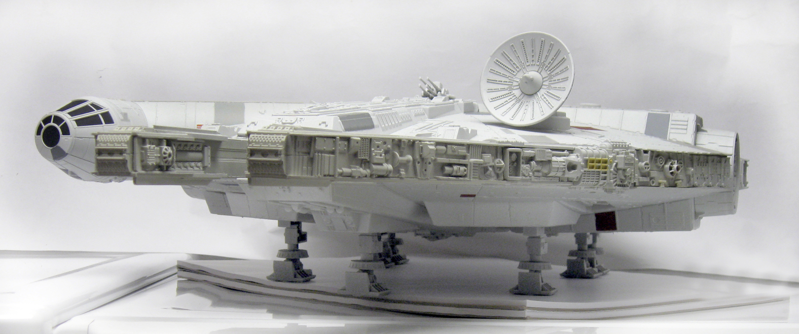

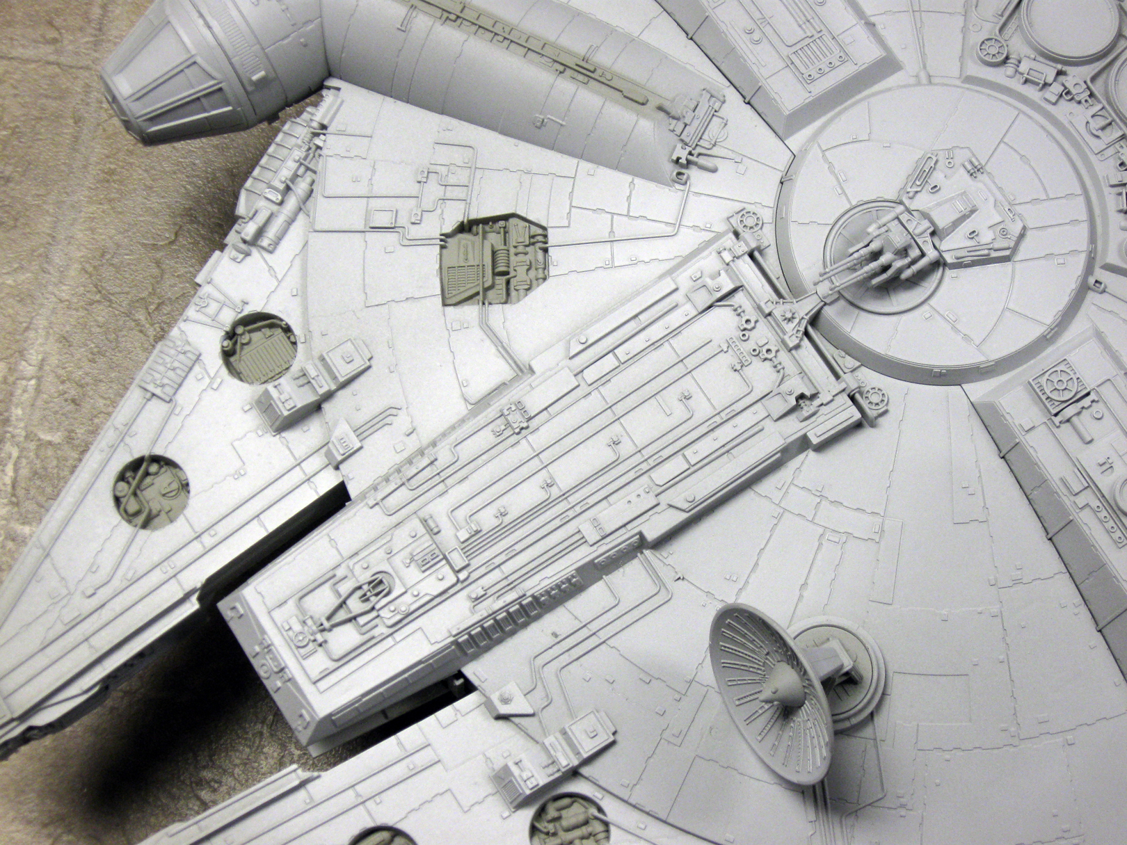

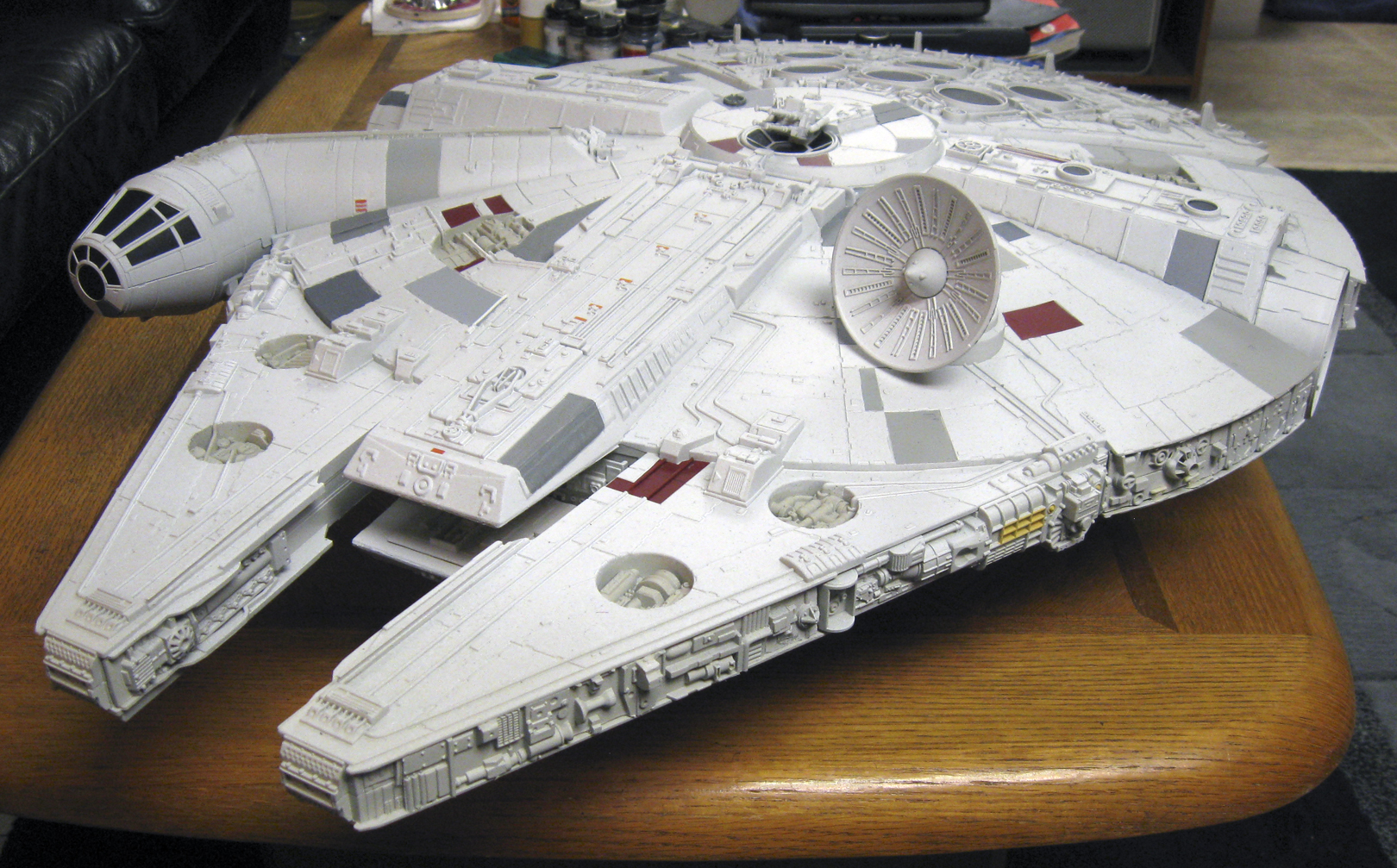

This is first paint and final build ie glue.

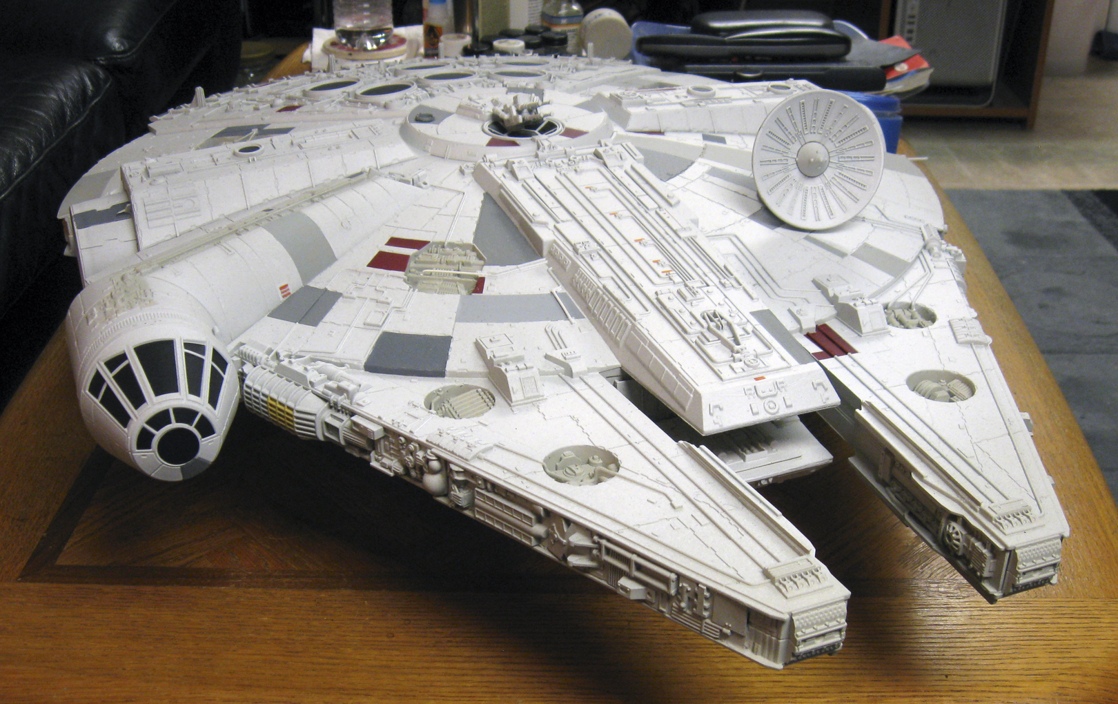

I use only 2 colors on Millennium Falcons. A. Testers rattle can Light Air Craft Gray as the base coat - two cans. let it dry for a minimum of 12 hrs.
B. Tamiya Mat White as the secondary coat. One rattle can. Why not Testers flat white? Tamiya is a different chemical make up and has a finer mist spray.
I mask off the open engine bays and loose tape the top along the cockpit access tube.
LH_MLF_m.jpg LH_MLF_n.jpg LH_MLF_o.jpg LH_MLF_p.jpg LH_MLF_q.jpg LH_MLF_r.jpg

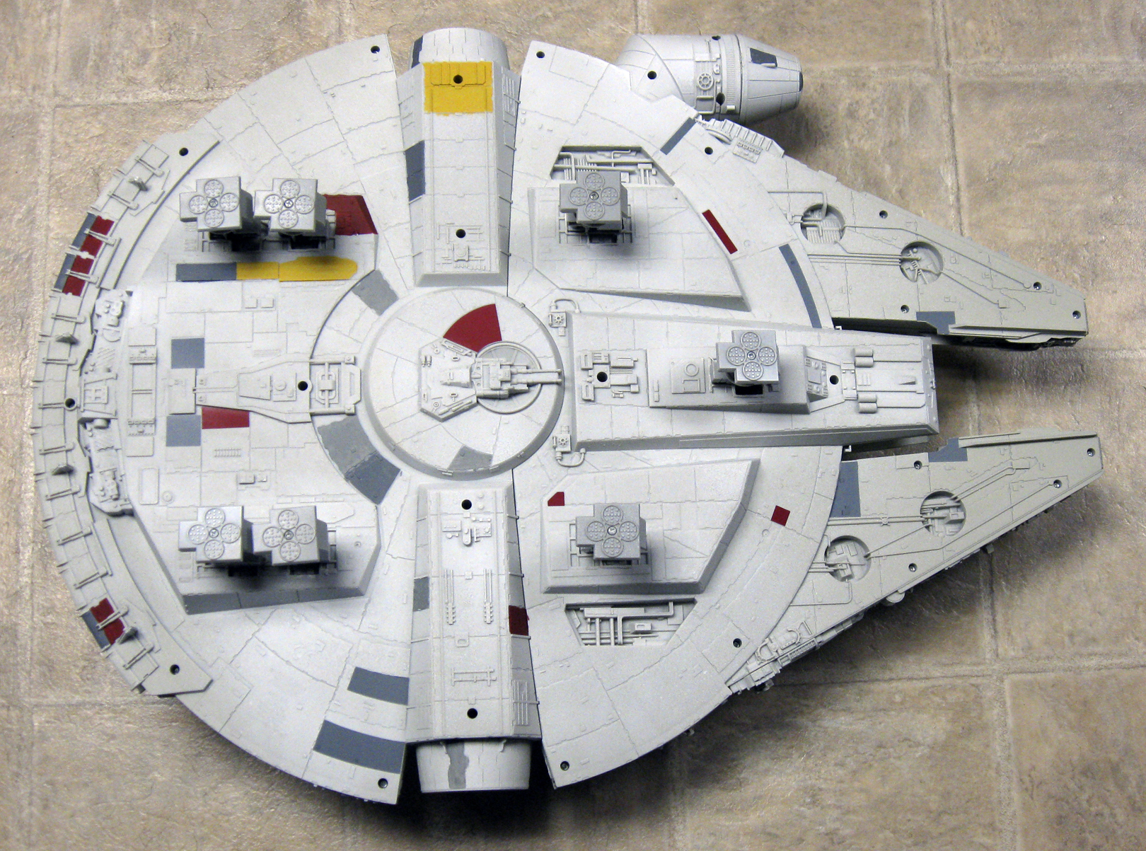

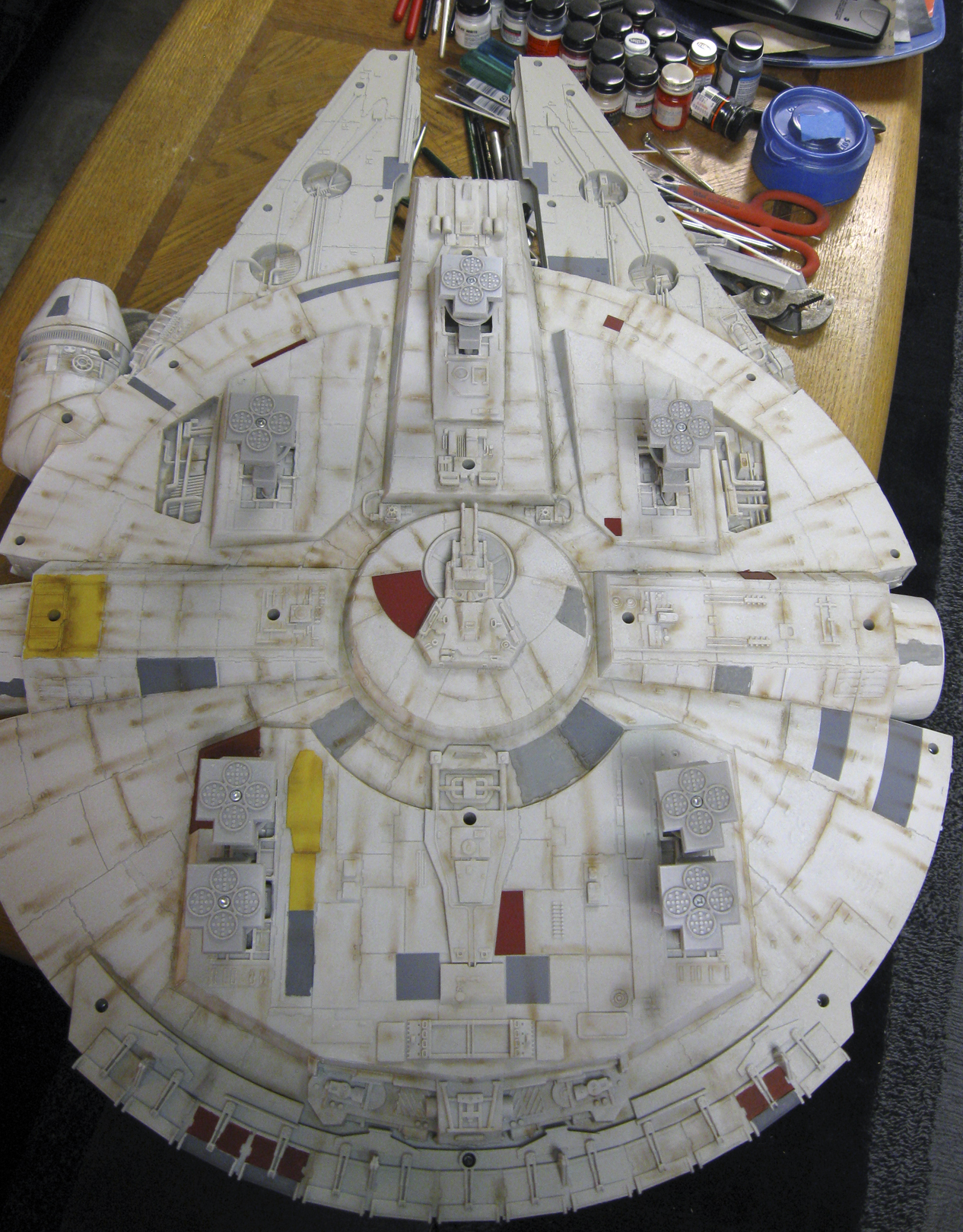

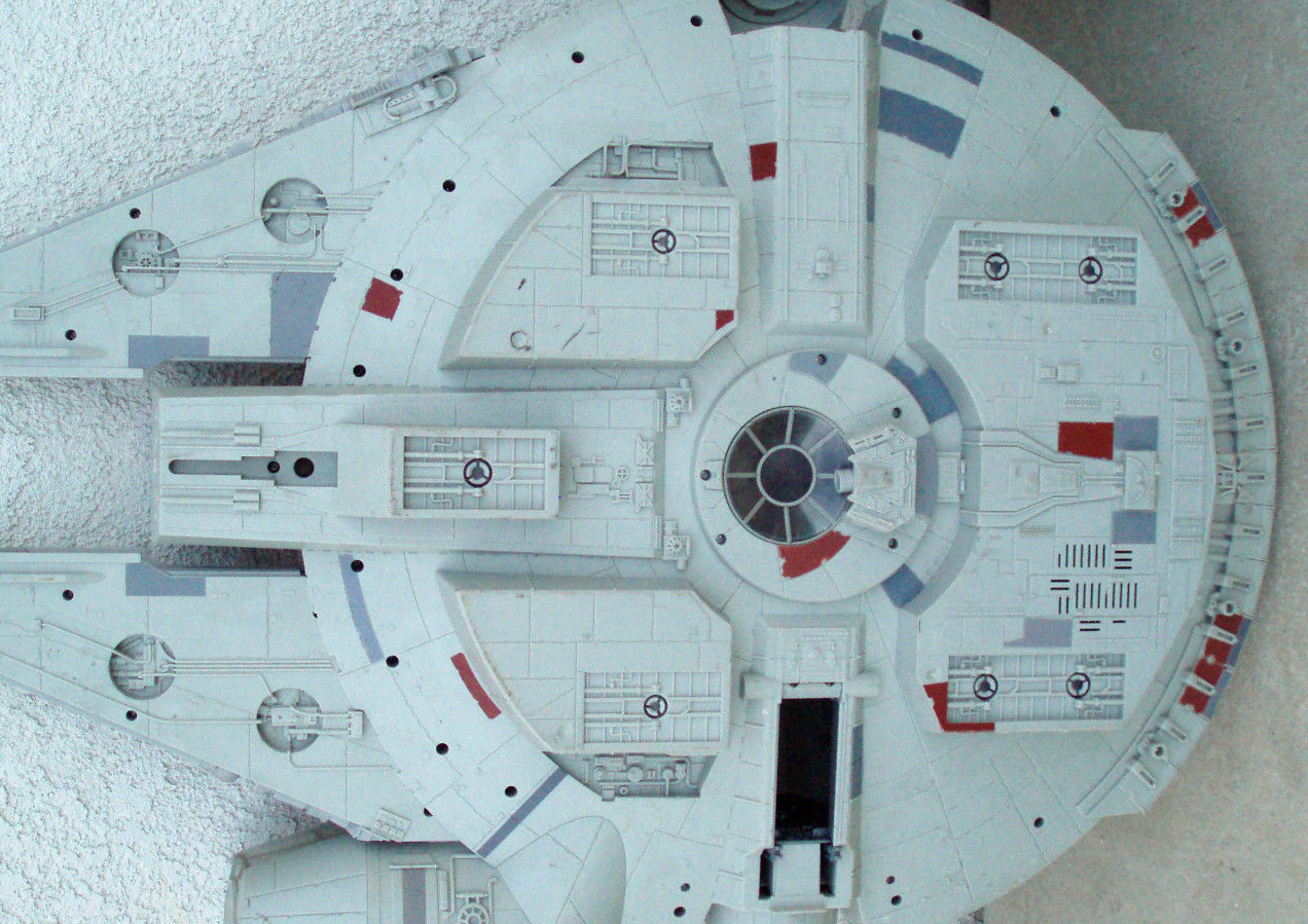

Next I applied the decals/stickers.
RHMLF_q.jpg RHMLF_p.jpg RHMLF_m.jpg RHMLF_l.jpg RHMLF_a.jpg RHMLF_b.jpg RHMLF_c.jpg

You plan to paint those sidewalls? They look a sand color against the white. No weathering at all? Its a clean build but lacks a bit in the realism department. After all that work the thing looks nice but too close to a toy appearance IMO.

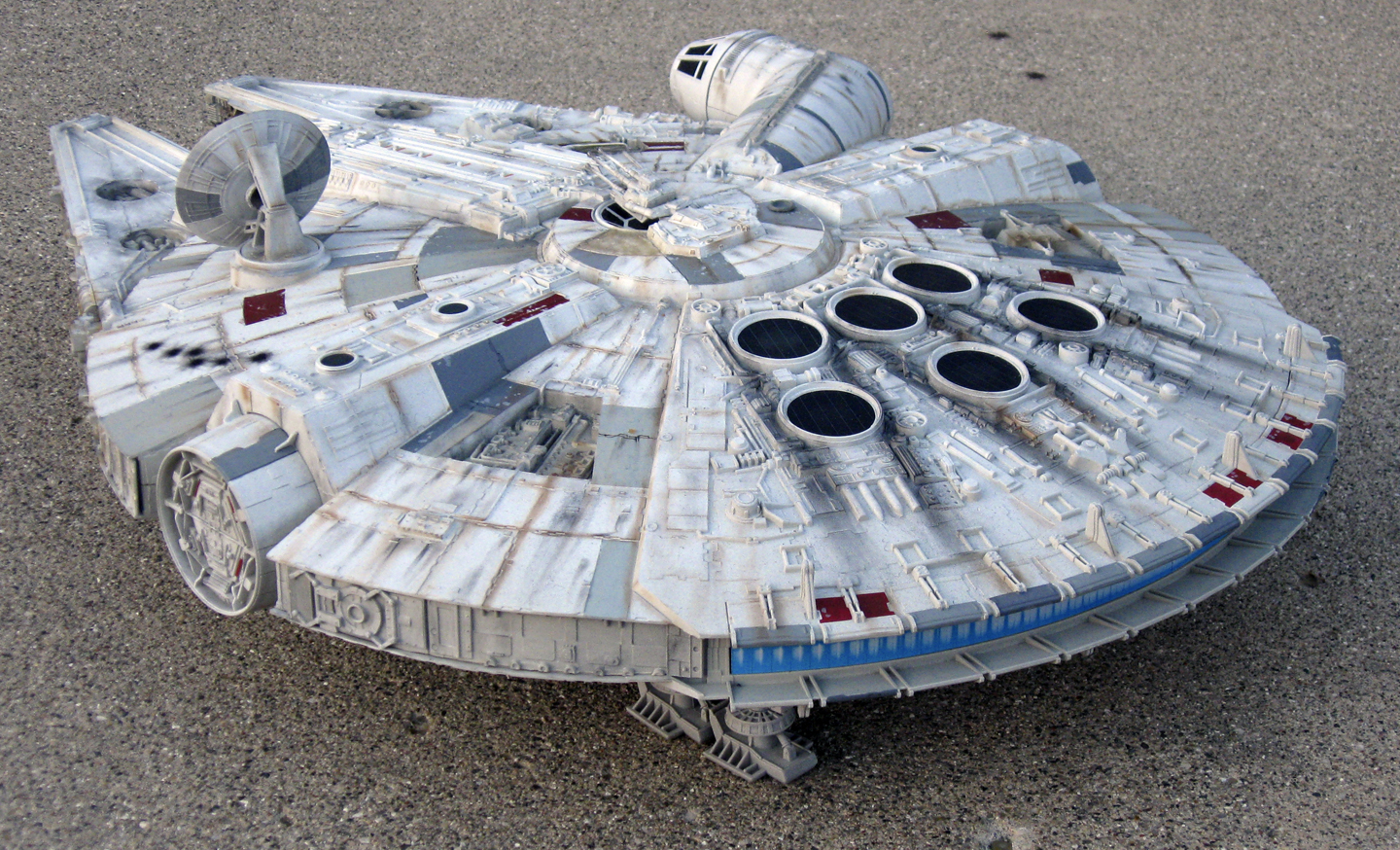

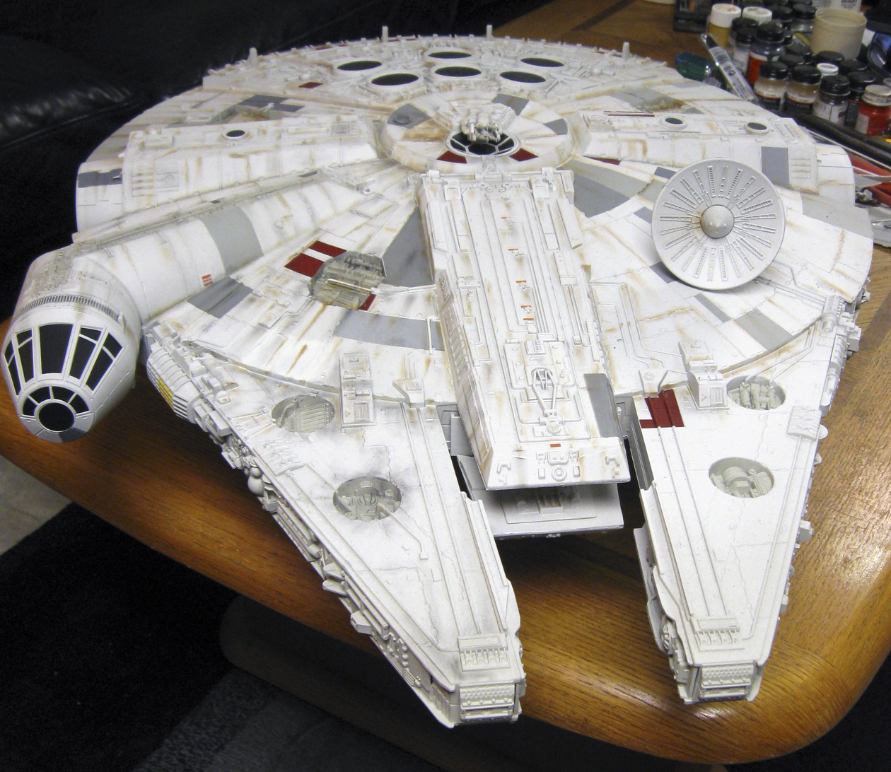

Cont. Weathering. Tools: Tamiya Weathering Master - Snow / soot /rust and Orange Rust /Gun metal / silver, Small stiff paint brush, Old chewed up small paint brush and supplied weather sticks comes with Tamiya sets. Testers DUL Coat 2-3 cans
These are as CLOSE as you can get to air brushing with out actually using an air brush.
After the decals/stickers are applied use a light coat of dull coat and build it up as it dries. You want to seal the stickers so they can be painted on.
I think all the colors are accurate with the exception of the warm gray. I used a neutral gray acrylic wash to match the paint color used on the legacy falcon.
The nice thing about the stickers is there is enough unused arias to cut out the missing panels needed. ie the small red aria to the R on the left open engine bay in front on the left front quarter panel.
When you weather the falcon it is very easy to OVER weather it.
I do rust first over the whole model. Then soot/ oil, lastly the blaster marks.
Last I put on the decals. Uhm,.. DIDN't You already DO that?

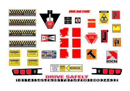

I'm talking about the decals that are on the 5 ft version.
LMF_Decal_1.jpg Note: I have re-created the most prominent ones, these are NOT to scale yet and the verbiage is made up as the shots off the 5 ft are really hard to read.
I'm thinking about making these available once I'm finished and have scaled them for the legacy HMF and the Rebel HMF. it will be a pdf that you can print on to decal paper.
Or possibly have JT Graphics do them.
This is with the R side just with rust and the beginning suet / oil on the R side.
RHMLF_o.jpg This is just rust

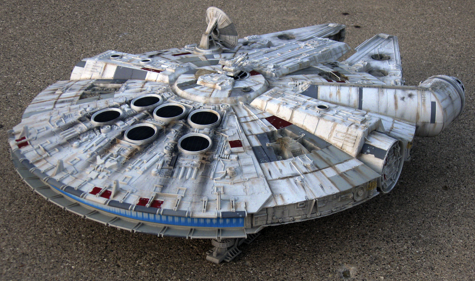

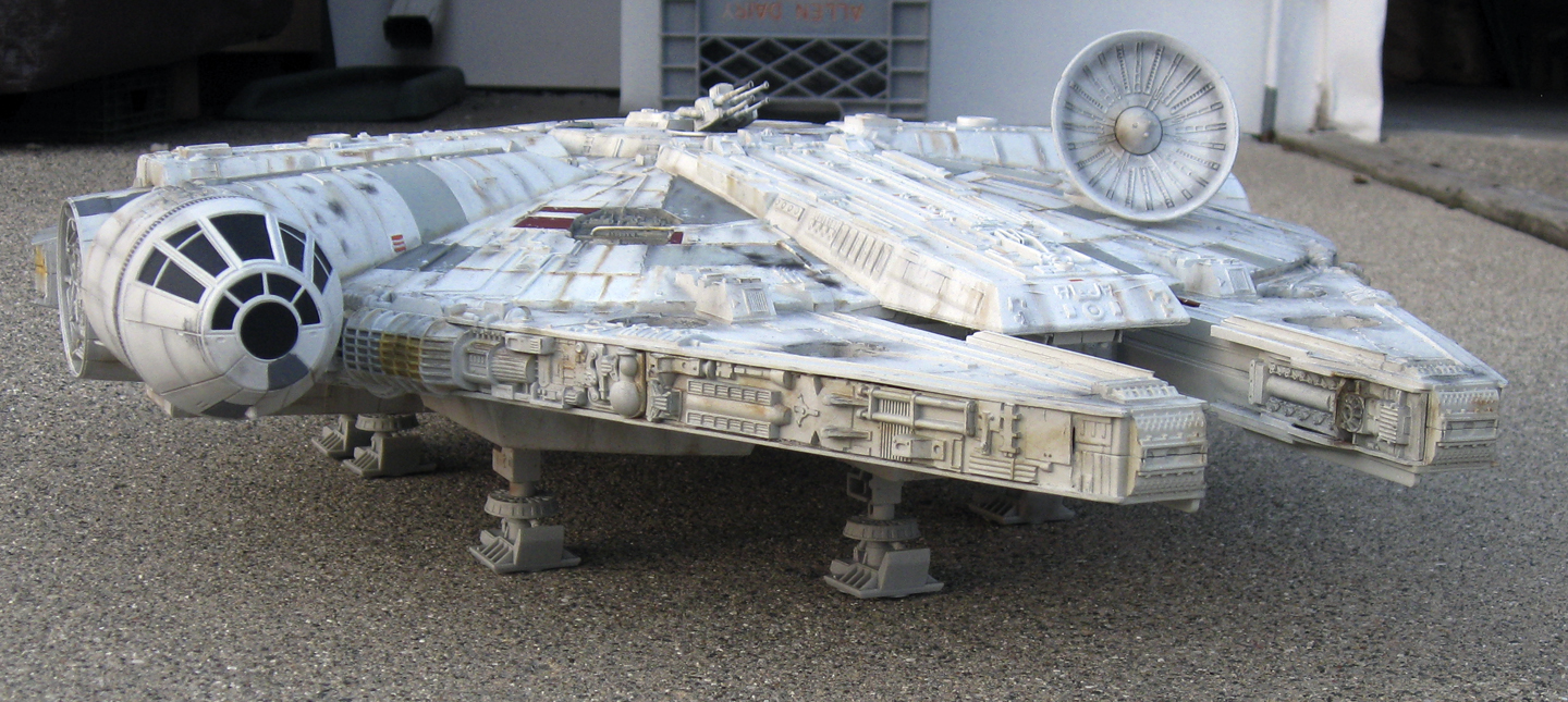

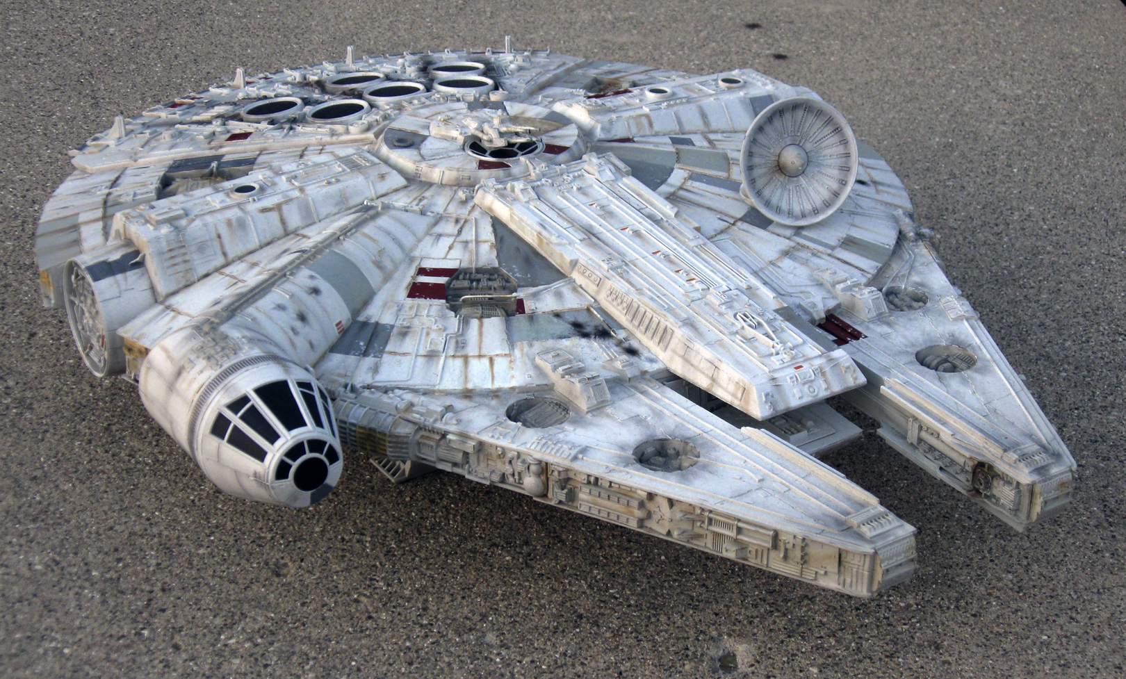

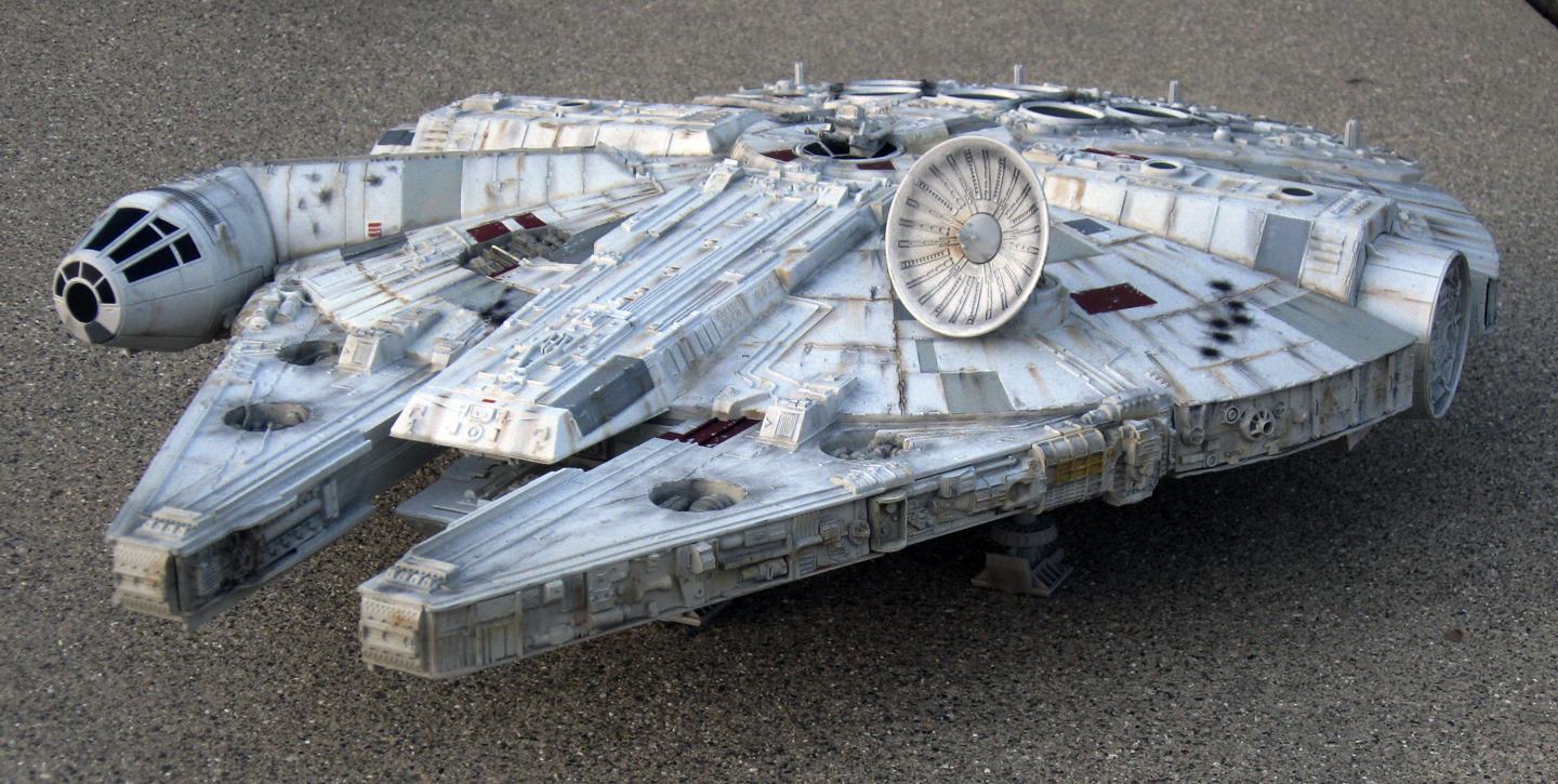

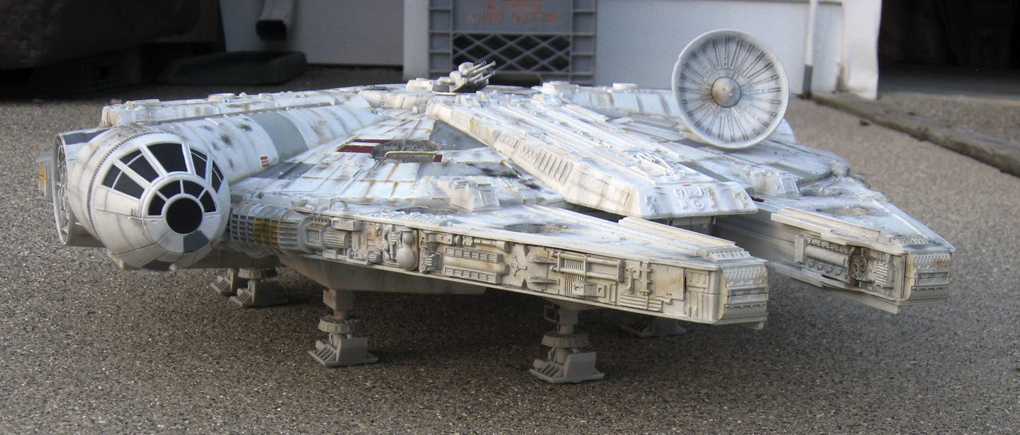

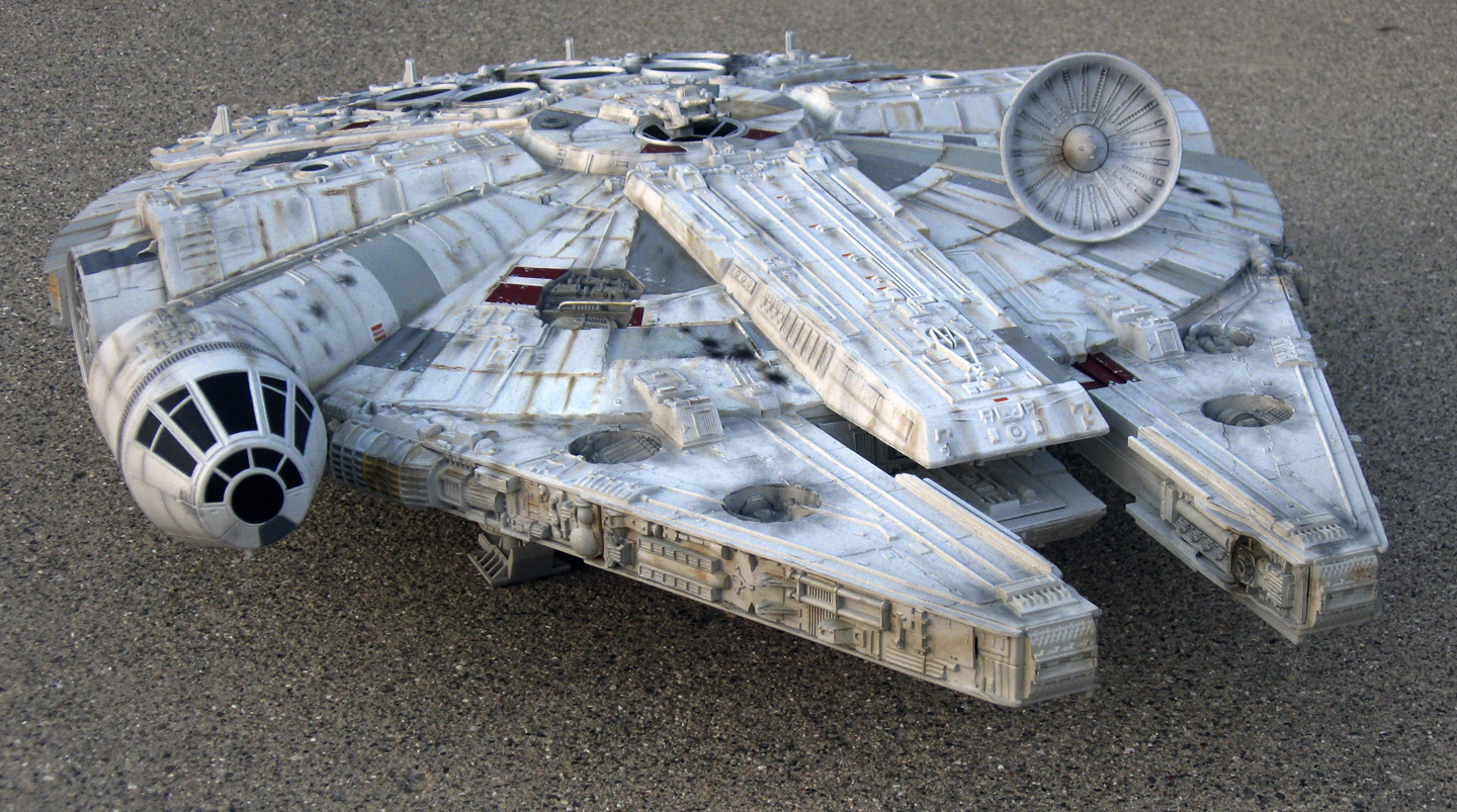

This is the top and side walls with most of the final weathering and blaster damage. I need to tone down some of the dirt and dry brush some of the details with white to bring them back a little more. I still need to do the soot / blaster damage on the bottom and landing gear.
RHMLF_r.jpg RHMLF_s.jpg RHMLF_t.jpg RHMLF_u.jpg RHMLF_v.jpg RHMLF_w.jpg RHMLF_x.JPG
Last will be the final decals once I'm done weathering it.

joberg
Good job on the painting business...seems to me that the landing gear is "too clean" compared to the overall look of the ship. But for that price and elbow grease it's a mighty MF you have there:cool

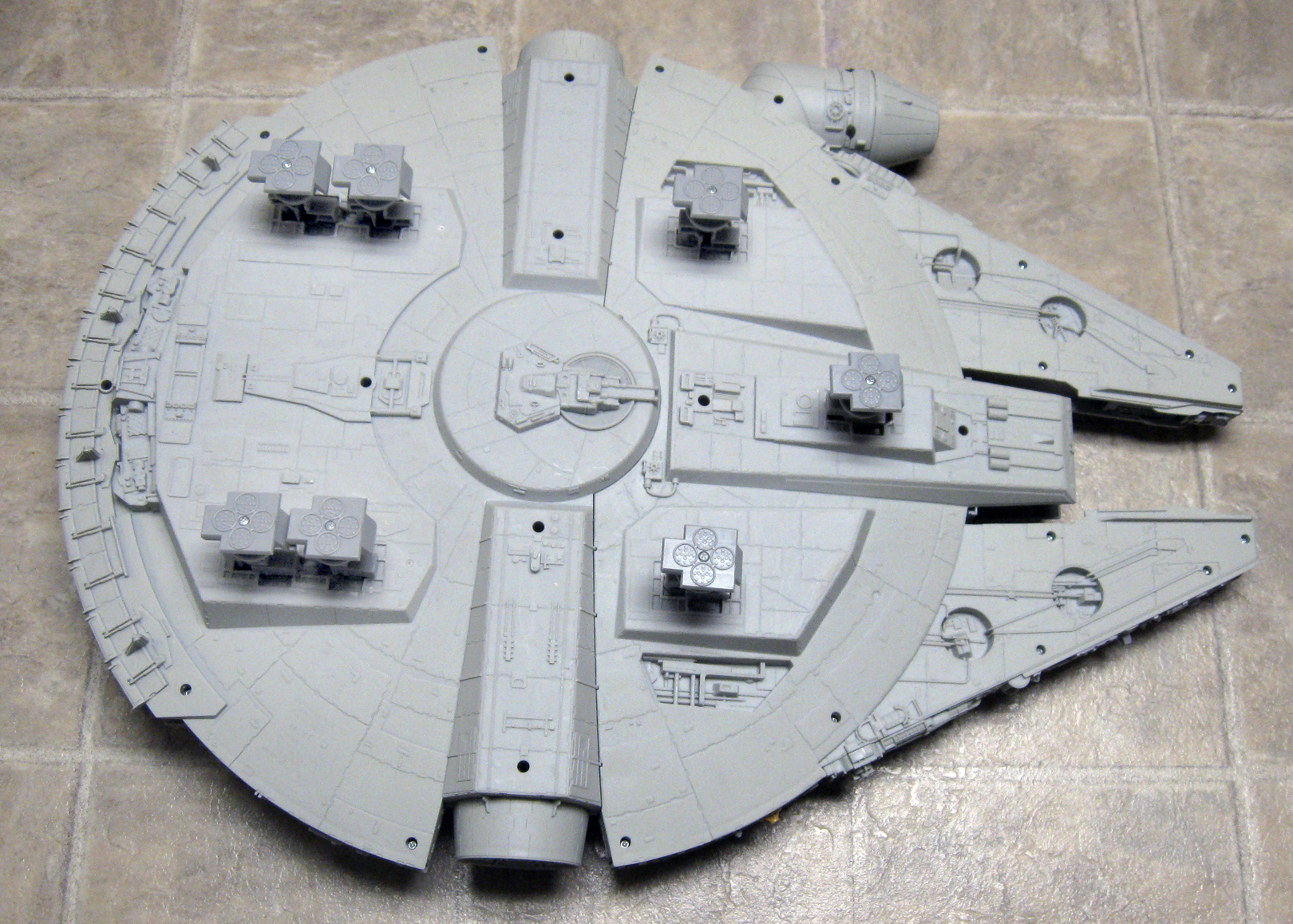

landing gear conversion using Legacy Mil Falc gear;
Leg Landing gear.jpg It has snap in holes. You are going to duplicate how these are attached on the HRMF model.
There are 2 types of gear on the HLMF. Knobby style; HLMF_B.JPG and cone style HLMF_A.JPG
The Knobby style are the R and L front gear. All the rest are cone style gear.
First Cut off the landing stubs on the HRMF model.
Use your choice of saw (Dreamel / hand razor saw / hack saw / Xacto Knife) Cut flush at the attachment aria so you have a hole the same shape as the landing stub.
Save these as you are going to use them as your inside mount points.
Remove all five landing stubs.
File / sand / trim aria you removed stubs from flat and flush with the bottom of the HRMF model.
This is so the model will sit with all gear on the surface once the gear has been attached.
Note there will be some play in the new landing gear when attached.
Line up the appropriate landing gear with the removed landing stubs in each open well with
the stubs on the inside of the lower hull and the new gear coming up through the cut out openings.
Use any type of tool ( marker / Xacto ) to mark the position on the stubs were the knob point on the new gear touches.
This is were you will cut new holes to attach the HLMF gear.
Cut out a SMALL hole as you want to make sure this is a TIGHT fit so the gear does not fall out.
I used an Xact as the plastic is really soft and it is easy to start small and enlarge it.
If you have done it correctly it should be hard to snap the landing gear in place.
Note; this is a semi permanent procedure.
If you want to display the model in flight you will need to disassemble the hull to remove the new landing gear.
Also you need to keep the shape of the cut out the same as the removed landing stub.
NOT a square cut. The indented shape keeps the gear in position and allows the gear to "clip on" around the edges.
You might need to trim the cut out aria slightly to fit the new gear, it depends on how close you cut to begin with.
