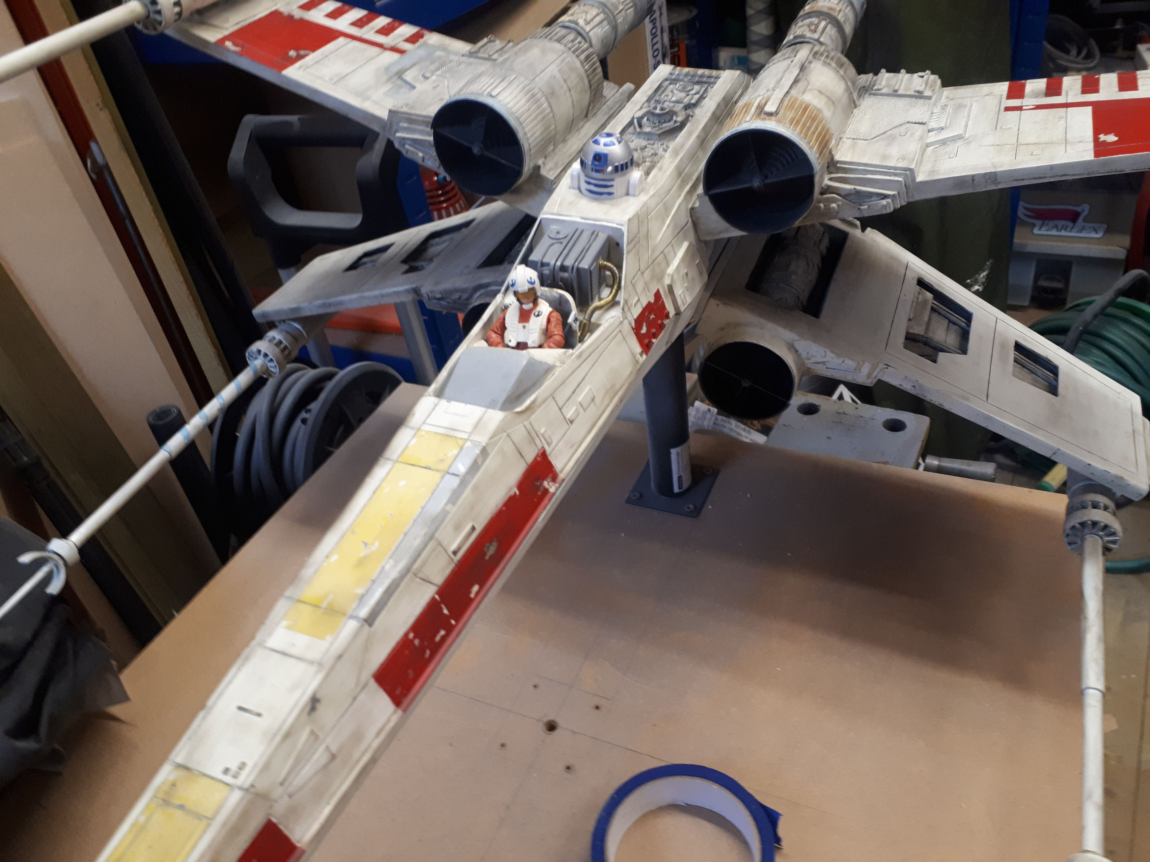

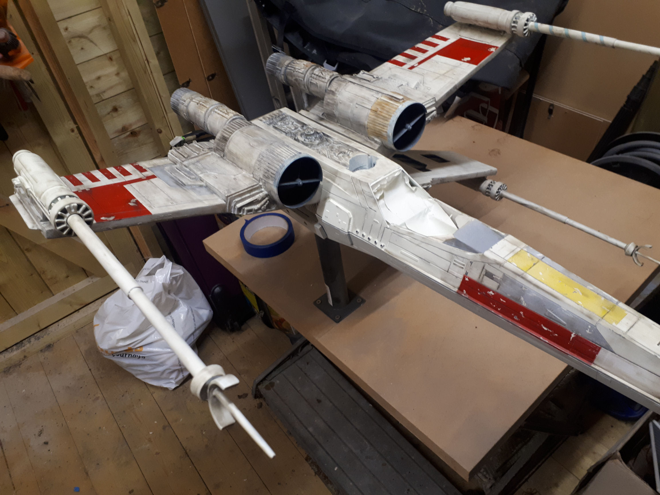

Yaris, I was inspired by your Build and did pretty much the same as you! Here is mine at present - just the cockpit to go now and the lighting.
yaris
Looks Great...!!!......do you have a build video...??...or even more build photos would be great.
Would be very interesting to see how you did your build, I get so much interest from mine, so many people want parts and advice, it's a very popular toy...:cool:...I've found it's really important to show the scale of just how big it is, many people often think it's just another small scale model, but at 1/18 scale it's the biggest anyone can buy and convert.
Great work, well done...!!
