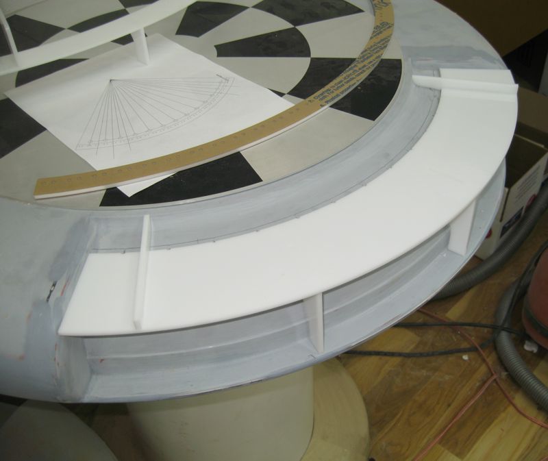

While forgotten by many and it may seem dead, this project is just slow going. After many attempts to get the keys done by others in volume including a very disappointing and time wasting failed couple of commitments from somebody that wanted to do them, I ended up just doing them myself with help getting going on molding and casting from Relicmaker and another local friend that worked on my Fett costume. I couldn't have done it without them and it has greatly raised my level of appreciation for those who do beautiful castings.

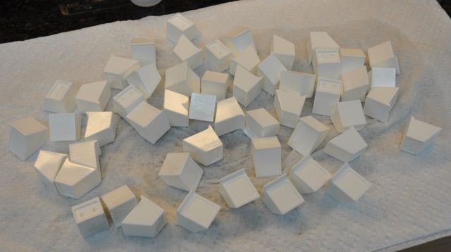

The table is making progress again with the completion of the process to make the 54 keys needed for each table from resin. While I had thought about pewter keys, and even cold cast keys, I think the resin ones turned out great and should paint fine along with the table.
Here are a few photos.

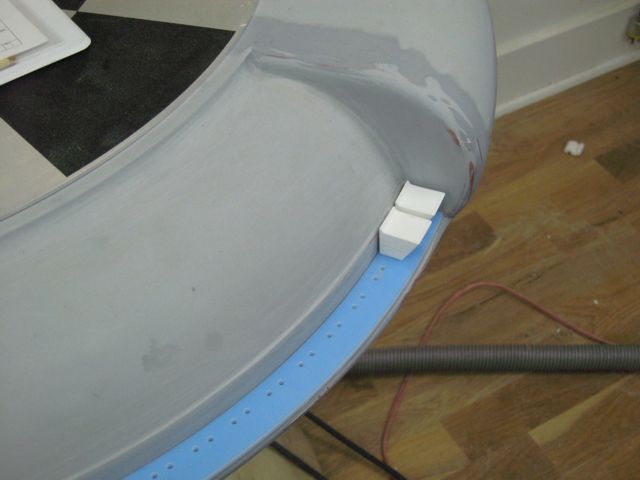

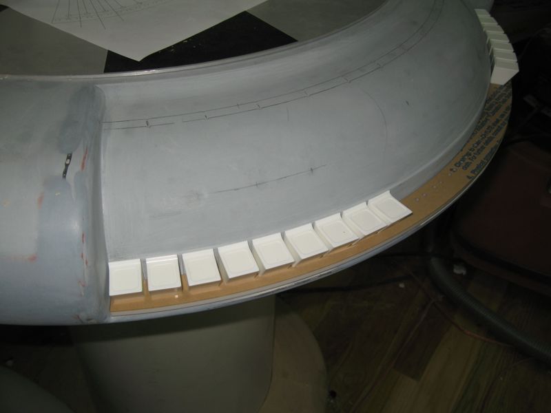

The final drill template for the key locations is done. I almost made a mistake here because I initially set it up for 26 keys and only at the last minute realized it was supposed to be 27 per side. They keys glue down to the table with metal pins inserted into the bottom of each key.​

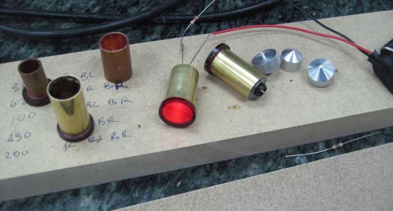

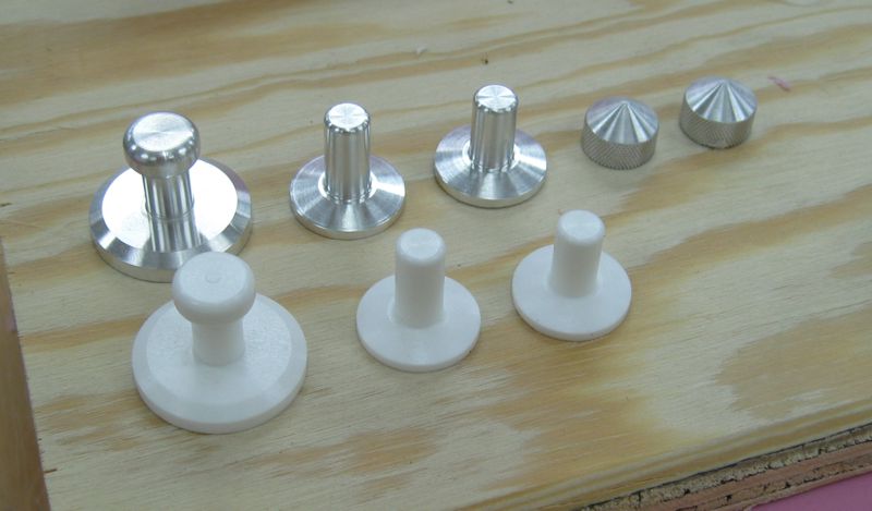

After a couple of revisions, these are the aluminum master knobs for each side of the table. Each knob will be drilled on the bottom and that will slip over the shaft on a digital encoder switch, rotate to choose, push to select. the knobs will work to control the table lights and sound.

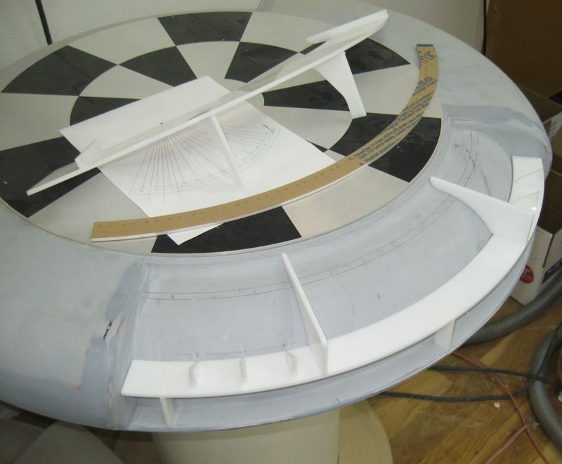

In order to have an accurate and consistent drill locations for the 26 lights and 10 knobs, I used the 3d models to create files so I could laser cut guide templates.

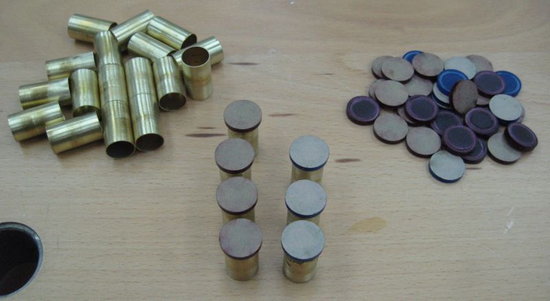

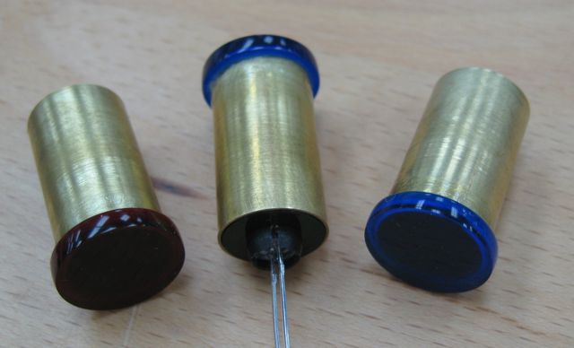

I've always known the lights would be a pain to build since the appear to just be round acrylic discs glued over holes drilled the table with a bulb under them. Good enough for the film, but it would not be great on this table. In the movie they kind of glow in the center, but have no light on the edges. After a lot of tinkering around, I came up with lights that I think will work fine. It's a lot of steps though so it takes a while to make 26 of them. They are made from acrylic discs, sandblasted to frost the underside, etched to give a place for a thin brass tube to be attached and the edges of each lens is polished glass smooth. The brass tube is sandblasted inside to eliminate reflective hot spots, glued to the lens and a 5mm LED bezel is inserted in a black acrylic donut glued into the bottom.
