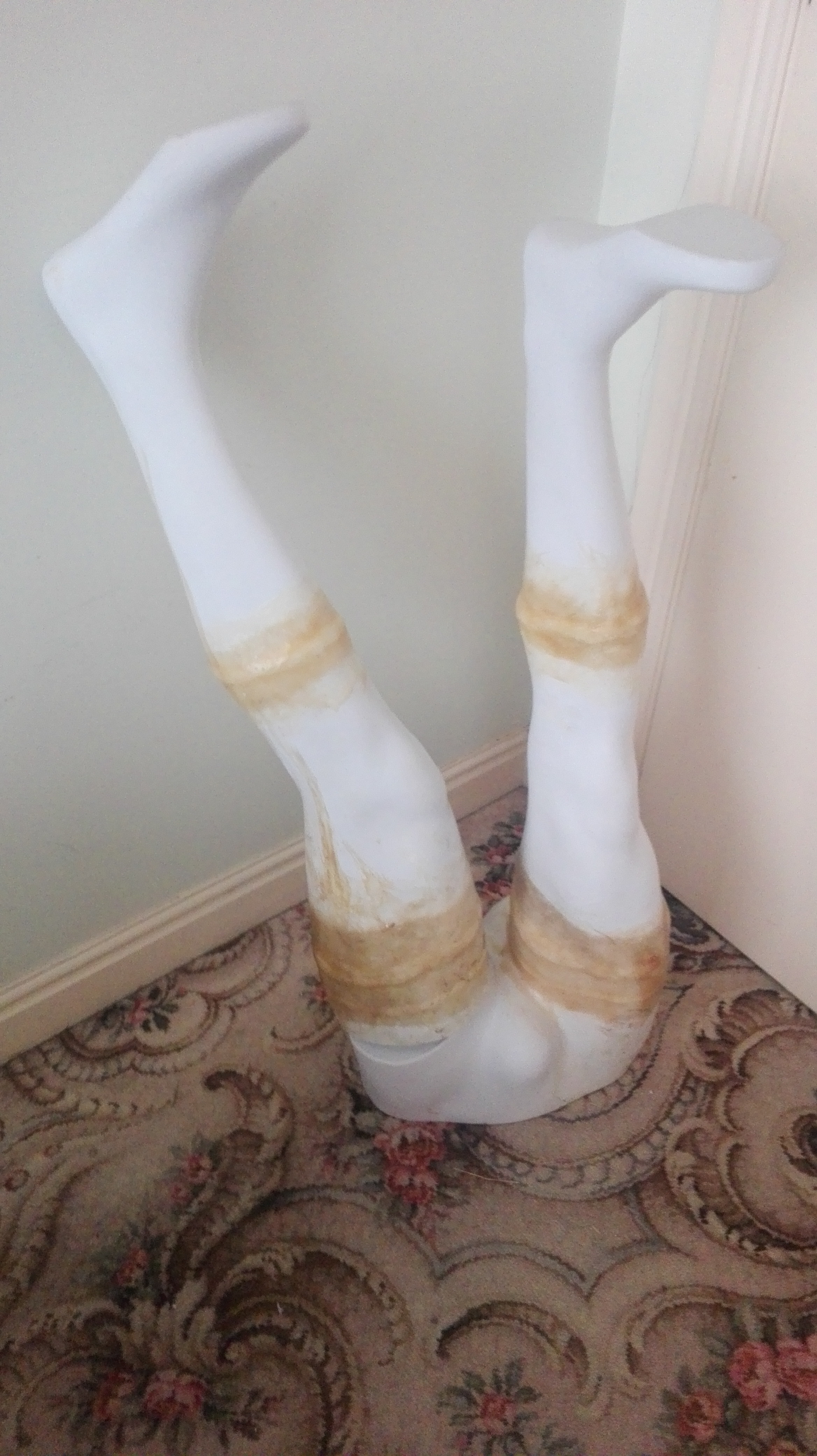

I cut a mannequin down to my height, so I ended up shrinking him by about 4". I took it out of the legs, I just made sure to take an even amount from each leg. I took it out twice, one below the knee and one above. This was because I wanted the knee proportions to be the same as me, and also because it meant there would be more glue joints opposed to if I just took a big chunk out.
When gluing back together, I used Gorilla super glue as an instant bond in the few places where the legs joined. Then I covered the seams and the gaps with Milliput. Finally, I fiberglassed them. They don't budge, although they creak a bit when I'm dressing him.
Be careful though, the more you remove, the less chance your edges will butt to glue.
