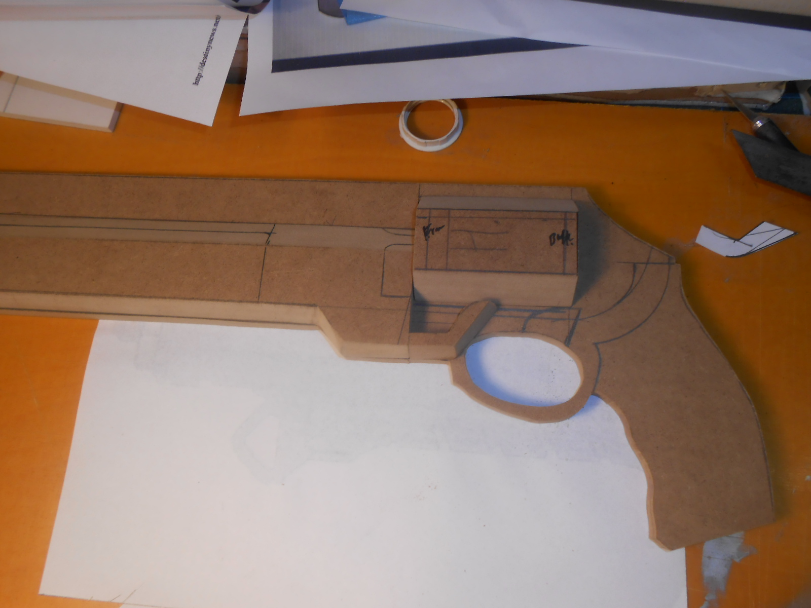

I started out with a piece of Mdf as a base:
Warhammer 40K Boltgun+stuff from the Workshop 038.JPG Destiny Hand Cannon Red Bandit MK 38 001.JPG Then i did som details in sintra and styrene, also
beweld som of the mdf, i also used som apoxie sculpt on some parts.
I cutted out som smaler parts on my scrollsaw and glued the to the mainbody.

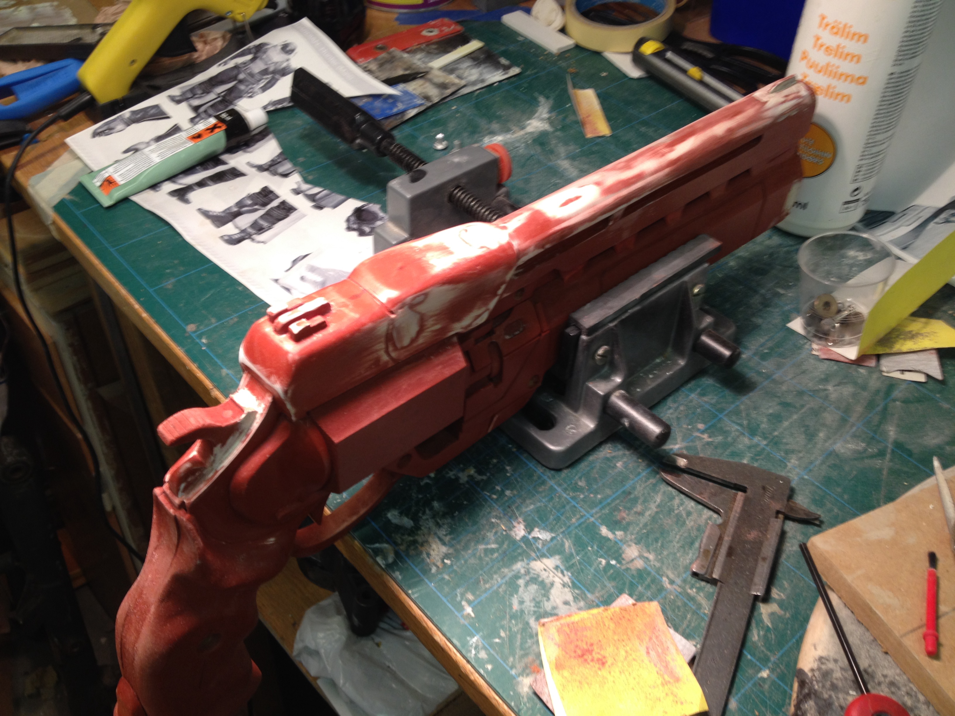

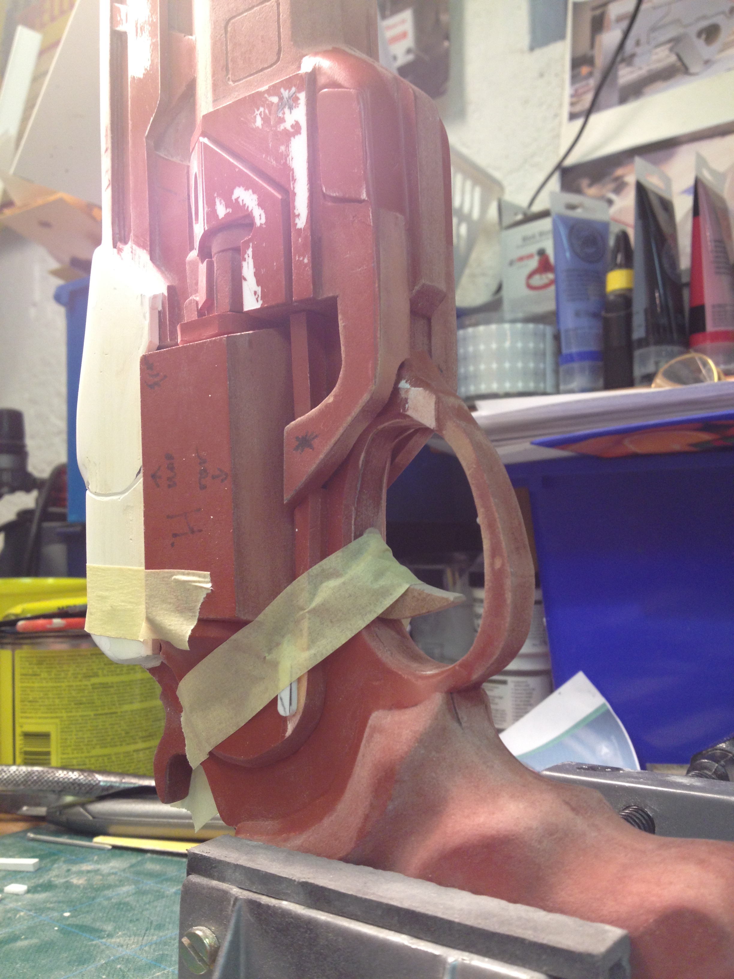

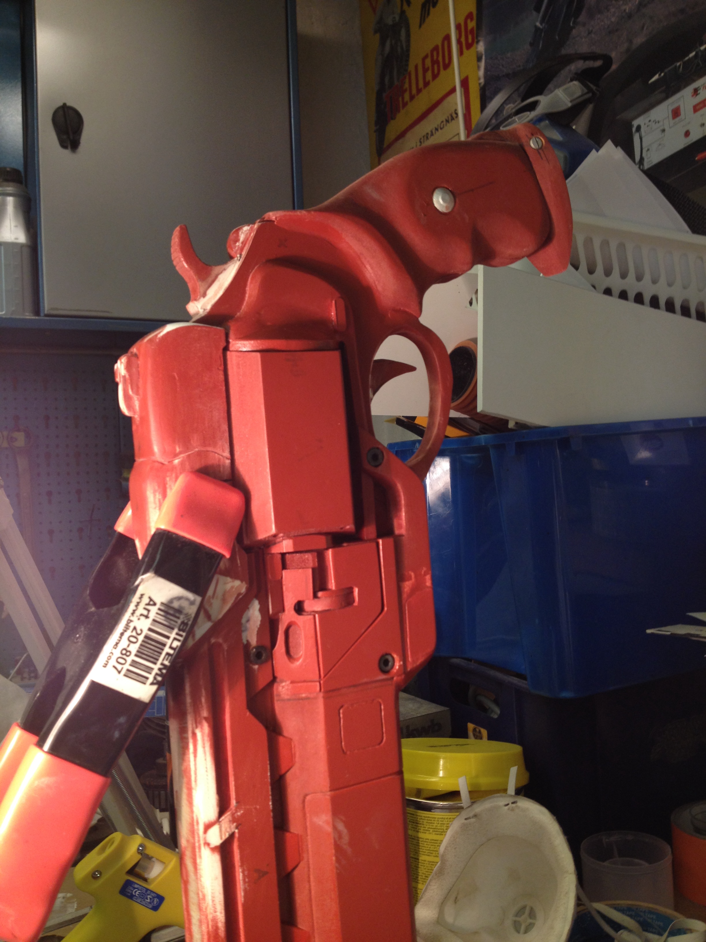

After som more small details i started to work with bondo:
In this picture i´ve glued a piece of styrene on the top back on the gun instead of using just Bondo, i made that piece in an small vaccumformer i created for smaller parts.
then i primed it and sanded it, then repeat repeat.......
