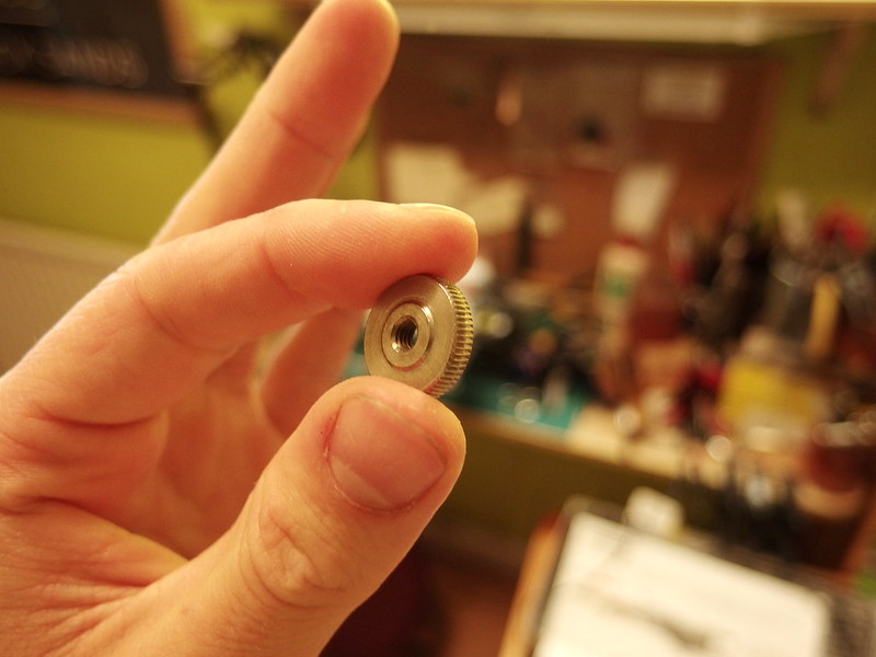

Many of the components we've ordered haven't yet arrived, but we had enough to make a solid start. I ordered some superb little M4 thumbscrews, and also scavenged various other dials.

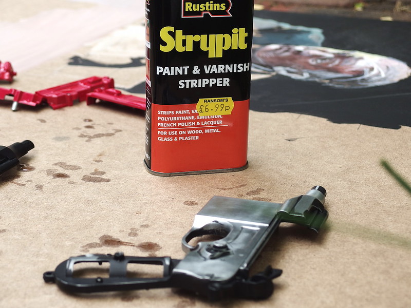

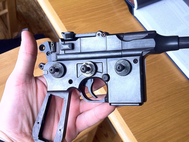

We started by using a sponge-tipped dremel to scuff the enamel away, but we soon realised that paint stripper would be a more efficient solution

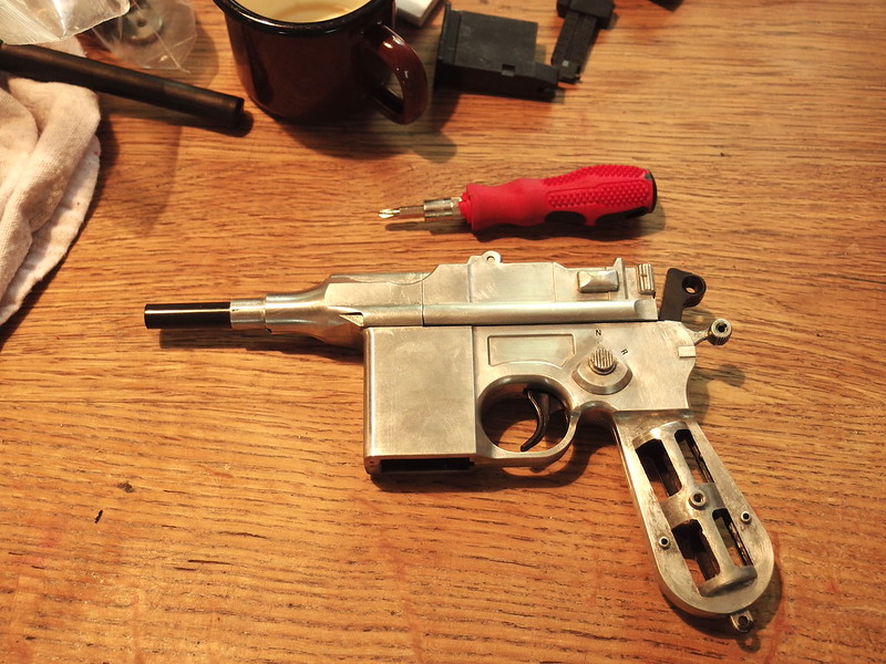

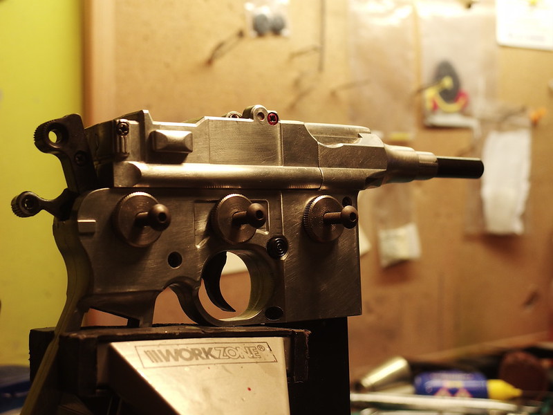

After some thorough buffing with wire wool, they look quite magnificent!

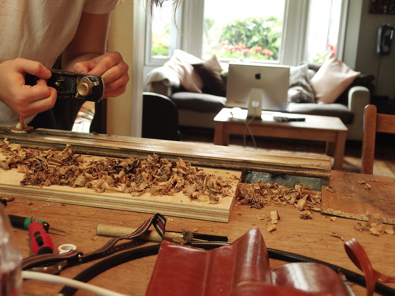

We knew early on that authentic wooden handles would be the only acceptable solution, however reproductions of the famous broomhandles would be 25% too large for our builds; so instead we took a surplus plank of Canadian maple flooring and planed the tongue-and-groove shaping away.

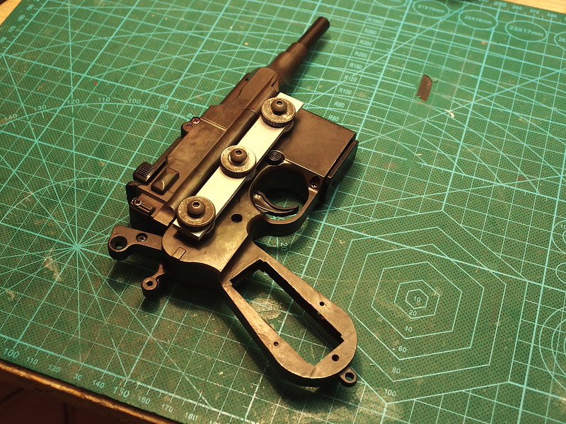

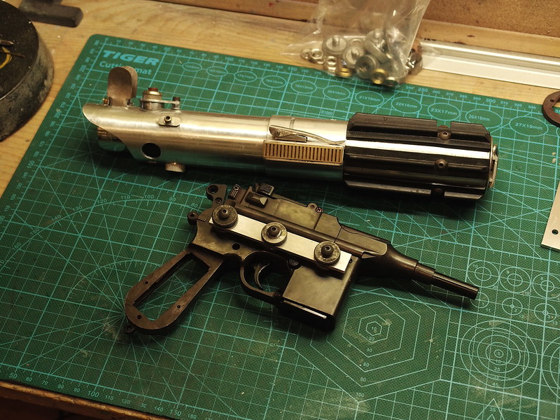

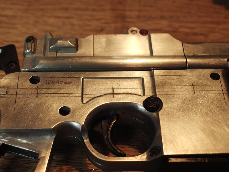

We marked out the alignment for the scope mount, before drilling 3.5mm pilot holes which we tapped with an M4 thread; despite being only some 2mm thick, the die-cast body still takes a machine bolt with relative strength: certainly enough for a scope.

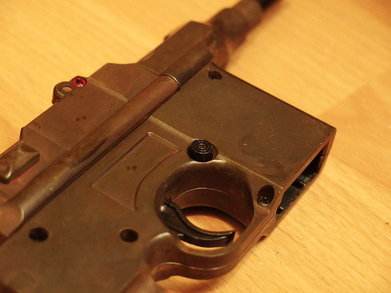

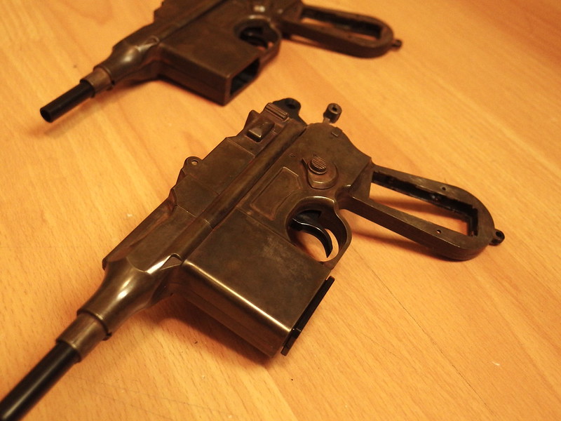

A friend was kind enough to lend me a chemical blackening solution, and although the product was specifically designed for stainless steel, I bit the bullet (used it neat!) and went straight onto the zinc alloy surface.
Worked beautifully....I daresay I'll put another coat on after totally buffing the first coat, as the guns seem a little browner in-person, I really want to get a proper black finish.
Once I'm satisfied, we'll protect the surface with jade oil which ought to make the colours pop too.

A little bit of progress here; I've given both blasters a second dunk in the chemical solution, after which I buffed the surface with a wad of felt, then polished in jade oil to protect and deepen the colour. You can see here in the morning daylight that the sheen and texture is far superior to paint !

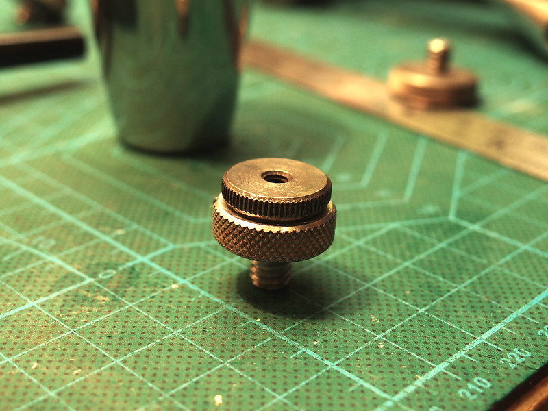

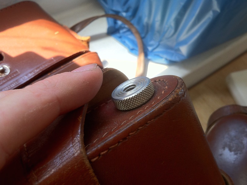

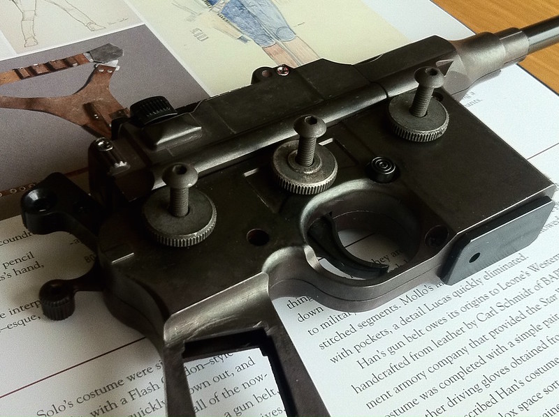

Then earlier today while I was in town I found a box of £1 camera cases in a flea market... luckily for us there were multiples of the same type, meaning I could scavenge the thumbscrews. You can see here how it looks against the gun and in comparison to the M4 thumbscrews we're using (which I've also chemically blackened)

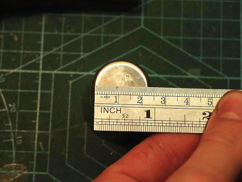

Also, the stainless steel shot glasses we ordered arrived...as we had feared... too big and odd-looking. Mercifully we anticipated this setback and several days ago ordered a set of brushed steel icing nozzles. Here's to hoping!

Great find on the knurled knobs from the camera cases!

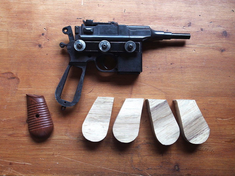

Re grips, if in doubt make them slightly oversize and then align the rear with the tang on the gun - this is what mauser used to do and it is common to see the grips sticking out a little at the front while the back is nicely flush.

I cut two aluminium bars for the scope mount and painted them in satin black (no photos of the painted piece though)

Most recently of all, I was generously allowed the fret saw from the college I was working at, and so on Tuesday afternoon I cut out the rough shapes of the grips from the maple we had planed down a fortnight ago
