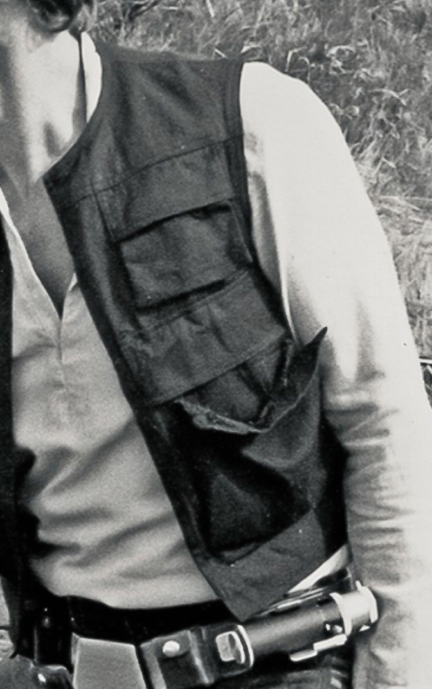

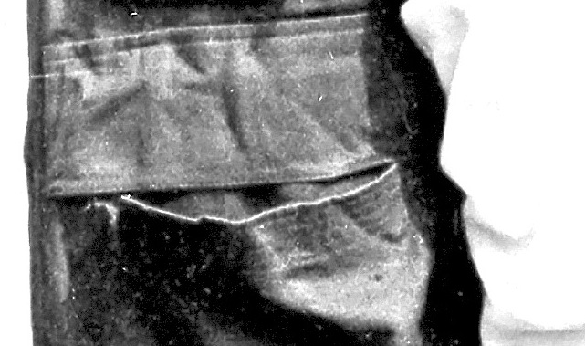

Also, in this photo - that darn bottom left pocket. It looks to my eyes as if the top of the pocket has a few rows of stitching maybe 1/4 inch or less apart
In this photo also seems to show that ALL the pocket flaps are top stitched down
What interests me is the two pockets on that left side. The bottom with its mysterious flap seems to be pretty open here. I am wondering if the extra flap is supposed to be a pull tab of sorts to open the pocket up from being tucked into the flap with its 3 stitched sides.
Then the top pocket in these photos seem to look like that left side of the pocket may not be attached, or the billow is VERY large.
