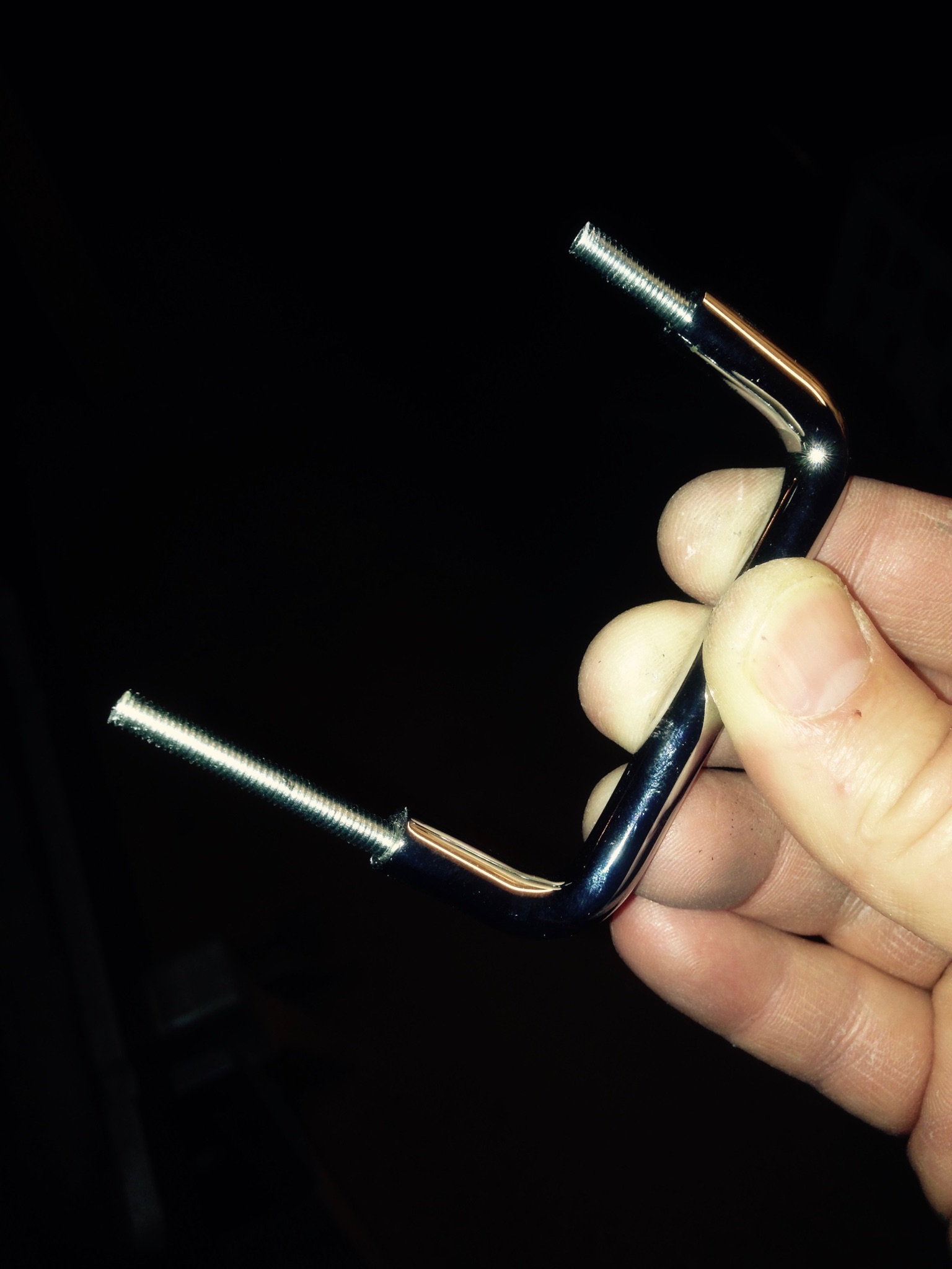

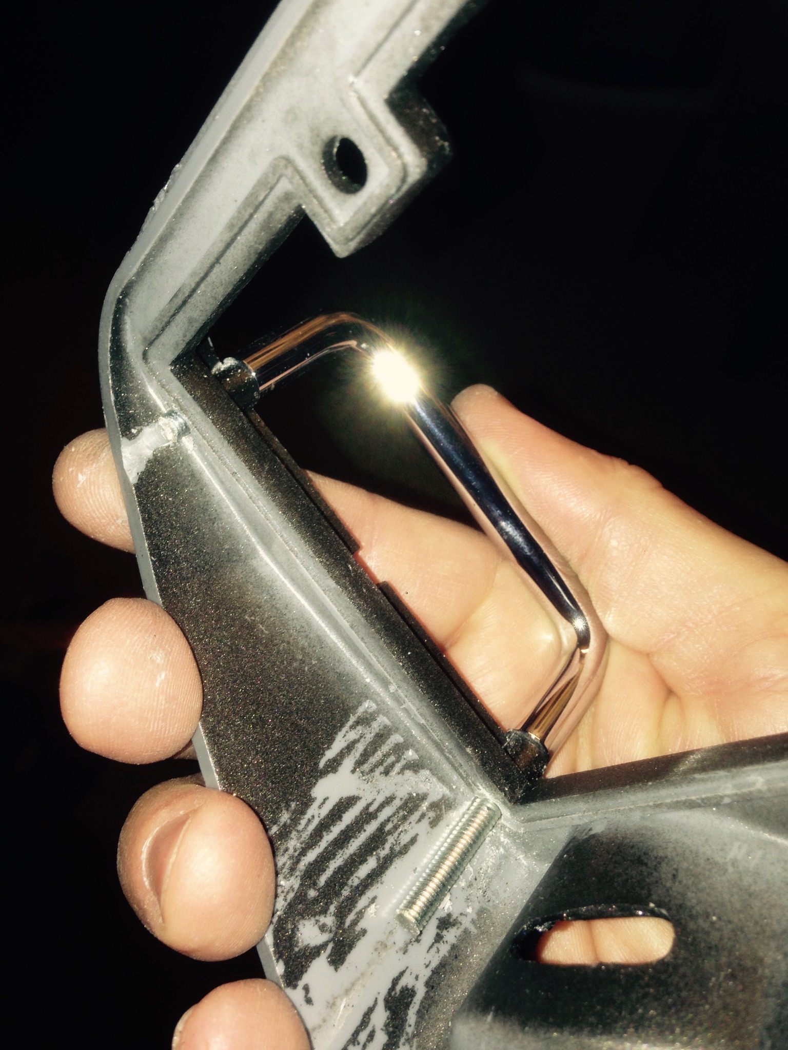

I got a package in the mail today and it was my 2.75 inch drawer pull handles for my hero panel. They're 98% correct. I'd say 100% but the outside diameter of the stubs is about 1/32 too big. It's such a small variance that no one but me will ever notice. The screws that the handles came with have a head that's way too wide to fit nicely behind the panel. There are two different lengths of screws, so I screwed each size into the handle with a little thread locker and then used a Dremel to cut off the head.
This is just a test fit and I'll glue the handles in place later, but they fit like a glove and will be very solid in the end.

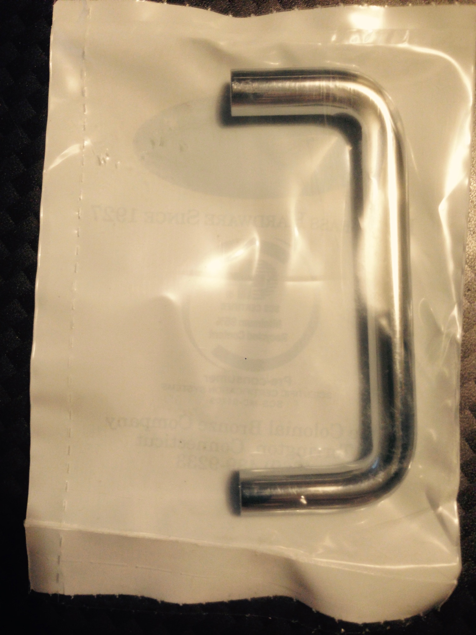

I can't find the packing list but here is the package the handles came in. I originally did a search for "2.75 Inch Wire Drawer Pull" and ended up with these folks:
I bought the same ones, fantastic for the price and accuracy.

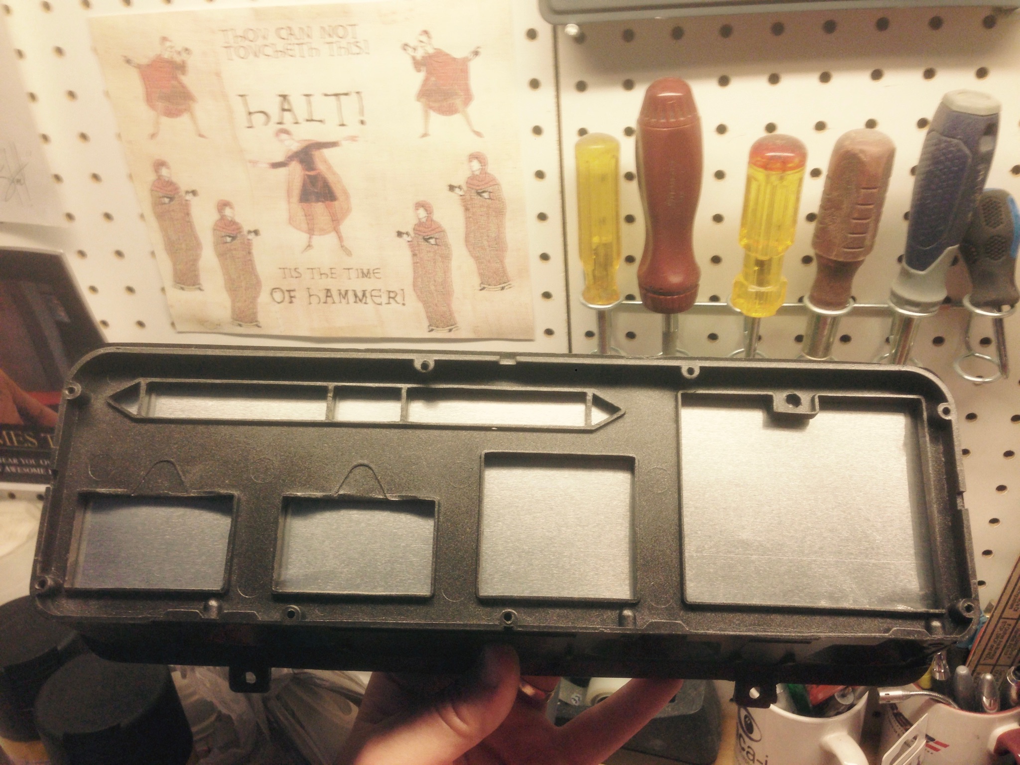

I ended up not liking the aluminum sheeting I used as a backing for the panels. It was too thick, it creased easily, it dented easily, it scratched easily and it didn't look right at all. So I scrapped it. I yanked every single one out and started over. It was easy to remove because I had been experimenting with various forms of adhesive. I tried Liquid Nails. I tried E6000. I tried JB Weld. Aside from the JB Weld, the adhesives peeled away from both the aluminum and the resin with ease. I think I was using the wrong kind of Liquid Nails to begin with.
I started over with a roll of aluminum flashing I found at the hardware store. Not only was it half the price, it was WAY easier to work with and it is very hard to scratch. The finish is superior to the other aluminum I was using and I'm much happier now. I decided to try LocTite superglue to stick the aluminum in place. I cut out my shape, ran a bead of LocTite around the inside of the panels and placed the aluminum sheet inside. I placed a few cans of spray paint on top to weigh it down as it hardened. I was amazed at the results. It made a solid bond with no fogging on the aluminum and dried very quickly. For me, the LocTite worked better than the others I had tried. I think my problem with the Liquid Nails is that I didn't give it enough time to fully harden because it takes longer to cure on non-porous surfaces like metal and plastic. The superglue worked well with my impatient nature.
