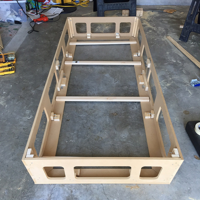

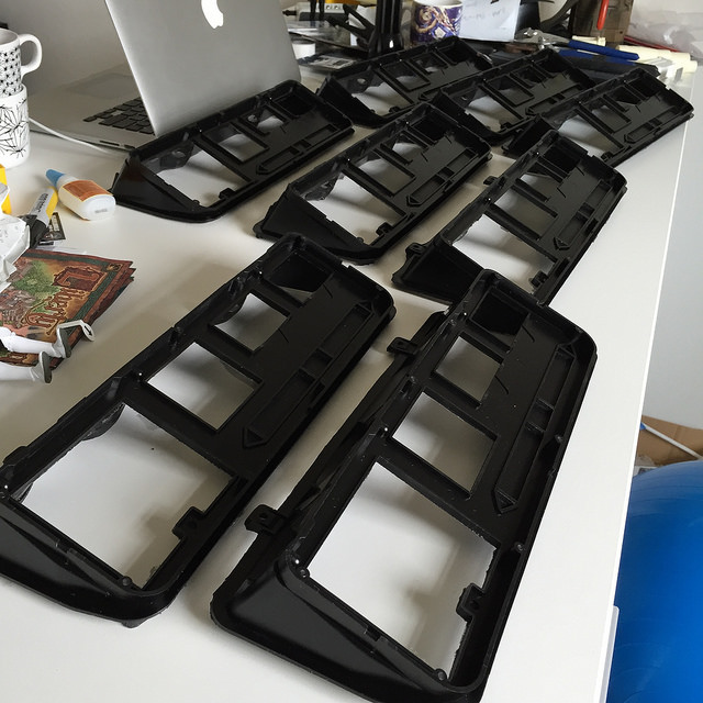

I'm building a Han in Carbonite, using: King Jawa's Han, Zenix's box kit and greeblies, and Bigturc's volvo panels. I'm also waiting on some end pieces from MonCal. I'm planning on figuring out the hero panel electronics myself using some kind of Arduino setup.. I haven't gotten that far yet.

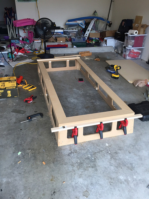

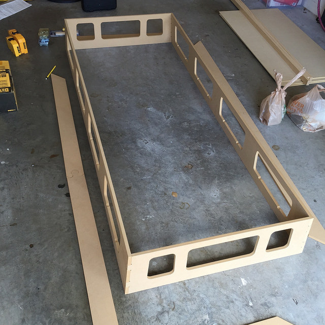

I've been working on the box kit first, doing it slightly different from Zenix's directions. I have used these metal brackets in the past on other things and thought it would be good here. It's a little more work, but it will be a little lighter and will definitely have room for the end pieces and panels. Hopefully it'll work out ok! I used 1/4" MDF for the face board which has been glued down.. once that is dry I'll add some cross bracing and then begin work on filling all the screw holes and gaps.

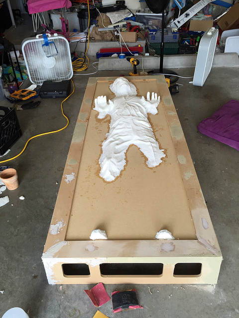

Once the box is done I'll mount Han.. who has been taking up all the room on my desk.. along with all the panels...

Here's the box upright with one of my kids for scale:

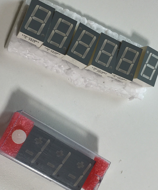

And today I received some parts for the hero panel in the mail.. 7 segment LEDs and a couple of the ones with the overflow + / - indicators. I got a couple extra of everything in case I screw something up.

woah nice! brackets! it'd be sweet if you shared how to do that in the build instructions so people can learn there too
Yep, those are the brackets I used! I'll try to update the document once I make a little more progress, I took photos as I went.
Speaking of, here's where I'm at with the build so far:

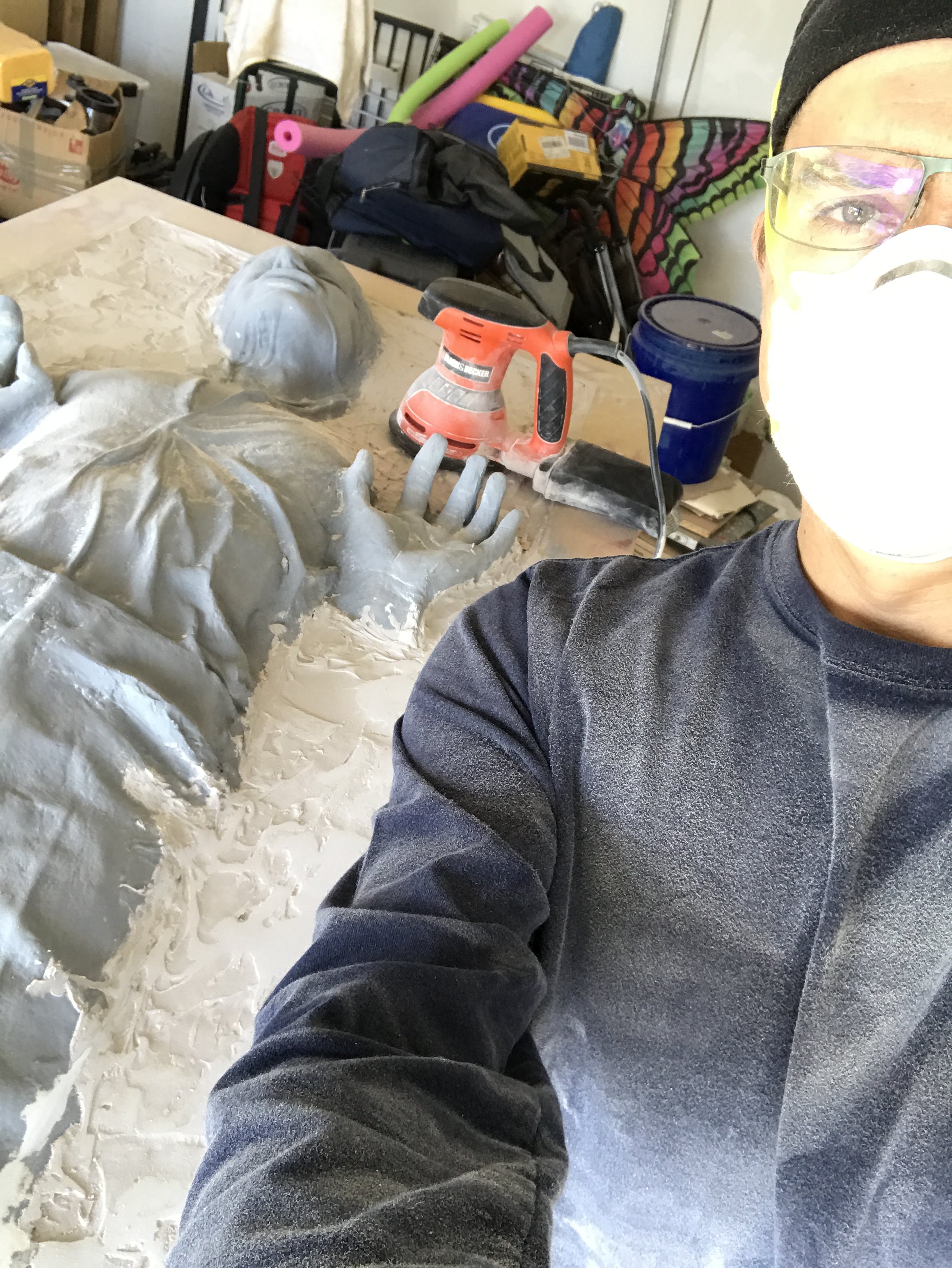

Some catch up photos:

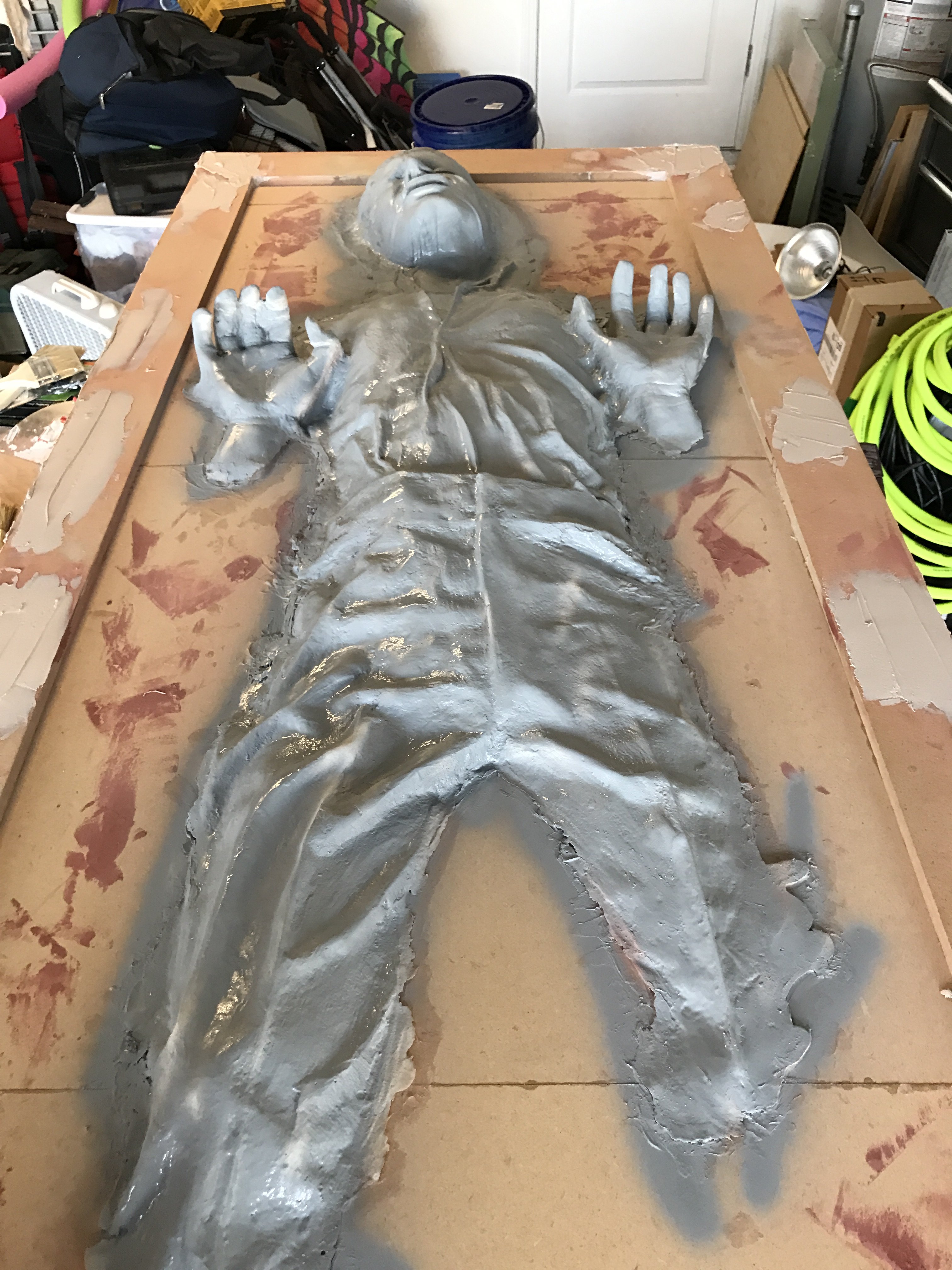

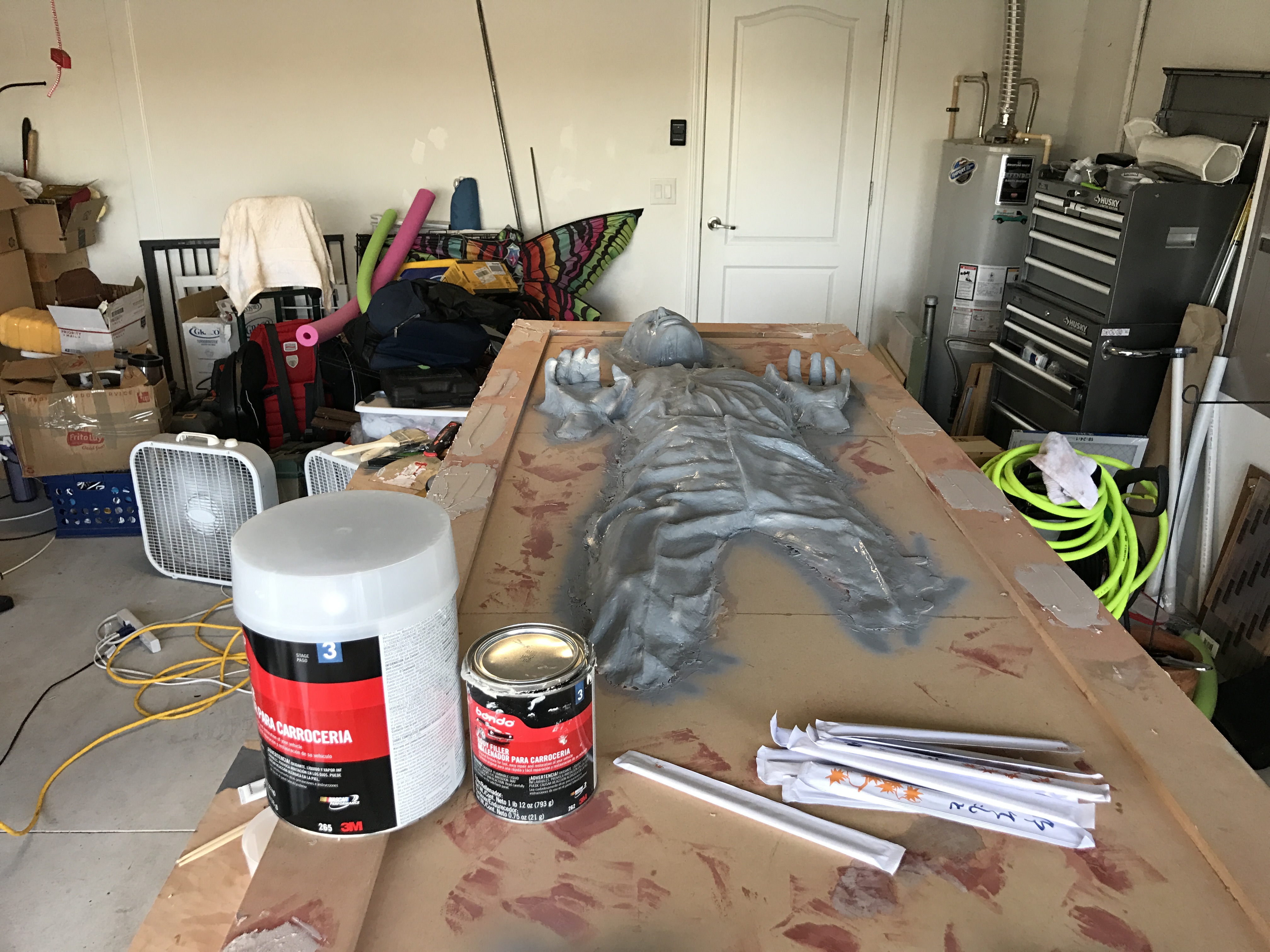

I left him like this for the longest time, when I didn't know what I was doing and used too much of the wrong kind of bondo and created more of a murder scene than anything else:

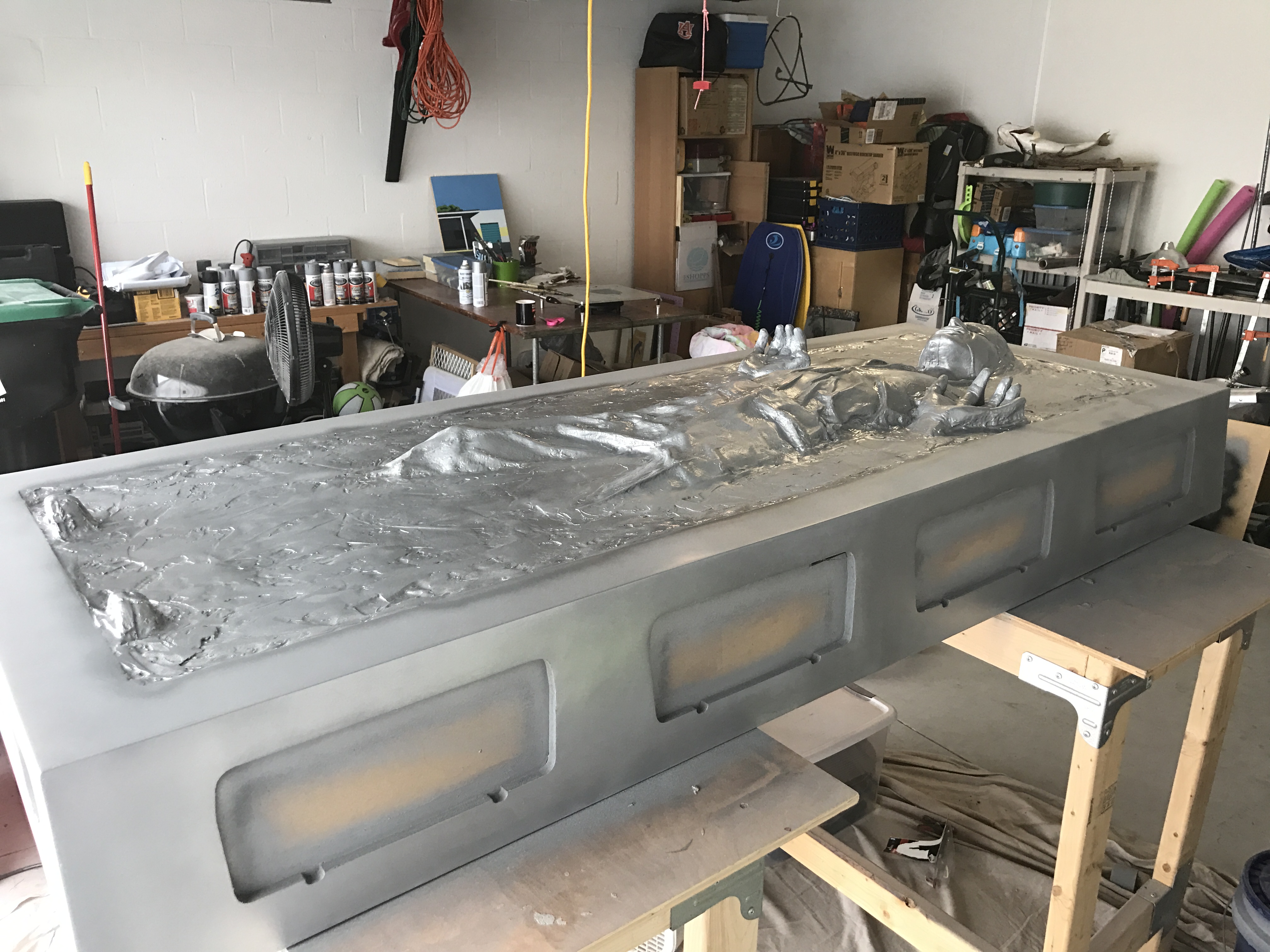

Now I've added supports, end pockets from MC (that don't fit well, but I'm going to smooth that out soon) and have put down a coat of bondo and filler primer for the carbonite texture:

Updates on priming and painting. Still need to weather and mount side panels. Starting to consider how to hang him, maybe from the ceiling/joists
