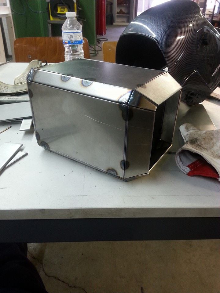

I was thinking of making a Thor hammer out of Iron.....well here is my progress so far!
I hope you guy's will enjoy watching this as I will enjoy making it!

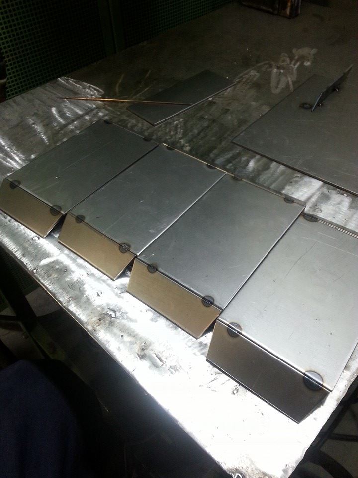

10352832_10205500843428592_2168284851905144380_n.jpgI cutted out all the pieces I needed for the head

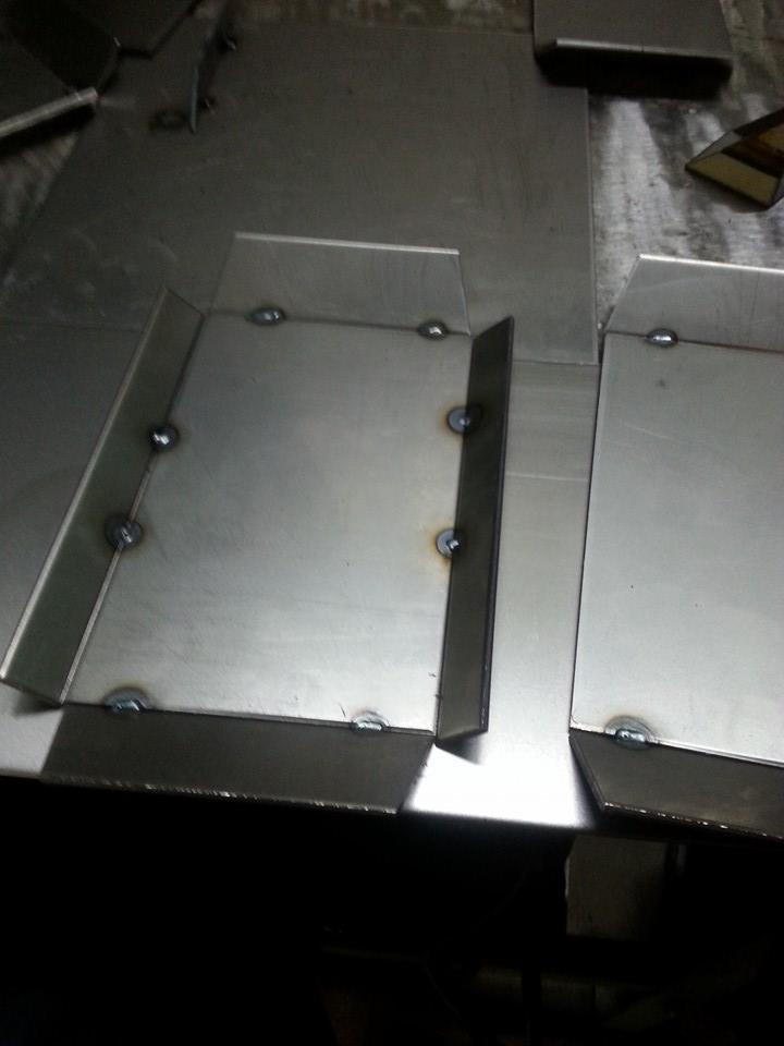

1970416_10205500851148785_5338657420150838255_n.jpg10422161_10205500850868778_574291232361299677_n.jpg Then I welded the short edges on the upper and bottem half
10734080_10205500851988806_4620720664417959599_n.jpg1501772_10205500851548795_6680275551492338350_n.jpgSO far so good!

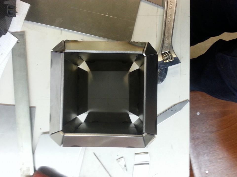

10410653_10205500852428817_4473073191653125297_n.jpgI cutted out some of the triangle teeth one by one to fit them in correctly!
1506989_10205500853428842_2580392141264867477_n.jpgwelded the teeth in place

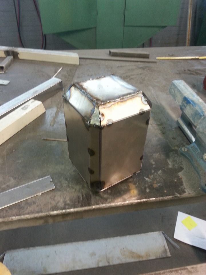

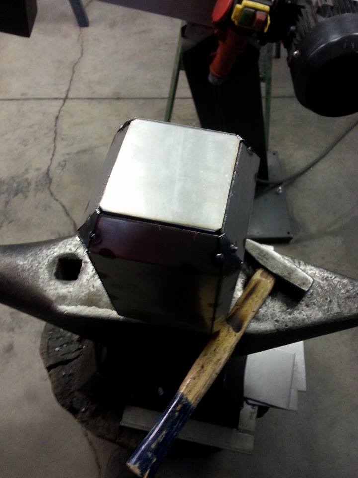

10429235_10205500854108859_2594596446277934942_n.jpgafter all the fittings, I welded first the two main sides so that no deformation would occur.
1011276_10205500854428867_7977664370401029799_n.jpgGrinding the hammer, first try first look

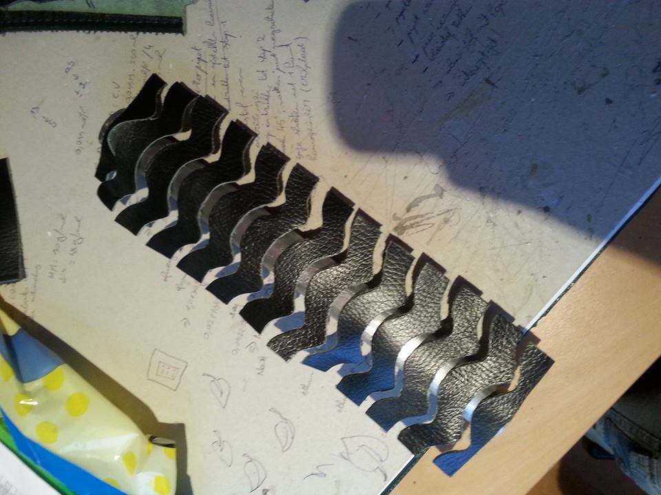

63966_10205537135295866_4679608631796074080_n.jpgnext step was the handel with some leather (no panic the green was ugly so I painted it black because the girls love black on shiny stuff ;) )
10175947_10205537968236689_8638183600377907552_n.jpgBelieve me, after cutting all of this out with a stolen scissors from your moms kitchen... it will hurt your hand bad...karma...

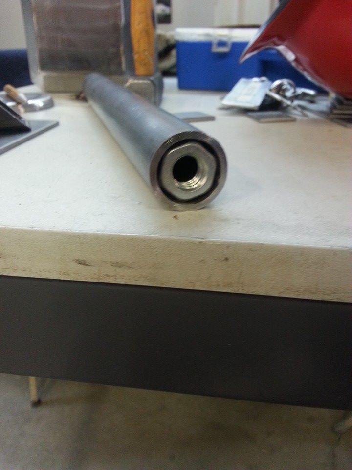

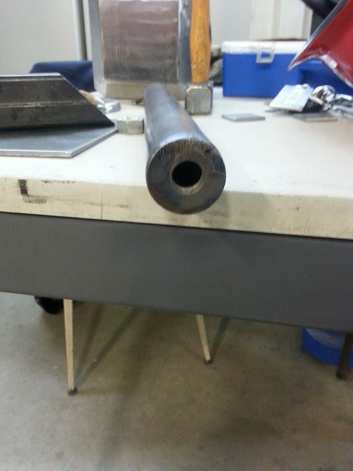

1901251_10205566115060342_1629017207704621201_n.jpg10845919_10205566114620331_895800065303316471_n.jpgI putted a screw in the handel wich I TIG welded. I weled a screw on the bottem side of the hammer so I can screw the handel on it. Between the handel and the hammer head there will be a little disc to make it a bit coler :)
10173562_10205566116180370_6327288044170522222_n.jpg10734046_10205566116700383_7141442570517459958_n.jpgeventually I putted almost all the pieces together... still need some perfections and leather work to be done
