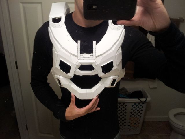

Well getting done by Halloween was always far fetched but at least now i can put as much detail as i want now
I've been trying a new technique with pep as well I've been using edge lock tape to build the whole thing instead of hot glue ( eliminates cutting out all those damn glue tabs and makes this go a lot faster. it can be tricky at times but it works for me) once I'm done with the first two coats of fiberglass on the outside i pull all the tape off and fiberglass the inside. The fiberglass soaks all the way through the paper so if i have to sand down past it.. no problems and no soft corners from the hot glue being in-between the layers of fiberglass.

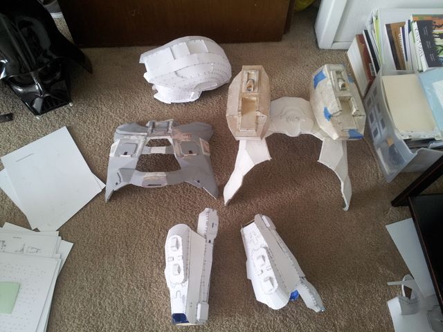

I decided to keep the jet packs separate so I can handle them easier

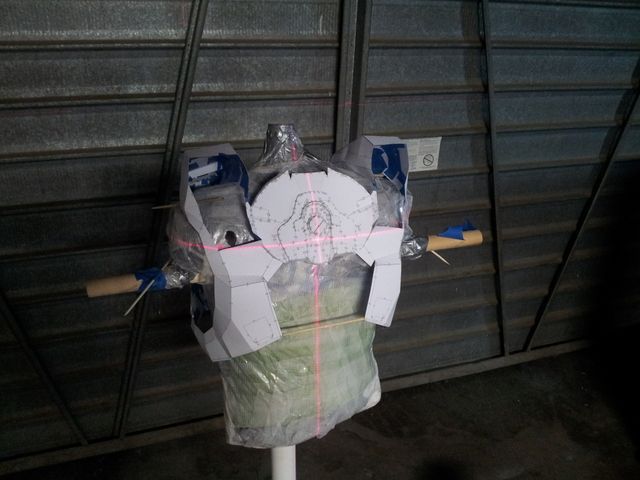

I did my best to laser level everything while i fiber-glassed it

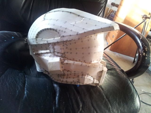

I modified the forearm pep files to make it more game accurate based off the photos I've seen ( I'm trying to do that will all the files but time is not on my side) and also started on the helmet
the helmet built and fiber-glassed

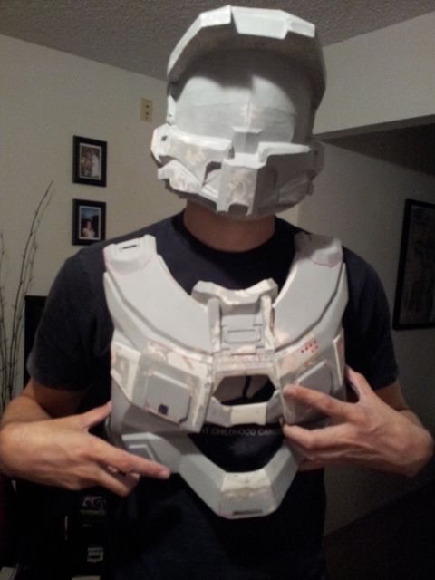

Slowly but surely its coming together and starting to look good
