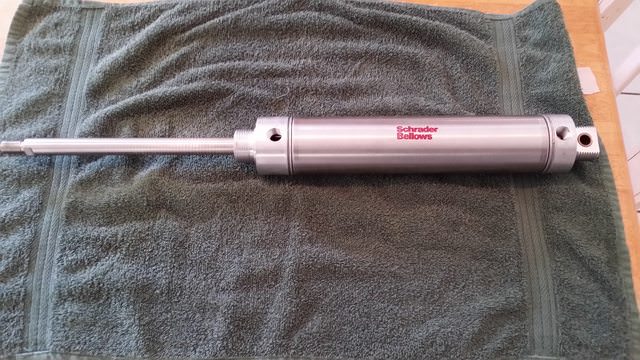

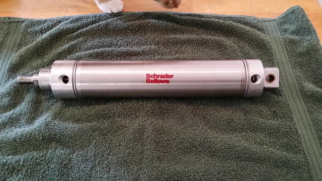

I actually managed to scrape together some leftover scraps and tools from work to make a pneumatic piston with a creepy looking skull pop-up when people walked nearby.

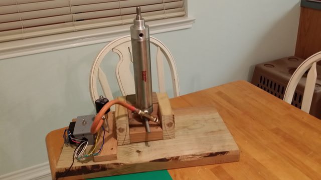

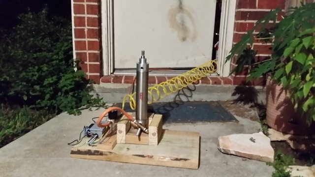

Did a quick and dirty wiring "proof of concept" with alligator clips. It works! The On button opens the valve, the Off closes the valve.

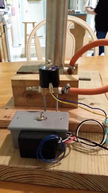

Fully wired up control box & wireless receiver completed. The blue cable is the antenna. I also decided to add a small on/off switch for the receiver, in case I need to power off the device or while I work on the piston. (Safety is important!)
Soldered clips for the Solenoid valves. I chose to do this for long term usage, since I will be able to use the solenoids for other projects.
