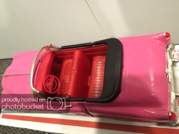

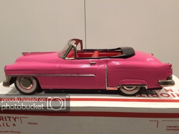

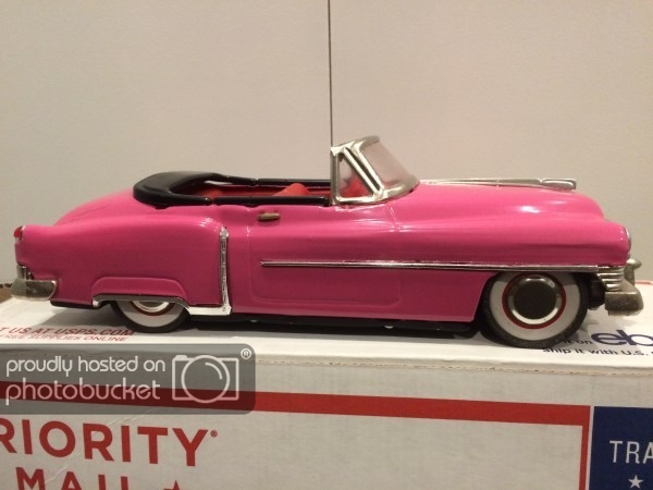

heres the car i won off ebay last week, she came to me about 20 minutes ago and to my surprise all the chrome pieces (minus the grill) ARE PERFECT!! the ebay auction pictures made this thing look like a piece of junk, but in all honesty this thing is in great shape!!
STEERING WHEEL IS IN 1 PIECE! YAY!!!!
