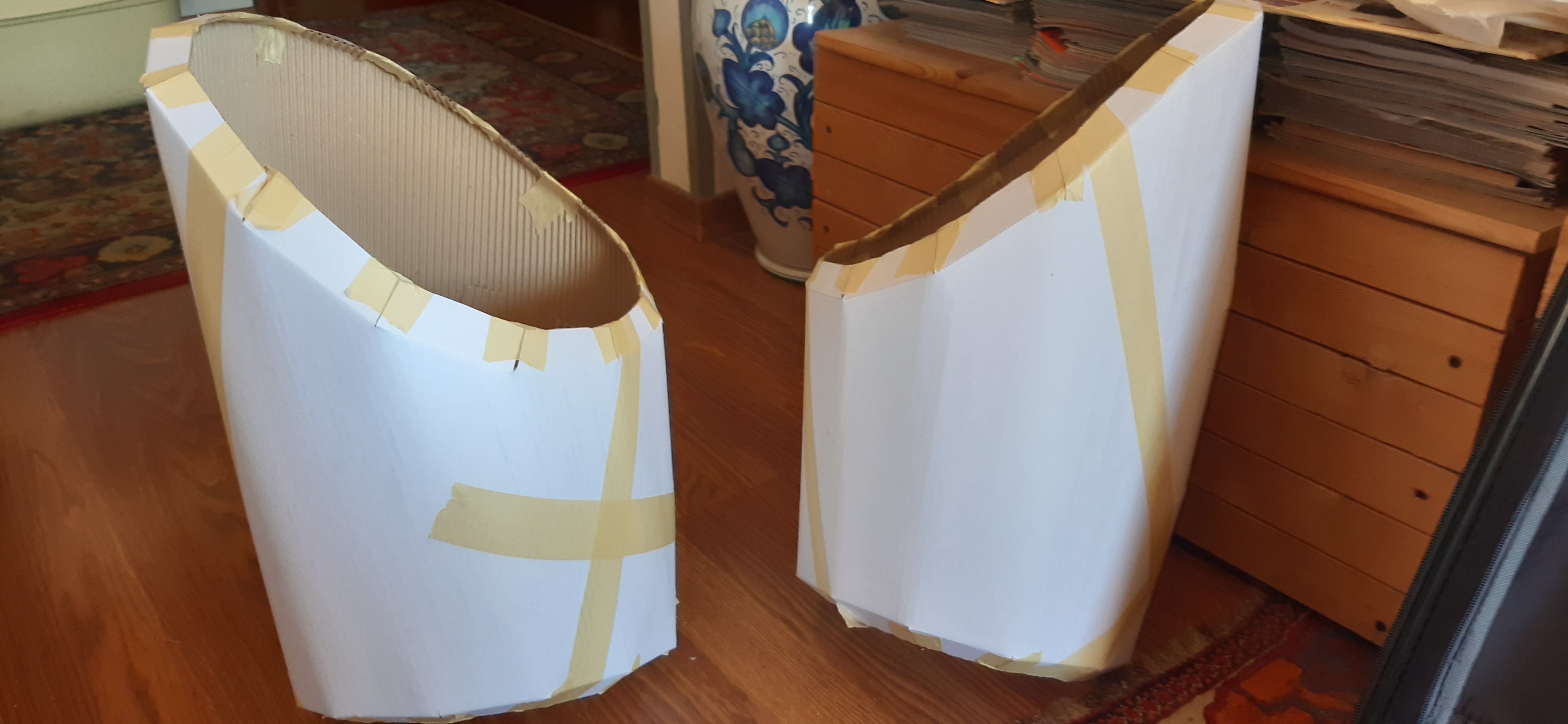

For the feet I used standard cardboard boxes but when I built one of the lower legs it had to many edges so I switched to the cardboard that comes in rolls and has only one layer of paper.
Every piece will be covered in paper mache and to smooth things out and add detail I'll add a layer of paper mache clay
This is one foot, I later decided to separate the toes

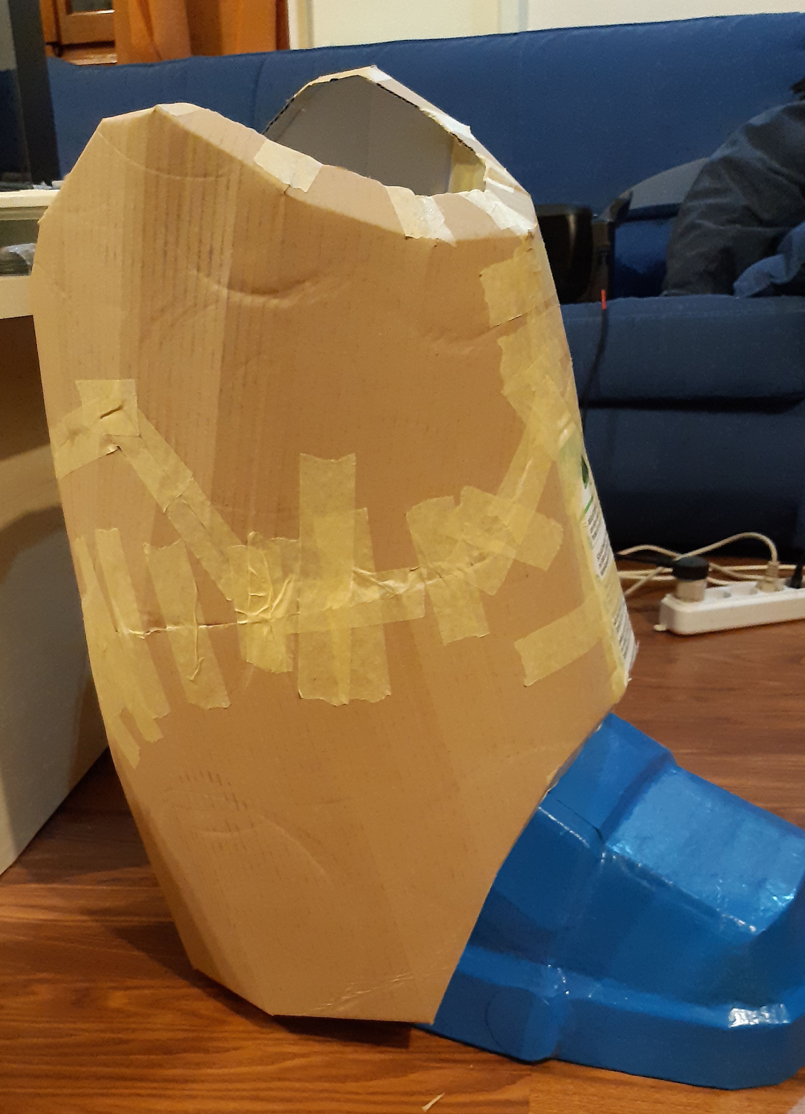

After the feet I built the right shin. This is when I decided to switch cardboard
I also built the other shin the thigs and knees but I'll post a photo of them next week.

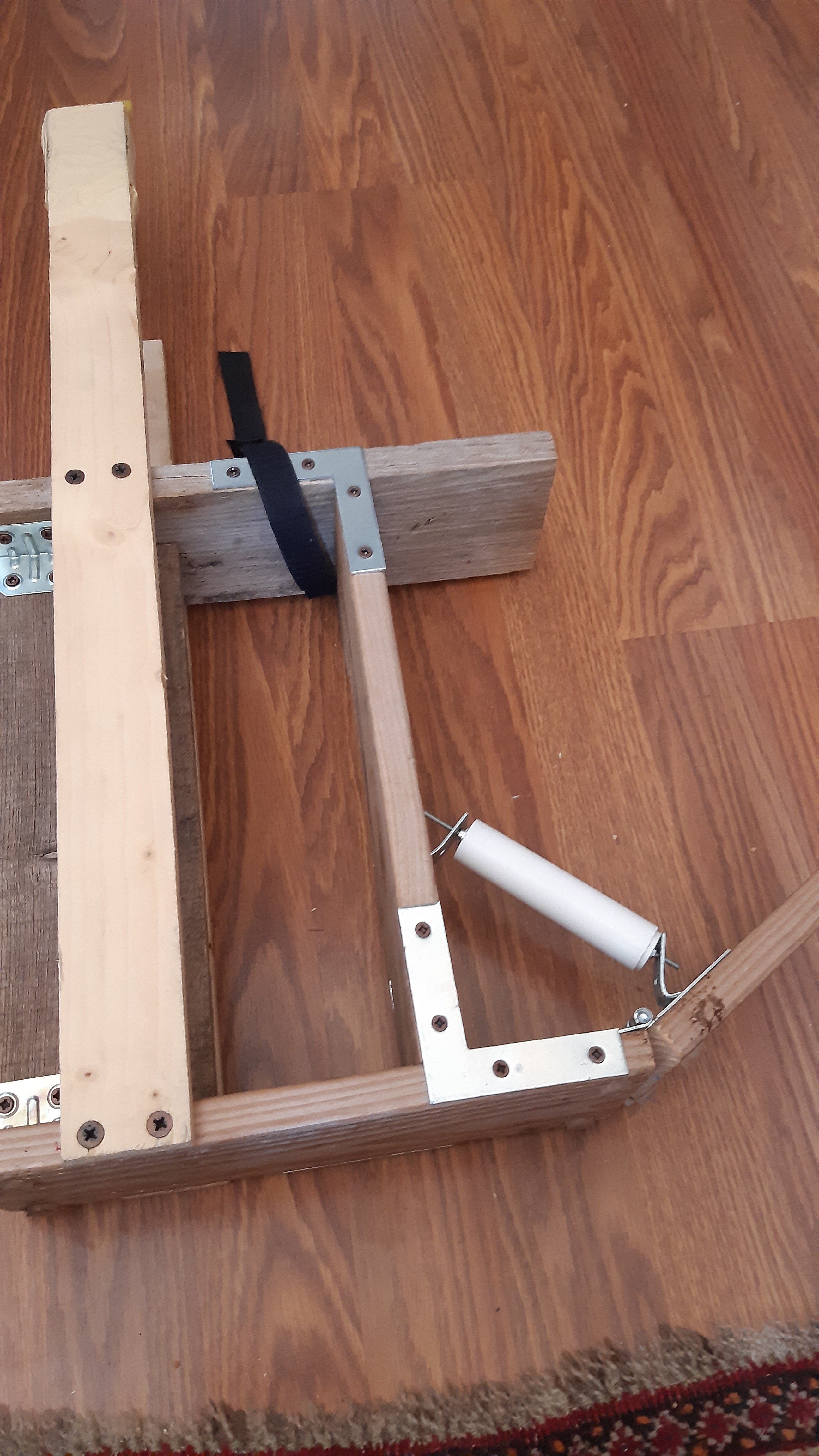

The stilts with temporary straps and moveable toe.
The moveable toe is made with a toilette paper holder so that the toe can return to the flat position.

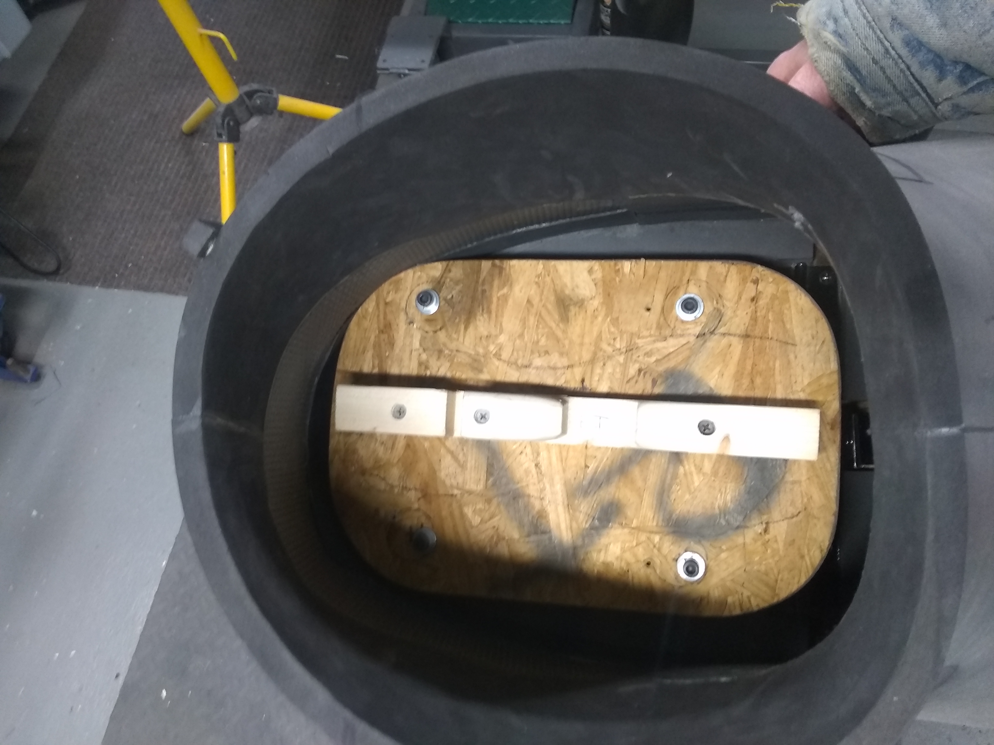

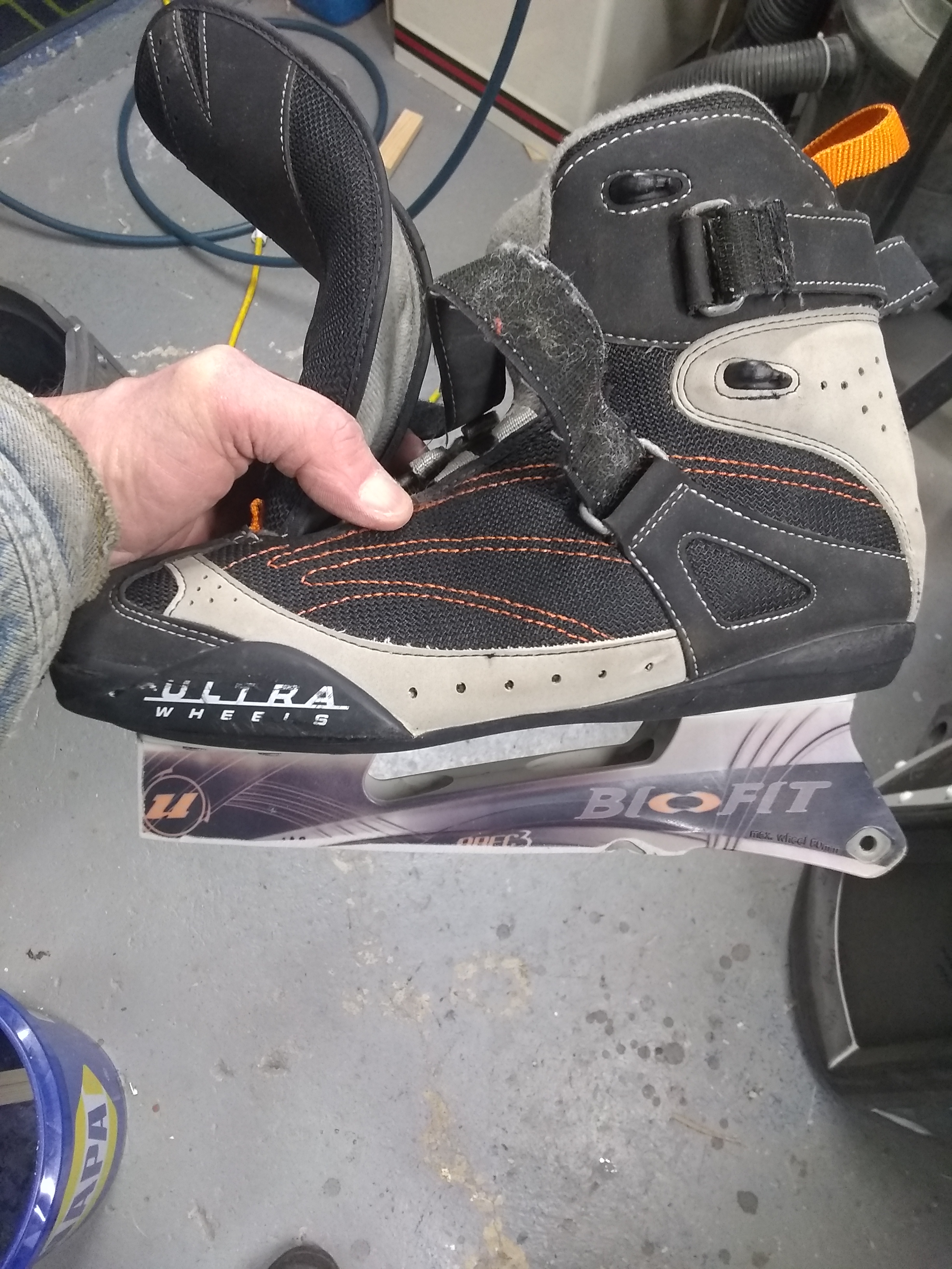

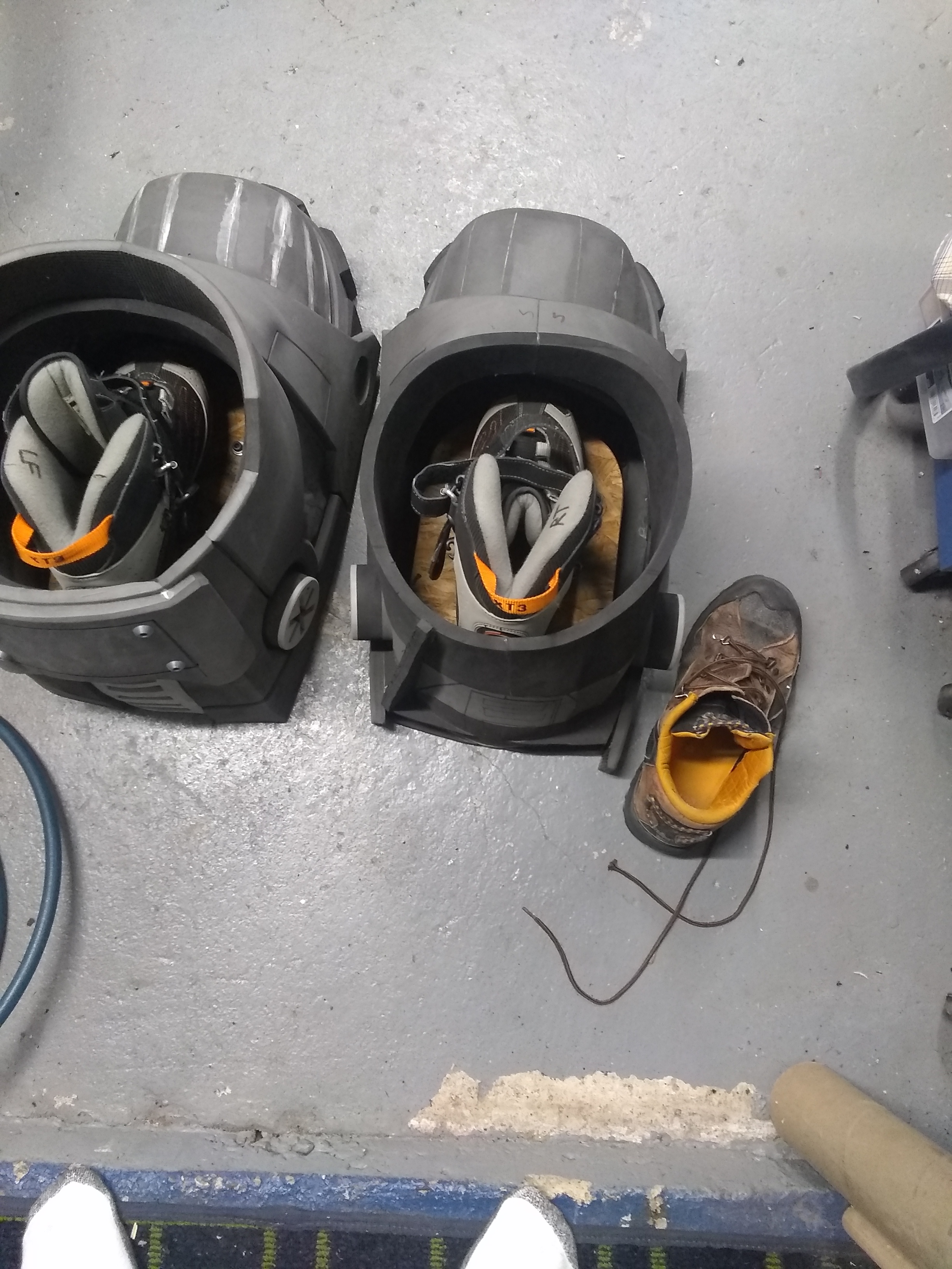

Be careful with the stilts. I wound up using a rollerblade boot in my terminator build. I ditched the wheels and cut the trucks down and mounted them to a block
IMG_20200418_213354123.jpg IMG_20200419_191513648.jpg IMG_20200419_193633272.jpg
Now my risers aren't as tall as yours, I'm 6'1". My finished build puts me at about 7'8". The skate boots make mine real stable, I can almost run in them but don't want to try it lol. Good luck on your build, I'll be watching
View attachment 1347948 View attachment 1347949 View attachment 1347950
I'm probably going to screw a shoe or a boot to the stilts to keep my feet in place and have a nylon strap on the calf though the idea of a rollerblade boot seems interesting, maybe I'll try that if my idea fails. thank you for the idea
I tried loafer style shoes and they didn't have the strength or support to lift my boot. Then thought about lace up, but I couldn't reach down in side the legs to tie them. Used the roller blade boots with the buckles to be able to secure them 1 handed. Something to think about
