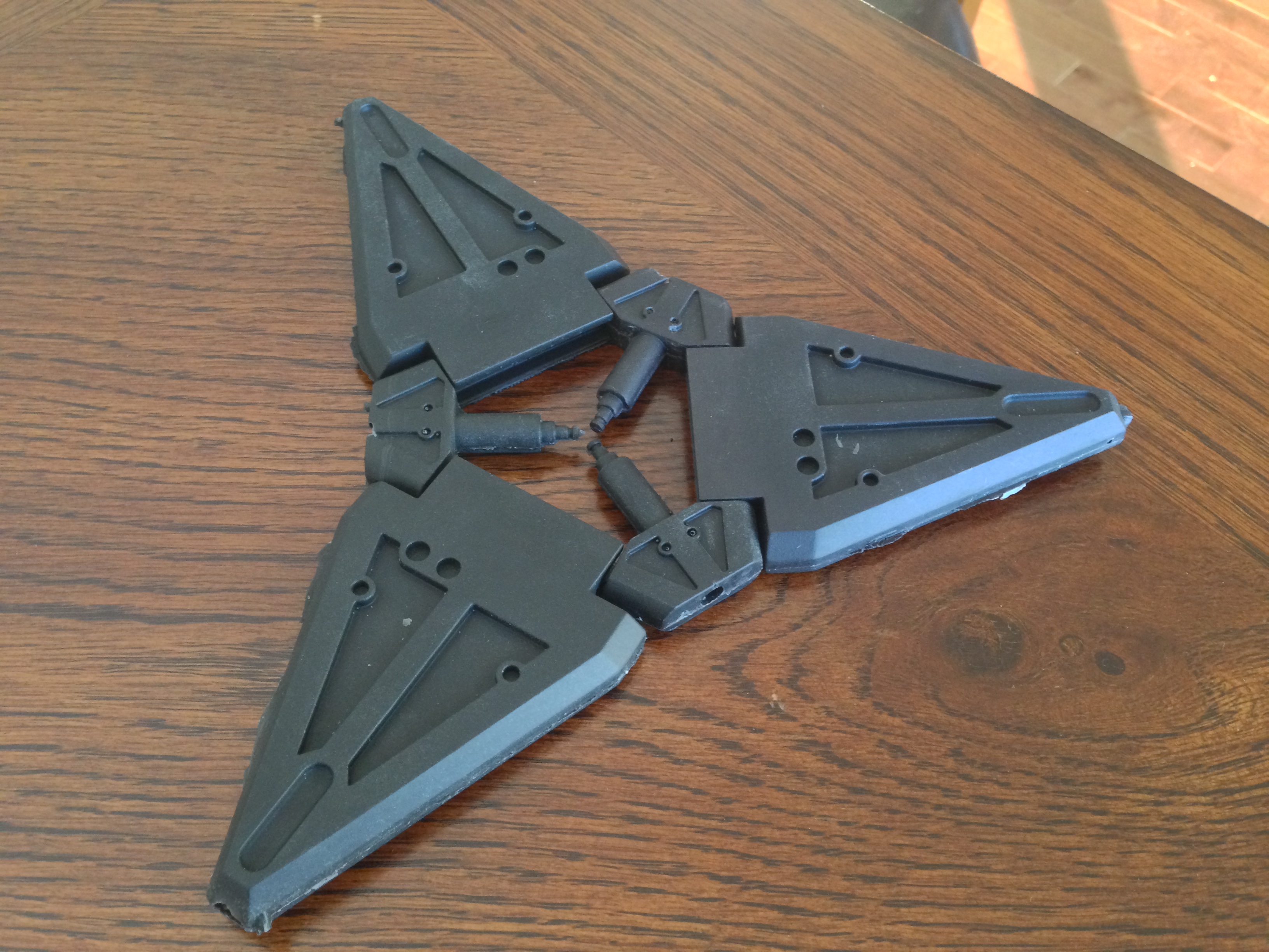

Wow .. thanks for those pics zombcom!!!
I'm very impressed by how close I am to the real deal proportion and detail wise!!!
Here's what I'm gonna correct on my master hinge:
- 2 holes and the round peg on the underside
- Round plug on the outside face
I'm very happy with the rest!!!

Zombcom, now that I look at it, is that a static prop? Meaning are the hinges glued to the legs?
I might have overdesigned it :)

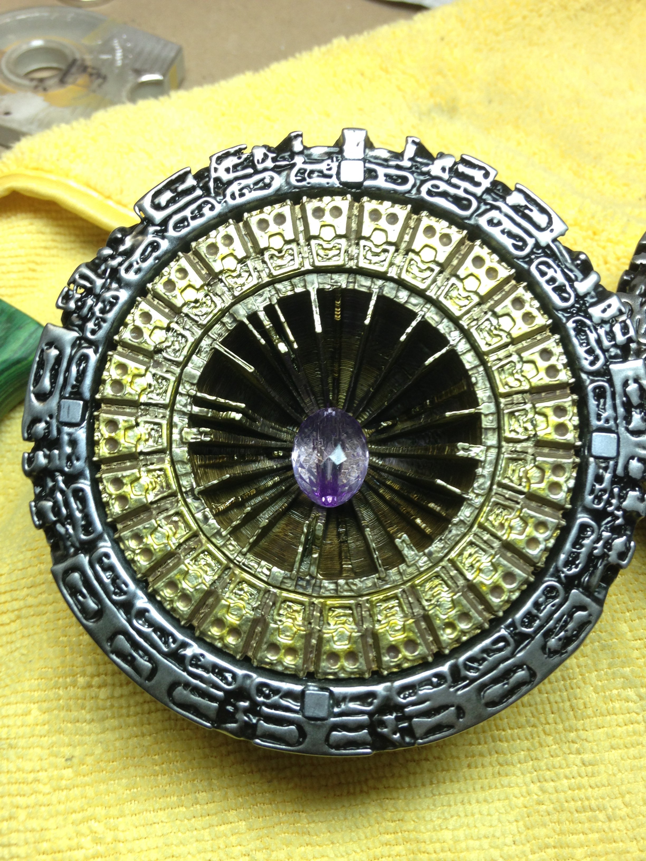

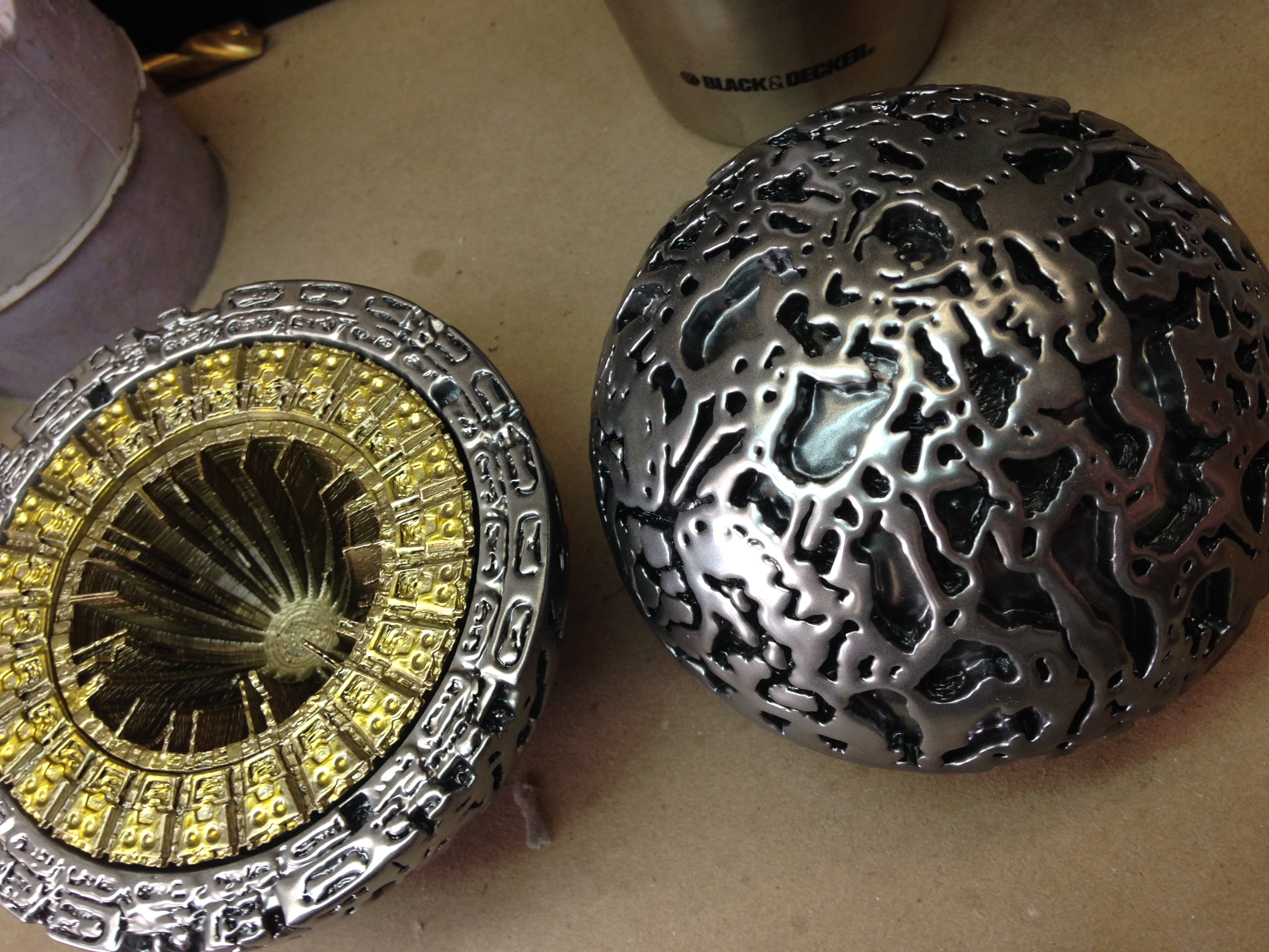

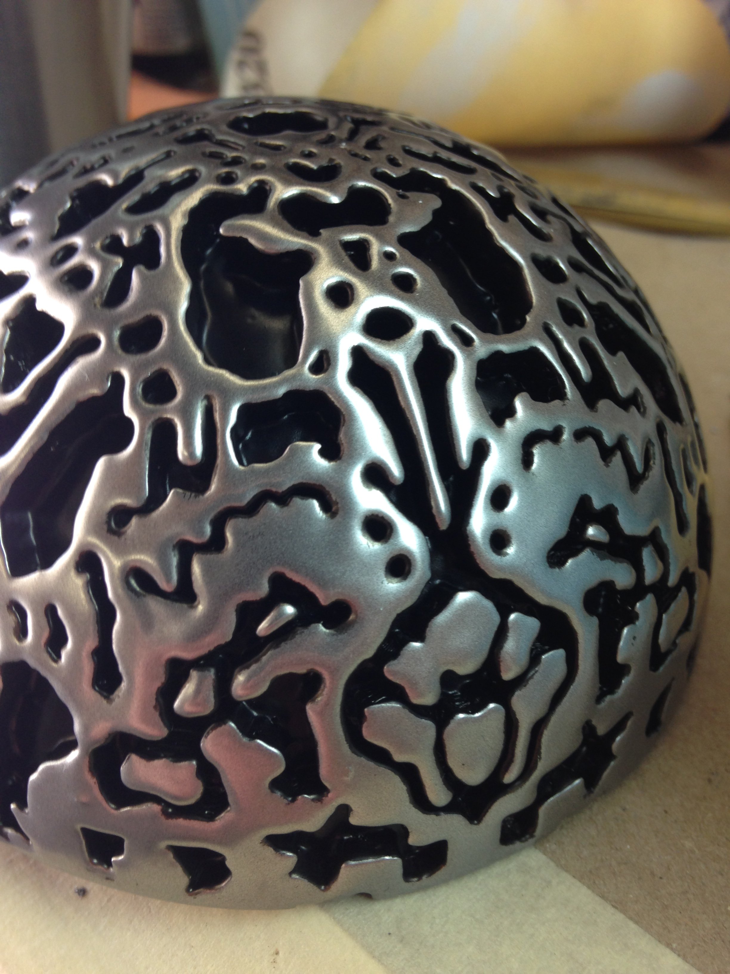

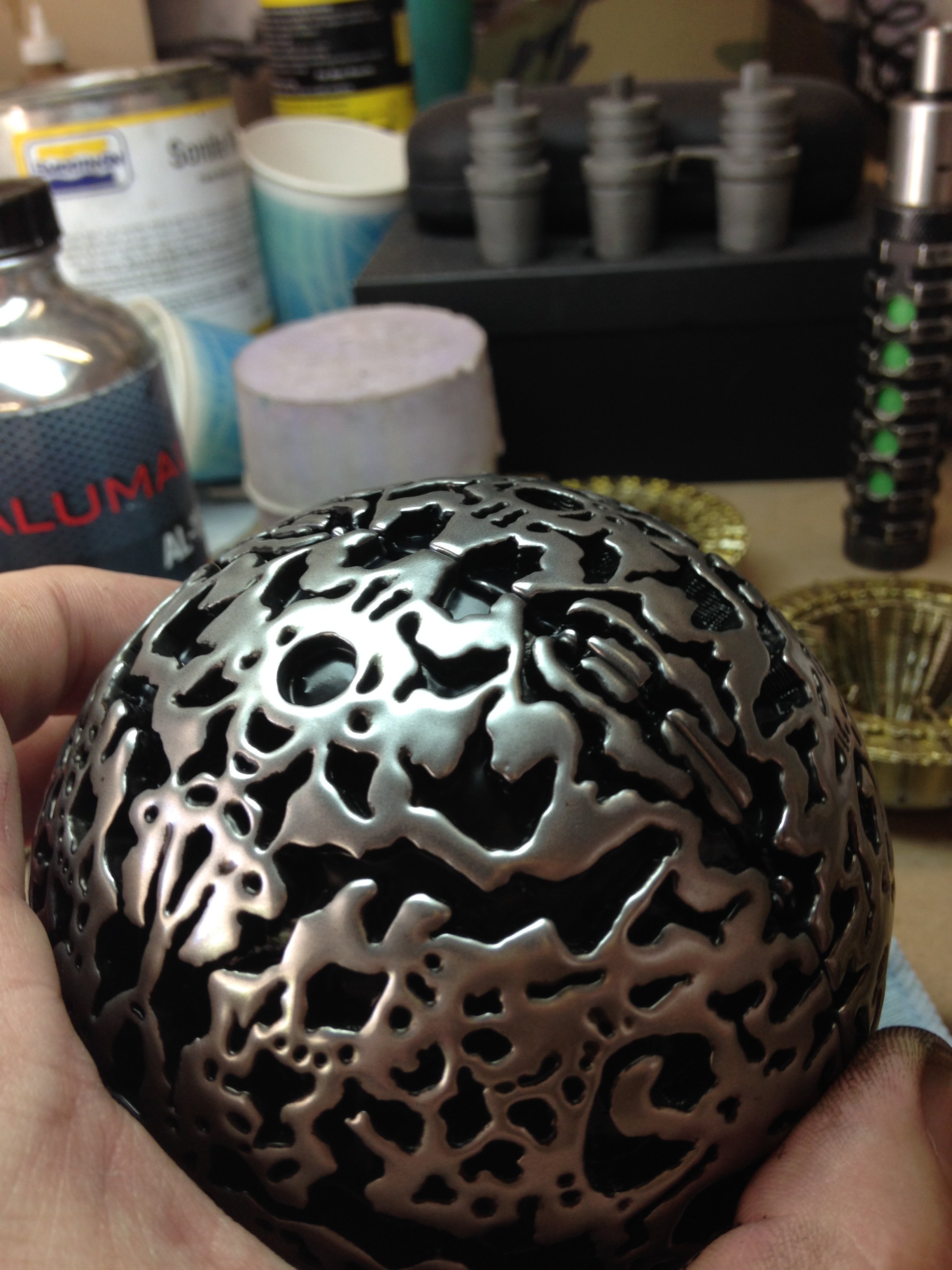

While I'm sharing here, I wanted to show you guys the alumaluster / impiriflex system I did on one of those prop tributes orbs, the stuff is amazing, granted there is a ton of polyester high build primer used here,and wet sanding to 400 , but you can achieve great results after all is said and done, I mentioned this in a different post way back, figured id show it. Also I am officially interested in this kit of yours, you did a great job, and now I need a base lol. ToddIMG_6929.JPGIMG_6927.JPGIMG_6928.JPGIMG_6936.JPG
yes it was all static, no moving parts, just all one casted piece ( horrible amaturish seam too btw lol )

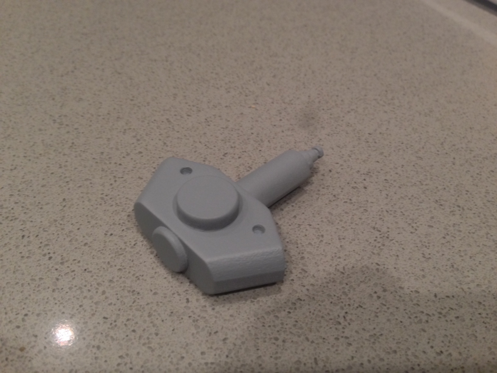

Re: Guardians of the Galaxy : Starlord Gravity Mine & Infinity Orb
Very productive day people, finished my new leg mold and greeblies mold .. waiting for the rubber to cure right now!
Also, adjusted the hinge to be more screen accurate to the actual prop since we never saw the underside before. Will remold this tomorrow.
Here's what I mean .. you can compare to the screen prop posted above. Very very happy with this!! Thanks again zombcom!

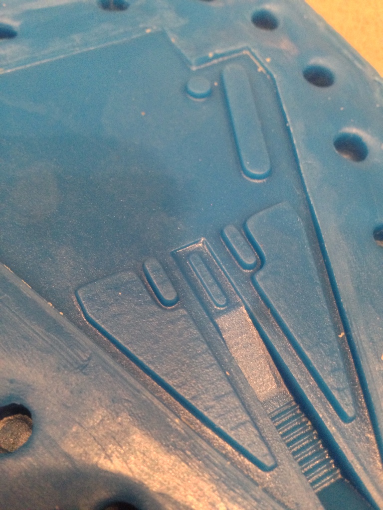

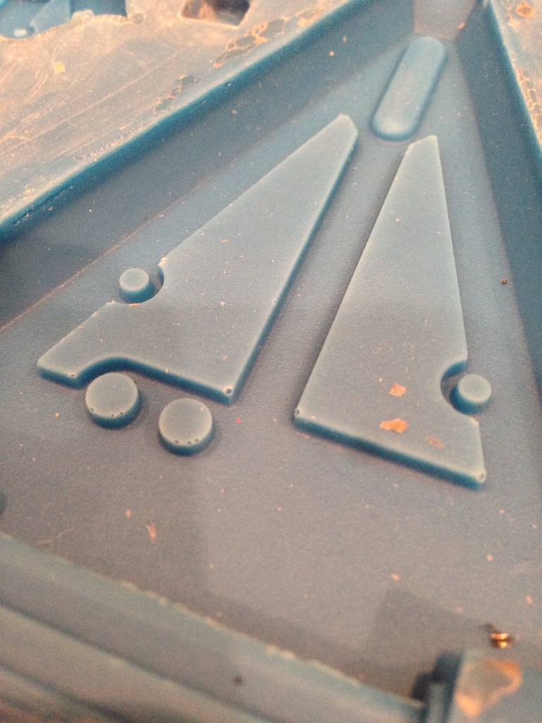

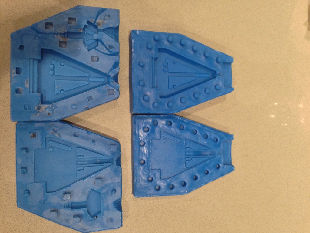

Update!!!
New molds are out of the pressure pot!! Can't believe how much of a difference a chamber and pot do!!! Maybe less the chamber but the pot .. Wow!!
I let you be the judge of the new vs first mold. Also, for my defense, that was my first ever 2 parts mold!!
And a close up of the small bubbles stuck in the first mold cavities even though I take great care to pour from high and slowly!
ImageUploadedByTapatalk1427170066.581955.jpg ImageUploadedByTapatalk1427170083.530745.jpg
And
ImageUploadedByTapatalk1427170107.547975.jpg ImageUploadedByTapatalk1427170123.665706.jpg

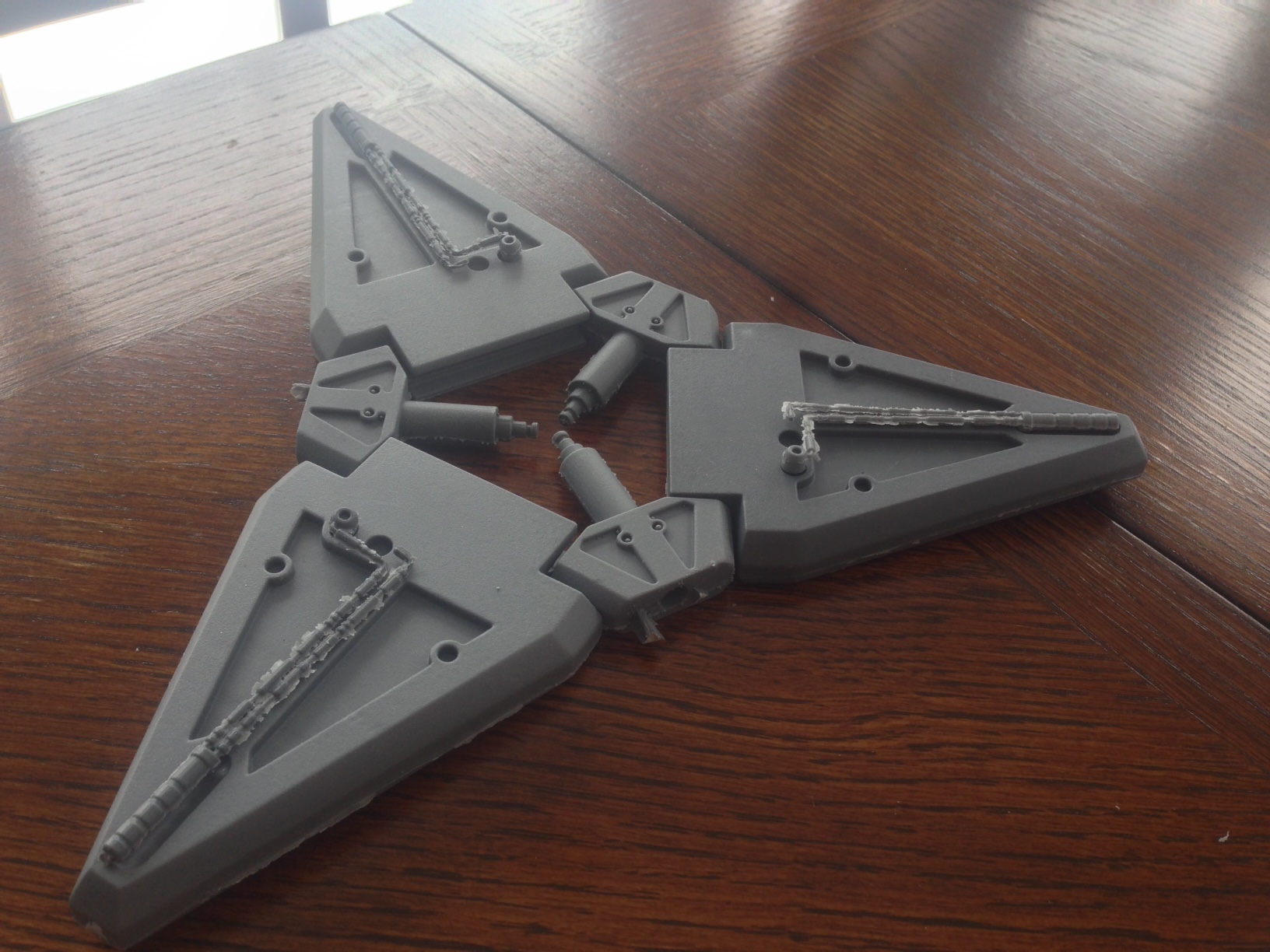

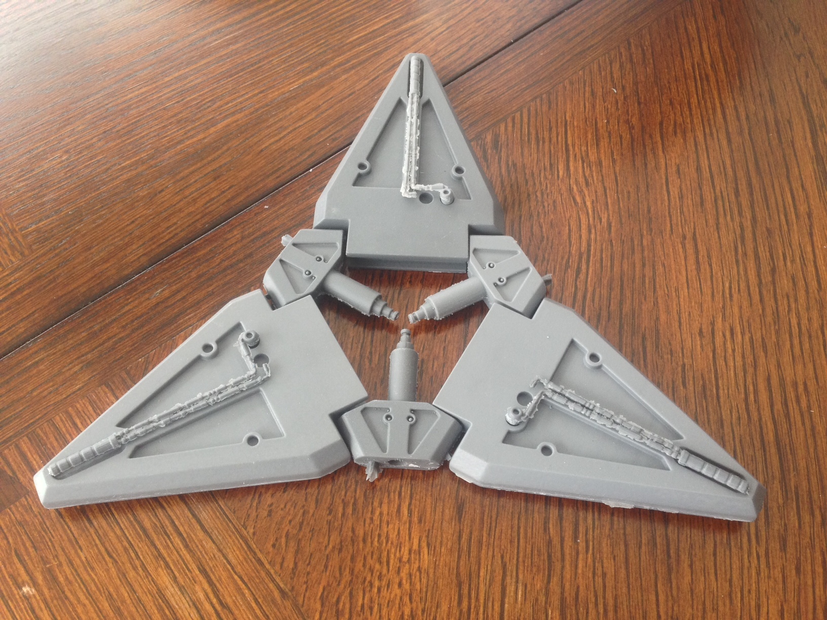

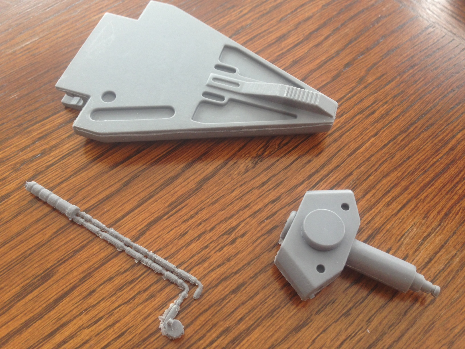

Update time!

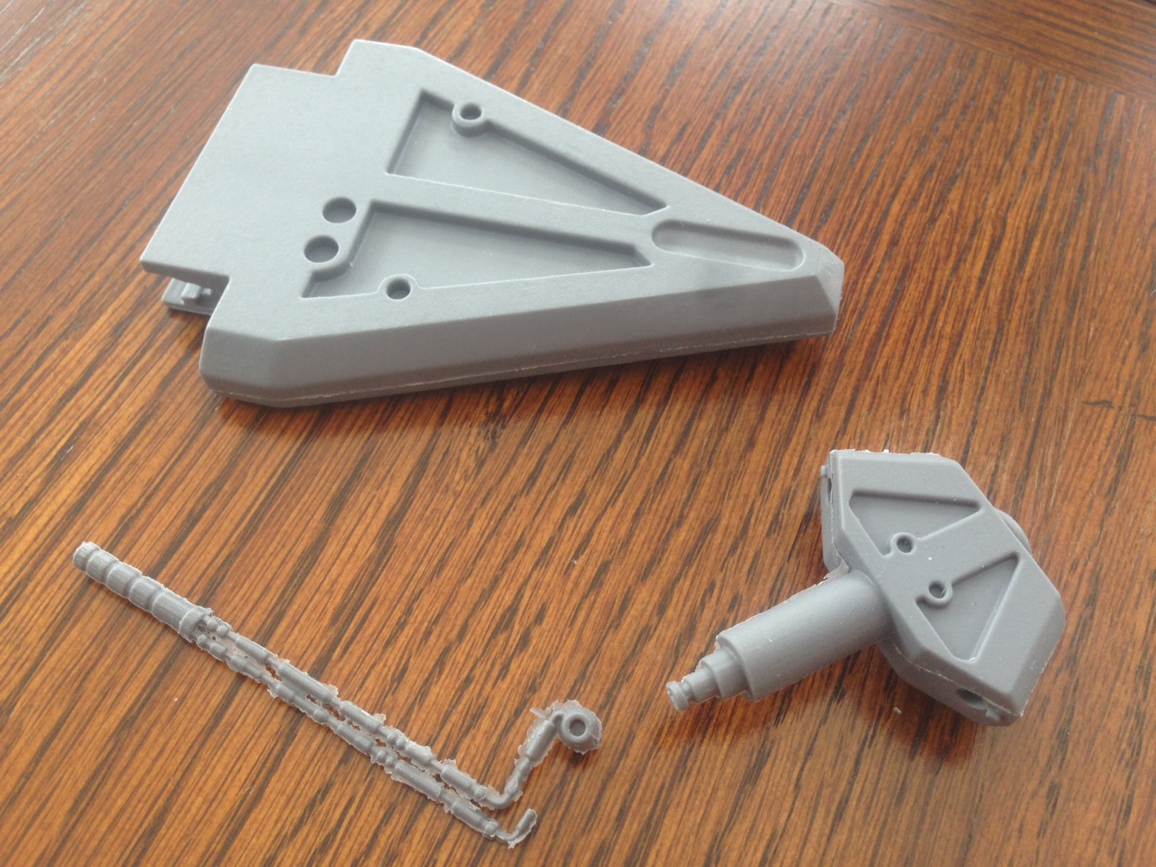

Molds are finally done and I can start producing these!!
Here is the parts that you will receive with the v2 kit.

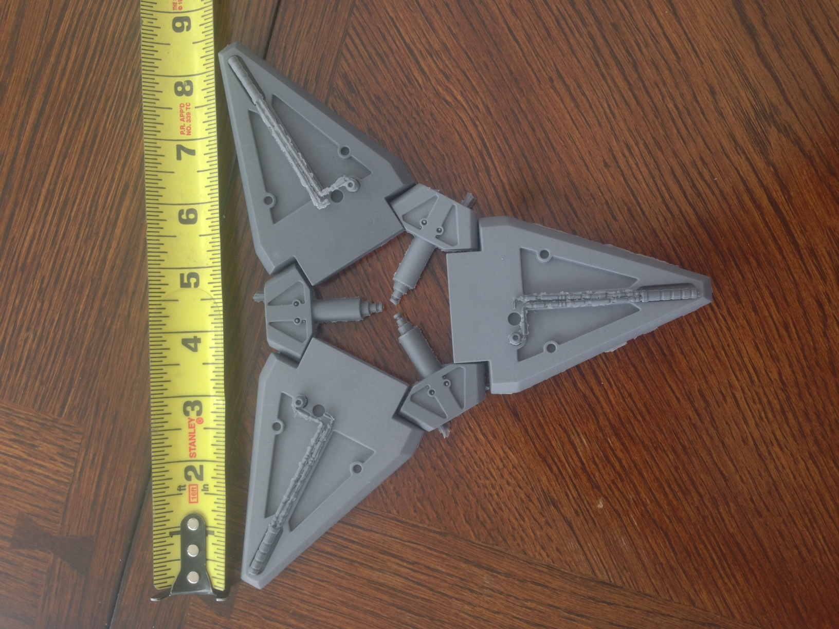

And a crude mockup of what it will look like finished. Model is about 8-1/2" from toes to toes. It was made to accomodate a 3" to 4" diameter orb.

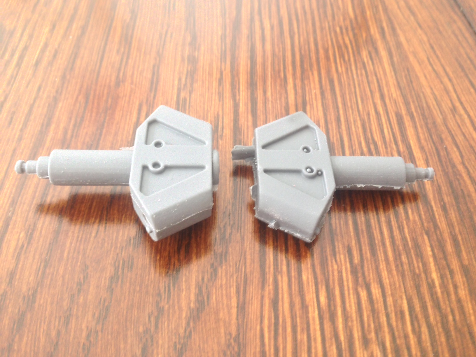

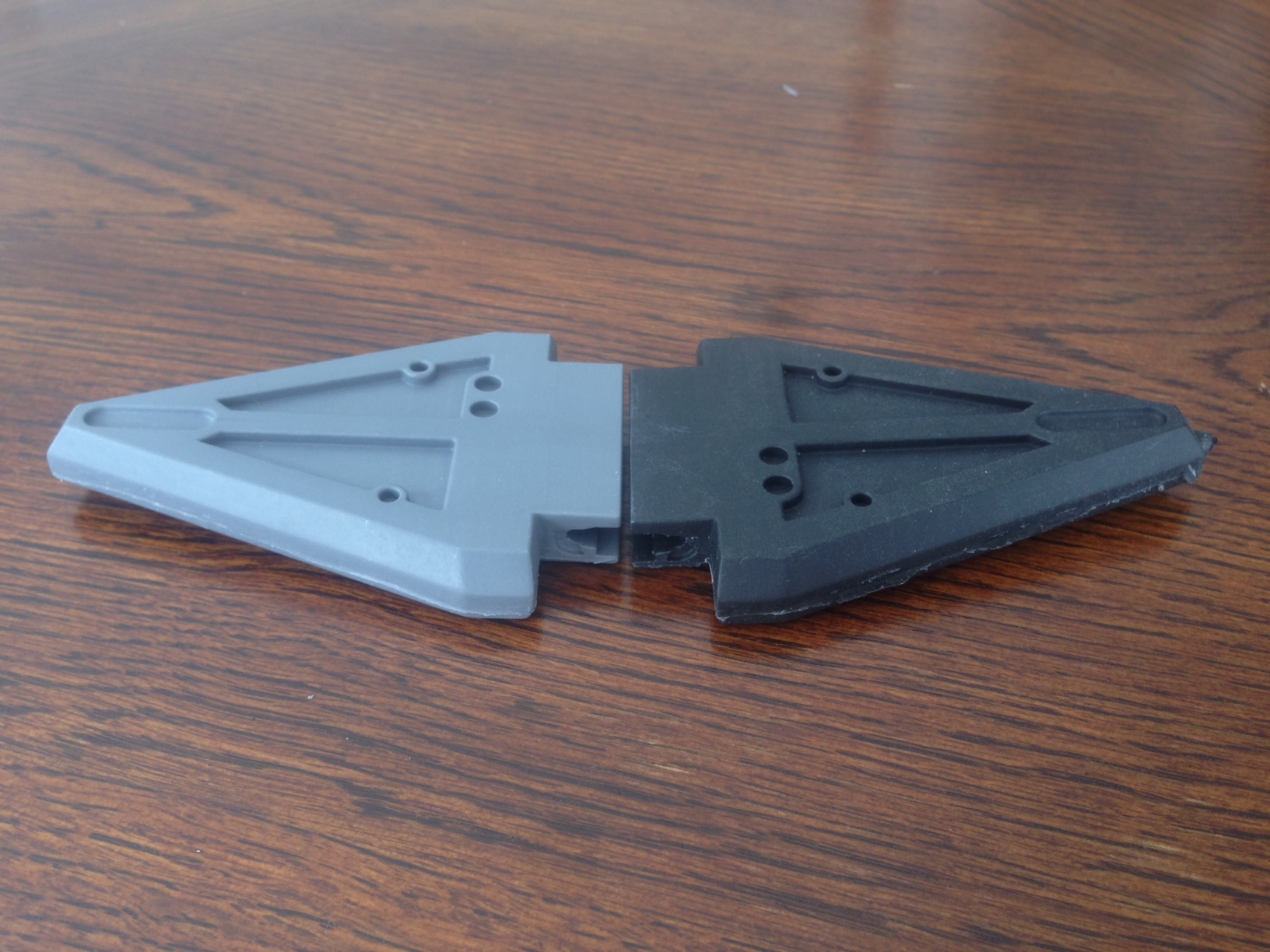

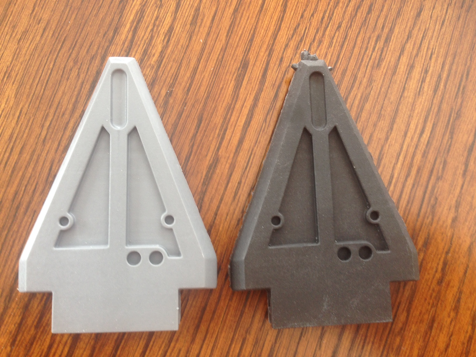

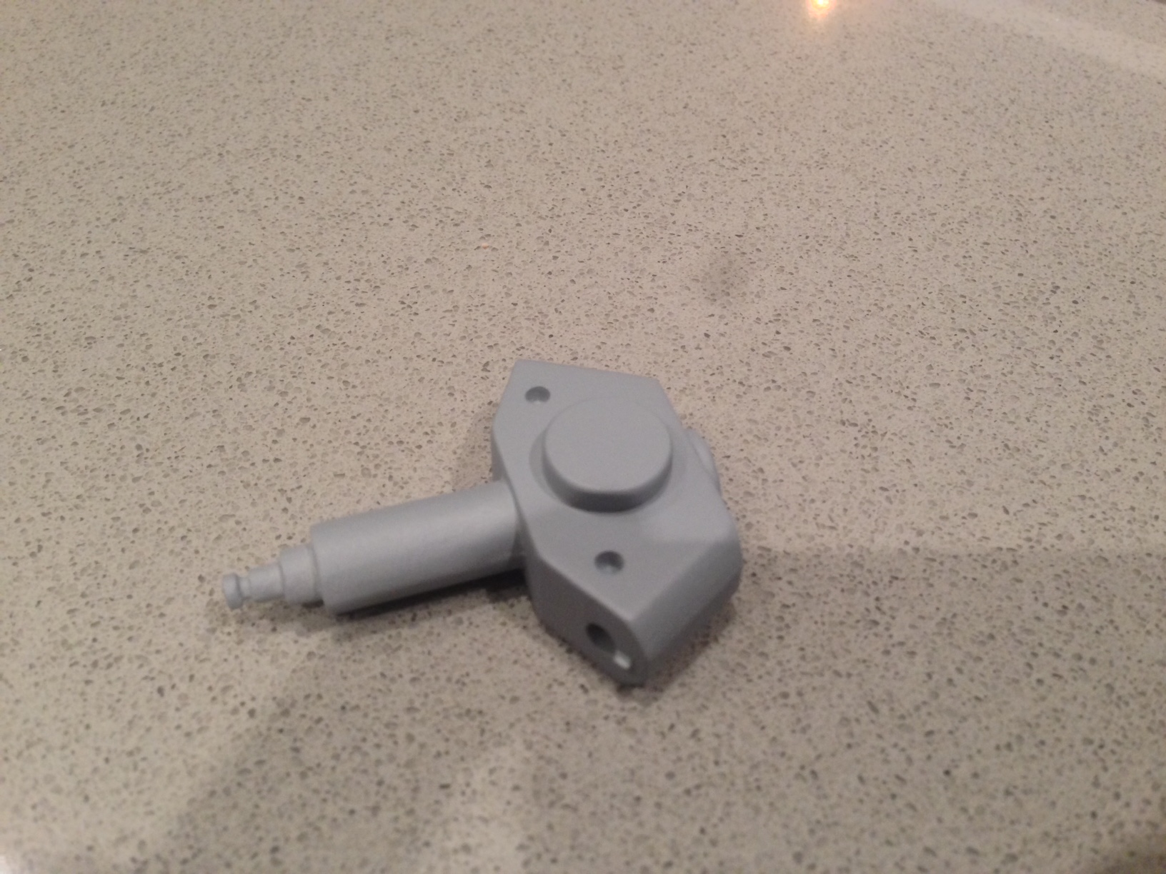

And a comparison of the V2 parts (left) versus the V1 parts, in resume:
- hinge was modified to fit the screen used prop: peg, holes and end cap were added based on the screen used prop revealed pics;
- leg has less flash cleanup;
- greeglies are the same.
