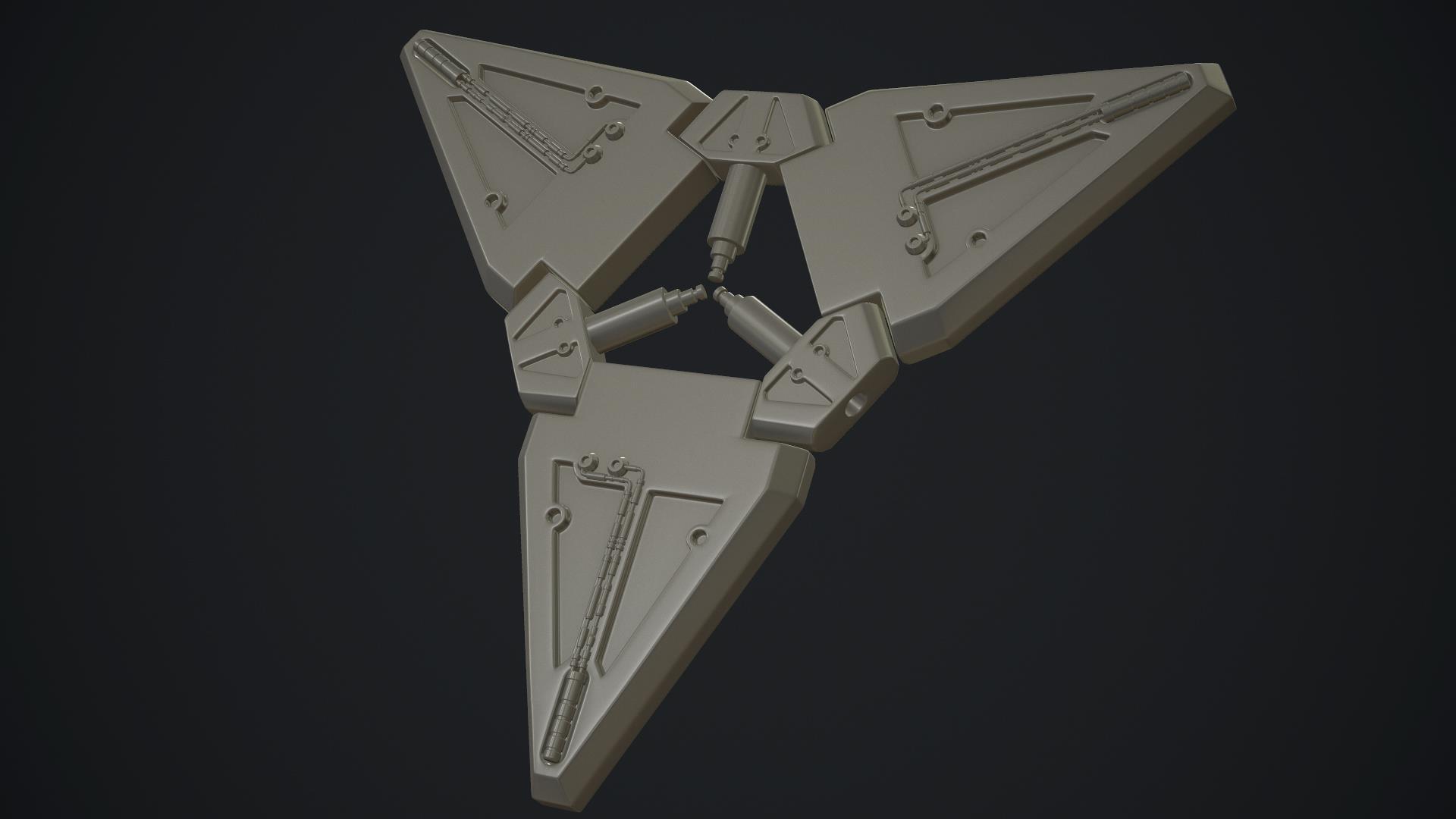

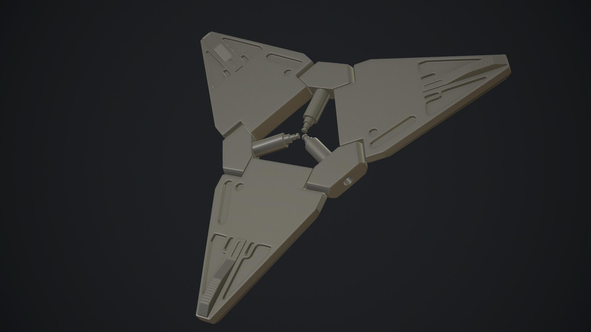

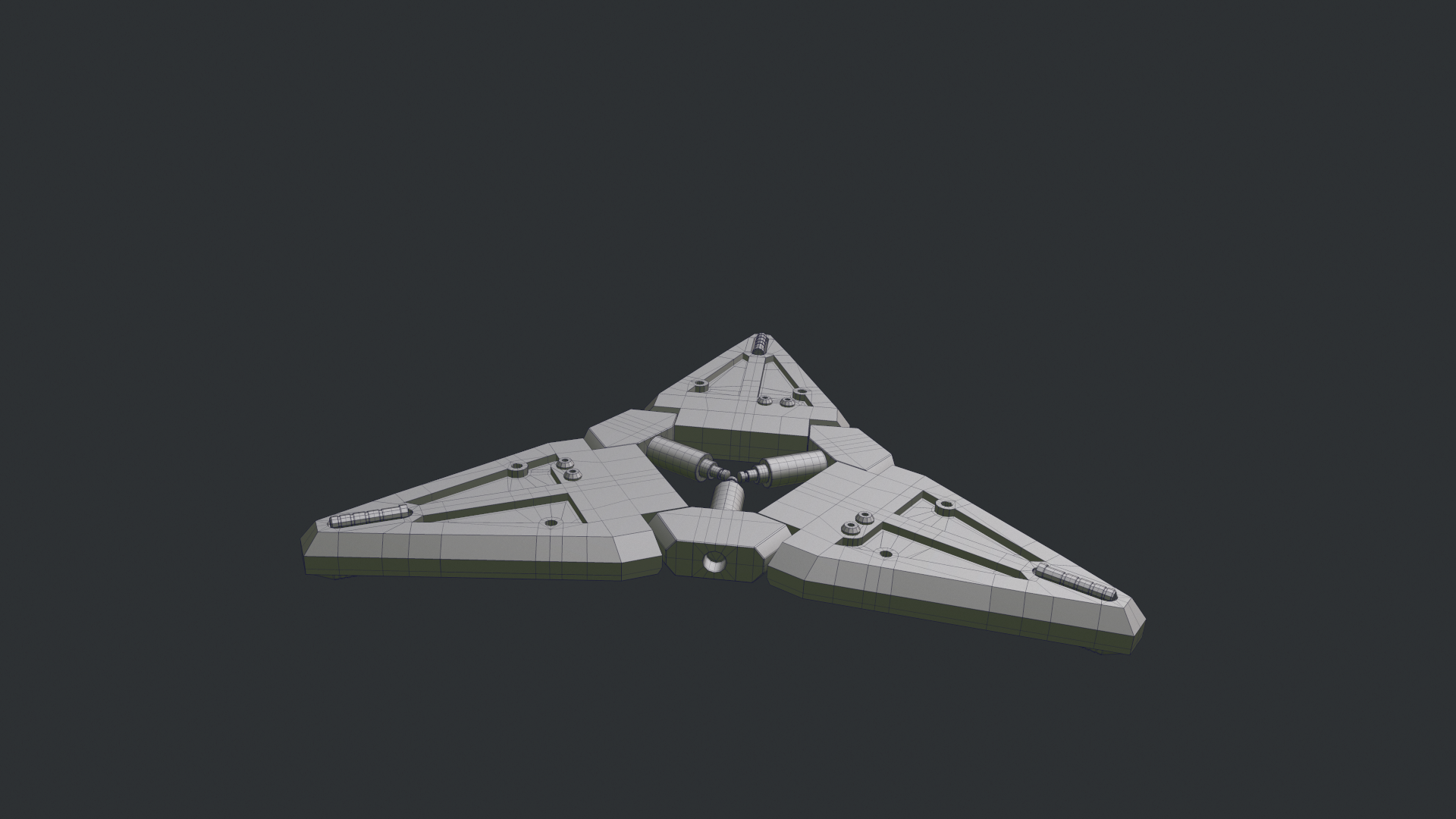

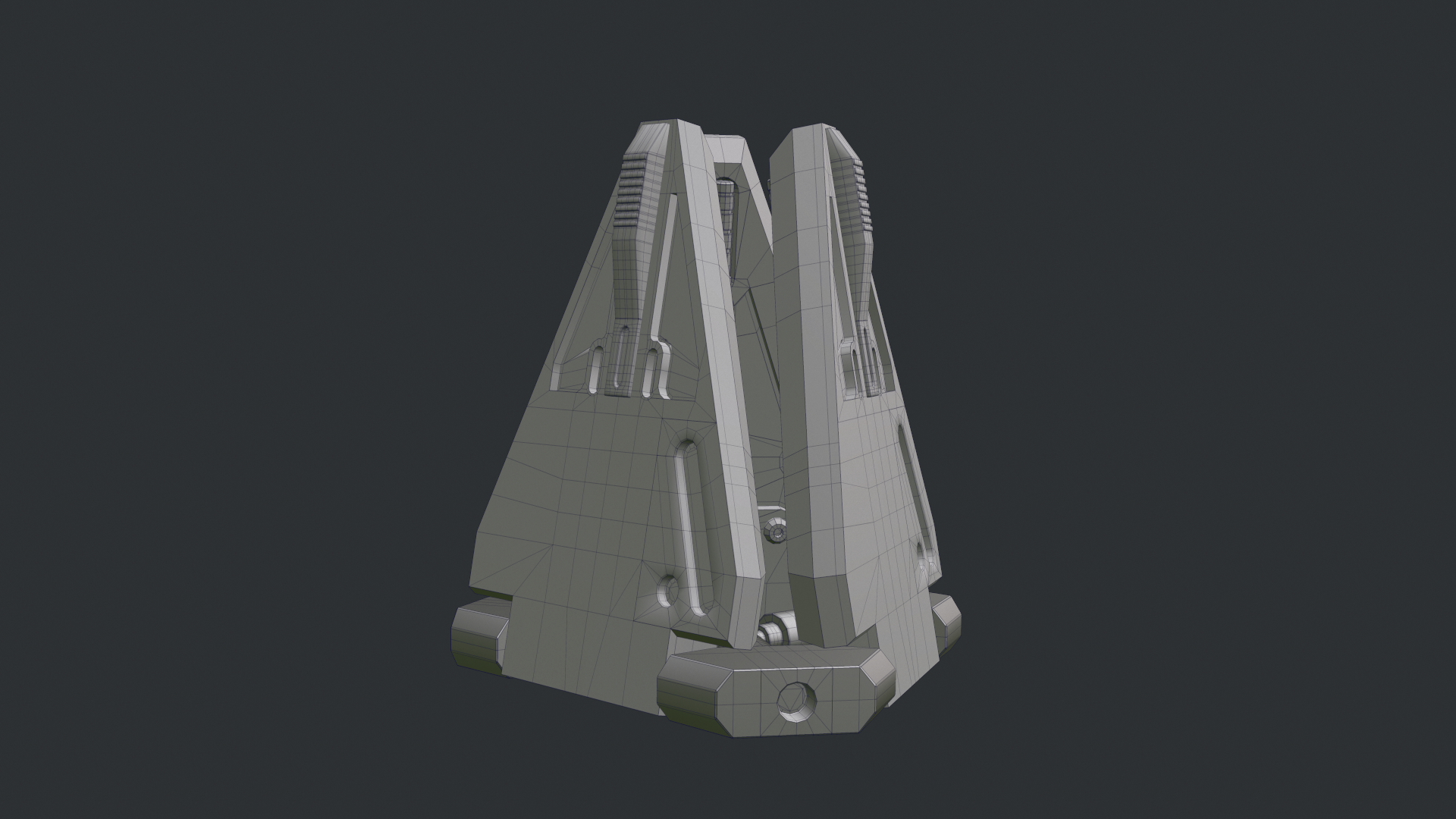

Hey guys,
I watched Guardians of the Galaxy like most of you and it grew on me!!! I was looking at all the nice orbs done here and decided that most people were missing one key piece: Starlord's Gravity Mine
So me and my buddy got to it, and within a couple days, based on the Marvel official pics, the HD movie and misc sources, we designed this...

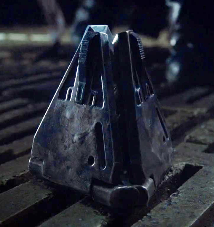

Movie prop:
Guardians.of.the.Galaxy.2014.1080p.BluRay.x264.YIFY.mp4_snapshot_00.08.26_[2014.12.03_22.08.44] .jpg Guardians.of.the.Galaxy.2014.1080p.BluRay.x264.YIFY.mp4_snapshot_00.10.02_[2014.12.03_22.12.41].jpg

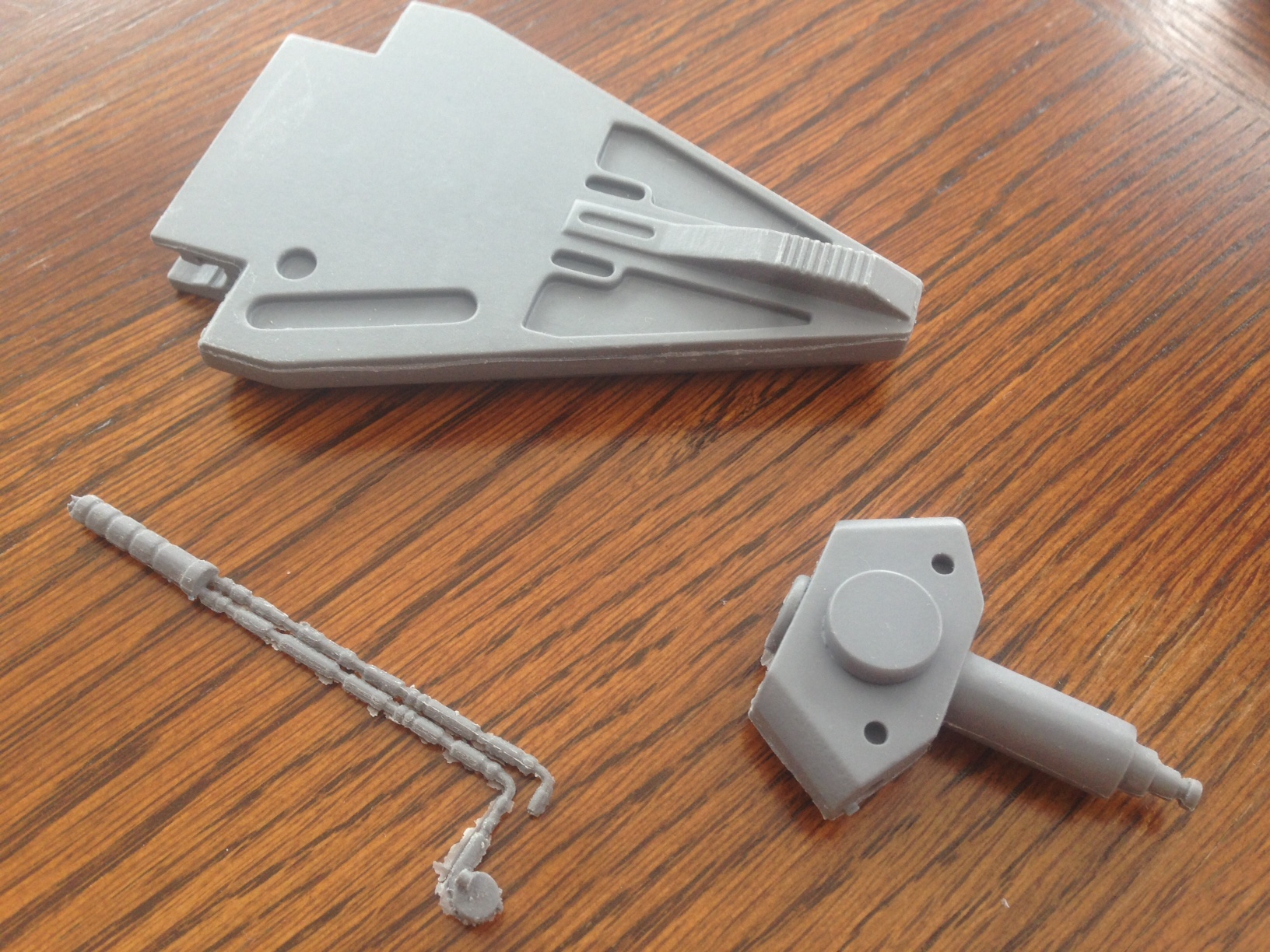

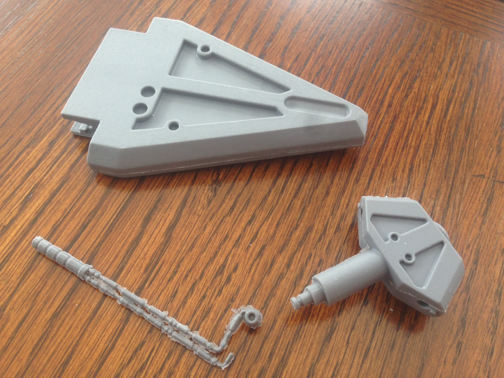

It's mecanically functionnal .. it can be set opened or closed .. hinges are solid and fonctional and have built in stoppers so that they won't go farther back and forth then the movie version - meaning it could be displayed closed or opened.

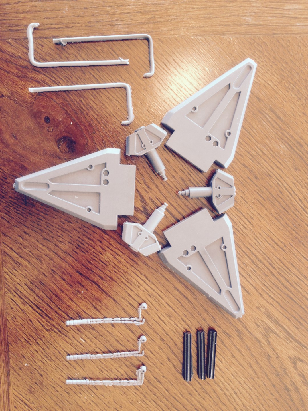

What's in both sets
v1 molds produce cast that have a little more flashing and finishing work to do legs and hinges: holes need to be cleaned and a little putty. The hinges are also the V1 version, without the small correction I added on the master based on the screen used prop pics that came out. Those corrections can be easily made by you if you go the v1 budget way.
v2 molds have been done with a vac chamber and pressure pot, so almost no cleanup is required. They also have the hinge corrections: under peg and holes and end cap.

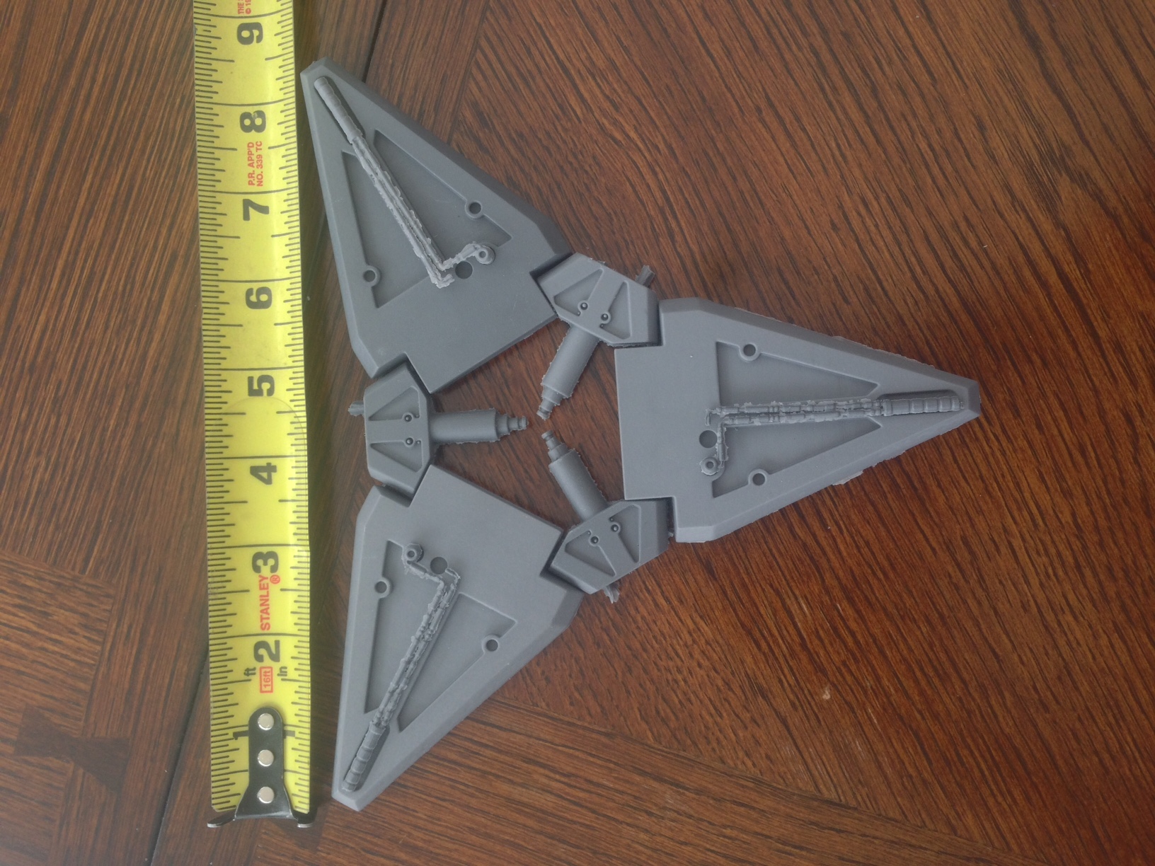

Model is about 8-1/2" from toes to toes. It was made to accomodate a 3" to 4" diameter orb.
Both sets include: 3x legs , 3x hinges, 3x plastic rods and 3x greeblies.
Greeblies are the same on both versions.

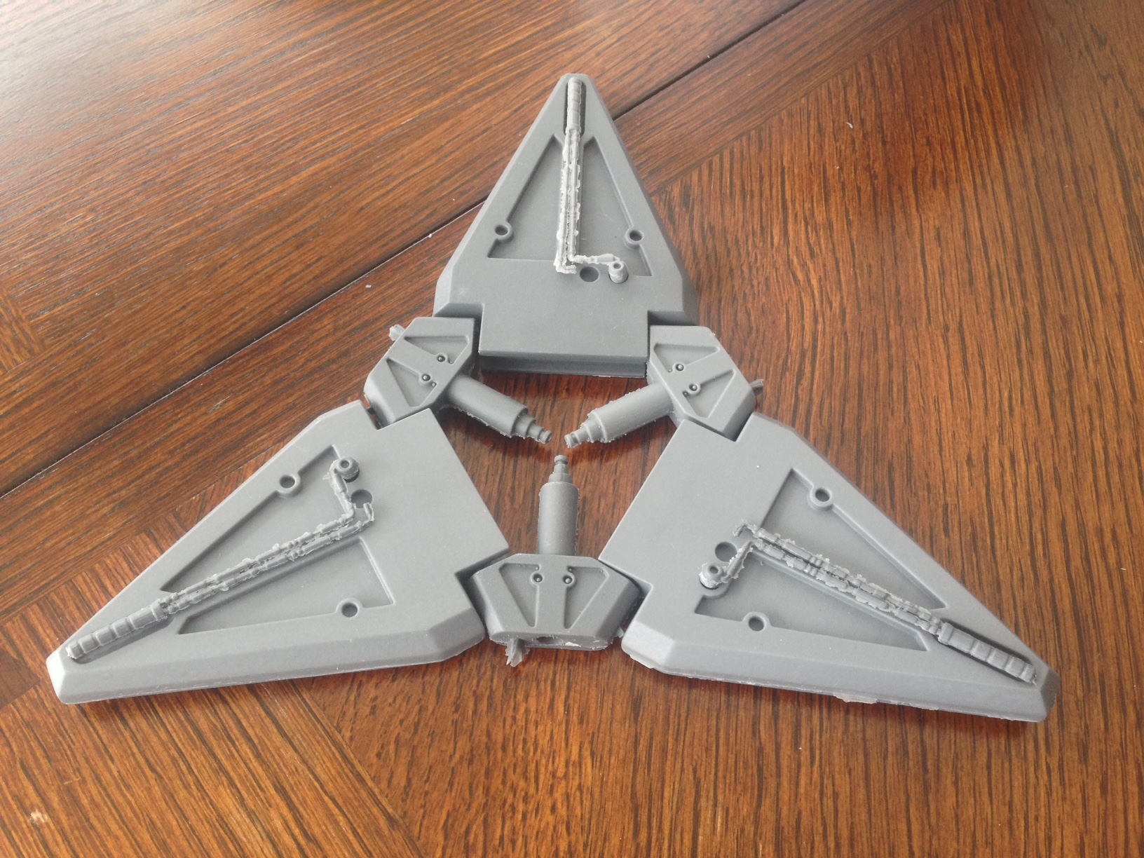

Update: Final product
View attachment 460274 View attachment 460275
And a crude mockup of what it will look like finished. Model is about 8-1/2" from toes to toes. It was made to accomodate a 3" to 4" diameter orb.
View attachment 460284 View attachment 460285 View attachment 460286

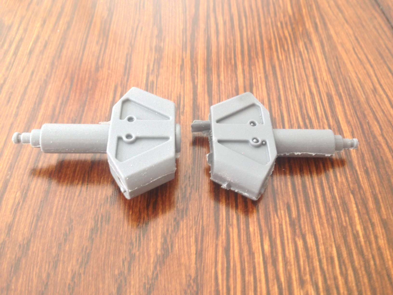

FINAL KIT

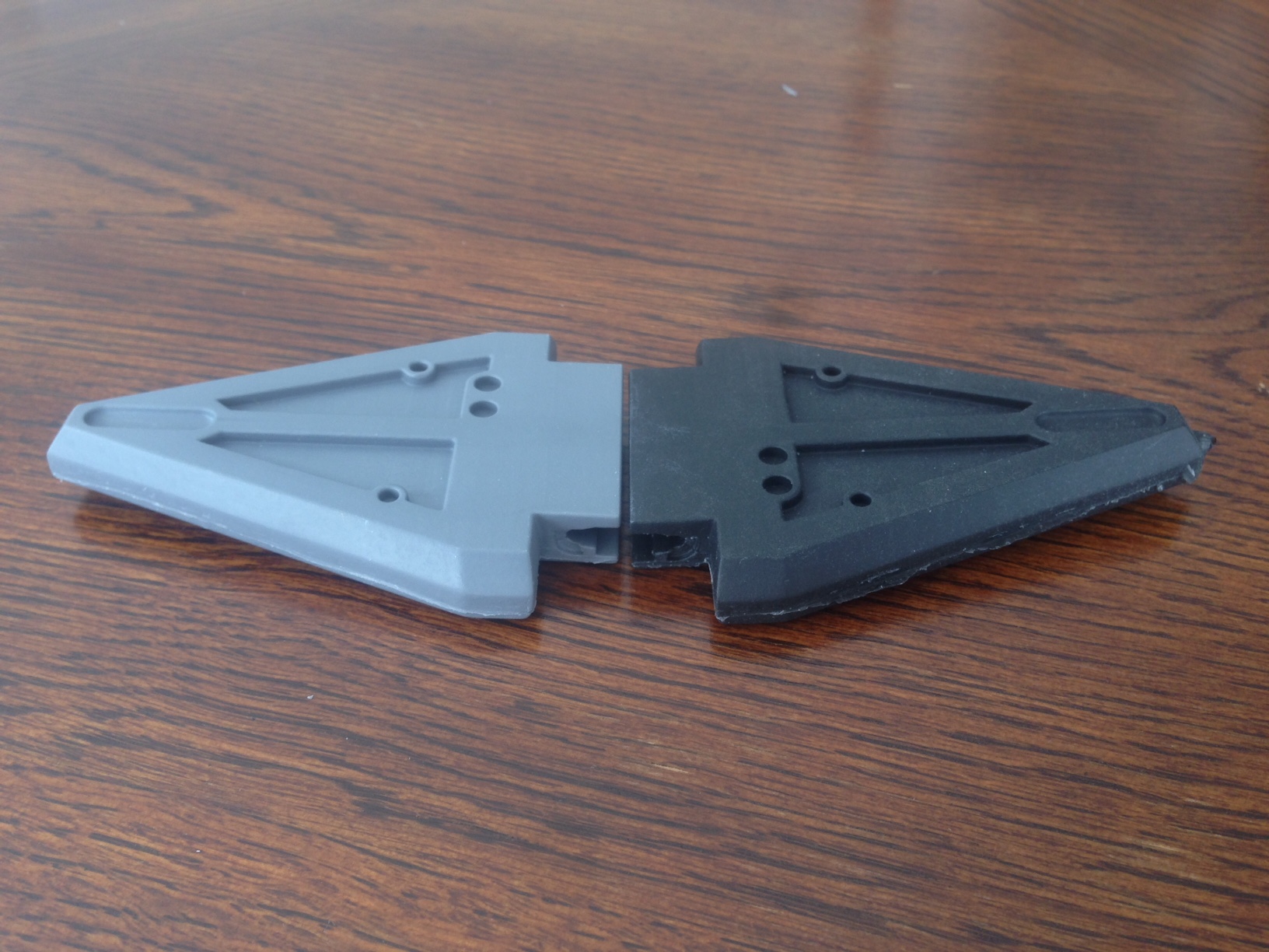

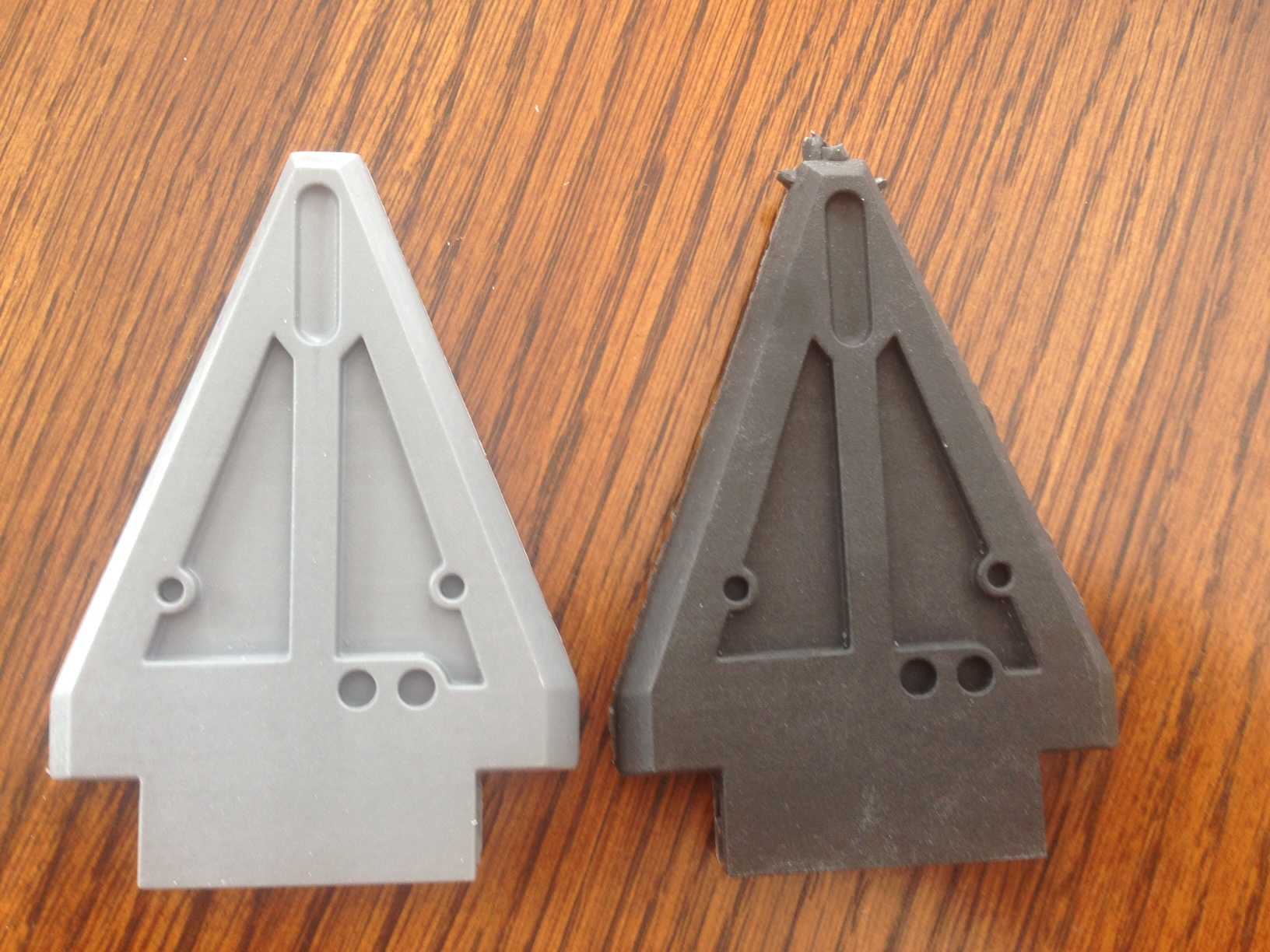

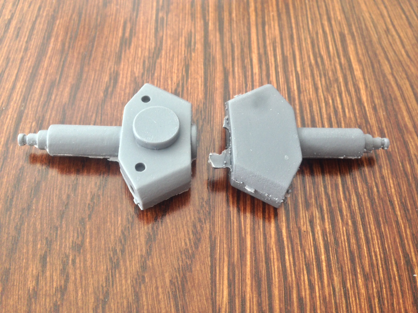

And a comparison of the V2 parts (left) versus the V1 parts, in resume:
- hinge was modified to fit the screen used prop: peg, holes and end cap were added based on the screen used prop revealed pics;
- leg has less flash cleanup;
- greeglies are the same.

Updated first post with a little more work: wires and other details were added .. still have some details to nail before printing this.

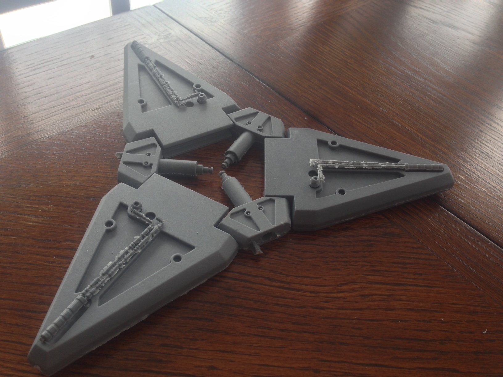

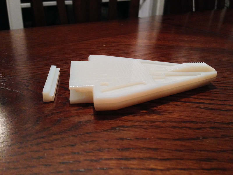

Brought my prints home last night .. they're beautiful! Will lightly sand with 400 then mold them up!
You can see my design here .. hinge will have a rob coming out, the exact dimension needed to connect to the other hinge. Then, each leg will clamp around the rods so that they can rotate. A small pin clamps the movement to be accurate to the movie mine in opened and closed position.

Will you lose a lot of the fine detail by sanding them?
I've been wary about getting into 3D printing because of the concern that although the printers can "print anything" it appears the parts need a lot of clean up before being useable, which sort of negates the advantage of the speed of the process when you have to spend a lot of time post-print to get them ready to mold/paint.
Sorry, that isn't a reflection of your work just voicing my concerns around the process.
I'd love to see a before and after of the raw print against the cleaned up and primed part, this looks like an interesting project and as someone who has handmade an Orb this could be a nice display piece to accompany it.
Re: Guardians of the Galaxy : Starlord Gravity Mine & Infinity Orb
Hey renaissance!
Very legit question .. and that's exactly why I don't print on a home made printer! These are good for big soft parts .. but I always find it not so good for detailed parts. That's where you lose details if you sand! :) If you read my first post, I'm sending all my master prints to a polyjet printer which comes up with barely noticeable print line .. I literally had to throw the light on the print to be able to see them ..
I took about 5 minutes last night to sand it with a 400 grit paper .. that's super fine and that's all it takes! Then, I threw some primer on it after gluing both parts together .. That's about as much prep as these are gonne need!
I let you be the judge of the quality of the master in the next post!
Master is almost ready for molding! Just have to completely erase that seam line and finish the primer properly. Again, I only sanded the leg top/bottom parts .. nothing else .. check the quality of the print!
Now, here's some pics to show how this is gonna be built:
- 3 rods of the right length will come in the kit.
- Insert one rod in each hinge.
- Set one leg around rod and glue clamp on the leg around the rod (make sure not to glue the rod). You can clamp first and insert through rod next. The reason it's made this way if we can't mold this kind of hole.
- Once you have the leg inserted, glue the next hinge to the end of that rod.
- Repeat 3 times.
You can see here the channel and pin that will prevent the legs from over-rotating either up or down and will get the exact orientation of the movie prop. Either opened or closed! :)
