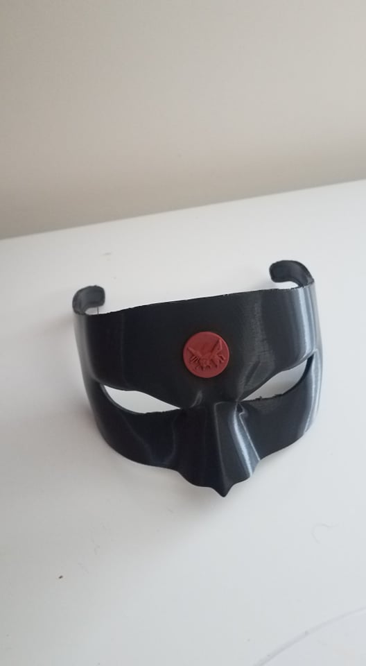

I can't speak for the original material, but I worked one up for a member here that was printed in PLA filament. It was absolutely wearable, but a urethane cast with separate hornet 'button' would look amazing and be more comfortable I think. Worbla would be a good material for the base too.
(below was a rough print with a separate hornet button)
