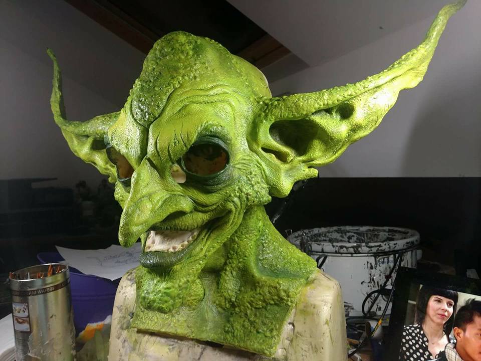

So what i did was take an alginate cast of the old design, and poured liquid plastiline into it. As there were elements I did like in the original sculpt. From there i placed the clay copy onto my sculpting form. Here i started to work out the problem areas, one being the nose. The Goblin the last mask was based on was more Brian Froud esq, Whilst I liked the hooked nose on that Goblin I began to feel it wasn't "Green Goblin" enough.

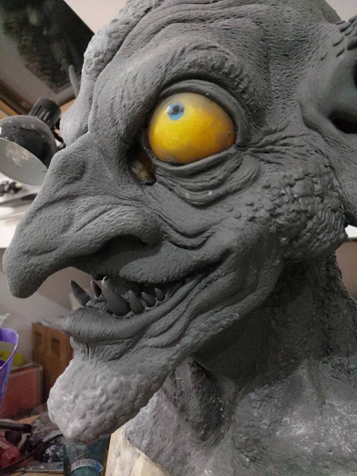

I looked at the nose the Green Goblin had and adjusted it to be more stocky, also made the chin jut out more. I am currently working on a small sculpt of my company's logo mascot and the ears from the Imp chap inspired the ears for this Goblin. I also decided to remove the boils and give it more course, rough skin in certain ares.

From there, once the sculpt was complete I made a two part Herculite Plaster mould as the mask would be cast in Latex.
I then seamed the mask and poured in some soft prop foam J-162 into areas such as the nose/chin and ears to help prevent them from distorting.

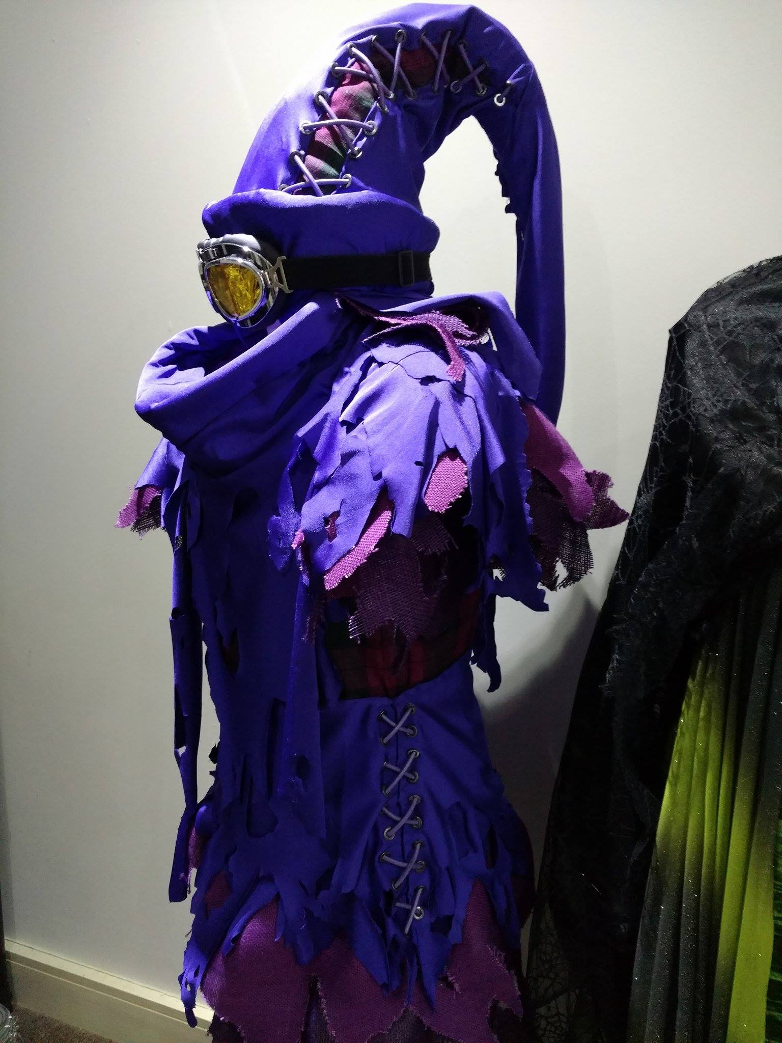

The costume was inspired by a few designs. In a Halloween show I did a few years back we had creature characters that had torn clothing draped over them. I really liked the torn look I had created for them, and felt that the Goblin would have torn clothing from fights. The second inspiration was the figure from Sideshow collectables. The use of a patterned fabric in the hat and the tunic was something I hadn't seen before. On the old costume i had wanted to make the stitching obvious, but seeing as it was last min only had string. Here I also wanted to retain that from the first design, but instead used a plastic looking leather thong.. I also had chance to add the missing eyelet holes i didn't hace time to add to the last one. I had also seen a few versions of the Goblin with goggles. This to me made sense as he probably would have them when flying on his small winged craft. Sadly I didn't get time to create that but I will be making on to go along with my cosplay for next time. I stripped the old hat down and simply recovered it due to time constraints. I also had an old pair of heeled boots i covered. The boots had panel forms already there so I simply kept these and highlighted them by utilising different shades of purple.

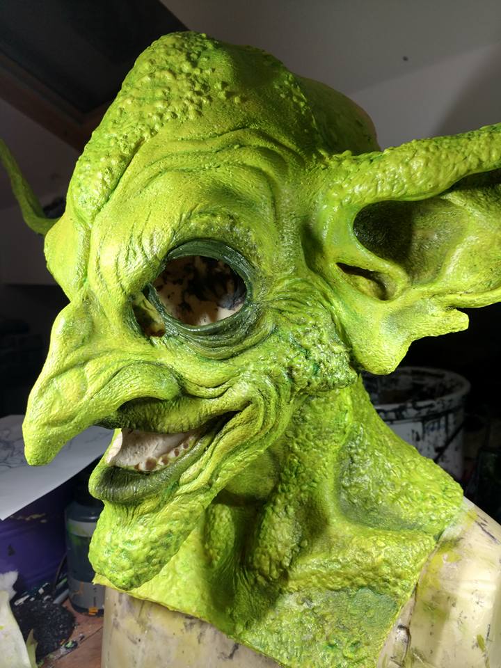

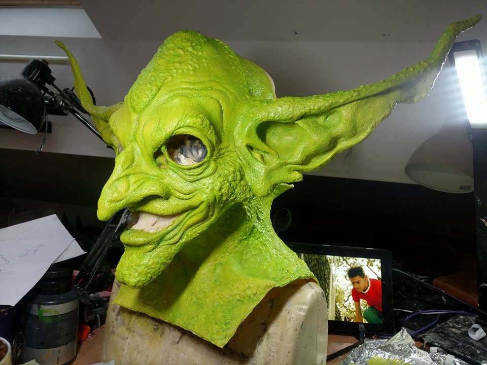

Then it was onto painting the mask, and the skin patches on the suit.
17190544_10155133857729533_8826067830396547290_n.jpg17191264_10155133857924533_544991940904088946_n.jpg17264302_10155153428769533_7939291639148271105_n.jpg
I left the teeth off for this version as I didn't want to frighten too many kids, but willbe adding them this week so will post an amended pic at a later date.
