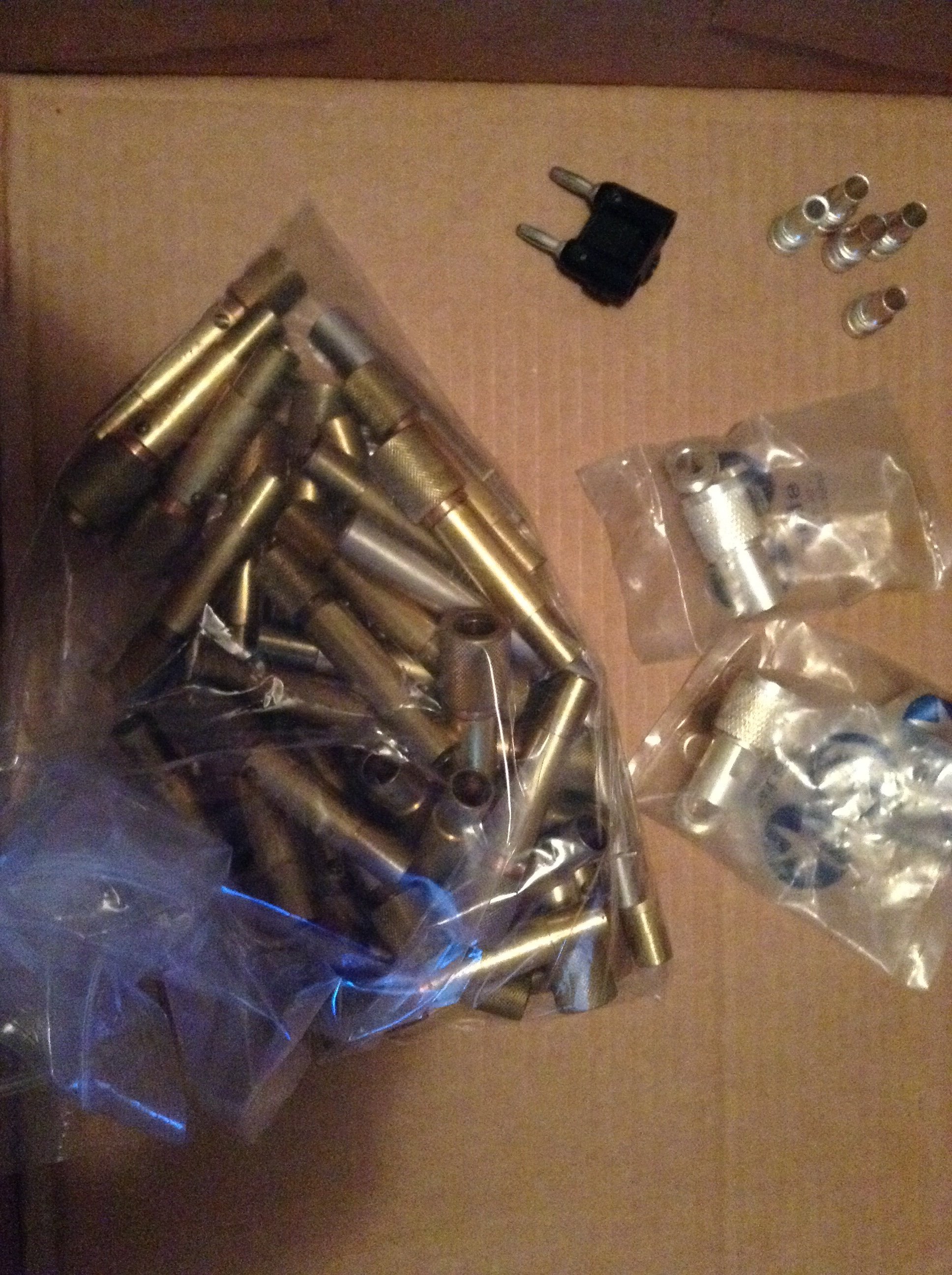

I have six of these connectors - enough for three blasters unless I'm mistaken. I don't want to make any profit or anything off these, I want you people to have them! Although I wouldn't say no to a trade ;) PM me!
here are five plus the one above. I saw someone post a pic of those big connectors above and I have a few nib but idk how they relate to this plug or anything lol

These are readily available at Radio Shack, as well. For pretty cheap.

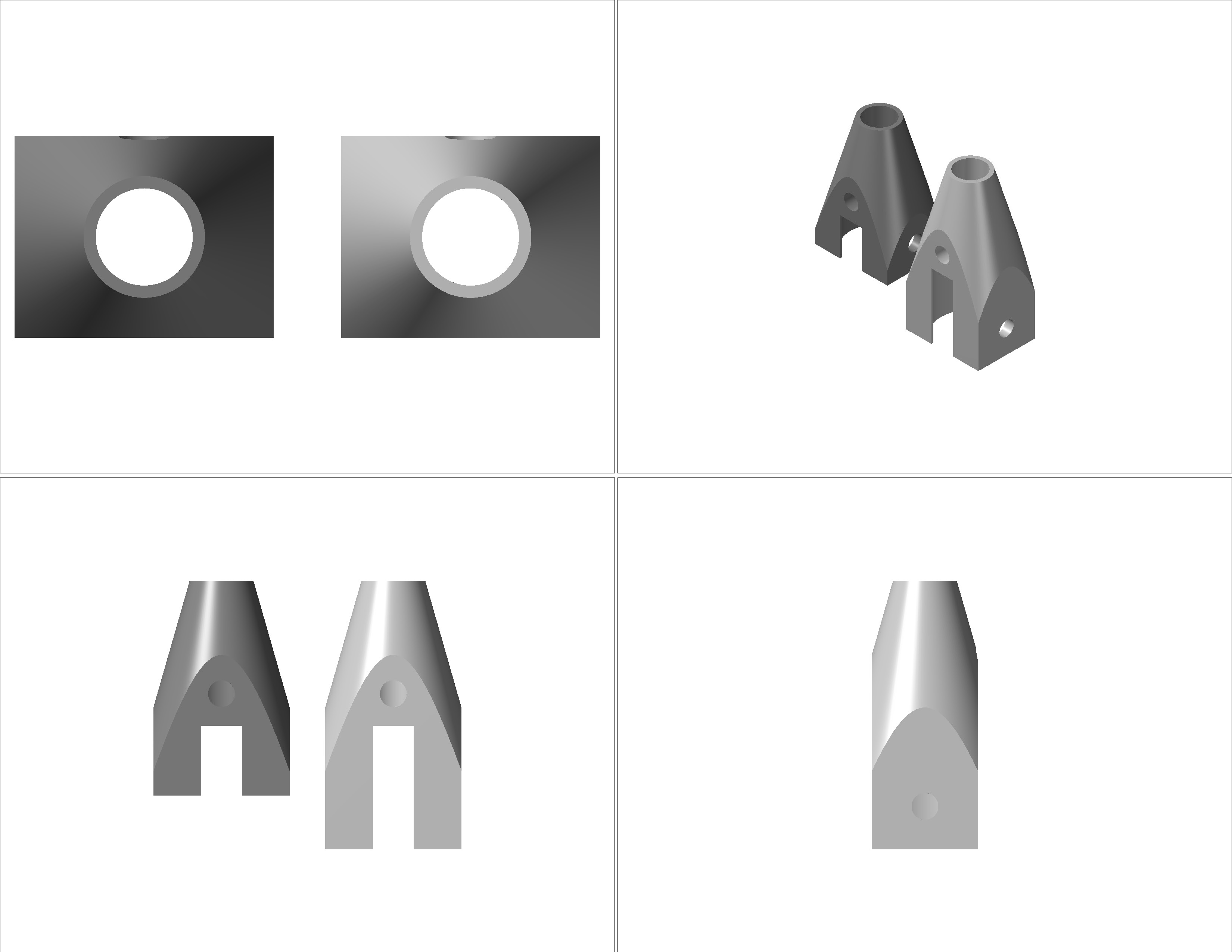

I would have addressed this some time ago but I have been out of commission for over a month with a broken ankle & surgery & have been stuck with my leg immobilized in the air. So haven't been able to work on anything so now I am trying to catch up on things.
I spent some time today studying photos & updated the model for the trans rotor piece by lengthening it to 25 mm long. This is 5 mm longer than what is currently available. I am basing this off of scaling the reference photos & I am on the fence as to whether it should be at 25 mm or at 23.5 mm depending on the angle of measurement. The difference is only 1.5 mm (.060"). There aren't any good photos that I have been able to find.
Here is a photo rendering of the current & the revised trans rotor piece showing the 5 mm difference in length. Any input on this would be appreciated.
You know how many times I've used that excuse? :p
Glad to see you're improving.
The part looks good to me but then again, I know nothing. :(

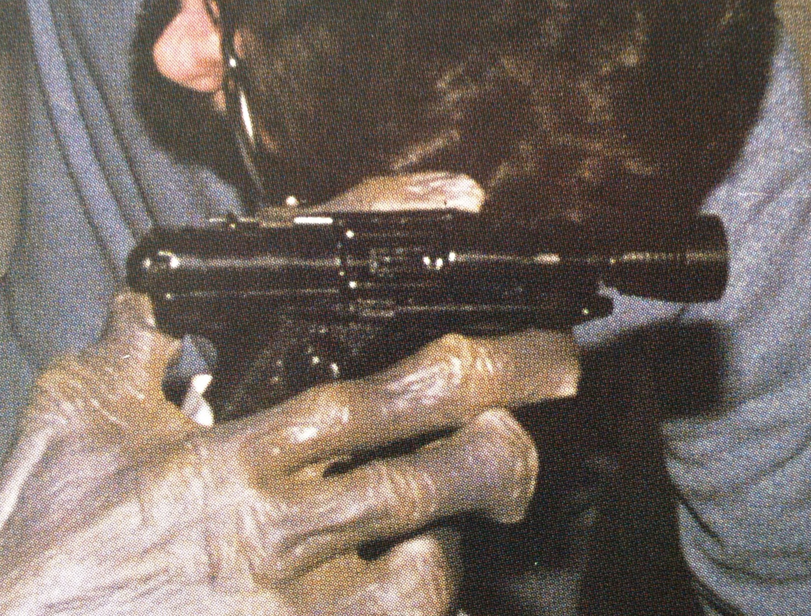

I never have anything helpful or insightful to add to these discussion/research threads but I was looking through one of my books & found a picture of Greedo that I've not seen before in the threads,
ok so it's just a iPhone picture of a picture in a book but given how few pictures we have of this blaster I thought it was worth adding I'm sure everyone's seen it before & it's old old news but hey ho :lol
It's probably just the picture quality but the front of the Tomtit cylinder looks odd, like its smooth/solid

Dude, nice! Never seen these.
Is that rear push rod metal?! Why on earth would that be?
And I'm seeing something different in the cylinder cover over the ejection port. Don't see the reducers. Almost looks like a short piece of t track or something, with something longer extending towards the barrel? Maybe just a reflection.

Also, in those pics, proof that at least one version had a fat (resin cast) trigger guard. I completely forgot that you can freeze frame the movie and see that plain as day.
Also, still not seeing the sweep arm piece in the barrel. Still looks like a metal rod that was added to the casting for durability, then chopped off at the end. Not seeing a center hole, and the edge looks jagged, like a hacksaw was taken to it.
