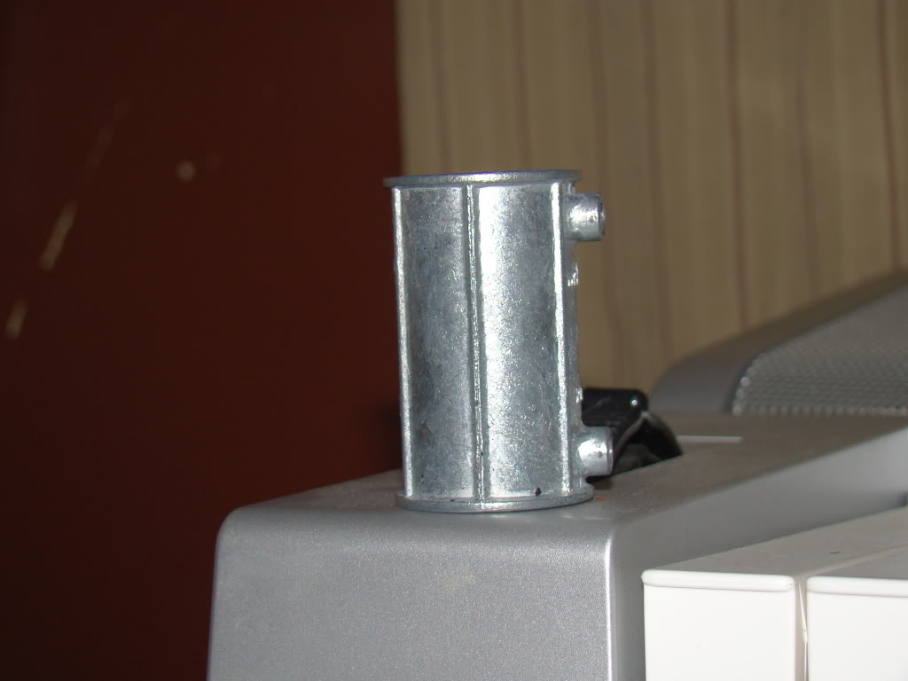

I am using these electrical conduit connectors from braids. They have a good shape and they also have a good weight to them. I had to brick lay them on the dreads because they make a clinking noise when they hit eachother. I painted them gold. Here is it in the raw form, you have to grind off the screw holes but they looked good when they were done. They held down the dreads to a more uniform shape.
